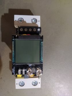

    I had to desolder the LCD Board and this is what I found. TX and RX from the CB3S are routed thought to the LCD PCB.
    The Main Chip Is a V9911
    A FM24C64 - nonvolatile memory
    A SC02B - Best Guess The numbers are unclear

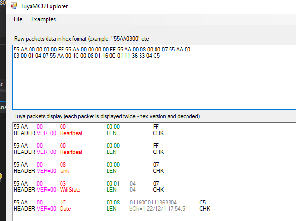

    If that's using UART, then I can try to make you support for that if you just provide me a capture of sent data, in hex format.
    I can run OBK on Windows and easily developer drivers with 'fake' UART packets.
    Would you be able to provide Realterm hex capture (and determine baud rate) like the user in this topic?
    https://www.elektroda.com/rtvforum/topic3933836.html
    Second option: is there ANY driver for V9911 anywhere? Tasmota? From what I heard, there is only that:
    https://www.creationfactory.co/2019/12/reverse-engineering-zmai-90-din-rail.html
    but zmai-90 uses Vangotech V9821 chip so we would need to know if it is the same as V9911

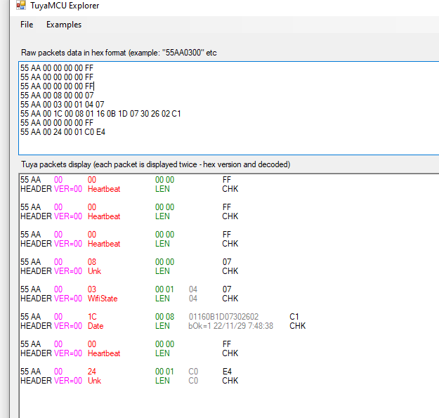

    Hey, it has 55 AA header! That's a very good news, it's a Tuya MCU, like the previous one, and we already support most of it out of the box!
    Still, lets analyze the packets, because some devices have 'special' packets that we still need to parse.
    But don't worry, you will certainly get support for that device.

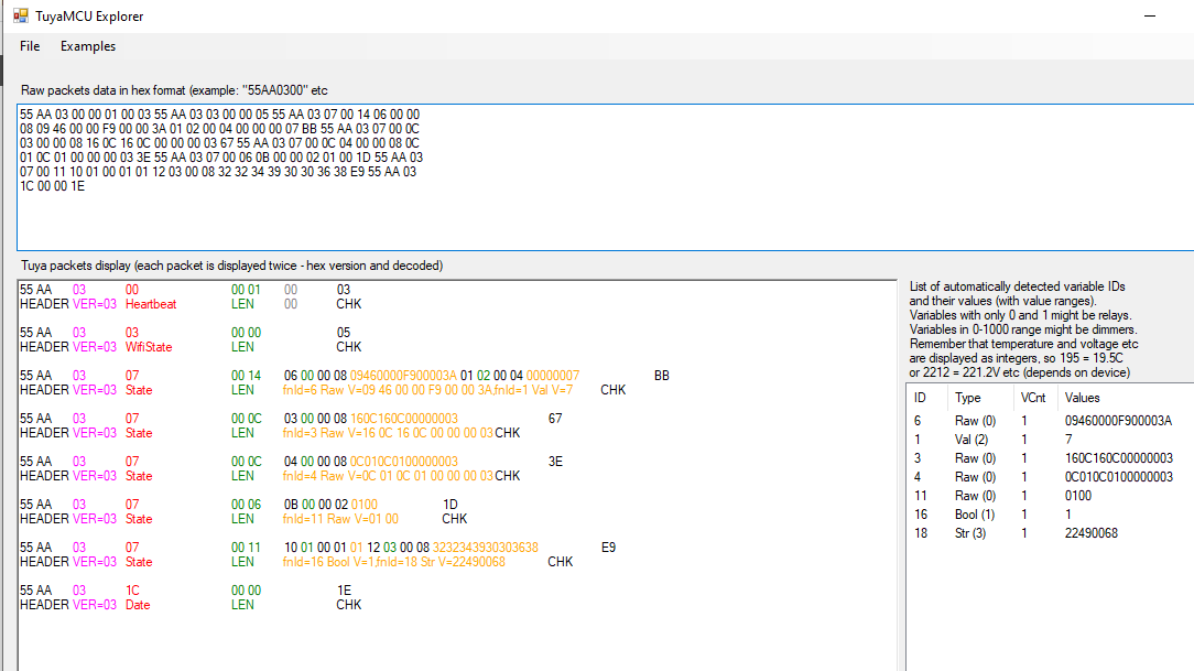

    This is the data send from TuyaMCU to WiFi module. It contains energy stats, voltage, etc.

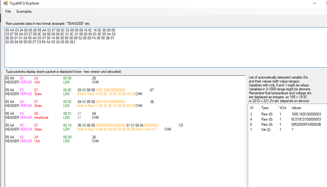

    Home Assistant Integration: Reflashing BK7231N in Tuya Smart DIN-rail Energy Meter TAC2121C
    fnID 6 looks like a compound data packet
    55 AA 03 07 00 14 06 00 00 08 09 1D 00 00 00 00 00 00 01 02 00 04 00 00
    00 00 58
    the content: 091D000000000000
    091D looks like a big endian 2333 to me, so a voltage times 10? 233.3V?
    the remaining bytes in this packet are most likely current, power etc, but they are all 0 and I can't determine which value is where, I need a sample with a 60W load

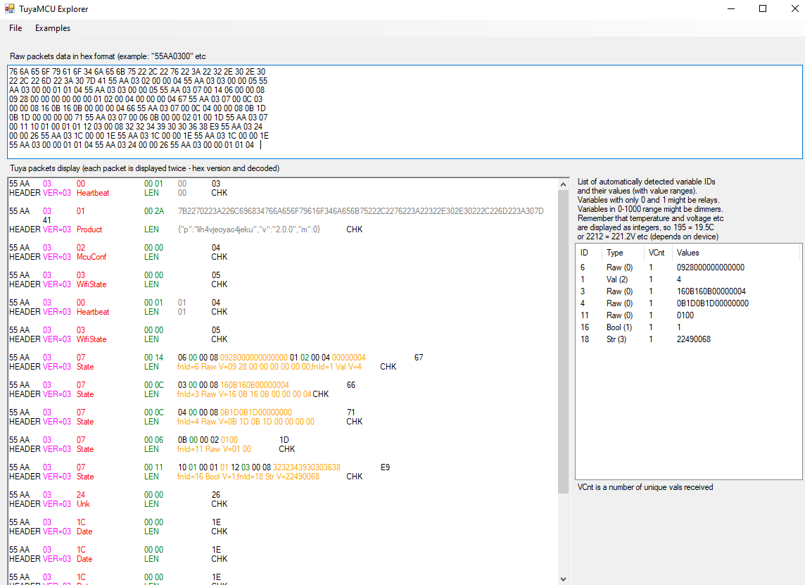

    Rx PIN:
    (Toggel Relay)
    55 AA 03 24 00 00 26 55 AA 03 07 00 11 10 01 00 01 00 12 03 00 08 32 32
    34 39 30 30 36 38 E8 55 AA 03 07 00 11 10 01 00 01 01 12 03 00 08 32 32
    34 39 30 30 36 38 E9 55 AA 03 00 00 01 01 04
    Huh? A a string?
    No idea what it might be currently.
    But there is also a fnID=16 with Val 0 or 1... so, a relay.
    it looks like a relay is connected to MCU and MCU reports to WiFi module the state of relay..

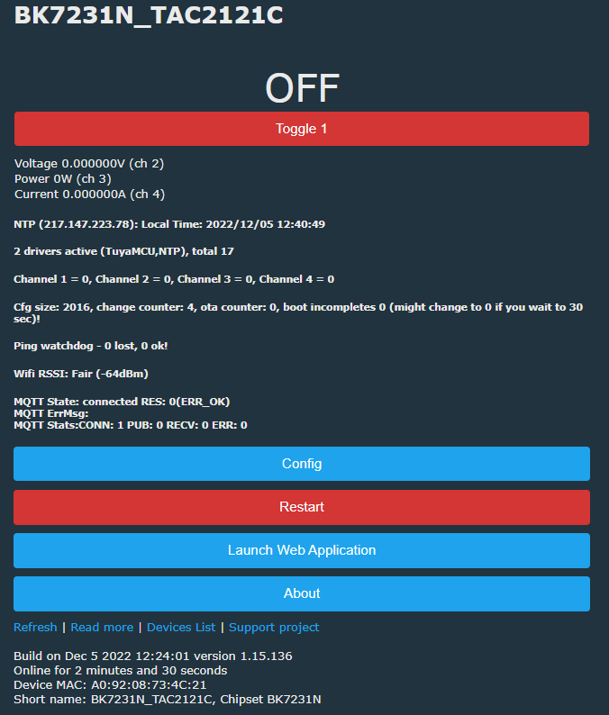

    #9 20305911
    tomanyusers
    Posts: 34
    Great News. I was also a little worried.
    I don't have a light ready at hand but I do have a fan. I hope that will work. If not let me know.

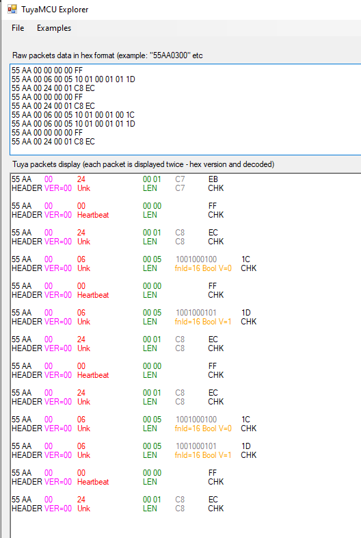

    Here is the Tx Pin when toggling the relay from the App.
    55 AA 00 24 00 01 C7 EB
    55 AA 00 00 00 00 FF
    55 AA 00 24 00 01 C8 EC
    55 AA 00 06 00 05 10 01 00 01 00 1C
    55 AA 00 06 00 05 10 01 00 01 01 1D
    Here is the Rx Pin when toggling the relay from the App.
    55 AA 03 24 00 00 26 55 AA 03 07 00 11 10 01 00 01 00 12 03 00 08 32 32 34 39 30 30 36 38 E8 55 AA 03 00 00 01 01 04 55 AA 03 07 00 11 10 01 00 01 01 12 03 00 08 32 32 34 39 30 30 36 38 E9 55 AA 03 24 00 00 26 55 AA 03 07 00 14 06 00 00 08 09 4A 00 00 84 00 00 1D 01 02 00 04 00 00 00 03 29 55 AA 03 00 00 01 01 04 55 AA 03 24 00 00 26
    Here is running with a fan on max:
    Voltage~ 234.8
    Current~0.154
    Watage~36.13
    PF ~0.999
    Frequency 50.04
    55 AA 03 00 00 01 01 04 55 AA 03 24 00 00 26 55 AA 03 00 00 01 01 04 55 AA 03 24 00 00 26 55 AA 03 00 00 01 01 04 55 AA 03 24 00 00 26 55 AA 03 07 00 14 06 00 00 08 09 16 00 00 99 00 00 23 01 02 00 04 00 00 00 03 10 55 AA 03 00 00 01 01 04 55 AA 03 24 00 00 26 55 AA 03 00 00 01 01 04 55 AA 03 24 00 00 26 55 AA 03 00 00 01 01 04 55 AA 03 24 00 00 26
    Here is running with a fan on min:
    Voltage~ 235.8
    Current~0.131
    Watage~28.67
    PF ~0.93
    Frequency 50.04
    55 AA 03 00 00 01 01 04 55 AA 03 24 00 00 26 55 AA 03 00 00 01 01 04 55 AA 03 24 00 00 26 55 AA 03 00 00 01 01 04 55 AA 03 24 00 00 26 55 AA 03 00 00 01 01 04 55 AA 03 24 00 00 26 55 AA 03 00 00 01 01 04 55 AA 03 24 00 00 26 55 AA 03 00 00 01 01 04 55 AA 03 24 00 00 26 55 AA 03 00 00 01 01 04 55 AA 03 24 00 00 26 55 AA 03 07 00 14 06 00 00 08 09 33 00 00 83 00 00 1C 01 02 00 04 00 00 00 03 10 55 AA 03 00 00 01 01 04 55 AA 03 24 00 00 26 55 AA 03 00 00 01 01 04 55 AA 03 24 00 00 26 55 AA 03 00 00 01 01 04 55 AA 03 24 00 00 26 55 AA 03 00 00 01 01 04 55 AA 03 24 00 00 26 55 AA 03 00 00 01 01 04 55 AA 03 24 00 00 26 55 AA 03 00 00 01 01 04 55 AA 03 24 00 00 26 55 AA 03 00 00 01 01 04 55 AA 03 24 00 00 26 55 AA 03 00 00 01 01 04 55 AA 03 24 00 00 26 55 AA 03 07 00 14 06 00 00 08 09 39 00 00 84 00 00 1C 01 02 00 04 00 00 00 03 17 55 AA 03 00 00 01 01 04 55 AA 03 24 00 00 26 55 AA 03 00 00 01 01 04 55 AA 03 24 00 00 26
    Here is toggling the relay from the meter with the push button
    55 AA 03 24 00 00 26 55 AA 03 07 00 14 06 00 00 08 09 42 00 00 84 00 00 1C 01 02 00 04 00 00 00 04 21 55 AA 03 07 00 11 10 01 00 01 00 12 03 00 08 32 32 34 39 30 30 36 38 E8 55 AA 03 00 00 01 01 04 55 AA 03 24 00 00 26 55 AA 03 07 00 11 10 01 00 01 01 12 03 00 08 32 32 34 39 30 30 36 38 E9 55 AA 03 00 00 01 01 04 55 AA 03 24 00 00 26
    Added after 25 [minutes]:
    I meant to add that the total kWh is 0.03 to 0.04 but reports as 0.02 in the app so I think there is the option to use the value stored in the MCU or in the BK7231N.
    I had the same with a HiKing DDS238 meter I have used in the past.
  • Relay fnID 16 identified as boolean control

    It seems I've found a little issue. The packets marked in my previous post as "invalid date" starting with 0x10 date (16) are not a date, they are a relay value. fnID = 16, values 0 and 1. It seems the same packet type on two different devices have different meaning.

    WiFI module sends setting of fnID 16 boolean to 1 or 0:

    Ok, let's focus on that:
    So basically, we have:
    - fnID 16 - relay boolean
    - fnID 6 - binary data 094200008400001C -> as explained above, voltage (0x0942 is 2370), current, power
    - fnID 1 - value - V=4 ??? No idea what it could be and why it's 4
    - fnID 18 - string - 22490068 - no idea yet. It's worth noting that it's marked as an ASCII string, it's 3232343930303638 in hex

    Here is the sample at the startup
    RX Pin
    55 AA 03 00 00 01 00 03 55 AA 03 01 00 2A 7B 22 70 22 3A 22 6C 69 68 34
    76 6A 65 6F 79 61 6F 34 6A 65 6B 75 22 2C 22 76 22 3A 22 32 2E 30 2E 30
    22 2C 22 6D 22 3A 30 7D 41 55 AA 03 02 00 00 04 55 AA 03 03 00 00 05 55
    AA 03 00 00 01 01 04 55 AA 03 03 00 00 05 55 AA 03 07 00 14 06 00 00 08
    09 28 00 00 00 00 00 00 01 02 00 04 00 00 00 04 67 55 AA 03 07 00 0C 03
    00 00 08 16 0B 16 0B 00 00 00 04 66 55 AA 03 07 00 0C 04 00 00 08 0B 1D
    0B 1D 00 00 00 00 71 55 AA 03 07 00 06 0B 00 00 02 01 00 1D 55 AA 03 07
    00 00 26 55 AA 03 1C 00 00 1E 55 AA 03 1C 00 00 1E 55 AA 03 1C 00 00 1E
    - fnId=6 Raw V=09 28 00 00 00 00 00 00 - already described above, 0x0928 is 2344 which is 234.4V, other fields are current and power
    - fnId=1 Val V=4- idk
    - fnId=3 Raw 16 0B 16 0B 00 00 00 04 - TODO?
    What could be 160B hex? That 0004 might be... just a 4. Total power consumption. full 4 bytes integer, 32 bit one. 00 00 00 04.
    Wait...
    0x16 is is 22 and 0B is 11... a date? Year and month? Hmm we would need to check in the next month if it changes to 0x0C (12 month).
    - fnId=4 Raw 0B 1D 0B 1D 00 00 00 00 - TODO?
    What could be 0B1D hex?
    0x0B is 11.... and 0x1D is 29! A day! 29th day of month 11!
    So...
    Maybe fnId==3 is a 'last month' and fnId=4 is 'last day'?
    The format would be: 2 bytes day ID, 2 bytes month ID, 4 bytes Wh consumption
    - fnId=11 Raw 01 00
    - fnId=16 Bool V=1 - relay boolean
    - fnId=18 Str "22490068" - model number

    55 AA 00 00 00 00 FF 55 AA 00 00 00 00 FF 55 AA 00 00 00 00 FF 55 AA 00
    08 00 00 07 55 AA 00 03 00 01 04 07 55 AA 00 1C 00 08 01 16 0B 1D 07 30
    26 02 C1 55 AA 00 00 00 00 FF 55 AA 00 24 00 01 C0 E4

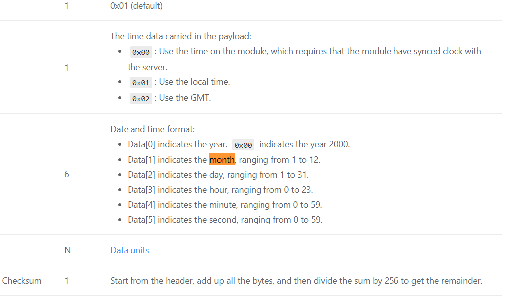

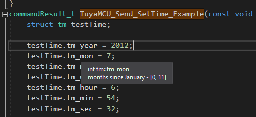

    In the following packet, the current date is being sent from WiFI module to TuyaMCU. We will also have to send that, but we have NTP.

    55 AA 00 00 00 00 FF 55 AA 00 00 00 00 FF 55 AA 00 08 00 00 07 55 AA 00
    03 00 01 04 07 55 AA 00 1C 00 08 01 16 0C 01 11 36 33 04 C5
    55 AA 03 00 00 01 00 03 55 AA 03 03 00 00 05 55 AA 03 07 00 14 06 00 00
    08 09 46 00 00 F9 00 00 3A 01 02 00 04 00 00 00 07 BB 55 AA 03 07 00 0C
    03 00 00 08 16 0C 16 0C 00 00 00 03 67 55 AA 03 07 00 0C 04 00 00 08 0C
    01 0C 01 00 00 00 03 3E 55 AA 03 07 00 06 0B 00 00 02 01 00 1D 55 AA 03
    1C 00 00 1E
    Requesting Historical Data
    55 AA 03 24 00 00 26 55 AA 03 07 00 0C 03 00 00 08 16 0C 16 0C 00 00 00
    03 67 55 AA 03 07 00 0C 04 00 00 08 0C 01 0C 01 00 00 00 03 3E 55 AA 03
    00 00 01 01 04 55 AA 03 07 00 14 06 00 00 08 09 52 00 00 FA 00 00 3B 01
    02 00 04 00 00 00 07 C9 55 AA 03 24 00 00 26
    55 AA 00 06 00 08 03 00 00 04 16 0C 16 0C 58 55 AA 00 06 00 08 04 00 00
    04 0C 01 0C 01 2F 55 AA 00 00 00 00 FF
    Home Assistant Integration: Reflashing BK7231N in Tuya Smart DIN-rail Energy Meter TAC2121C Home Assistant Integration: Reflashing BK7231N in Tuya Smart DIN-rail Energy Meter TAC2121C
    What are the next steps from here?
  • Packet dump shows TuyaMCU time sync and historical data requests
    #16 20319375
    Posts: 14791
    Rate: 12937
    Sorry for the delay, let me analyze the last packets dump.
    tomanyusers wrote:
    On Startup
    Here WiFi module sends time to TuyaMCU:
    1C 00 00 1E

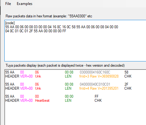

    There are dpIds, but it seems I have already described them above.
    Flash OpenBeken and we will try to prepare a config for this device, your help will be needed to test if it works ok.

  • LED control not responding after flashing

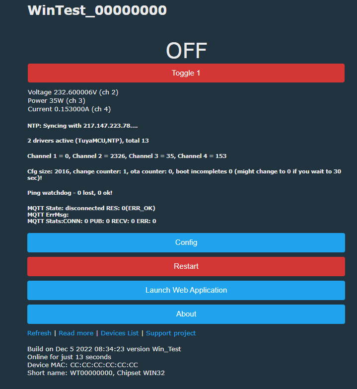

    #19 20319498
    tomanyusers
    Posts: 34
    Hi
    Flashed and added the autoexec.bat with the details.
    I am not able to toggle the LED from the web portal.
    Here are the logs:
    Info:TuyaMCU:TUYAMCU received: 55 AA 03 1C 00 00 1E
    Info:TuyaMCU:TuyaMCU_ProcessIncoming[ver=3]: processing command 28 (SetTime) with 7 bytes

    @tomanyusers does the BK toggle state changes when you toggle a physical switch?

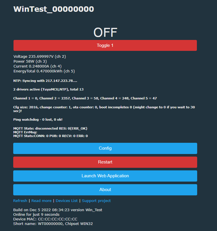

    Updated config:
    startDriver TuyaMCU
    startDriver NTP
    setChannelType 1 toggle
    setChannelType 2 Voltage_div10
    setChannelType 3 Power
    setChannelType 4 Current_div1000
    linkTuyaMCUOutputToChannel 16 bool 1
    // TAC2121C VoltageCurrentPower Packet
    linkTuyaMCUOutputToChannel 6 RAW_TAC2121C_VCP
    The packet used for simulator:
    "55AA03070014060000080916000099000023010200040000000310"
    Result in simulator:
    wait you need an update for that one, I will push changes to repo and do Release

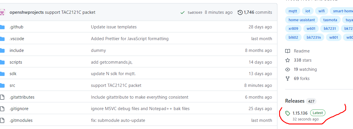

    This update:
    Please check, if nothing happens do a screenshot and I will add a command to send a request to get data (if that's the 0x08 packet)
  • TuyaMCU only sends heartbeat, no switch data
    #21 20319569
    tomanyusers
    Posts: 34
    No, the BK toggle state does not change when you toggle a physical switch.
    Still just getting the heartbeat every second. No other data is received.
    If I had to guess, it looks like the TuyaMCU is expecting something from the BK7231N at startup before it started sending other data. Like confirmation that the Wifi is connected or something...

    Added after 9 [minutes]:
    Have updated to the latest release.
    Here is the updated log.
  • Testing uartSendHex commands one by one
    #22 20319600
    Posts: 14791
    Rate: 12937
    It seems that you will have to do some testing yourself. It is surprising, because for Hiking meter here:
    https://www.elektroda.com/rtvforum/topic3928897.html
    no one reported the need to send something.
    The UART send command is this: uartSendHex
    Here is what you reported being sent do TuyaMCU on startup:
    Command expects argument in hex, without spaces.
    So try:
    // 0x08 packet type
    uartSendHex 55AA0008000007
    // wifistate 0x03 type
    uartSendHex 55AA000300010407
    // date - should be already send by OBK automatically?
    uartSendHex 55AA001C000801160B1D07302602C1
    // 0x24 type unk
    uartSendHex 55AA00240001C0E4
    try one by one and wait to see if something happens

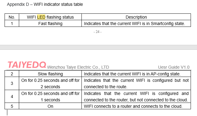

    I was able to find what needed to be sent to the meter to make it start reporting readings and toggle the relay. I have no idea what is in this command though.
    I was also able to determine that this command sets the Wifi Signal Strength on the LCD Display
    // 0x24 type unk
    The Voltage, Current and Power all match what is on the meter. Just the kWh that is still to be added.

    I only needed to send the command
    once and the meter sends through the readings every few min. It also seems to set the Status LED to On. Toggling the relay does not change the status LED.
    I have also picked up that the time on the meter is not updated.
    If I have a look at the logs:
    Info:TuyaMCU:TUYAMCU received: 55 AA 03 07 00 14 06 00 00 08 09 35 00 00 F8 00 00 3A 01 02 00 04 00 00 00 2F D1
    Info:TuyaMCU:TuyaMCU_ProcessIncoming[ver=3]: processing command 7 (State) with 27 bytes
    Info:TuyaMCU:TuyaMCU_ParseStateMessage: processing dpId 6, dataType 0-DP_TYPE_RAW and 8 data bytes
    Info:MQTT:Publishing val 2357 to BK7231N_TAC2121C_obk08734C21/2/get retain=0
    Info:TuyaMCU:TuyaMCU_ParseStateMessage: processing dpId 1, dataType 2-DP_TYPE_VALUE and 4 data bytes
    Info:TuyaMCU:TuyaMCU_ParseStateMessage: raw data 4 int: 47
    raw data 4 int: 47 is 0.47kWh.

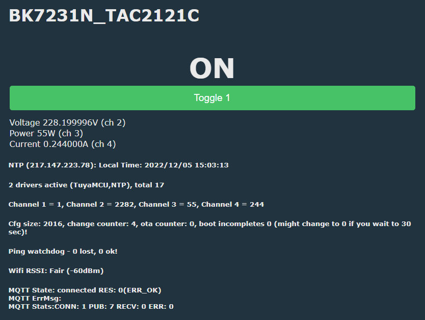

  • Updated TAC2121C script with energy and VCP mapping
    #26 20320571
    Posts: 14791
    Rate: 12937
    We can try to analyze more and figure out how to control that LED. Did you find anything else?
    You need to be more specific. What kind of time is shown?
    Wait for our NTP to get time and then use command:
    tuyaMcu_sendCurTime
    does it help? But it should be done automatically...
    Is that a total consumption, all time?

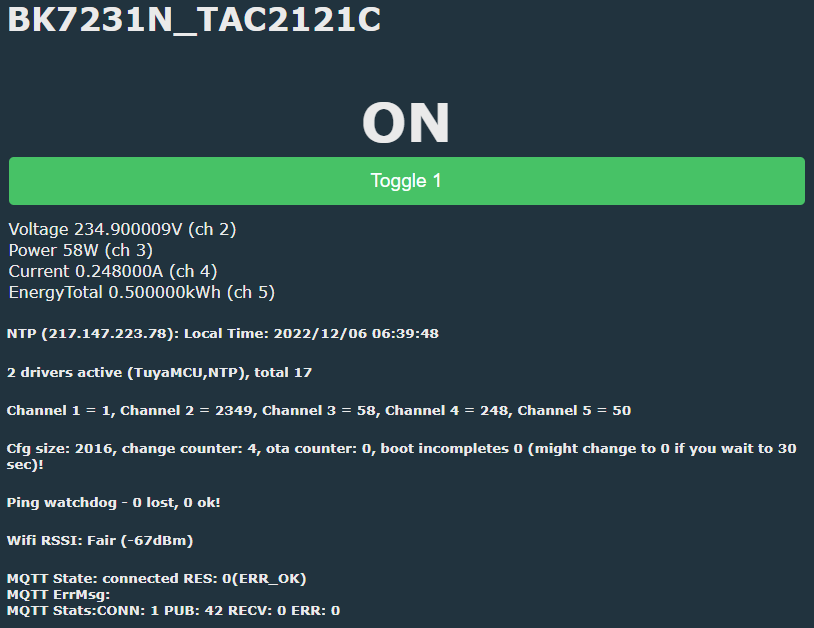

    See updated script:
    startDriver TuyaMCU
    startDriver NTP
    setChannelType 5 EnergyTotal_kWh_div100
    // link id 16 to channel 1
    // link id 1 to channel 5
    linkTuyaMCUOutputToChannel 1 val 5
    // This will automatically set voltage, power and current
    Expected result:
  • Energy total matches LCD after uartSendHex command
    #27 20320773
    tomanyusers
    Posts: 34
    With the latest code here is a screen result with the latest script and after sending "uartSendHex 55AA000300010407"
    The total kWh is always increasing and matches the LCD.

    At this stage, the date and time on the meter are not updated.
    After Sending The "uartSendHex 55AA000300010407" and "tuyaMcu_sendCurTime" commands here are the logs:

    Info:TuyaMCU:TuyaMCU_ProcessIncoming[ver=3]: processing command 0 (Hearbeat) with 8 bytes
    Info:TuyaMCU:TUYAMCU received: 55 AA 03 03 00 00 05
    Info:TuyaMCU:TuyaMCU_ProcessIncoming[ver=3]: processing command 3 (WiFiState) with 7 bytes
    Info:TuyaMCU:TUYAMCU received: 55 AA 03 07 00 14 06 00 00 08 09 27 00 00 F7 00 00 39 01 02 00 04 00 00 00 34 C6
    Info:MQTT:Publishing val 2343 to BK7231N_TAC2121C_obk08734C21/2/get retain=0
    Info:MQTT:Publishing val 247 to BK7231N_TAC2121C_obk08734C21/4/get retain=0
    Info:MQTT:Publishing val 57 to BK7231N_TAC2121C_obk08734C21/3/get retain=0
    Info:TuyaMCU:TuyaMCU_ParseStateMessage: raw data 4 int: 52
    Info:MQTT:Publishing val 52 to BK7231N_TAC2121C_obk08734C21/5/get retain=0
    Info:TuyaMCU:TUYAMCU received: 55 AA 03 07 00 0C 03 00 00 08 16 0B 16 0B 00 00 00 00 62
    Info:TuyaMCU:TuyaMCU_ProcessIncoming[ver=3]: processing command 7 (State) with 19 bytes
    Info:TuyaMCU:TuyaMCU_ParseStateMessage: processing dpId 3, dataType 0-DP_TYPE_RAW and 8 data bytes
    Info:TuyaMCU:TUYAMCU received: 55 AA 03 00 00 01 01 04
    Info:TuyaMCU:TUYAMCU received: 55 AA 03 07 00 0C 04 00 00 08 0B 06 0B 06 00 00 00 05 48
    Info:TuyaMCU:TuyaMCU_ParseStateMessage: processing dpId 4, dataType 0-DP_TYPE_RAW and 8 data bytes
    Info:TuyaMCU:TUYAMCU received: 55 AA 03 07 00 06 0B 00 00 02 01 00 1D
    Info:TuyaMCU:TuyaMCU_ProcessIncoming[ver=3]: processing command 7 (State) with 13 bytes
    Info:TuyaMCU:TuyaMCU_ParseStateMessage: processing dpId 11, dataType 0-DP_TYPE_RAW and 2 data bytes
    Info:TuyaMCU:TUYAMCU received: 55 AA 03 07 00 11 10 01 00 01 01 12 03 00 08 32 32 34 39 30 30 36 38 E9
    Info:TuyaMCU:TuyaMCU_ProcessIncoming[ver=3]: processing command 7 (State) with 24 bytes
    Info:TuyaMCU:TuyaMCU_ParseStateMessage: processing dpId 16, dataType 1-DP_TYPE_BOOL and 1 data bytes
    Info:TuyaMCU:TuyaMCU_ParseStateMessage: raw data 1 byte:
    Info:MQTT:Publishing val 1 to BK7231N_TAC2121C_obk08734C21/1/get retain=0
    Info:TuyaMCU:TuyaMCU_ParseStateMessage: processing dpId 18, dataType 3-DP_TYPE_STRING and 8 data bytes
    Info:TuyaMCU:MCU time to set: 1670310008
    Info:TuyaMCU:ptime ->gmtime => tm_hour: 7
    Info:TuyaMCU:ptime ->gmtime => tm_min: 0
    I manually set the date and time on the meter to:
    Date: 2022.12.06
    Time: 08:44:23
    Then Send "tuyaMcu_sendCurTime"
    The result on the meter is:
    Date: 2022.11.06
    Time: 06:46:23
    The time seems correct (Just need to add the time zone) I'm GMT+2
    Why the month changes I am not sure.
    On the Command:
    I have done some testing:
    -> Turn the LED ON.
    uartSendHex 55AA000300010306
    -> LED On for 0.25 seconds and off for 1 seconds
    uartSendHex 55AA000300010205
    -> LED On for 0.25 seconds and off for 2 seconds
    uartSendHex 55AA000300010104
    -> Slow flashing
    uartSendHex 55AA000300010003
    -> Fast flashing
    This aligns with the user manual.
    Looks like the TyuaMCU only start to send data when it thinks it's connected to the 'cloud'
    Added after 32 [minutes]:
    I did some testing on the Wifi signal strength indicator on the LCD. This is what I found.
    uartSendHex 55AA00240001FF23  - Sets 3 Bars
    uartSendHex 55AA00240001C0E4  - Sets 3 Bars
    uartSendHex 55AA00240001B1D5  - Sets 2 Bars
    uartSendHex 55AA00240001A2C6  - Sets 1 Bar
    uartSendHex 55AA0024000181A5  - Sets 0 Bars
    uartSendHex 55AA002400011E42  - Sets 0 Bars
    Did some testing and the xx in the below is the 2's complement of the RSSI. So -54dBm = CA
    uartSendHex 55AA00240001xx42

    #28 20323453
    Posts: 14791
    Rate: 12937
    This is very good job and very useful information, but it will take some time to process.
    The wrong month number might suggest that Tuya numbers months from 1 instead of from 0 and we have to add 1 while sending the date.... let me see...
    wait...
    Tuya uses 1-12 and tm structure is 0-11? So now that's solved, I pushed a fix:
    https://github.com/openshwprojects/OpenBK7231...mmit/e52ec34cc981973fca31eb7fa7cdc51990ac9bcb
    Can you check now?
    BTW: "uartSendHex 55AA00240001xx42" this will most likely not work (I mean replacing the 'xx' with test value) because you also have to recalculate the checksum of the packet, which is the last hex number here . Checksum changes with each change in the packet.
  • Keep TuyaMCU cloud-connected with periodic uartSendHex command
    #29 20323542
    tomanyusers
    Posts: 34
    Hi
    Using the version above, the date and time are now set correctly. But still, need to set the time zone. How do I do that?
    Did some more testing.
    The command "uartSendHex 55AA000300010407" needs to be sent every few hours to tell the TuyaMCU that it is still connected to the "cloud". So that the TuyaMCU will send through the readings. Seems to time out at around 6 hours.
    Also, "tuyaMcu_sendCurTime" only updated the time once the above command has been sent so that the TuyaMCU thinks it's connected to the "cloud"
    For setting the Wifi Signal Strength. I tested by using the following.
    Take the RSSI for the front web interface (eg -54), calculate the 2's complement (0xCA), and manually calculate the checksum and it works.
    "uartSendHex 55AA00240001CAEE"
    I also found a different menu on the meter and by doing the above I am able to see the RSSI displayed correctly on the meter.
  • TuyaMcu_sendRSSI command added for RSSI reporting
    #30 20332622
    Posts: 14791
    Rate: 12937
    Thanks, I have added a tuyaMcu_sendRSSI command with implementation. Check: "tuyaMcu_sendRSSI -80", etc
    When checked, we will need to somehow make it being send automatically to device.

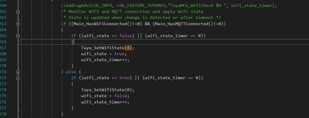

    By the way, are you sure that you have to send "55AA00 03 0001 04 07", the 0x03 version packet. WiFi status, yourself?
    There is already a function Tuya_SetWifiState in Obk and it's called according to MQTT/WiFi status....
