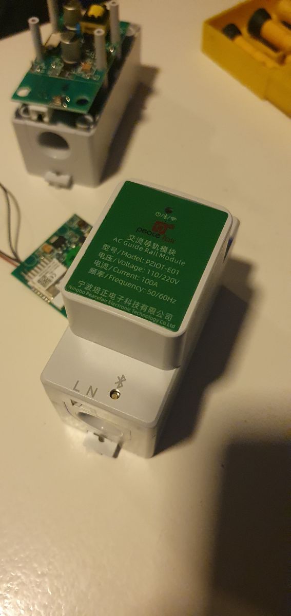

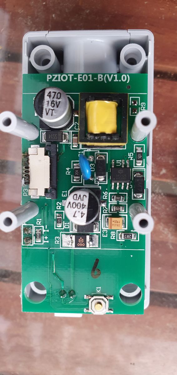

    So I just bought 4 Tuya Single Phase Energy Meter 6 In 1, and now have 3 left after blowing one up and nearly my house.
    Link here
    https://www.aliexpress.com/item/1005004967717....order_list.order_list_main.11.21ef1802jIFjLq
    They come with a CBU chip which I believe is based on the BK7231N.
    But, I seem to not be able to flash it. Not sure if I'm doing something wrong but would love to get these things into ESPHome.
    Thanks.

    Can you provide more information, show how have you connected the programmer, etc? How the board looks like?
    Maybe there is a TuyaMCU on the same board and it interferes with flashing?

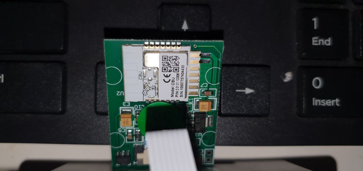

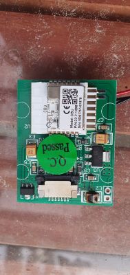

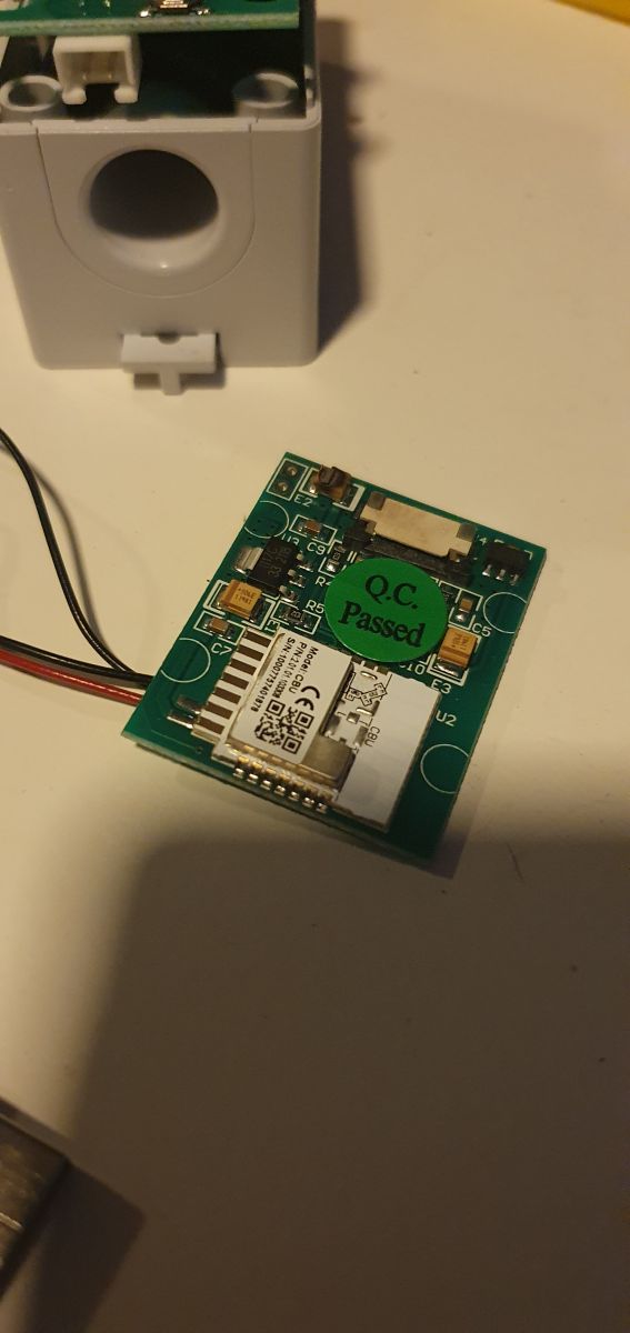

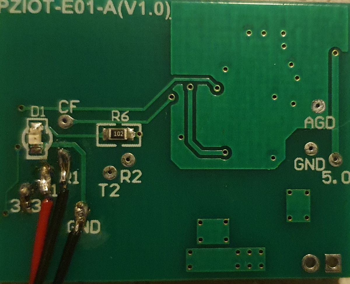

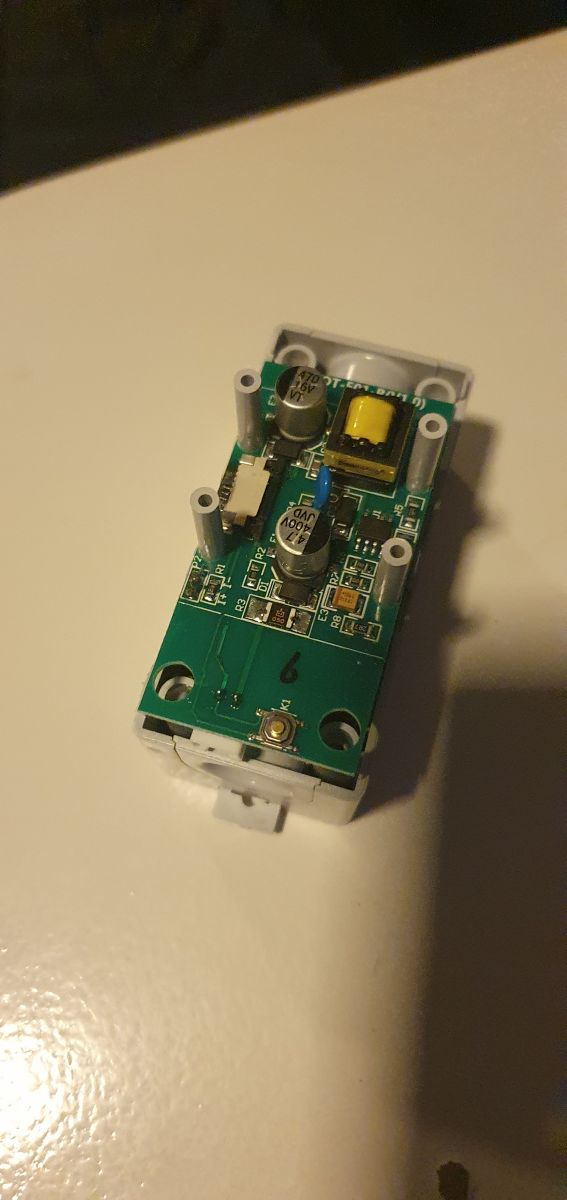

    The best I can do is these close-up photos.

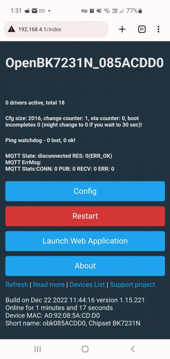

    Ok heres what I ran and here was the result.
    Still no AP.
    dean@Dean-PC:~/hid_download_py$ sudo python3 uartprogram OpenBK7231N_QIO_1.15.219.bin -d /dev/ttyUSB0 -r -s 0x0 -l 0x200000

  • #21 20350030
    deanfourie
    Posts: 45
    Boom, we're in business.

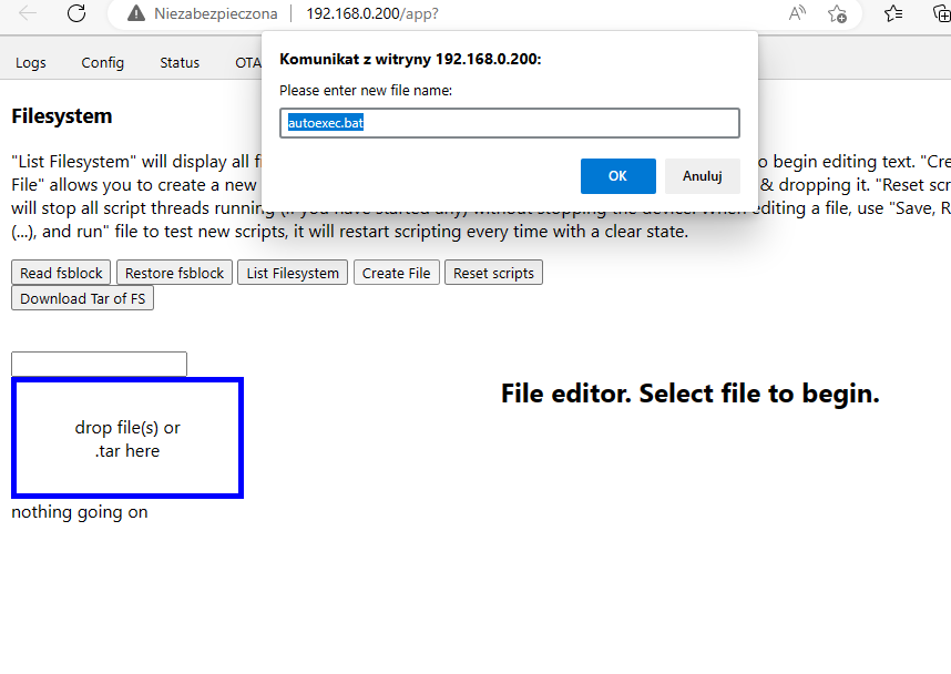

  • Request to identify TuyaMCU dpIDs and board ICs
    #22 20350155
    Posts: 14754
    Rate: 12875
    No, dont flash other devices yet, first we must configure your first device.
    This might be a TuyaMCU device.
    TuyaMCU devices are different between each other, use different dpIDs, etc. So each model requires a slightly different setup which we need to figure out.
    First, go to Launch Web Application, to LittleFS, create a file autoexec.bat and enter command:
    "startDriver TuyaMCU"
    Reboot your device and show me the packets from Web Application -> Logs, we need to know what TuyaMCU sends to us
    You are looking for something like this:
    Info:TuyaMCU:TUYAMCU received: 55 AA 03 07 00 08 01 02 00 04 00 00 00 04 1C
    Info:TuyaMCU:TuyaMCU_ProcessIncoming[ver=3]: processing command 7 (State) with 15 bytes
    Info:TuyaMCU:TuyaMCU_ParseStateMessage: processing dpId 1, dataType 2-DP_TYPE_VALUE and 4 data bytes
    Info:TuyaMCU:TuyaMCU_ParseStateMessage: raw data 4 int: 4
    We need to reverse engineer the dpIDs for that device.

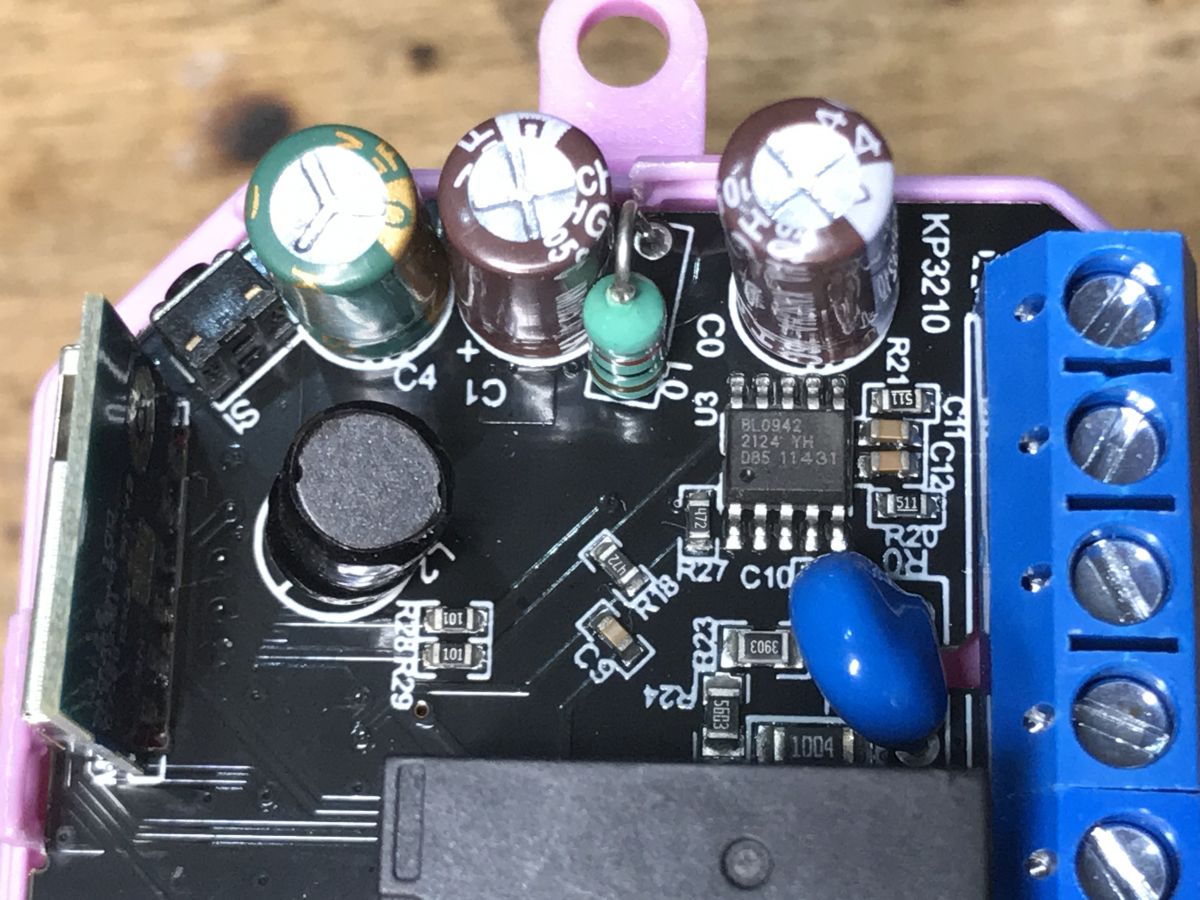

  • Suggesting BL0942 detection and driver test
    #24 20350261
    Posts: 14754
    Rate: 12875
    Please disconnect everything from serial and PC while doing things from mains! It would be very dangerous!
    I need to know what kind of power measurement chip is inside. Maybe that's even not a TuyaMCU, just a bare bones BL0937 or BL0942, that would be even easier to support.
    You can also try:
    1. remove "startDriver TuyaMCU" from autoexec.bat
    2. enter "startDriver BL0942" there
    3. reboot
    4. show me what kind of measurements you get
    but more reliable way would be to just read IC names....
    EDIT: Take a look into the spoiler photo, this is how BL0942 looks like. Is there such a chip in your device?
    Spoiler:
    Tuya Single Phase Energy Meter 6 In 1: CBU Chip Flashing & ESPHome Integration Issues

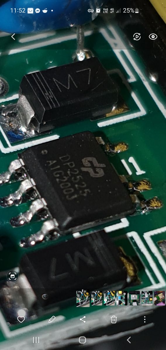

  • #25 20350304
    deanfourie
    Posts: 45
    I definitely don't see a chip with that many legs, on each side.
    Tuya Single Phase Energy Meter 6 In 1: CBU Chip Flashing & ESPHome Integration Issues Tuya Single Phase Energy Meter 6 In 1: CBU Chip Flashing & ESPHome Integration Issues
  • Request to identify the actual metering chip on the board
    #26 20350310
    Posts: 14754
    Rate: 12875
    Okay, so proceed with TuyaMCU test.
    You can also provide a list of chips on the board, because it has to measure the current/power/voltage somehow.
    If not BL0942, then maybe BL0937 or CSE?
    EDIT: I can see that you have updated your post with a photo. Very nice quality, btw. That's what we want! The chip you've shown is DP2525 and it's a power supply controller, it converts 110V (or 220V, idk which standard you use) to 12V or 5V or something like than.
    This is not the chip we're looking for, there might be something else as well.
  • #27 20350328
    deanfourie
    Posts: 45
    Check this video out. I honestly don't see any others.

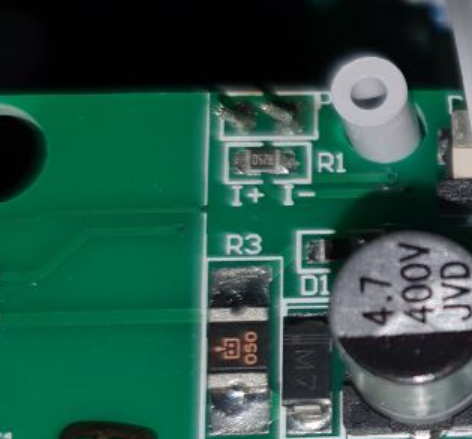

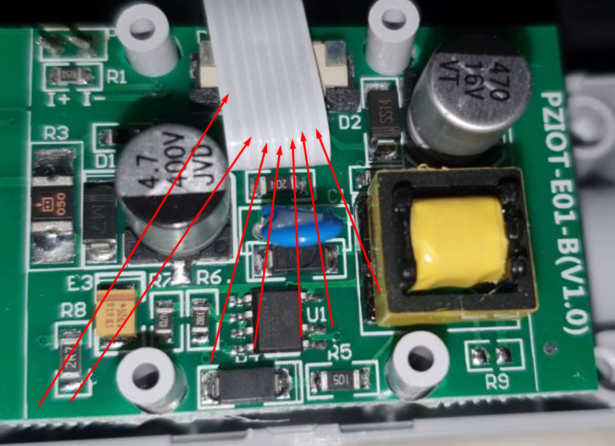

  • Requesting continuity test of CBU ribbon connections
    #28 20350365
    Posts: 14754
    Rate: 12875
    Maybe it's using a different method of measurement. We need to investigate.
    That I+ and I-...
    that markings made me think they are using current measurement transformer, but maybe I am wrong. I haven't found any such devices yet.
    Are you able to check with multimeter (in a continuity test mode, the beeper mode) which CBU module pads/signals are connected to the second board by that ribbon?
    TuyaMCU is here:
    but TuyaMCU is an external chip/MCU connect to UART lines (RXD1, TXD1) of WiFi module and I can't see any MCU on the photos/videos

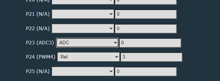

  • ADC3 P23 may be the current-sense input
    #30 20350427
    Posts: 14754
    Rate: 12875
    Exactly, that's what I said I suspect in my previous post.
    The I+ and I- markings:
    That I+ and I-...
    so we might do this just by using the ADC, but again, I need to you to determine the pinouts....
    Or maybe we can try guessing.
    5	ADC	I/O	ADC, which corresponds to P23 on the internal IC (Correspond to Pin 17 of the IC)
    Set in Configure Module:
    What kind of readings do you get?
    does ADC3 (P23) reacts to change in current?
