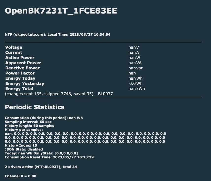

    I am new to this, so please bear with me.
    I have a Single Phase Din Energy meter which contains the WB3S and BL0937.
    I have flashed the module with 1.17.129 and configured the Pins (traced BL0937 pins back to MCU)
    (Will provide pictures and tear-down details when working!)
    All my energy values display NaN for all voltage, current, power values.
    Is this likely a configuration issue, or might I have introduced a hardware fault?

    Have you calibrated your device? Calibration can be done via GUI, go to Web App->Tools->see Calibration section, or do it in old style, VoltageSet, etc commands.
    Are the GPIOs correct?
    Please extract Tuya Config and attach it here for validation:

    Yes I have calibrated it, but seems to make no difference.
    The GPIO's are i think correct - the following is mapped:
      "vendor": "Tuya",
      "bDetailed": "0",
      "chip": "BK7231T",
      "board": "TODO",
      "flags": "0",
      "keywords": [
        "TODO",
        "TODO",
        "TODO"
      "pins": {
        "6": "WifiLED_n;0",
        "7": "Btn_n;0",
        "8": "BL0937CF1;0",
        "9": "BL0937CF;0",
        "24": "BL0937SEL;0"

  • Poor reflow on CF and CF1 pads caused issue
    #4 20596260
    nickhills
    False alarm - Apologies.
    In order to flash the WB3S i had to desolder it from the rest of the module (first time using a hot air station) It seems that when I flowed it back on both the pads used for CF CF1 had not reflowed properly.
    Your comment about the GPIO did prompt me to go back and recheck the connections though!
    Because i had traced the pin out on the system board before adding the WB3S back on, it made me wonder if my soldering had failed!
