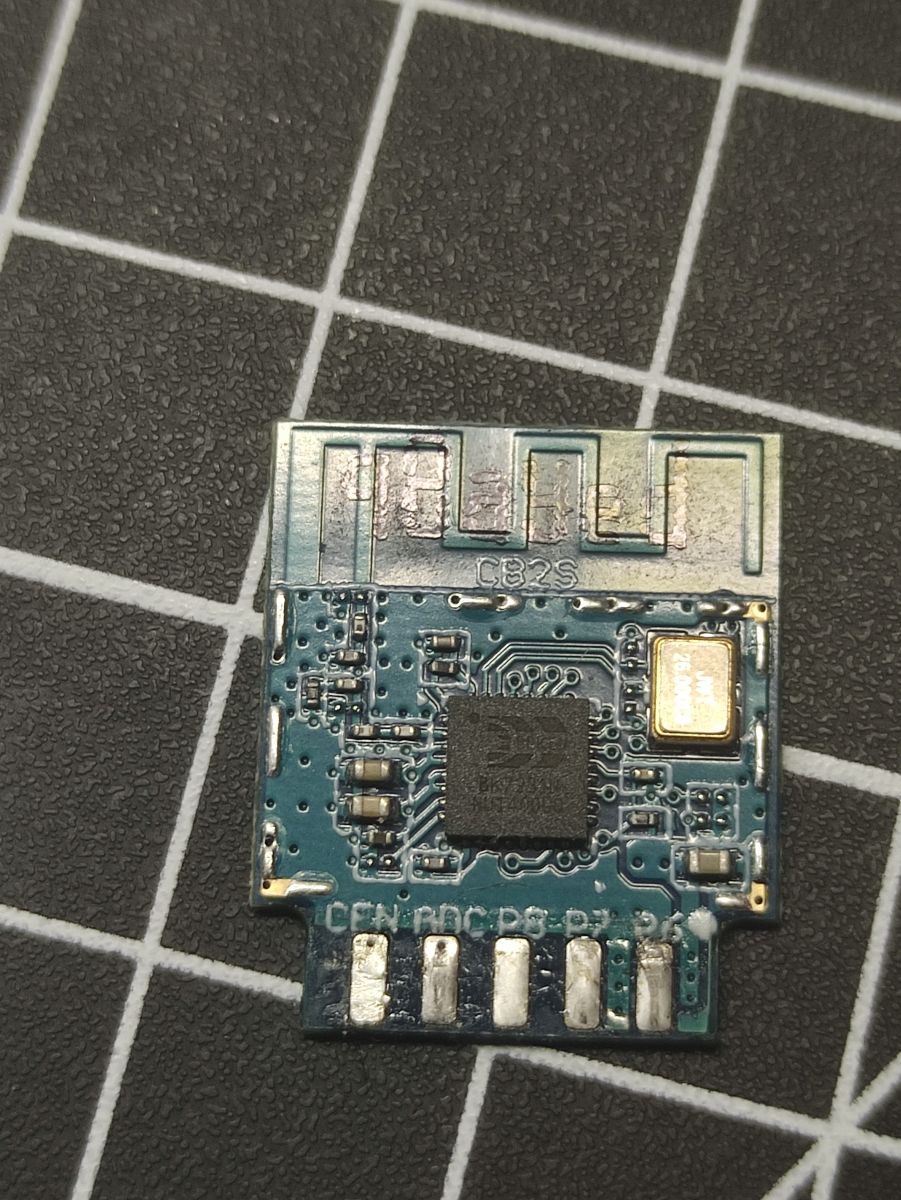

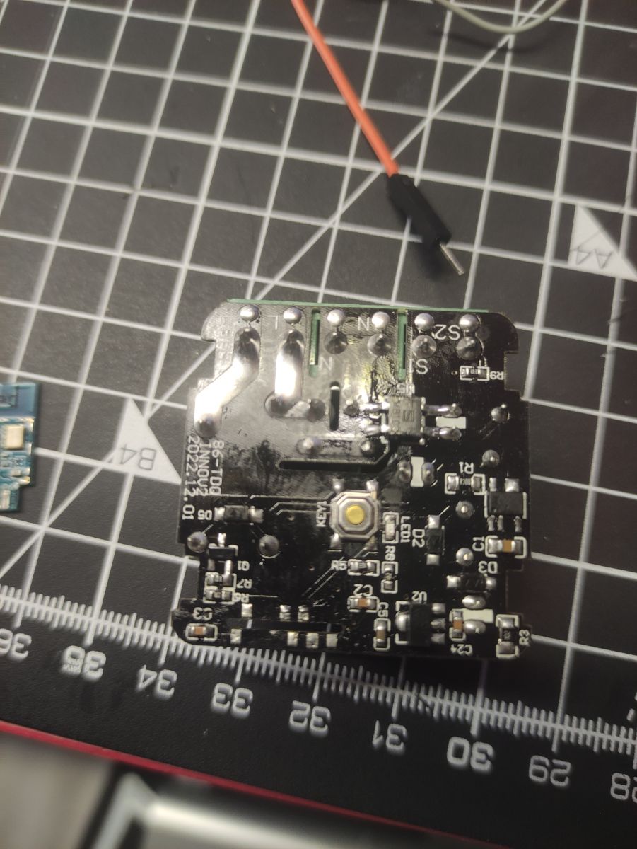

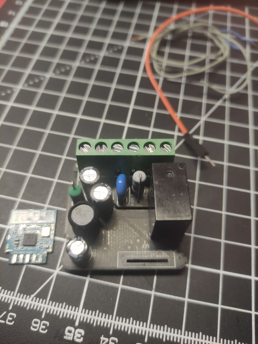

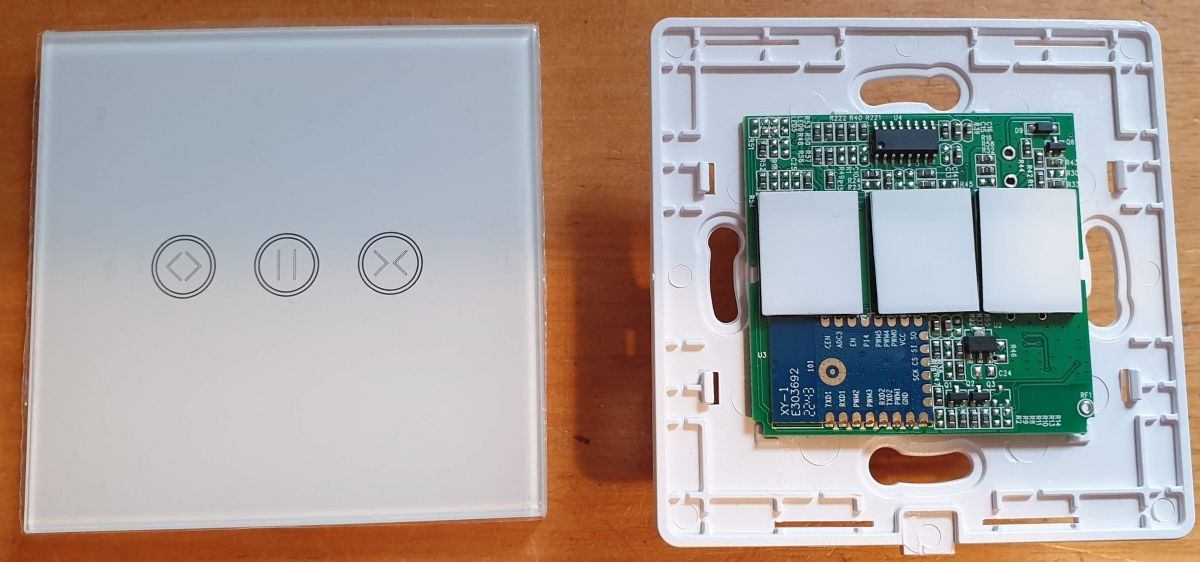

    I've flashed and partially configured a Smart Life Switch but I'm struggling with triggering scripts or backlog commands in the event of a button click. I'm familiar with Tasmota but have never used OpenBeken before.
    Here's the unit with the front panel removed:
    OpenBeken Configuring Open/Stop/Close buttons on a Smart Life switch
    Current configuration is Open btn, Open LED, Open Relay all on Ch 1, Stop btn & Stop LED on Ch 2, Close btn, Close LED and Close Relay all on Ch 3. No Channel Types have been set. I have an autoexec.bat file to label the buttons on the GUI and close the window.

    ATM I'd like it to behave like it did with the Tuya firmware.
    On Open btn click, it should ensure the Close Relay is not on, then turn on the Open Relay and Open LED for 10 seconds then turn both off, then it should turn on the Stop LED for 3 seconds. The Close btn should do the opposite. The Stop btn should turn both relays off (Either one could be on) then turn on the Stop LED for 3 seconds.
    So I just need a bit of help linking the btn clicks to some action. Also, should I use different channels for the buttons away from the relays/LEDs to stop any automatic linkage. I don't want both relays on at the same time as that could blow up the actual opener itself!

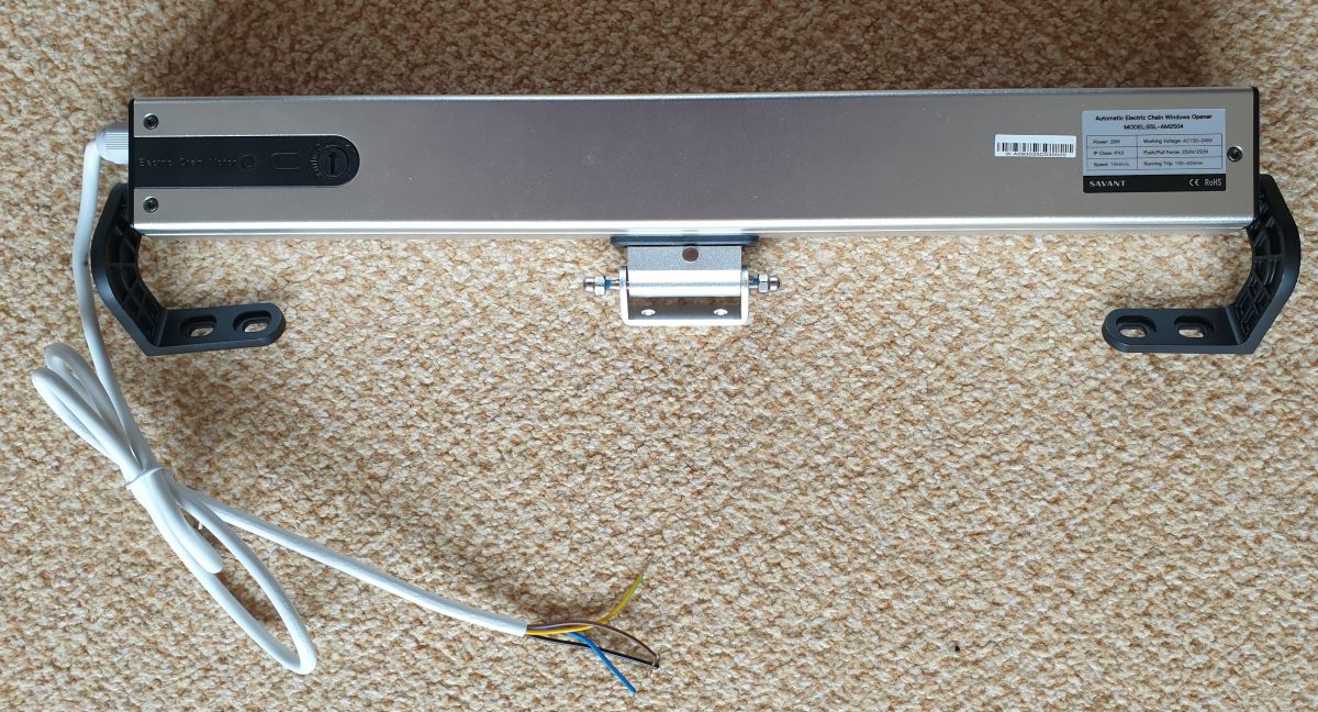

    Yes, It's a 'Shutter' in concept but in this case it is opening/shutting a Skylight.
    It's a 4 Wire system - Earth, Neutral, Live/Open and Live/Close. So i need either of the 2 Relays to be on but definitely not both. The way the switch operated with the Tuya firmware was that after about 10 seconds (presumably long enough for the window to be opened/closed, both relays went off (to save power and isolate the mechanism I guess).

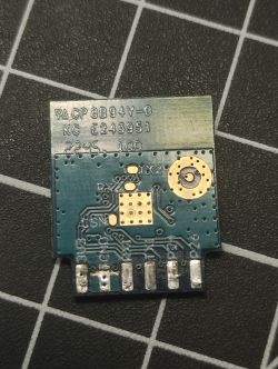

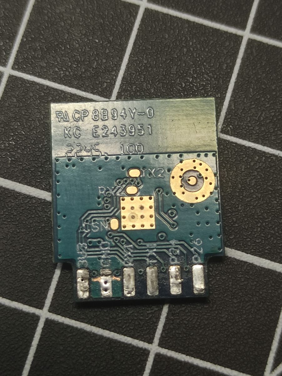

    OpenBeken Configuring Open/Stop/Close buttons on a Smart Life switch Hello, I have a cb2s module. I tried to enter the code to be able to use it as a shutter module by adding a second relay and a second push button, but it doesn't work for me. the code of the autoexec.bat is the following:

    But none of the outputs are activated.
    Please I appreciate any help

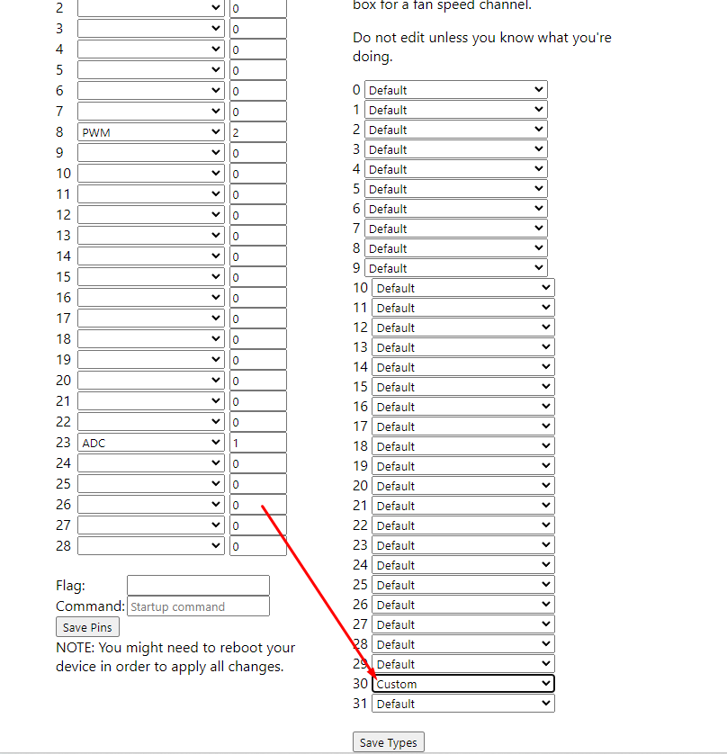

    Please edit post and use code tag to post code.

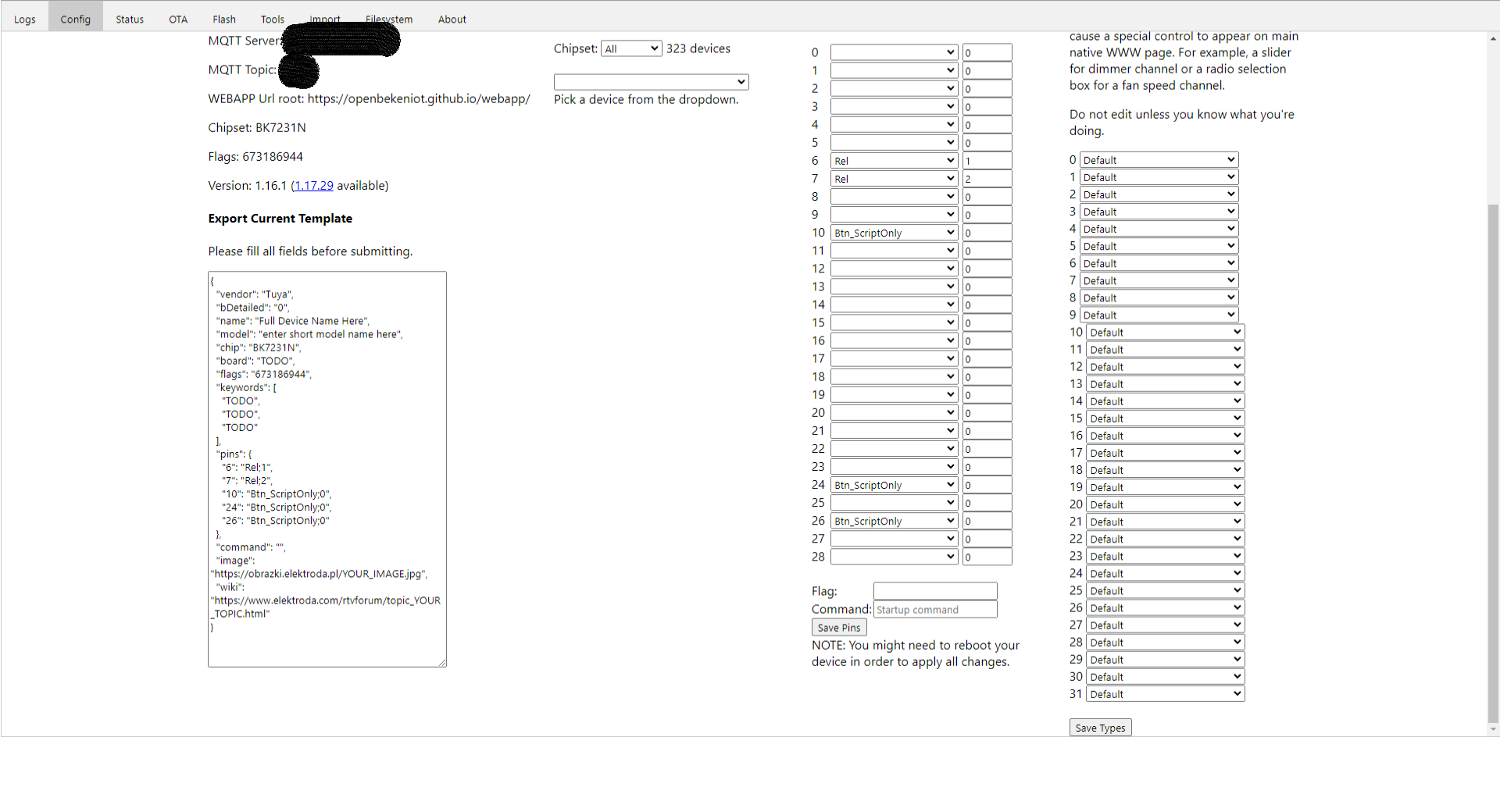

    Please attach some screenshot of your device pin configuration. Have you set the Relay roles for correct GPIOs and assigned the channels to them?
    Have you seen shutter tutorial?
    https://www.elektroda.com/rtvforum/topic3972935.html
  • #12 20552484
    mbolty
    Posts: 6
    Thanks, I had already read the post. I edited my post and added an image of the configuration and a part of the log.

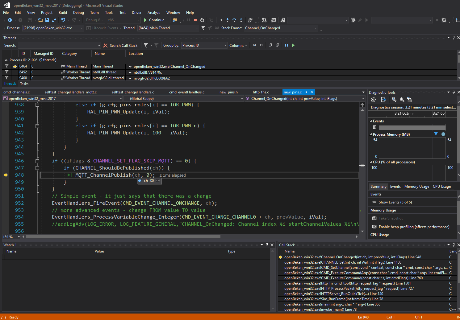

    Very good job,
    mbolty wrote:
    I only have one question, in the value of $CH60. The value could not be sent by MQTT by Home Assistant to be able to modify it according to the time of each motor?
    By default, channels are only send if they are used for basic IO, but this behaviour can be overridden.
    I will give you two methods:
    1. Just manually publish channel value
    addEventHandler OnChannelChange 30 publishInt myCustomValue $CH30
    2. You can also update OpenBeken to latest version, and then make sure you are using channel up to 31, and then in Web App change type:
    If you set type, for example to "Custom", Obk will know there is something in this channel and it will publish it when it changes.
    Keep in mind that you can also set any channel easily via MQTT.
    https://github.com/openshwprojects/OpenBK7231T_App/blob/main/docs/mqttTopics.md
