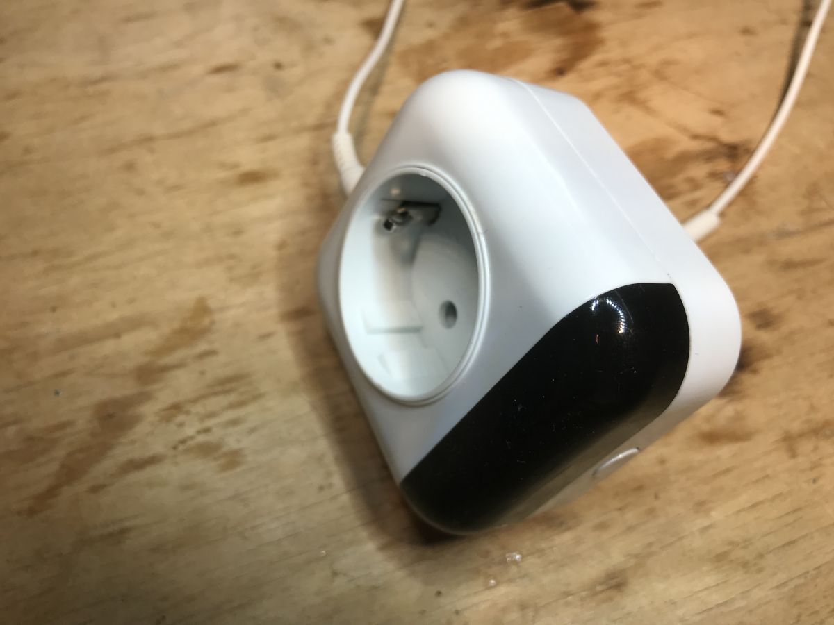

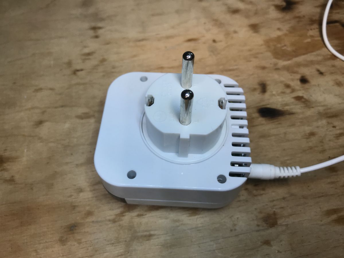

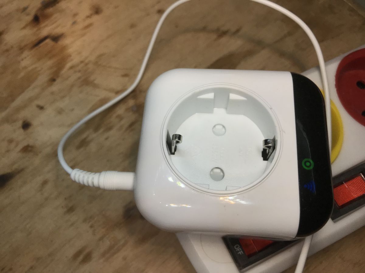

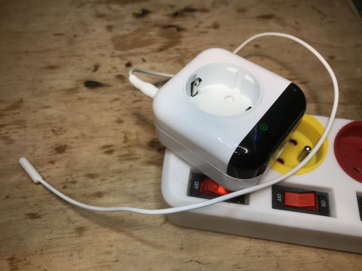

    For this topic I used a TuyaMCU BK7231N thermostat (relay+external temperature probe) device, but in this case I will focus mostly on the relay control:
    TuyaMCU socket adapter on a wooden table Smart electric socket with an external temperature probe. Smart plug connected to a power strip White electric plug adapter on a wooden surface.

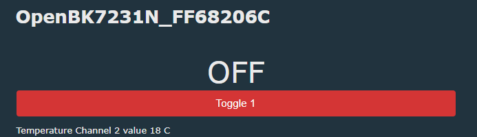

    So, let's setup this in OBK. Create autoexec.bat in LittleFS:
    // start TuyaMCU driver
    startDriver TuyaMCU
    // set TuyaMCU baud rate
    tuyaMcu_setBaudRate 115200
    // set TuyaMCU default wifi state 0x04, which means "paired",
    // because some TuyaMCU MCUs will not report all data
    // unless they think they are connected to cloud
    tuyaMcu_defWiFiState 4
    // set channel 1 to display toggle
    setChannelType 1 Toggle
    // Map given dpID to channel 1, dpID type bool
    // linkTuyaMCUOutputToChannel [dpId][varType][channelID]
    // channel 2 will be temperature
    setChannelType 2 temperature
    // Map given dpID to channel 2, dpID type value
    linkTuyaMCUOutputToChannel 24 val 2
    Save and reboot, you will get the following controls:
    OpenBeken control interface screen with temperature information.
    But that's just the beginning...

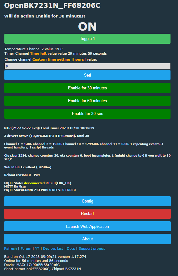

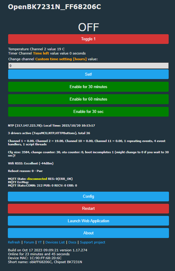

    Here is how it looks on OBK page:
    OpenBeken interface screen with TuyaMCU settings and timer
    OpenBK7231N interface page with relay enabled for 30 minutes.
    Each button is fully functional. The timer is automatically refreshed and formatted. The custom delay also works, it can be set either via OBK page or via Home Assistant. The countdown timer can be also accessed in Home Assistant if you write custom yaml to listen to countdown variable channel.

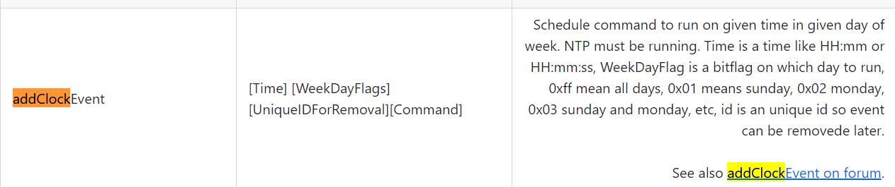

    Linking the behaviour of the relay to the current time
    It is also possible to relate relay behaviour to the current time we've got from NTP. There are two ways to do that:
    - use addClockEvent:
    Section of documentation about the addClockEvent function in OpenBeken.
    This can be used to run any script at given time of given day of week.
    - use $hour or $minute variable and check its value with if conditional expression

How do I use NTP time in OpenBeken to control a relay by schedule with addClockEvent, $hour, or $minute?
Start the NTP driver, then trigger actions either with addClockEvent or by checking $hour and $minute in script conditions. The thread gives two methods: scheduled script execution at a given time and day of week, or direct checks against clock variables. 1. Add startDriver NTP. 2. Use addClockEvent for fixed schedules. 3. Use if with $hour or $minute for custom time logic. [#20777858]
