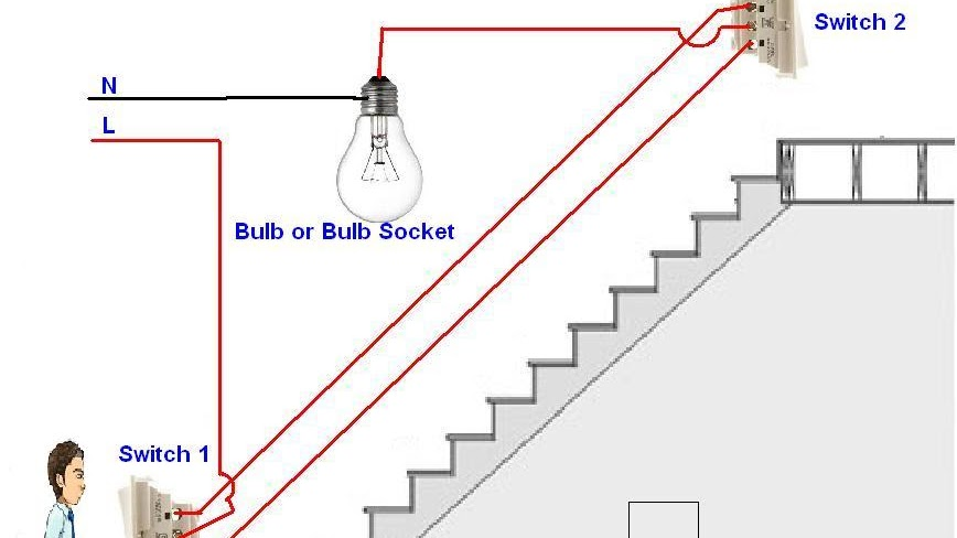

    Hello, I would need some more information about the device because I am not yet sure what exactly is the issue.
    Is your device a stairs switch, the switch where one bulb is connect basically to two switches and it's not possible to simply tell whether the bulb is on by checking the single relay state?
    And you are using it indeed in the 3-way switch configuration?

    Yes, the device and wiring are as in the stair switch picture you posted. The "main / smart switch" is switch 1 in the picture and the "dumb switch" is switch 2 in the picture. The relay state does not change on the device when the light bulb is actuated by the "dumb switch". The sensor in HA that tracks dInput_n on PIN 26 does show the actual state of the light bulb.

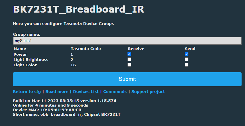

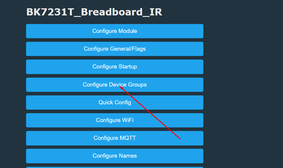

    SOLUTION 2 - link switches by device group
    On switch A, change Relay role to AlwaysLow
    On both switches, setup two-way DGR:
    OpenBeken for Treatlife 3-way switch - how to setup stairs switches pair in OBK
    DGR should be a bit better, because first solution may not sync-back the state of second switch in the current state of my script.
    What do you think about those solutions, do they fit your use case? If not, we can think about one more way to solve the problem.

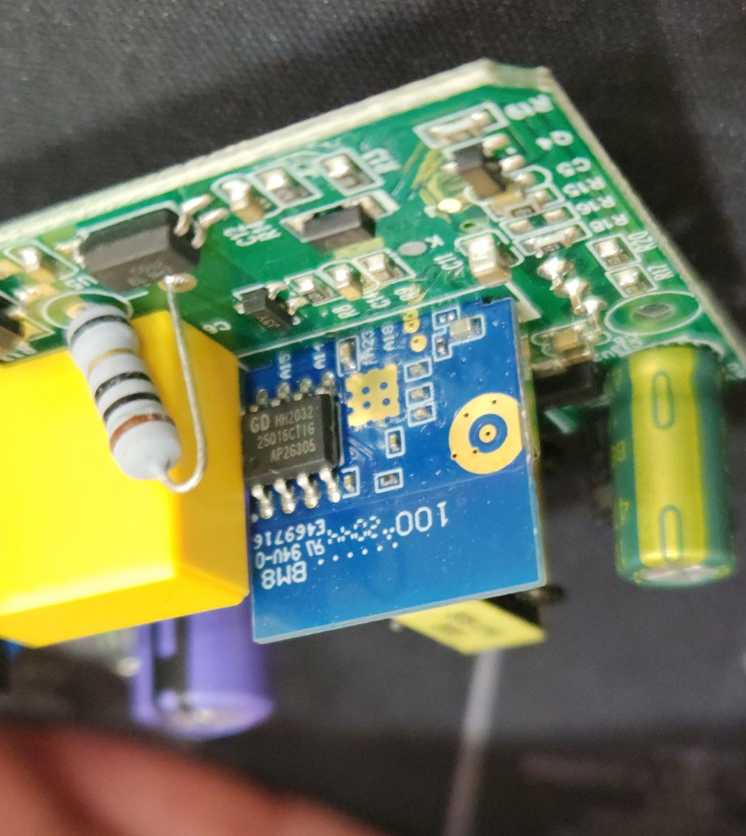

    I just got a 3-way switch but came with WR2E
    I see an IC on the back of the WIFI module and I was wondering if this chip has something to do with the 3-way function.
    Because the switch claim to work with regular mechanical 3-way switch.
    the marking in the chip
    GD HH2032
    25Q16CTIG
    AP26305
    I still haven't flashed openbeken yet.
