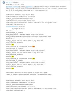

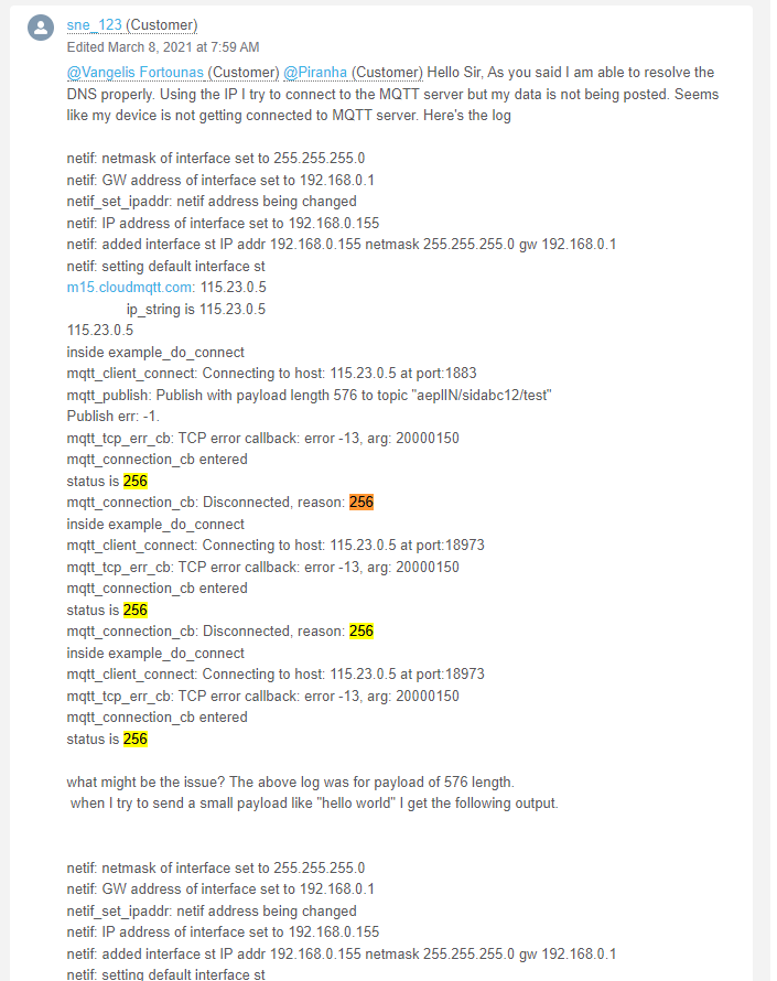

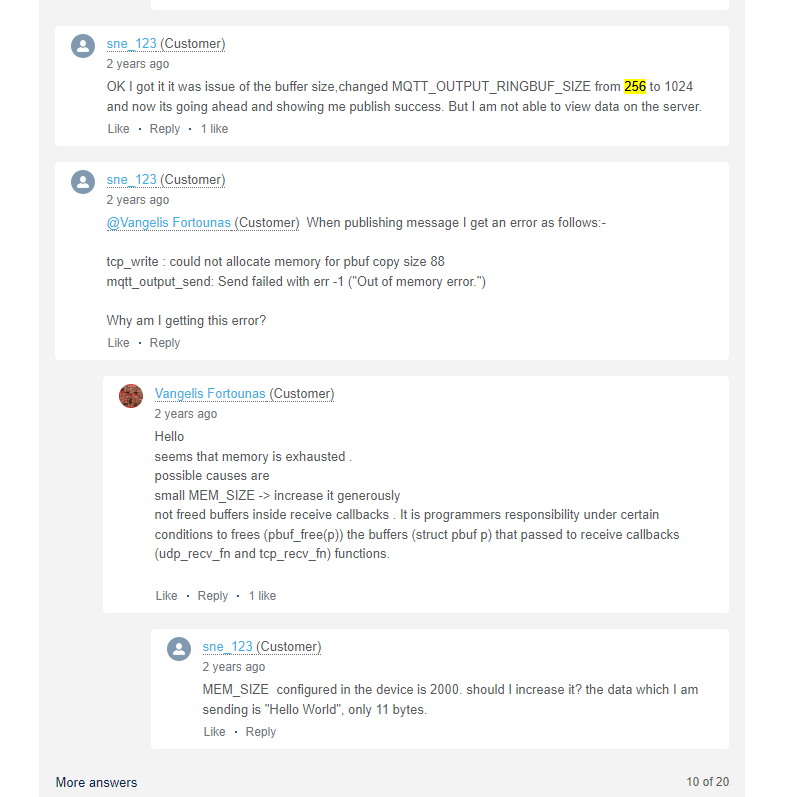

    Kuled Smart Switch MQTT Disconnect Issue: OpenBeken v1.17.14, Reason 256, IP 192.168.0.50:1883
    They suggest increasing LWIP memory size, but I think we already allocated enough on LWIP:
    And it happened to you randomly... hm please report here if anything else strange happens with your MQTT
