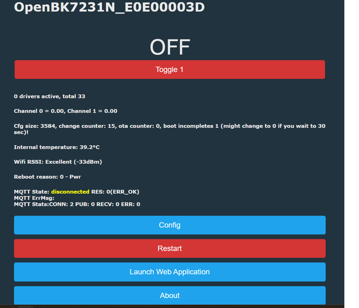

    Hello everyone,
    I’m a beginner in this field, and I’ve recently updated my smart relay switch (it’s a module like this one: https://www.elektroda.com/rtvforum/topic3912748.html) to OpenBK7231 (OpenBeken). I followed this guide to flash it.
    After configuring the Wi-Fi and everything else, I can access the device through its IP address. However, I’m having trouble connecting it to the MQTT broker in Home Assistant.
    I’ve double-checked the MQTT settings: username, password, and port are all configured correctly, but it still won’t connect.
    Could this be a problem with my router, or does it not play a role in this communication?
    Thanks in advance for your help!
    Screenshot of the OpenBK7231N user interface showing the device status as off and disconnected from MQTT.

    Info:GEN:dhcp=0 ip=192.168.1.135 gate=192.168.1.1 mask=255.255.255.0 mac=b8:06:0d:e0:e0:3d
    Info:GEN:sta: 1, softap: 0, b/g/n
    Info:GEN:sta:rssi=-35,ssid=MIWIFI_YppT-EXT,bssid=0c:0e:76:98:b0:5f,channel=2,cipher_type:CCMP
    Info:MAIN:Time 331, idle 183931/s, free 74904, MQTT 0(20), bWifi 1, secondsWithNoPing 261, socks 2/38
    Info:MAIN:Time 332, idle 192015/s, free 74904, MQTT 0(20), bWifi 1, secondsWithNoPing 262, socks 2/38
    Info:MQTT:mqtt_userName homeassistant
    mqtt_pass __**password_not_changed**__
    mqtt_clientID SWITCH_RELAY
    mqtt_host 192.168.1.131:1883
    Info:MAIN:Time 333, idle 187124/s, free 74816, MQTT 0(21), bWifi 1, secondsWithNoPing 263, socks 2/38
    Info:MQTT:mqtt_connection_cb: Disconnected, reason: 5(Refused not authorized)

    Mosquitto credentials likely causing MQTT authorization failure
    #2 21320058
    kaplanroger
    Posts: 10
    >>21318067
    It looks like your MQTT username/password is not being accepted:
    Check your Mosquitto configuration in Home Assistant (Settings->Add Ons->Mosquitto Broker->Configuration Tab)
    I also recommend downloading MQTT Explorer https://mqtt-explorer.com/
    That will let you connect directly to the Mosquitto broker, which will let you validate whether your MQTT credentials are correct or not, and take OpenBK out of the loop.

    It’s working now! I thought it was the MQTT broker’s username and password, but it turned out to be the credentials for logging into Home Assistant.
