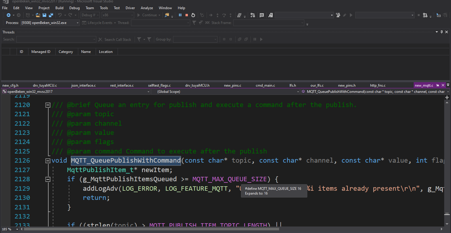

    And are you connecting to Home Assistant via MQTT Discovery?
    Raised MQTT message limit to 32 for more relays
    #6 20928467
    Posts: 14771
    Rate: 12914
    So are you talking about Hass Discovery?
    As far as I can see there is a limit of 16 messages, why aren't you reporting that an error was showing up in the log?
    Screenshot of a program code in Microsoft Visual Studio showing the MQTT_QueuePublishWithCommand function, with the queue limit increased to 32.
    I increased the limit to 32:
    https://github.com/openshwprojects/OpenBK7231...mmit/168334343e3c74ad3c6add39fbc515bef6e53f61

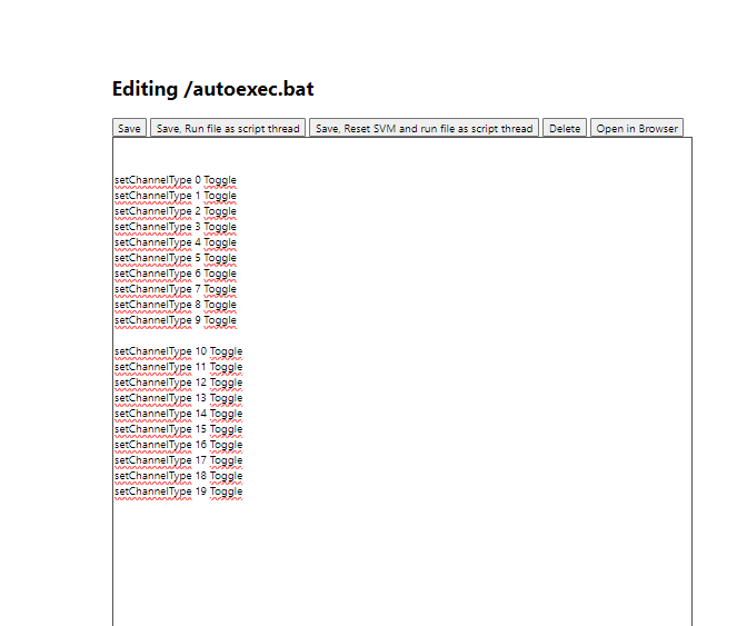

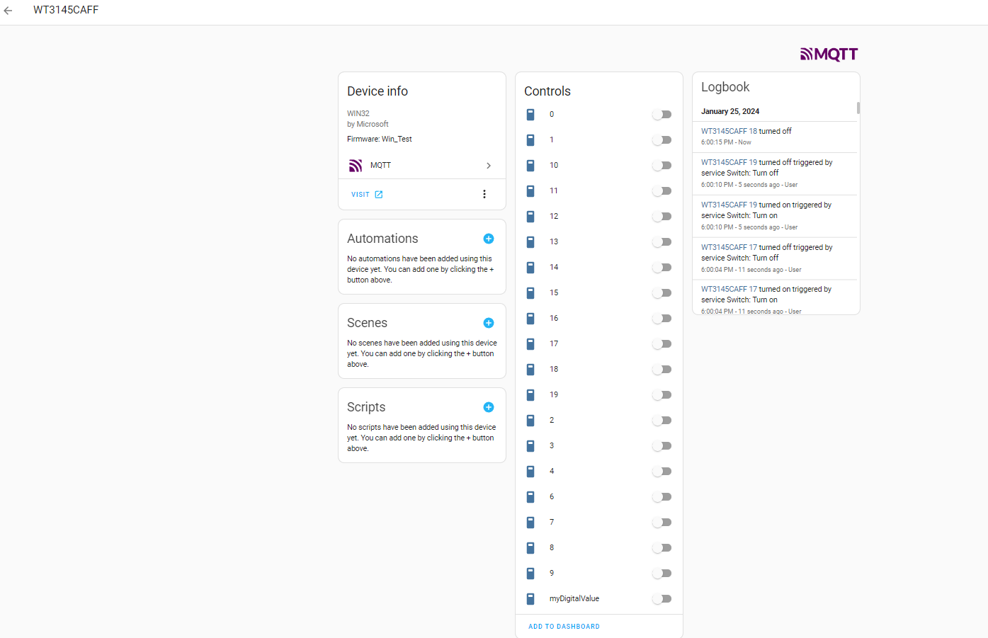

    Now it works for me - there are 20 relays:
    Screenshot of a user interface displaying device information and controls. Screenshot of editing /autoexec.bat with a list of setChannelType commands and a save button. Screenshot of editing /autoexec.bat with a list of setChannelType commands and a save button.
