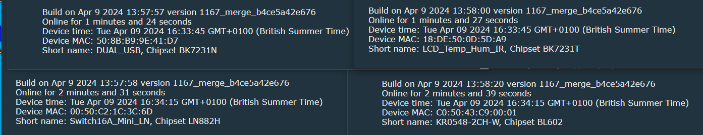

    There are some cons, especially that NTP will keep the clock accurate, which I learned was not the case with my first approach.
    But, there are some pros:
    No need for a network: You can set and use time even in the AP mode
    No need for NTP protocol
    The first approach was very simple and needed only very limited resources.
    And finally: you usually don't need exact clock: If the sum of energy values for one day is inaccurate for some seconds, who cares?

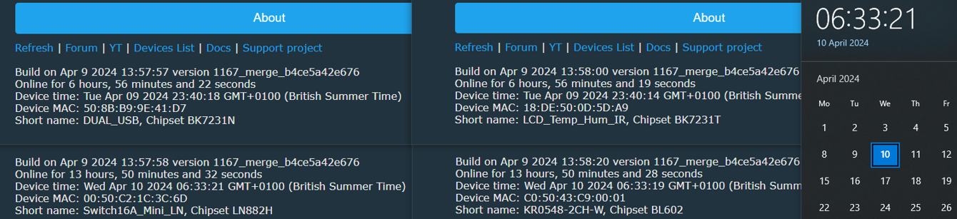

    O.k., lets finally get to the basic idea:

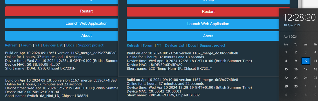

    If I only add one simple variable containing the "time at startup", I can calculate the actual time by adding the value of g_secondsElapsed.

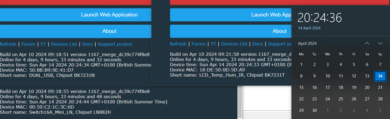

    This worked as expected - for some short time - but in my case it was drifting ~ 2 minutes per day :-(.
    So my first improvement was: making g_secondsElapsed more accurate (requiring two further variables):
    Every ten seconds I calculate the number of RTOS ticks elapsed and update g_secondsElapsed to this value.
    Now time is o.k. for me - it differs about 1 to 2 seconds a day, I can live white this, and maybe a correction can make it even better.

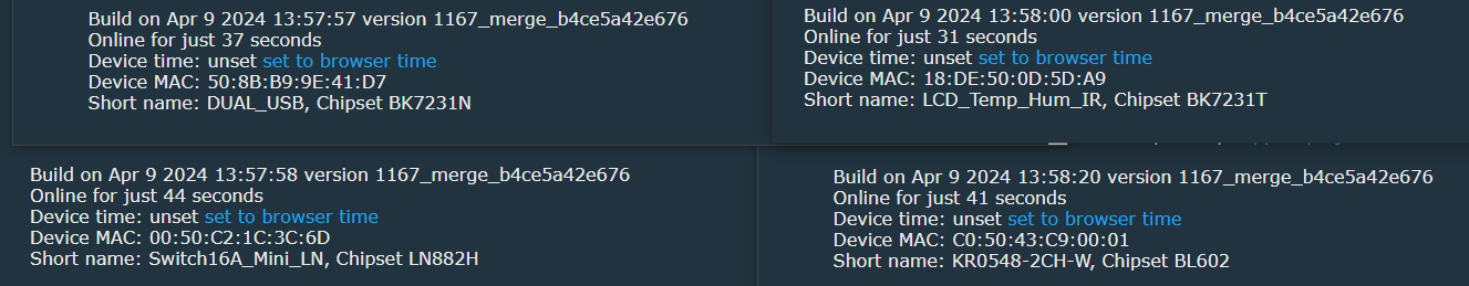

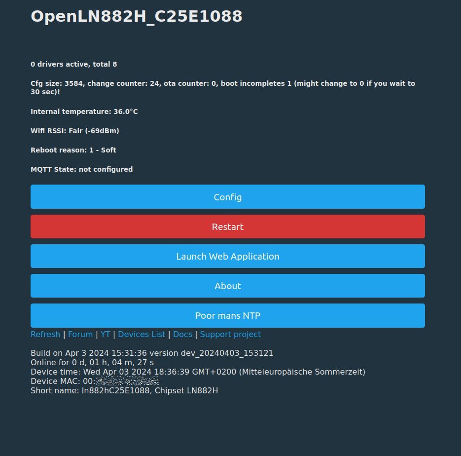

    Actual screenshot of "index" page:
    Screenshot of the OpenLN882H user interface.

  • #5 21032907
    max4elektroda
    Posts: 758
    Help: 49
    Rate: 189

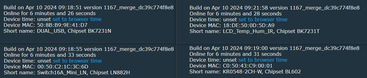

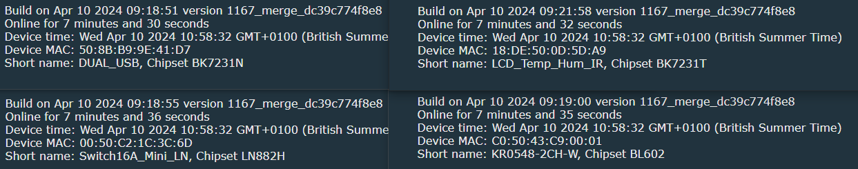

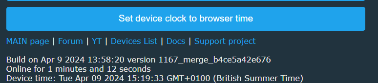

    I just made PR#1167.
    Please note that as requested the function is disabled, so to see and check it, you would need to change the #defines in
    obk_config.h and compile it again.
    I used ENABLE_LOCAL_CLOCK for basic usage and ENABLE_LOCAL_CLOCK_ADVANCED to also use daylight saving time calculation (requiring ENABLE_LOCAL_CLOCK to be set ;-)).

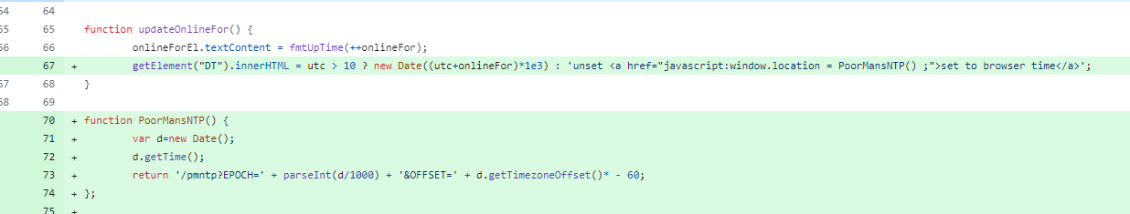

    Is this fragment always executed, or only if local time keeping is enabled?
    JavaScript code snippet with a function for updating and setting the time.

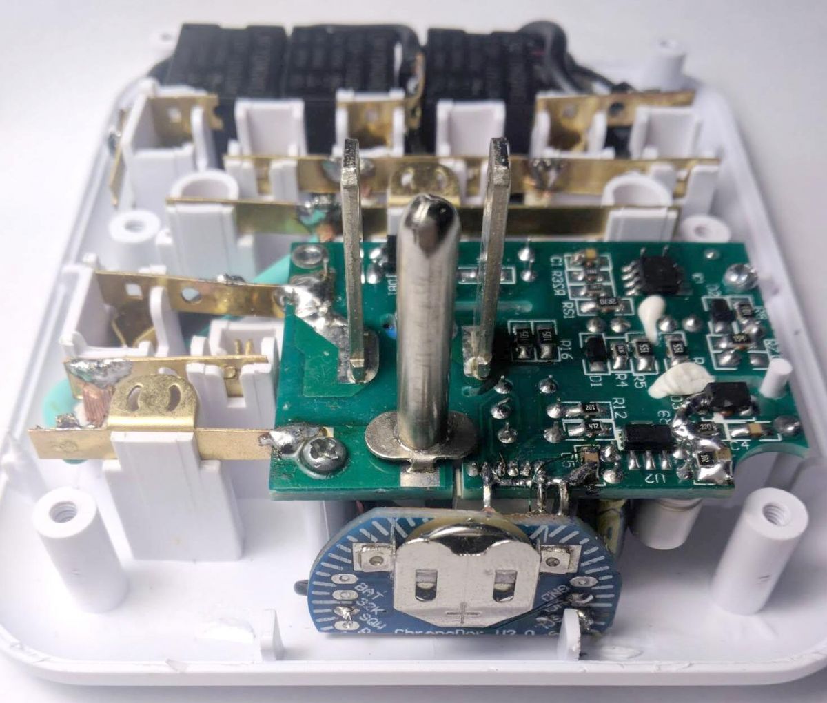

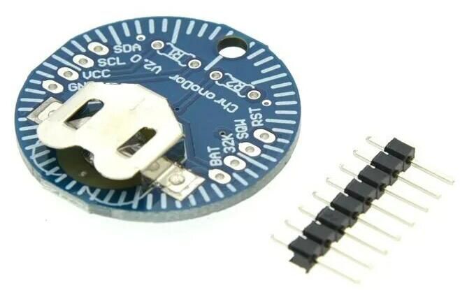

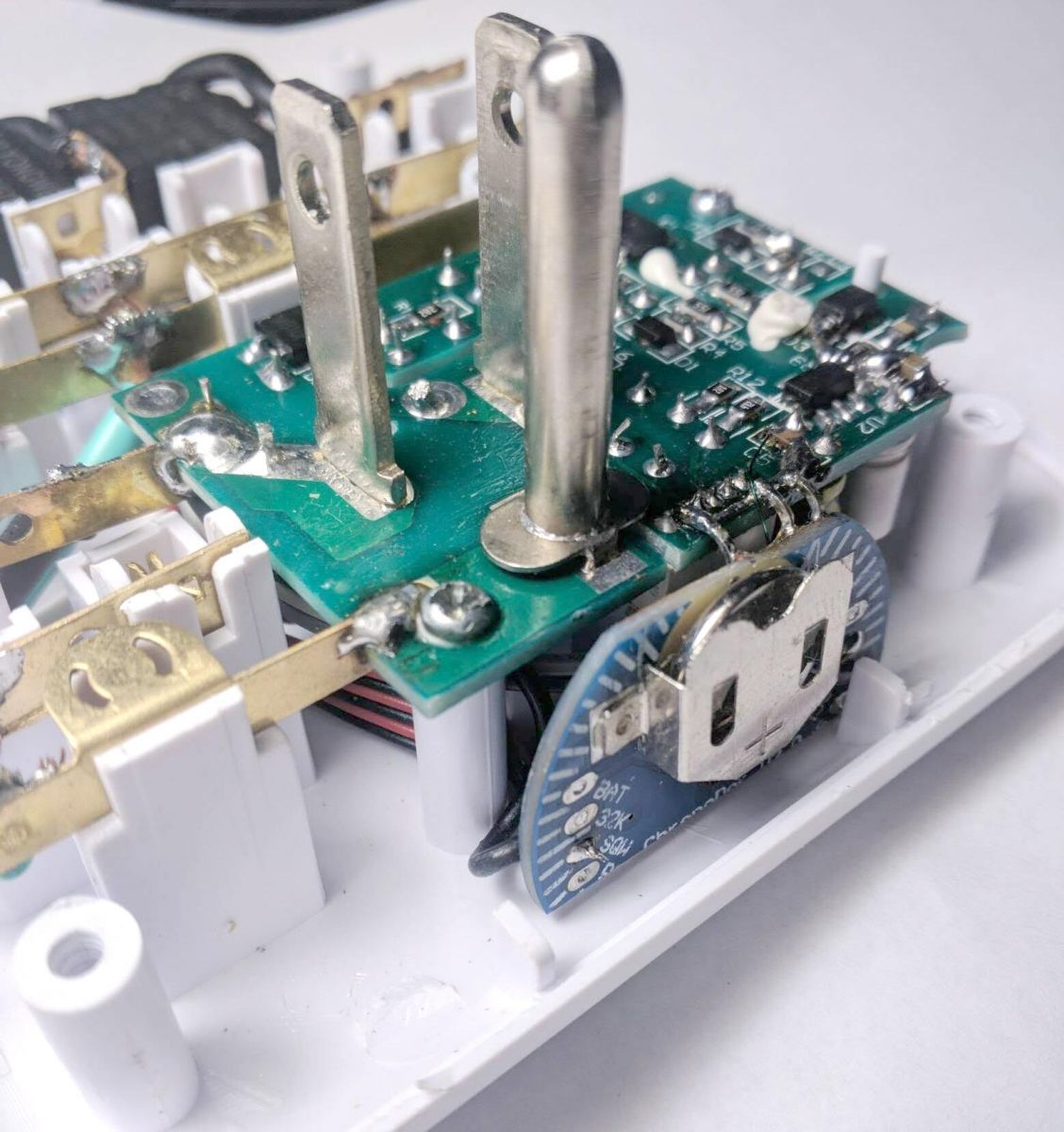

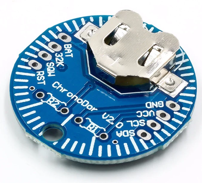

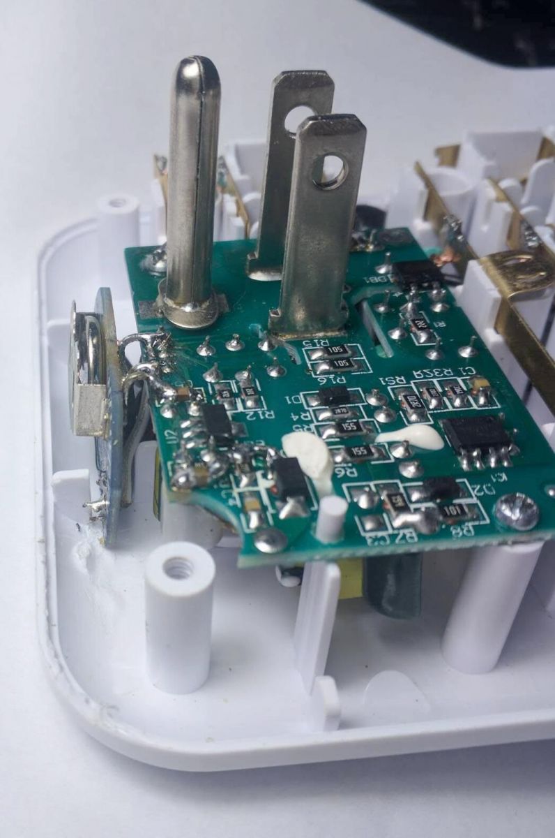

    #7 21034483
    omniron
    Posts: 114
    Best solution to all NTP related issues would be to use an RTC.
    Here I added the DS3231 to a KMC 4AC Power Monitoring unit (30608).
    How to Implement a Clock in OpenBeken Devices Without Using NTP Protocol How to Implement a Clock in OpenBeken Devices Without Using NTP Protocol How to Implement a Clock in OpenBeken Devices Without Using NTP Protocol How to Implement a Clock in OpenBeken Devices Without Using NTP Protocol How to Implement a Clock in OpenBeken Devices Without Using NTP Protocol
    With such an RTC the accurate (a minute in a year) time can be queried without opening the units to the internet or having internet running at all.

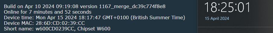

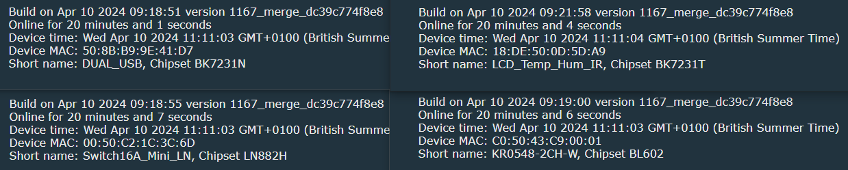

    Sorry, I'm quite busy this weekend and will be on a business trip next week, so just a few words:
    I think I didn't make it clear enough: I would really appreciate some feedback before merging it.
    Will it work on other platforms as expected?
    How accurate is the time for some days?
    What would others say on how should daylight saving time be implemented?
    With a table, like in the actual PR? This means, it must be adjusted to the timezone on compile time - or changed to variables, that could be added during the run.
    If we changed to a calculation we would be much more flexible but this will "cost" quite some code/space in the image.
    Yes, that's one of the drawbacks I pointed out: Javascript is not inside an "#if" statement.
    If this is a blocking point: No problem, I will move the JS code inside the HTML part, which can be controlled with an #if, but I think it will be next weekend ...

    The "clock" as implemented here, is visible on the GUI and also in the answer to a STATUS request.
    But as the defines in obk_config.h are set to 0, the clock would miss initializing.
    (There is no entry "set clock to browser's time" on the bottom of the config menu page and the link on the status page is misleading because the function to actually set the clock is missing).
    If it's ok, I could make the git system build images with this feature enabled.
    Just give me a hint if it would be better to commit a simple change for this to the existing PR or it should be better a "Testing PR", just to provide the images, that can be deleted if no longer needed.
    BTW, in a later version your suggestion would work, if accepted: the time, once got by NTP, could be handled like a manual clock setting and the clock would run, even if NTP is stopped.

    Made a change to the PR so that the features are enabled in obk_config.h
    So it should be easy to use the generated images for some testing:
    Link to artifacts
    #18 21038935
    Posts: 5220
    Help: 449
    Rate: 918
    yay.
    will set some devices up with no internet access, no ntp driver or other drivers running and powersave 0.
    it begins
    Screenshot of a device settings interface with a button labeled Set device clock to browser time.

  • Browser time display may be cached after refresh
    #20 21039030

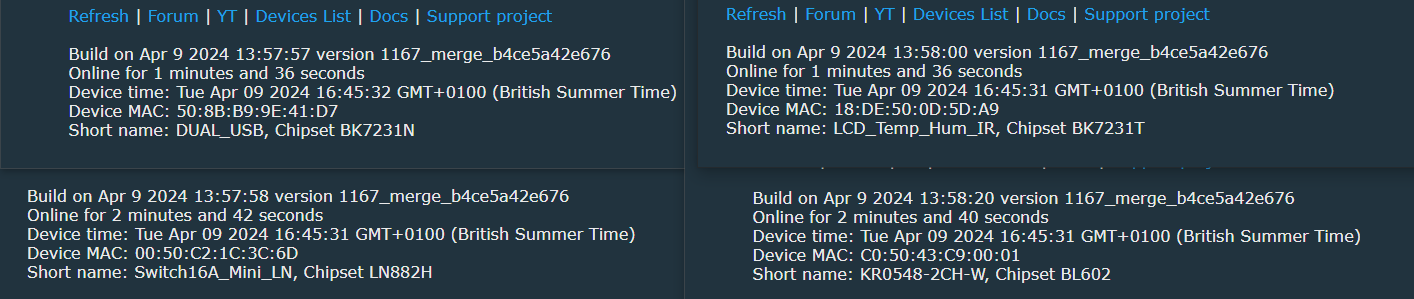

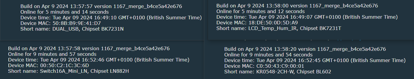

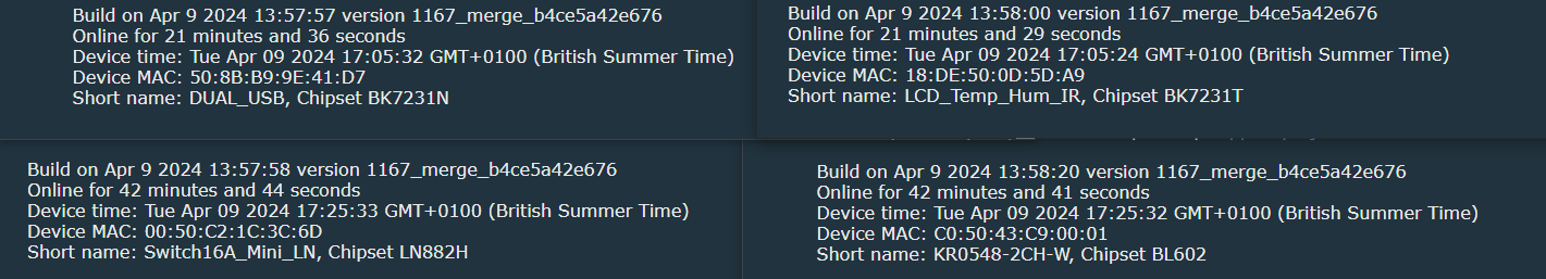

    Posts: 5220
    Help: 449
    Rate: 918
    about as close as I can get uptime and clocks as a starting position.
    Screenshot showing technical details of four devices, including online time, software version, device time, and MAC addresses.
    Added after 3 [minutes]:
    starting again. the uptime is weird on refresh, as you can see.
    Added after 6 [minutes]:
    OK. uptime before setting time to browser.
    Screenshot showing technical information about four devices, including their MAC addresses, online time, and software version.
    ah interesting, all 4 were set within 1-2s of eachother. N and T chips online/uptime seem to be put back 1 minute at the time this happens, as below. actual time seems good as a starting point though
    Four sections of device information showing parameters like firmware version, device time, and MAC address.
    Added after 4 [minutes]:
    is the device time seen in the browser the *actual* time reported on the device, in real-time, or does the browser carry on with it's own ticking over mechanism from when the page is loaded/refreshed?
    hmm. OK refreshed all 4 within a 1-2s of each other (first refresh since time was first set). something's wrong with N and T
    Screenshot of four different devices showing uptime, device time, and software version information.

  • Browser time persists across page refreshes
    #27 21039956
    Posts: 5220
    Help: 449
    Rate: 918
    of course. flashing now
    Added after 40 [minutes]:
    starting positions
    Screenshot with information about several network devices, including names, MAC addresses, online time, and chipsets.
    browser time set
    Screenshot showing information about networked devices, including build time, online status, and MAC addresses.
    13 minutes later - page refresh
    Screenshot showing details of four network devices with information on build time, online duration, device time, MAC address, and short name.
    Added after 1 [hours] 18 [minutes]:
    more time
    Screenshot of a web application control panel showing device details and a system clock.

    I have a W600 now. Sadly, it's not happy very quickly
    Screenshot displaying device and time information.
  • #30 21046557
    Posts: 14770
    Rate: 12913
    Are you testing on W600 with PowerSave or without it?
