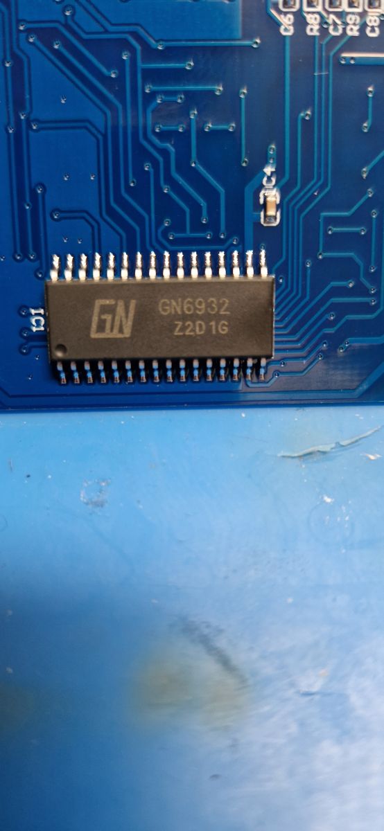

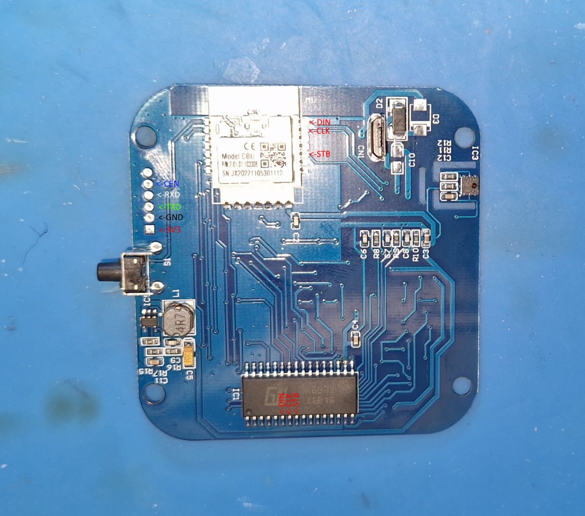

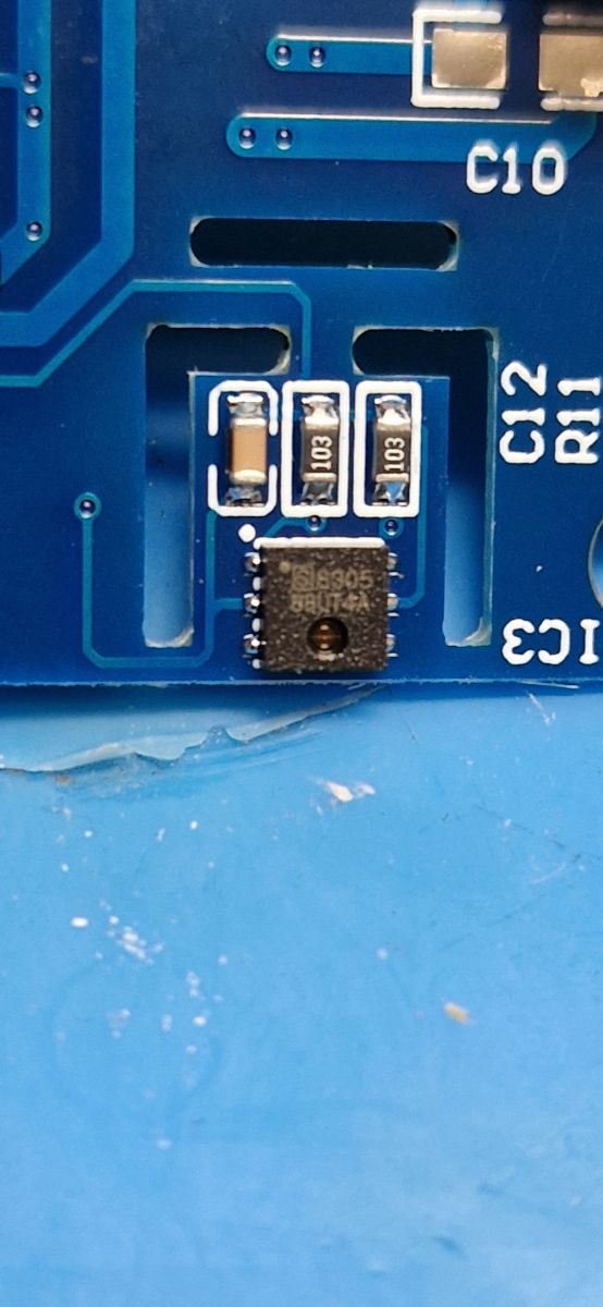

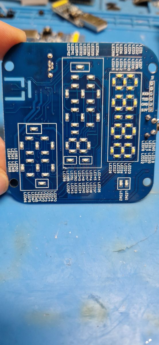

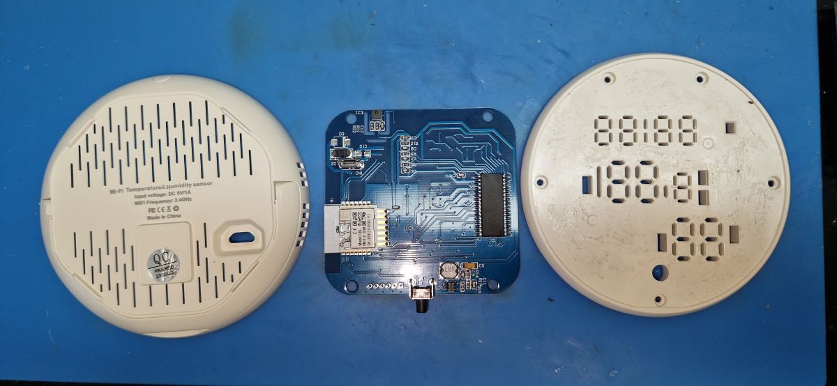

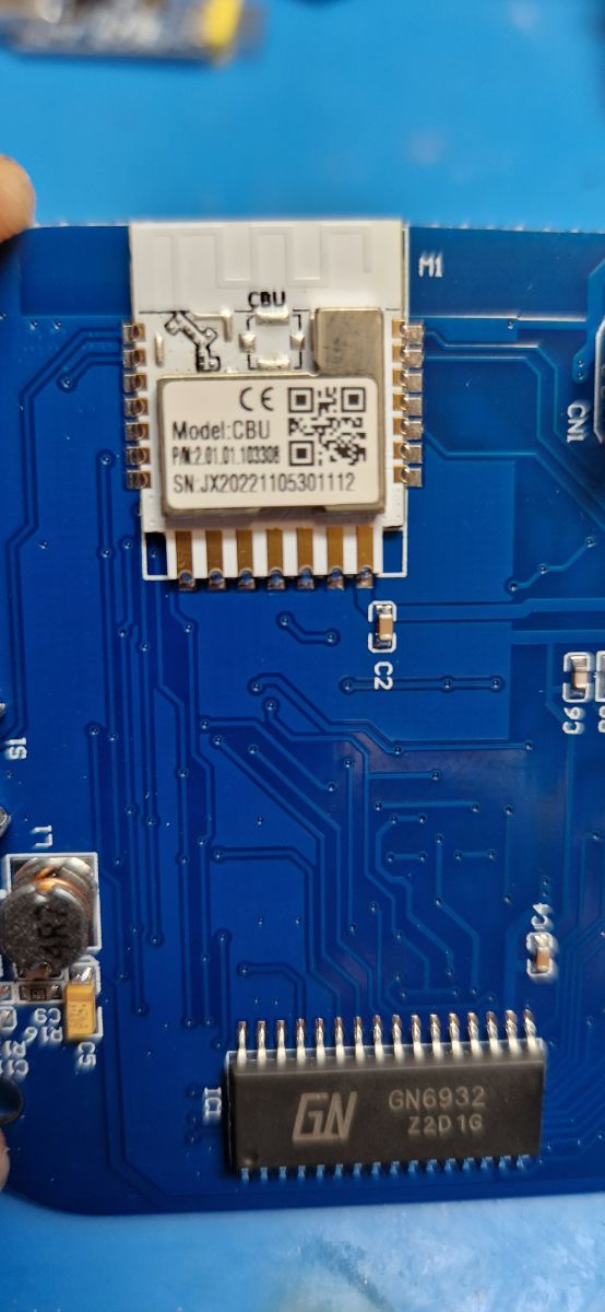

    Here is another device with Tuya CBU module, here is the AliExpress listing for it - https://shorturl.at/sJVZ6
    It is based around CHT8305 sensor but it has a GN6932 a multi 7 segment display driver.
    [BK7321N] Generic USB powered thermostat and humidity sensor with LED display - CBU module [BK7321N] Generic USB powered thermostat and humidity sensor with LED display - CBU module [BK7321N] Generic USB powered thermostat and humidity sensor with LED display - CBU module [BK7321N] Generic USB powered thermostat and humidity sensor with LED display - CBU module [BK7321N] Generic USB powered thermostat and humidity sensor with LED display - CBU module [BK7321N] Generic USB powered thermostat and humidity sensor with LED display - CBU module
    This is a fast teardown with some basic info, more to come soon. Also attached is the dump from the working device if that is of any help and datasheet for that LED driver.
    EDIT:
    To make the temp sensor working in the config menu set:
    CHT pin 1 (SDA) -> CBU pin 4 (P22)
    CHT pin 6 (SCL) -> CBU pin 3 (P20)
    Led driver configuration:
    LED driver pin 6 (DIN) -> CBU pin 21 (P15)
    LED driver pin 7 (CLK) -> CBU pin 20 (P17)
    Led Driver pin 8 (STB) -> CBU pin 17 (P28)
    Button configuration:
    Button -> CBU pin 1 (P14)
    EDIT: added AliExpress listing.

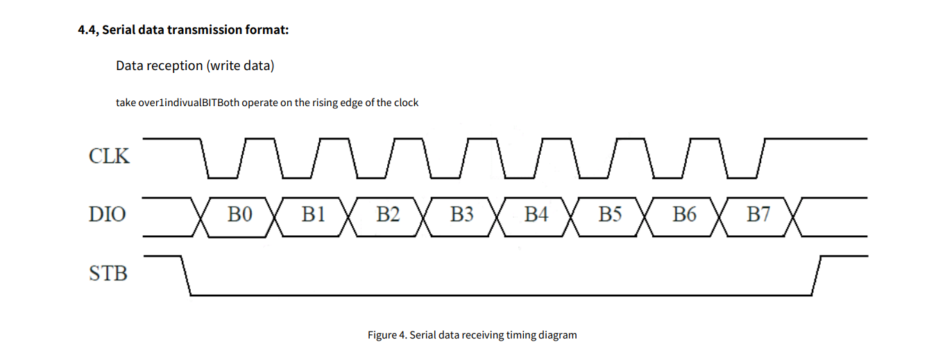

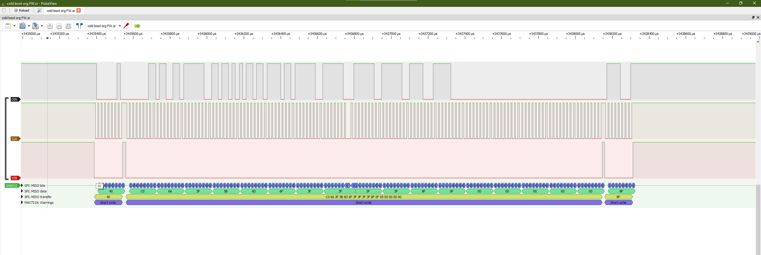

    Here is the capture from the cold boot from PulseView (aka Sigrok) from the 3 data lines, DIN, CLK and STB.
    6 DIN Data Input Serial data input on clock rising edge, low bit first.
    7 CLK Clock input Input/output serial data on the rising edge of the clock
    8 STB Chip select Initializes serial interface on rising or falling edge

  • GN6932 LED driver datasheet translation
    #3 20535551
    DeDaMrAz
    Posts: 620
    Help: 34
    Rate: 130
    Just a quick translation from the datasheet of the LED driver:
    GN6932 is a special circuit for LED (Light Emitting Diode Display) drive control, which integrates MCU digital interface, data lock
    memory, LED high voltage drive. This product has excellent performance and reliable quality. Mainly used in multi-segment display driver.
    Its main features are as follows:
    ● Using power CMOS technology
    ● Display mode (8 segments×16 bits)
    ● Brightness adjustment circuit (8-level adjustable duty cycle)
    ● Serial interface (CLK, STB, DIN)
    ● Oscillation mode: RC oscillation (450KHz±5%)
    ● Built-in power-on reset circuit
    ● Package form: SOP32

    This is a very interesting device. I'd rather expect it to be TuyaMCU based, but it doesn't look like it. Are you able to check where is the CHT8305 connected?
    CHT8305 driver is already in OpenBeken, is it working on this device well?
    The 2MB backup can be restored anytime, although for the new flash tool you may need to rename the dump and put it into the "firmware" directory.
  • CHT8305 wiring and backup restore confirmed

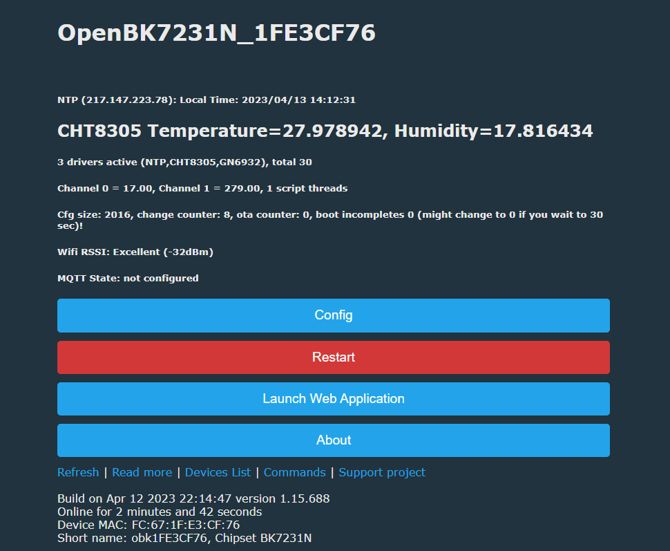

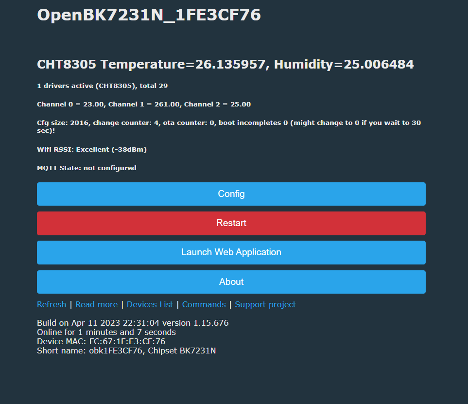

    Yes I can:
    Alert pin is NC(?!?)
    And the CHT is working,
    Added after 14 [minutes]:
    Just to confirm renamed backup written and working.
    In my case I renamed it to OpenBK7231N_QIO_1.15.xxx and the flasher did write and device is in the original state.
    BTW consider adding backup naming and writing option to flasher.

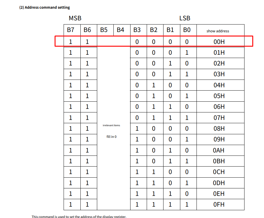

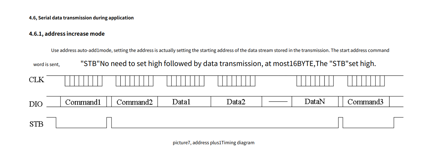

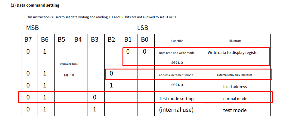

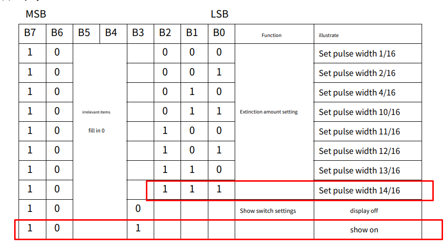

  • GN6932 command sequence and multi-byte write protocol
    #10 20535619
    Posts: 14756
    Rate: 12883

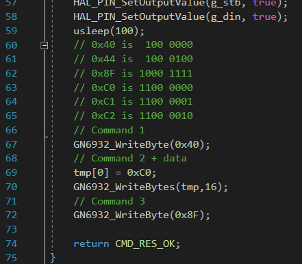

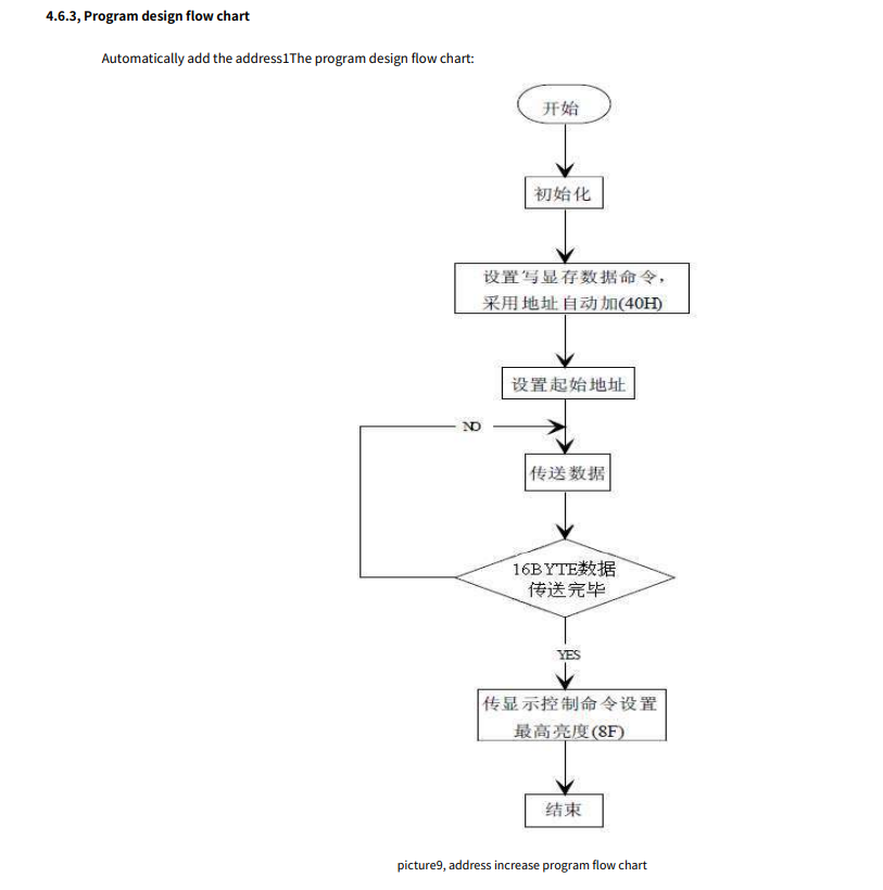

    Thank you, the basic protocol is the following:
    Code: C / C++
    but one can write multiple bytes if STB does not go high:
    Code: C / C++

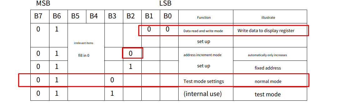

    The flowchart requires sending 3 commands: setup command, cmd +data, turn on command.
    first setup command, single byte, 0x40 is 100 0000:
    Second command has multiple bytes, it's address command + data bytes:

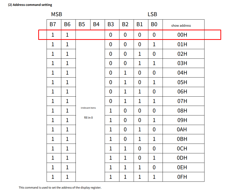

    0b1100 0000 is 0xC0.
    Third command is 0x8F which is 1000 1111:
    Here is what I come up so far:
    Code: C / C++
    I will push it to the source in the morning so you can get binaries and test. Curent version just sends random segments data.

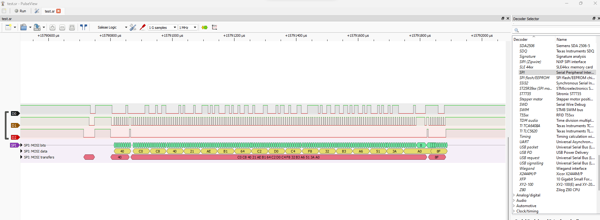

  • Logic analyzer capture decoded as MAX7219 data
    #11 20535915
    DeDaMrAz
    Posts: 620
    Help: 34
    Rate: 130

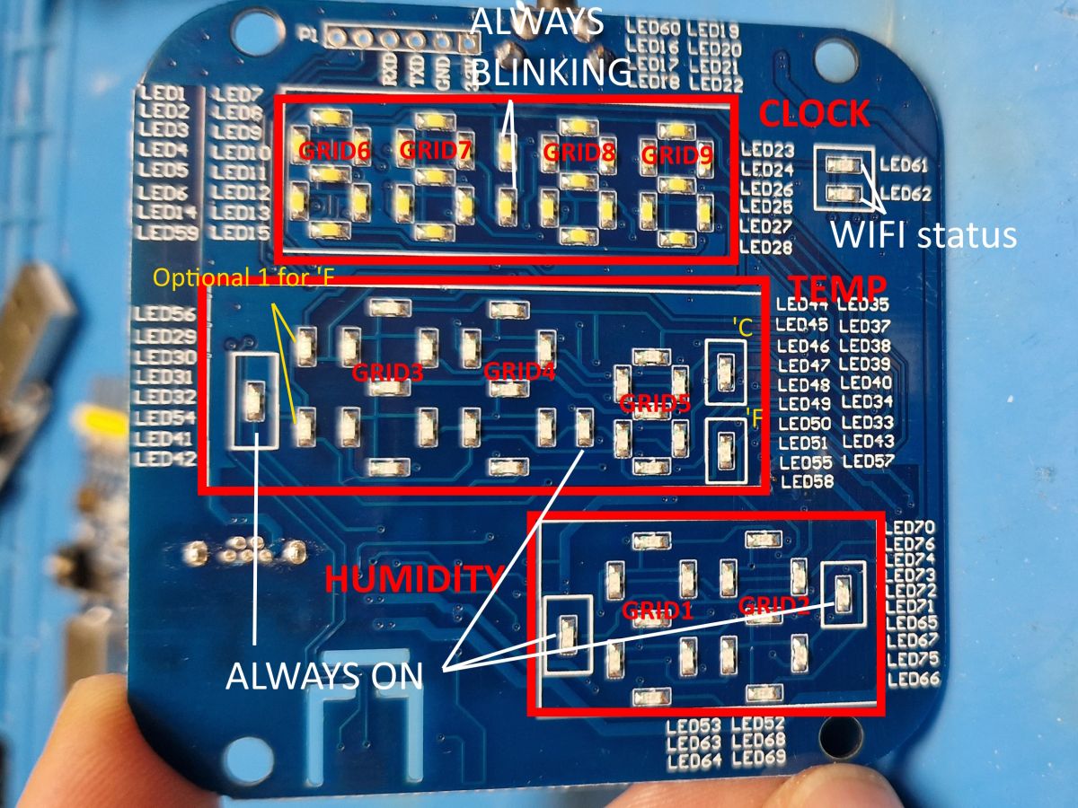

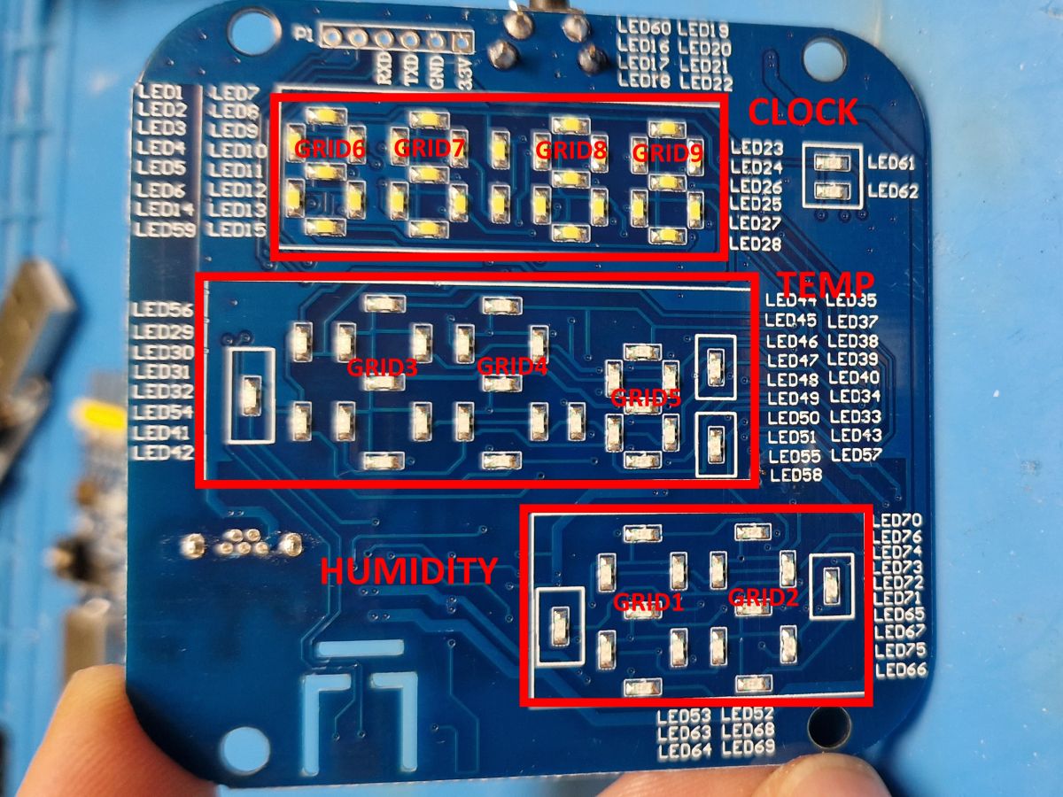

    Some more info from observing the HW, which can possibly influence the data format set.
    Added after 12 [minutes]:
    The data sheet and the data transfer on the board corelate, but configuration depending not all bytes (my guess GRID registers) are used.
    Here is the short snippet of the data capture from the logic analyzer and decoded as MAX7219. You can load the previously attached capture into PulseView and have a clearer picture about the data transfer structure that is based on this specific configuration.
    • test.txt (579.08 KB) You must be logged in to download this attachment.

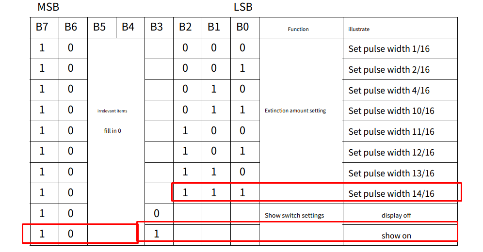

  • Bit order swapped in SPI display commands
    #12 20535970
    Posts: 14756
    Rate: 12883
    I haven't loaded it yet, but your text file looks very interesting.
    But it seems that bit order is swapped!
    There is basically that:
    17130098-17130262 SPI: MOSI transfers: 02
    17130279-17132867 SPI: MOSI transfers: 03 66 60 DA F2 60 FC FC FC 60 F1 C0 00 00 00 00 00
    17132885-17133038 SPI: MOSI transfers: F1
    0x02 is a first command. It sets the normal mode and auto increment.
    This fragment:
    it's first 0x03, the address setting, it sets address 0x00
    The next part of the data is the segments/grids data. They are using auto address increment and set all in one batch, within single STB tick.
    The last part is that:
    0xF1 hex is binary 1111 0001, but as I said, you have swapped endiannes, so it is in fact this:
    It sets the brightness and enables the display.
    Your packet dumps are very helpful, I will try to push the test driver code to repository today so you can flash OBK and try it. For the start, we will set random segments.
  • #13 20536000
    DeDaMrAz
    Posts: 620
    Help: 34
    Rate: 130
    Sorry that decoding was done as MSB-first, I changed to LSB-first and the message is clear.
    40
    C0 66 3F 5B 6D 6F 3F 3F 3F 3F 8F 0F 00 00 00 00 00
    8F

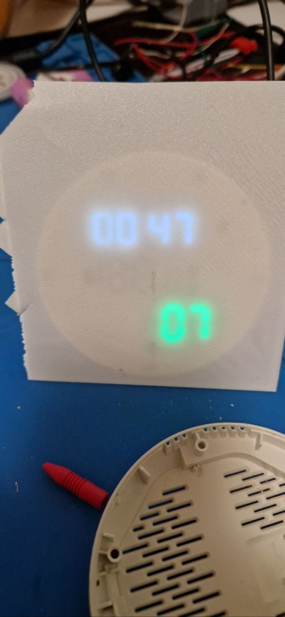

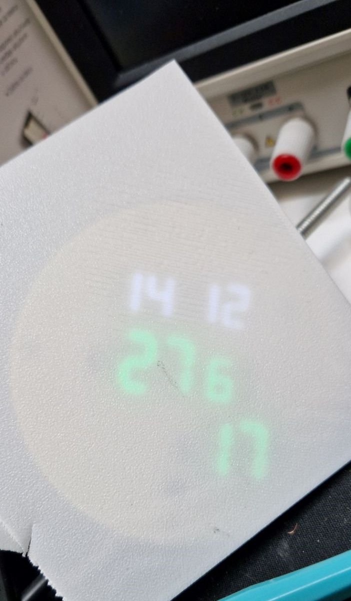

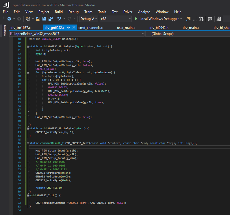

  • GN6932 test driver and pin mapping added
    #14 20536026
    Posts: 14756
    Rate: 12883
    Suprisingly enough, it matches well what I've written yesterday, just by basing on the datasheet:
    Ok, I will push that test driver in a hour or two, I am looking into door sensors protocol now:
    https://www.elektroda.com/rtvforum/topic3937723-90.html#20535974
    Added after 55 [minutes]:
    This protocol looks the same as TM1637, except the addition of the STB pin and lack of the ACK. One could say that GN6932 is SPI version of TM1637 ?
    Anyway, I added test code:
    https://github.com/openshwprojects/OpenBK7231...mmit/0b8a78fa2b6420cf1a2af3cc629b15c603681c97
    It assumes pin indices:
    int g_clk = 17;
    int g_stb = 28;
    int g_din = 15;
    Usage:
    1. enter command startDriver GN6932
    2. enter command GN6932_TestAddressIncreaseMode , random segments should lit up.

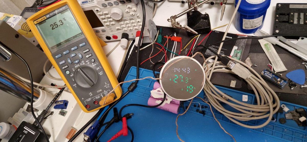

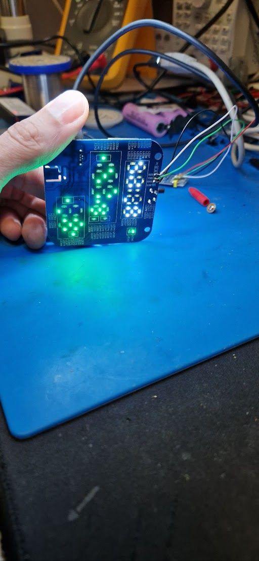

  • GN6932 command changes bus pattern; byte order corrected
    #15 20536357
    DeDaMrAz
    Posts: 620
    Help: 34
    Rate: 130
    It does work, there is a changing pattern with every GN6932_TestAddressIncreaseMode command, here is the analyzer screenshot (sorry decoding is wrong by my mistake it is MSB first should be the other way around)
    tested with 680 build.
    EDIT:
    corrected byte order

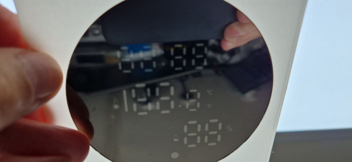

  • #17 20536418
    DeDaMrAz
    Posts: 620
    Help: 34
    Rate: 130

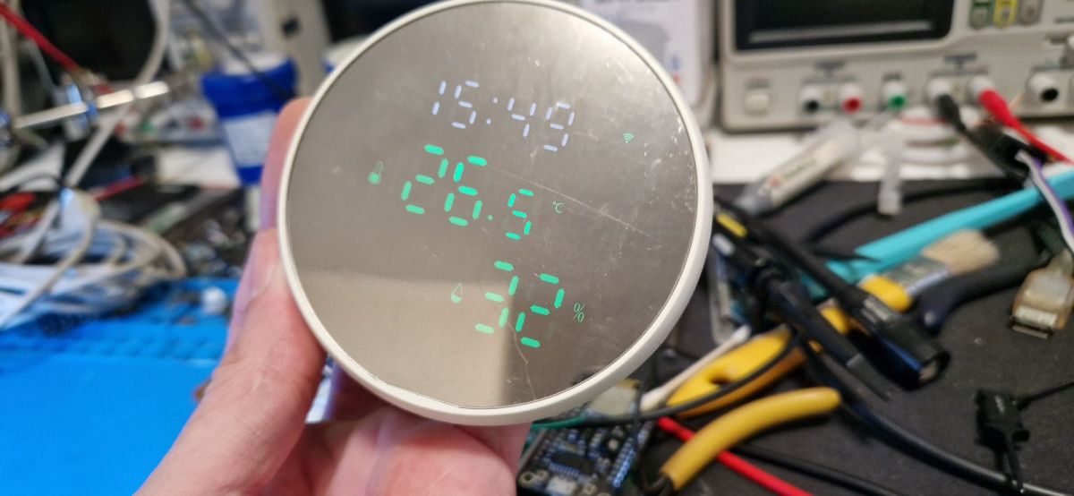

    Brightness control does work!
    Build 681
    Enter in command line:
    1) GN6932_TestAddressIncreaseMode
    2) GN6932_Dimmer 1 3 - syntax is GN6932_Dimmer [bOn] [brightness], (bOn is 0 for OFF and 1 for ON, brightness level 0-7)
    3) GN6932_TestAddressIncreaseMode - to apply changes (also lit characters will change)
  • Merged TM1637 and GN6932 driver with test commands
    #18 20536515
    Posts: 14756
    Rate: 12883
    I have pushed merged TM1637 + GN6932 driver.
    https://github.com/openshwprojects/OpenBK7231...mmit/3b25aee97370775559e279f879bb016c0f1304fd
    It currently uses your pins by default.
    		i2c.pin_clk = 17;// PIN_FindPinIndexForRole(IOR_TM1637_CLK, 16);
    		i2c.pin_data = 15;// PIN_FindPinIndexForRole(IOR_TM1637_DIO, 14);
    		i2c.pin_stb = 28;// PIN_FindPinIndexForRole(IOR_TM1637_DIO, 14);
    (yes, I know, that's not I2C...)
    usage:
    1. start and try to print something:
    backlog startDriver GN6932 ; TMGN_Print 0 0 123456
    // NOTE: TMGN_Print [Ofs] [MaxLen]
    // If MaxLen=0, then no lenght limit
    Is it printing anything?
    2. check brightness changes:
    backlog TMGN_Brightness 5; TMGN_Print 0 0 123456
    // NOTE: TMGN_Brightness [Brightness0to8] [bOn]
    // The bOn is optional, default is 1
    backlog TMGN_Brightness 2; TMGN_Print 0 0 123456
    backlog TMGN_Brightness 7; TMGN_Print 0 0 123456
    Are they working?
    3. try to create character codes
    TMGN_Char 0x00 123
    // Note: TMGN_Char CharIndex CharCode
    This is 7 segment display, I assume.
    So we can display: 0, 1, 2, etc etc 9, A, B, C, etc F.
    But we need to know which segments are displayed for each letter.
    That function can set code for given index.
    For example, TMGN_Char 0 123 sets code for 0.
    The TMGN_Char 10 33 sets code for A (A is 10)
    etc etc.
    You can play around it by:
    - first use TMGN_Char 0 33 , replace 33 with anything
    - then use TMGN_Print 0 0 00000 - does it print proper 0?
    You can also do a tricky way and just use character codes from your capture
    40
    8F
    ok so 3F most likely is 0 here? What was the display showing when you captured that data?
    Try:
    TMGN_Char 0 0x3F

  • Working GN6932/TM1637 clock script and grid mapping
    #21 20537116
    DeDaMrAz
    Posts: 620
    Help: 34
    Rate: 130
    Following script should work with both GN6932 and TM1637 and create a simple clock.
    //startDriver GN6932
    startDriver TM1637
    startDriver NTP
    //edit for your time zone
    //ntp_timeZoneOfs  +2:00
    TMGN_Clear
    again:
    // TMGN_Print  offset len value bPadToLenWithZeros
    TMGN_Print 4 2 $second 1
    TMGN_Print 2 2 $minute 1
    TMGN_Print 0 2 $hour 1
    delay_s 0.1
    goto again
    Build 688.
    Just to confirm, this is the script that is working for the clock (refer to previous picture explaining GRID placement index starts from 0-8 not 1-9) and seconds are where humidity should be (GRID1 or index 0) for now.
    startDriver TM1637
    startDriver NTP
    TMGN_Clear
    again:
    //GRID1_2digits_seconds
    TMGN_Print 0 2 $second 1
    //GRID8_2digits_minutes
    TMGN_Print 7 2 $minute 1
    //GRID6_2digits_hours
    TMGN_Print 5 2 $hour 1
    delay_s 0.1
    goto again

  • Working GN6932 autoexec script for BK7321N display
    #23 20537716
    DeDaMrAz
    Posts: 620
    Help: 34
    Rate: 130
    Got it working, that approach worked. Here is the pictures and the script that worked for me. All that is left is the always on LED's.
    Script that works for me now on build 688.
     startDriver GN6932
    startDriver NTP
    TMGN_Clear
    again:
    //TMGN_Print 0 2 $second 1
    TMGN_Print 2 3 $CH1 1
    TMGN_Print 0 2 $CH0 1
    delay_s 0.1
    goto again
    EDIT: confirmed working with Build 691.
    Added after 1 [hours] 36 [minutes]:
    To conclude this is the working script, I created autoexec.bat and it works as intended.
     startDriver GN6932
    startDriver NTP
    TMGN_Clear
    //adjust brightness if needed (0-7) - default is 7
    TMGN_Brightness 7
    TMGN_SetBit 9 1 1
    TMGN_SetBit 9 2 1
    TMGN_SetBit 9 3 1
    TMGN_SetBit 9 7 1
    TMGN_SetBit 9 0 1
    TMGN_SetBit 10 2 1
    TMGN_SetBit 10 3 1
    again:
    delay_s 0.1
    //blinking : on the clock
    TMGN_SetBit 10 0 0
    TMGN_SetBit 10 1 0
    delay_s 1
    TMGN_SetBit 10 0 1
    TMGN_SetBit 10 1 1
    delay_s 1
    goto again
    And a picture to prove it :)

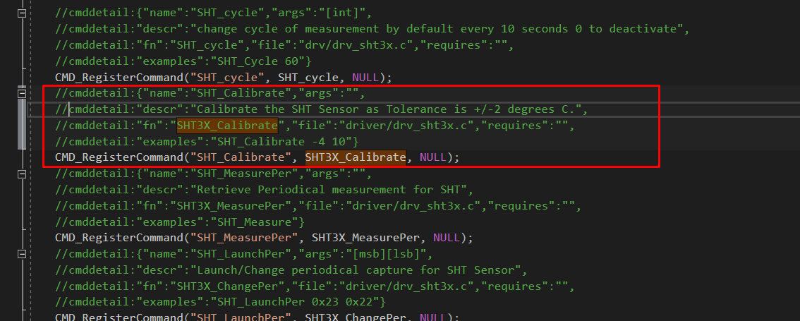

    It seems that the driver contributor, @dheenhasty , has added a calibrate function already:
    SHT_Calibrate
  • SHT_Calibrate not supported on CHT8305 sensor
    #28 20539486
    DeDaMrAz
    Posts: 620
    Help: 34
    Rate: 130
    SHT_Calibrate
    That command doesn't work on CHT8305 :) tried already
    Info:SENSOR:DRV_CHT8304_readEnv: Temperature:27.354543C Humidity:19.824522%
    Info:MAIN:Time 87358, idle 184978/s, free 73208, MQTT 0(5460), bWifi 1, secondsWithNoPing 1, socks 2/38
    Error:CMD:cmd SHT_Calibrate NOT found (args -2 10)
    Info:CMD:[WebApp Cmd 'SHT_Calibrate -2 10' Result] Unknown command
    Info:GEN:CHANNEL_Set channel 1 has changed to 274 (flags 0)
    Info:SENSOR:DRV_CHT8304_readEnv: Temperature:27.384756C Humidity:19.848936%
    Info:MAIN:Time 87447, idle 186866/s, free 61512, MQTT 0(5465), bWifi 1, secondsWithNoPing 1, socks 3/38
    Error:CMD:cmd SHT3X_Calibrate NOT found (args -2 10)
    Info:CMD:[WebApp Cmd 'SHT3X_Calibrate -2 10' Result] Unknown command
    Info:GEN:No change in channel 1 (still set to 273) - ignoring
    #29 20539583
    Posts: 14756
    Rate: 12883
    I will add a calibration function today. I confused drivers. CHT8305 indeed lacks calibration.
