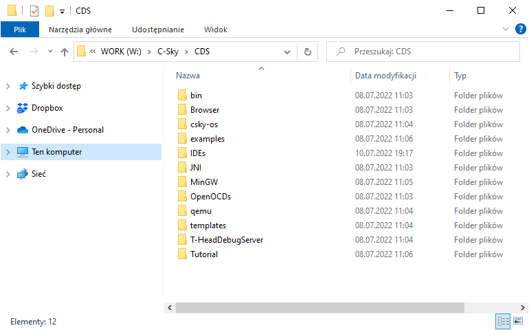

    After installation, we should get a path of this type:
    W:\C-Sky\CDS
    Folder content:

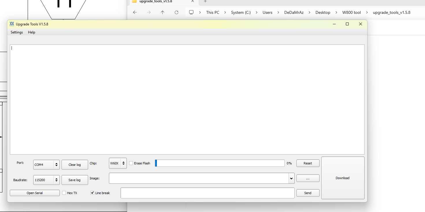

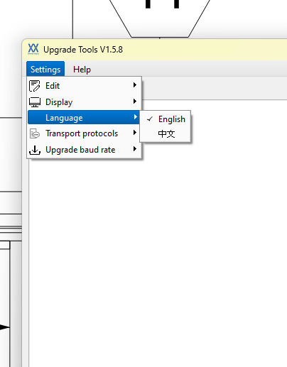

    Update 2026
    As of 2026, this platform read/write is also supported by our flash tool:
    The connection (soldering, wires), is the same, but you can use our tool instead of the legacy one.
    Please check it out and use it instead of legacy tools, let us know how it works for you!

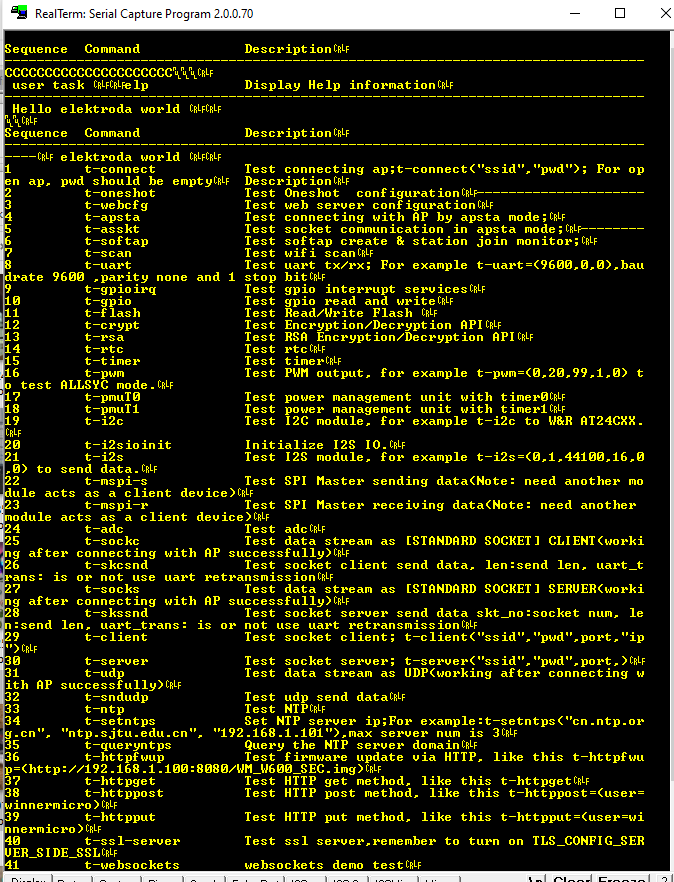

    Let's send the "demohelp" command, but without the CRLF (newline, carriage backspace):
    W800-C400 WiFi/BT microcontroller programming - wm_sdk_w800 tutorial
    Well, it's the same message, but it works.

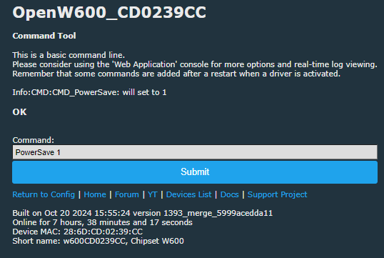

    Yes, it gets warm, but we have a fix for that (tested on BK7231N/BK7231T and W600 - not sure about W800 yet, but it should also work) - a powersave command, which will put OBK into a power saving mode. Big thanks to @btsimonh and @iprak
    NOTE: tls_wifi_set_psflag(1, 0); might not be enabled for W800 for current platform, you might need to enable it or wait for me to find W800 dev board (I will enable it in the following days).

    There is a new version of the update tool that has English translation on this link - http://www.isme.fun/upload/10001/down/2024_04/upgrade_tools_v1.5.8.zip
    Screenshot of the Upgrade Tools V1.5.8 update program.
    to select English
    Screenshot of Upgrade Tools V1.5.8 with the settings menu expanded.
    EDIT: if link for some reason does not work file is attached.
    • upgrade_tools_v1.5.8.zip (10.87 MB) You must be logged in to download this attachment.
  • #19 21209630
    Posts: 14612
    Help: 655
    Rate: 12630
    I can see W60X on the dropdown menu, so it supports both W60X (W601, W600) and W80X?
  • #20 21209635
    DeDaMrAz
    Level 22  
    Posts: 603
    Help: 34
    Rate: 129
    Looks like it but I have no W60x devices to test and I just received my first W800 device :)

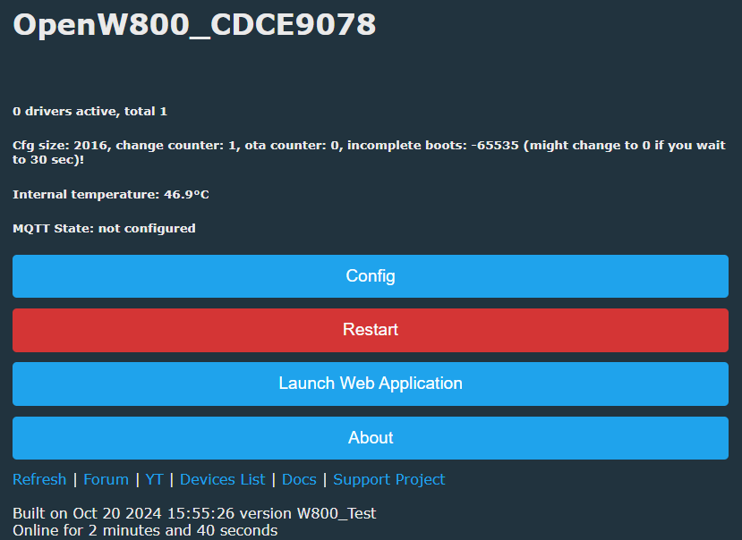

    Rate: 187

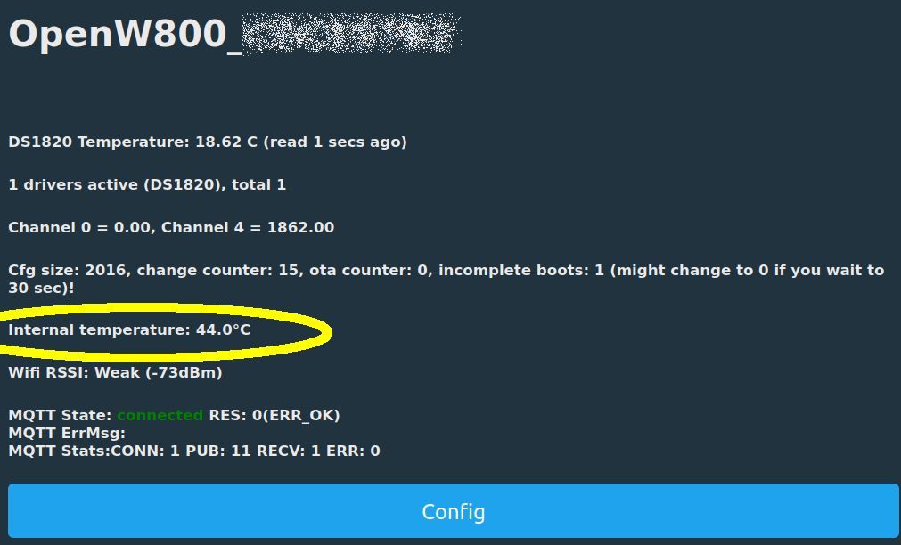

    Hi,
    I tried to add missing internal temperature in PR #1393.
    Screenshot of the OpenW800 interface displaying an internal temperature of 44.0°C.
    Tested only on W800, maybe @divadiow is willing to help testing on W600?
    Thanks!

    max4elektroda
    Posts: 754
    Help: 48
    Rate: 187
    It's meant to be fun, not stress ;-)
  • #25 21271035
    max4elektroda
    Posts: 754
    Help: 48
    Rate: 187
    Thanks a lot, looks at least as a possible temperature...

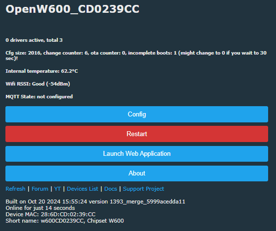

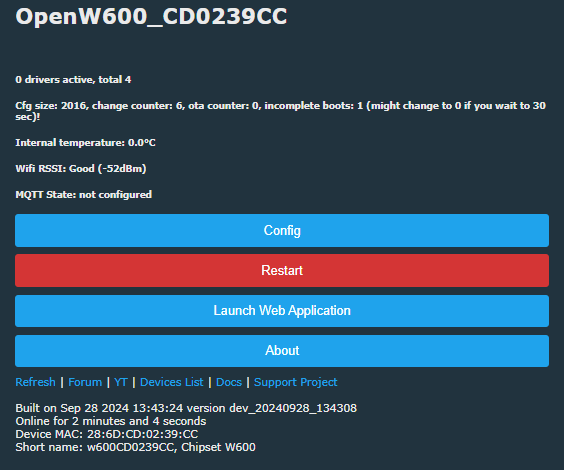

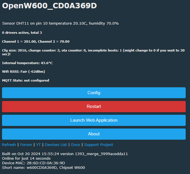

  • #26 21271053
    Posts: 5059
    Help: 438
    Rate: 893
    yes. a bit toasty but it could be accurate-ish. this is a TW-02 module transplanted into a mini DIY square breaker switch. I can't recall off the top of my head if W600 supports powersave, but it hasn't made much difference to the temp in the 8 hours since I ran the command.
    OpenW600 interface with power-saving mode enabled.
    Added after 8 [minutes]:
    and another W600 in exactly this setup: https://www.elektroda.com/rtvforum/topic3977022.html#21249449
    Screenshot of the OpenW600 system interface showing various network parameters and settings.

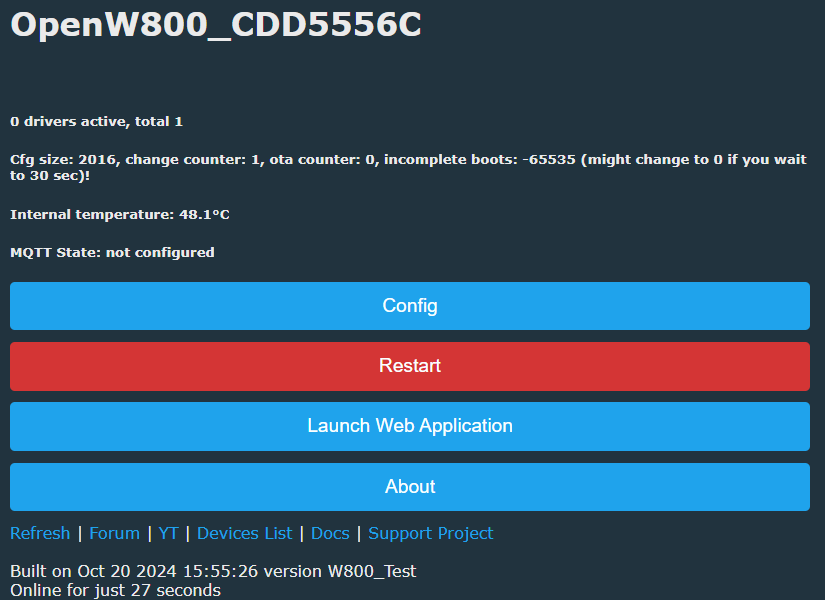

  • #29 21274975
    Posts: 5059
    Help: 438
    Rate: 893
    Maybe this good is to release?
    Here is another W800 and a W801
    Screenshot of the OpenW800 user interface displaying system information and configuration buttons. Screenshot of OpenW800 interface with buttons Config, Restart, Launch Web Application, and About.
