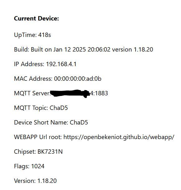

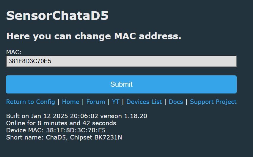

    Now I have two PB-69W devices which seems to be not repairable in my opinion. I tried to re-flash it, restore RF partition, I am able to start in safe mode, I am able to check the MAC, but I am not able to connect it to WiFi regardless the MAC at basic management seems to be OK. I noticed, that MAC differs in basic Web GUI and in Web App. See the attachments.

    Regarding the RF/mac issue if you have the original firmware backups then reflashing those in their entirety and starting again with OpenBeken should sort that out

    @divadiow "Thanks for your reply! I flashed the original Tuya backup and then the OpenBeken firmware, and it works well on both devices.
    Note to others: If you restore the original Tuya backup to more devices, it contains the original MAC address, so you have to change it to avoid conflicts."
