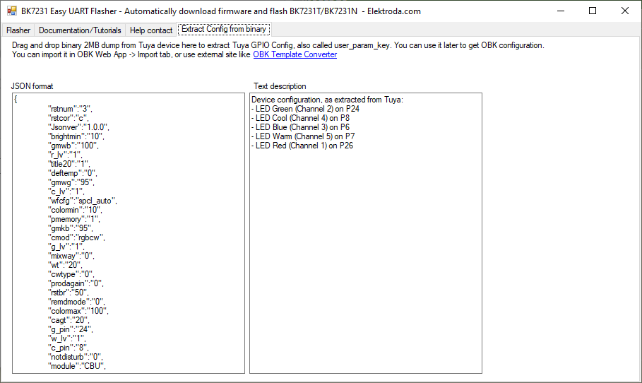

    Latest version of BK7231Flasher can detect GPIO config automatically from Tuya binary and soon it will automatically configure OBK, so maybe it would be worth to give it more attention.

Cloud exploits can be blocked or unsupported. One user resolved this by soldering and flashing directly. If OTA fails repeatedly, switch to wired flashing to proceed safely. [Elektroda, loveolgavanya, post #21410483]
What’s the most reliable fallback to flash CB2S devices?
Use BK7231Flasher over wires. The latest version auto‑detects GPIO from Tuya binaries and can preconfigure OpenBK, reducing setup time. [Elektroda, p.kaczmarek2, post #20570471]
