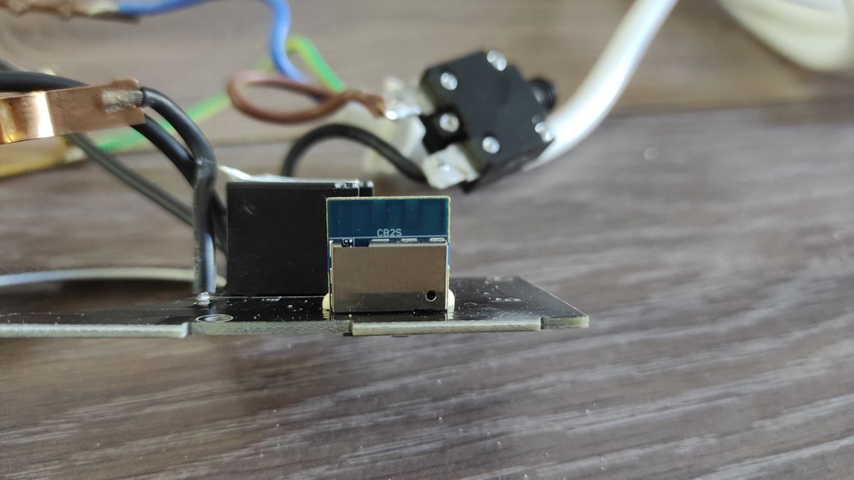

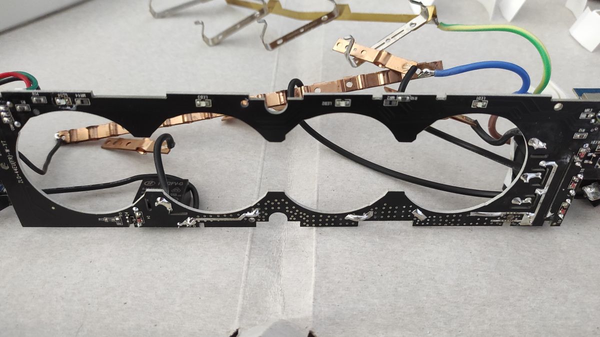

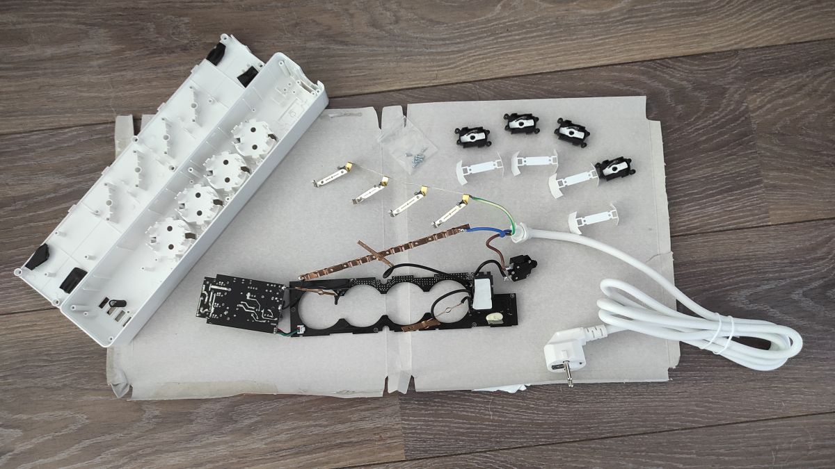

    Only way to find out which chip it's using was to completely disassemble it, here are some pictures. Note: Also it's not needed to disassemble it with this howto, it might be good to do it anyway, as I noticed that the cables where not very nicely soldered to the contacts for the outlets and need some retouching.

You may not be able to confirm it from the outside on this model. The author says the device itself had no printed device name, and they had to completely disassemble it to identify the module as CB2S. They also note that disassembly is not required for the flashing method itself, but it was the only way they found to verify the chip family before mapping GPIOs. [#20663247]
What safety issues should I inspect inside a Tuya power strip like the ZLD-44EU-W before putting it back into service?
Inspect the soldering on the outlet contact wiring before reuse. The author noticed the internal cables were "not very nicely soldered" to the outlet contacts and said they needed retouching. That makes internal visual inspection worthwhile after opening the strip, even though disassembly is not required for the WiFi flashing procedure itself. [#20663247]
