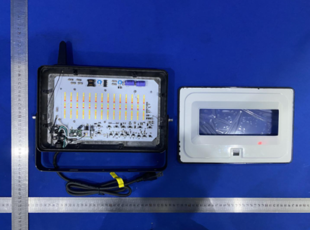

    Onforu D100WIFI is a powerful 90W, RGBCT Spotlight featuring IP66 Ingress Protection rating, which means it can be effectively used for outdoor lighting. D100WiFi features CBU module with BK7231N controlling 5 PWM LED channels, which means it can be very easily flashed with OpenBeken.
    The information about D100WIFI was submitted by our reader from USA. Thank you! I am just submitting it.

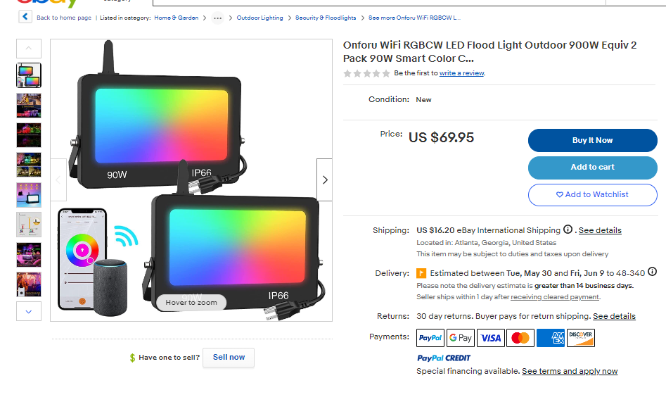

    D100WiFi can be bought on various places, here are some screenshots:
    [BK7231N/CBU] Onforu D100WIFI 90W RGBCT Spotlight programming/teardown/guide/OpenBeken

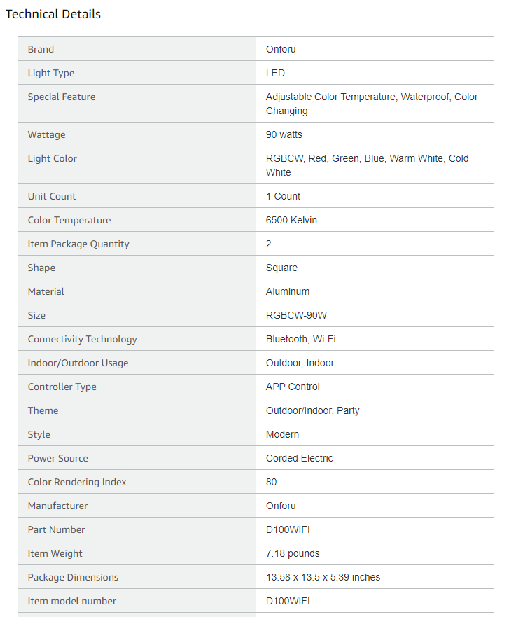

    Technical details:
    ASIN: B08VJ5CVML
    FCC ID: 2A3W8D100WIFI

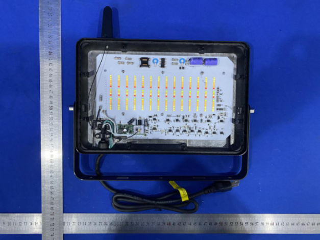

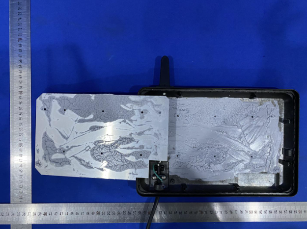

    Device internals can be seen on related FCC document:

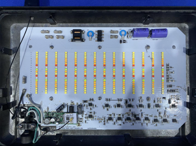

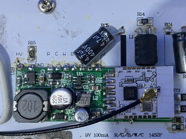

    LED closeup:

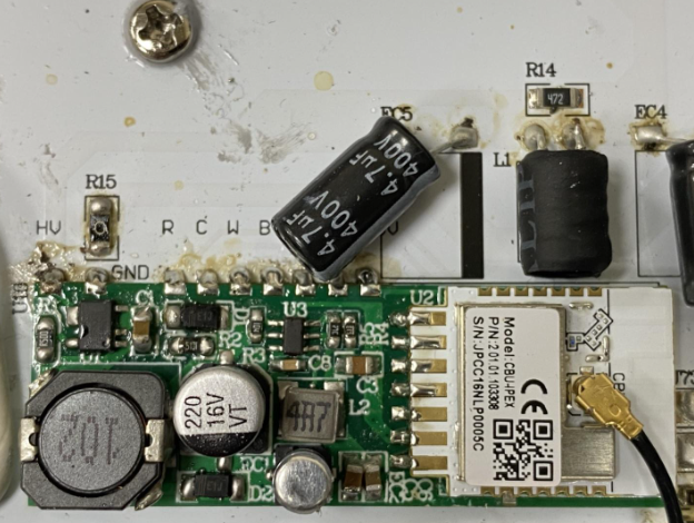

    CBU with external antenna:
