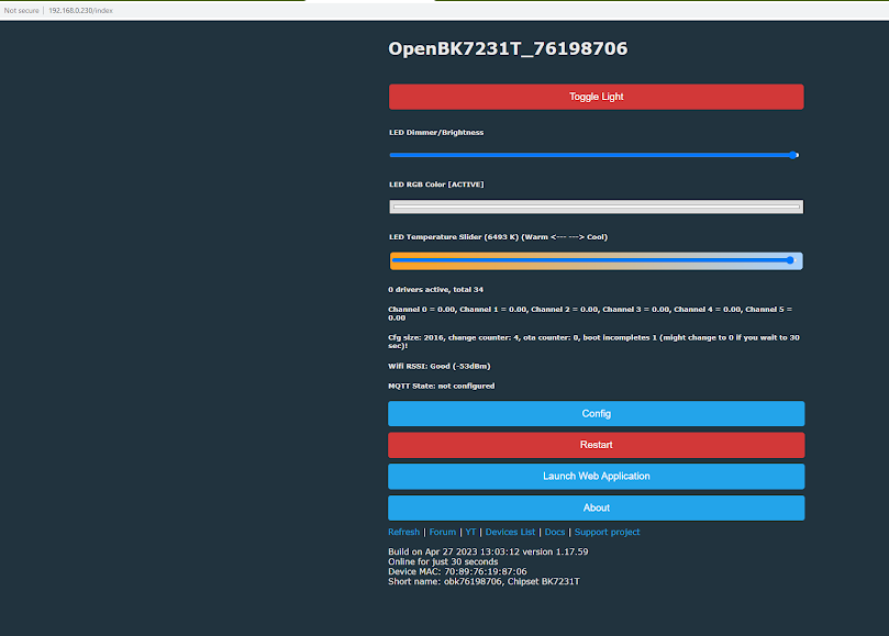

    Then you need to set the 5 PWM pins that control the colors.

    OpenBeken panel:
    [BK7231T/FL_M44_V1.6.1z??] MOKO Smart Bulb C37 E14 5W 400lm
    Template:
    words template;
    - LED Red (Channel 1) on P26
    - LED Green (Channel 2) on P24
    - LED Blue (Channel 3) on P7
    - LED Cool (Channel 4) on P6
    - LED Warm (Channel 5) on P8
