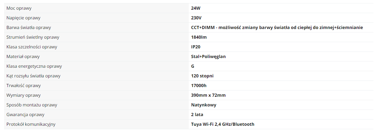

    I bought a ceiling light Spectrum Nymphea 24W 1840lm CCT at Polish shop -> https://spectrumsmart.pl/pl/p/Oprawa-LED-Wi-F...DIM-230V-130st-IP20-390x70mm-BIALY-okragla/87
    [BK7231T/WB3L] Spectrum Nymphea 24W 1840lm CCT
    1. The light has WB3L module based on BK7231T
    2. Flashed OTA with tuya cloudcutter with OpenBK7231T_UG_1.15.223.bin - I had to try few times and at the end bring laptop as close to the light as possible.
    3. Openbeken configuration (pins and flags).
    * Pin 24: PMW_n 1,
    * Pin 26: PWM2 0
    * Flag 8
    * Flag 12

    Thanks, but it's worth adding that this device model name is SLI031033CCT and here is the manual:
    • DE_User_manual_for_Spectrum_SMART_application.pdf (1.57 MB) You must be logged in to download this attachment.
    • SLI031033CCT_SLI031033CCT.pdf (1.26 MB) You must be logged in to download this attachment.
