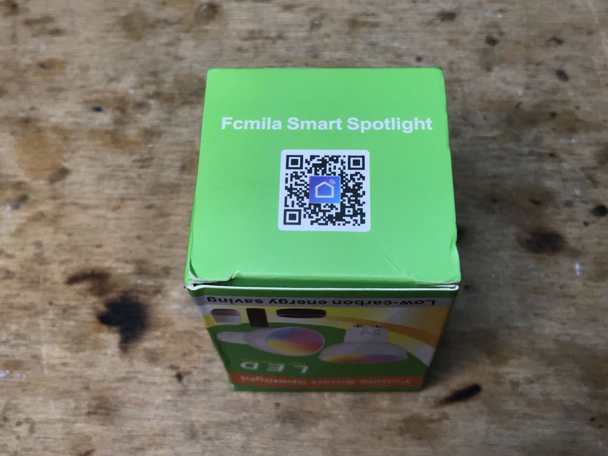

    This is what the packaging looks like:
    [WB2L/BK7231T] LED lamp Fcmila smart spotlight GU10 RGBCW [WB2L/BK7231T] LED lamp Fcmila smart spotlight GU10 RGBCW [WB2L/BK7231T] LED lamp Fcmila smart spotlight GU10 RGBCW [WB2L/BK7231T] LED lamp Fcmila smart spotlight GU10 RGBCW [WB2L/BK7231T] LED lamp Fcmila smart spotlight GU10 RGBCW [WB2L/BK7231T] LED lamp Fcmila smart spotlight GU10 RGBCW
    Kit Contents:
    The product had a broken lid right out of the package. Didn't the manufacturer shut it down?

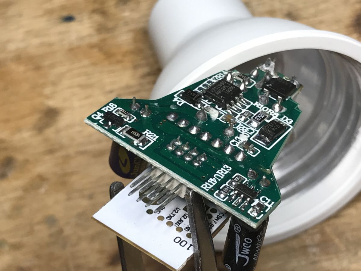

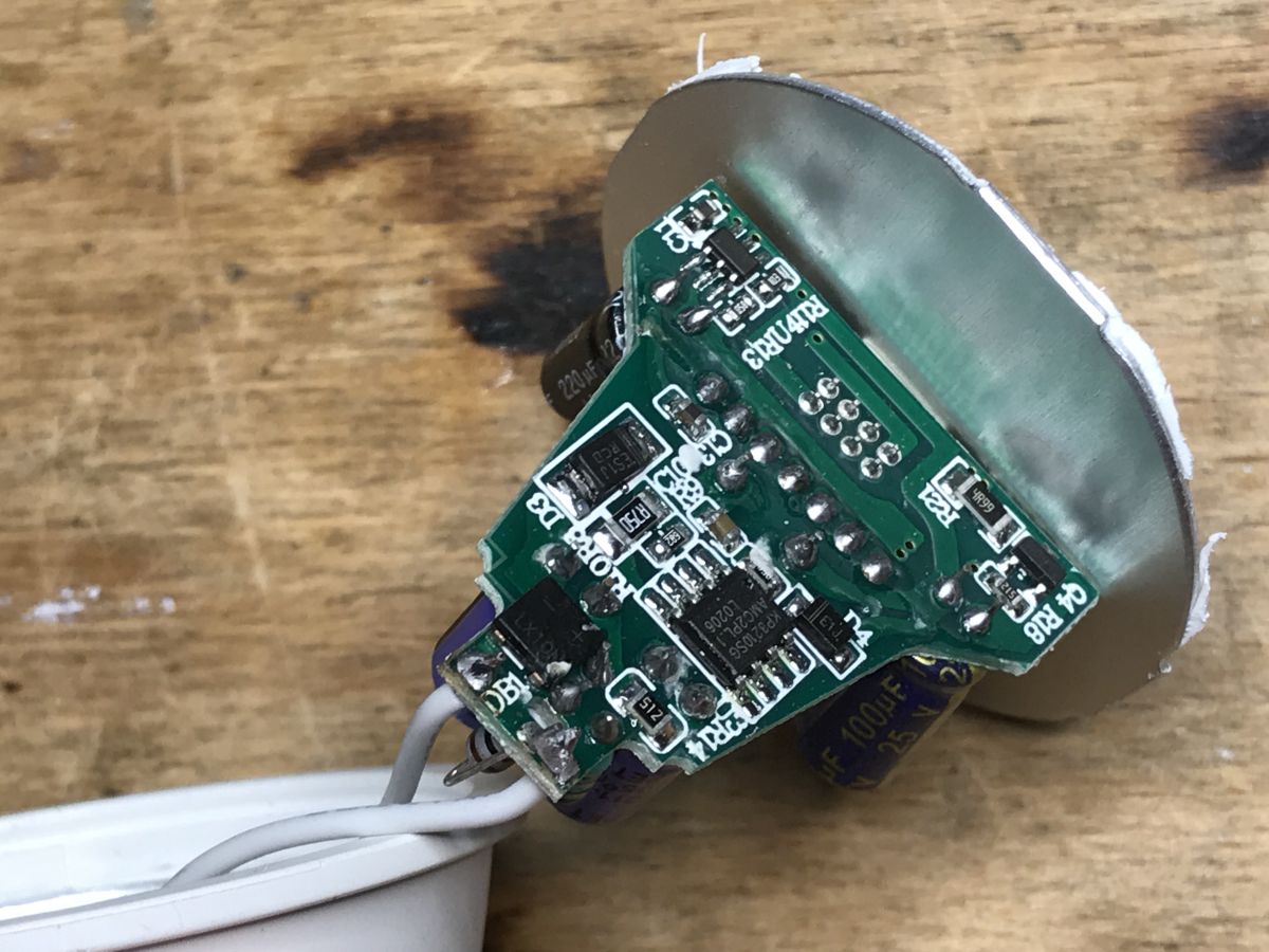

    Electronics is on longer cables, it can be removed:
    [WB2L/BK7231T] LED lamp Fcmila smart spotlight GU10 RGBCW[WB2L/BK7231T] LED lamp Fcmila smart spotlight GU10 RGBCW [WB2L/BK7231T] LED lamp Fcmila smart spotlight GU10 RGBCW

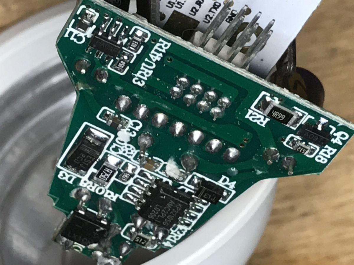

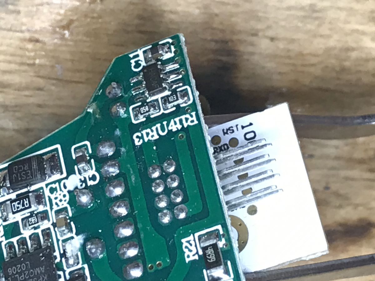

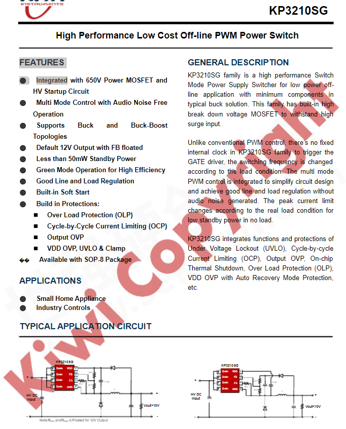

    The input shows a fuse resistor, LX10N rectifier bridge and KP3210SG transformerless converter controller:
    At the bottom there is also an SMD element marked HACAF - perhaps a 3.3V LDO regulator or a step down converter giving 3.3V?
    The R, G, B, C and W channels are controlled by separate transistors coded A09T (i.e. AO3400, N-channel MOSFET):

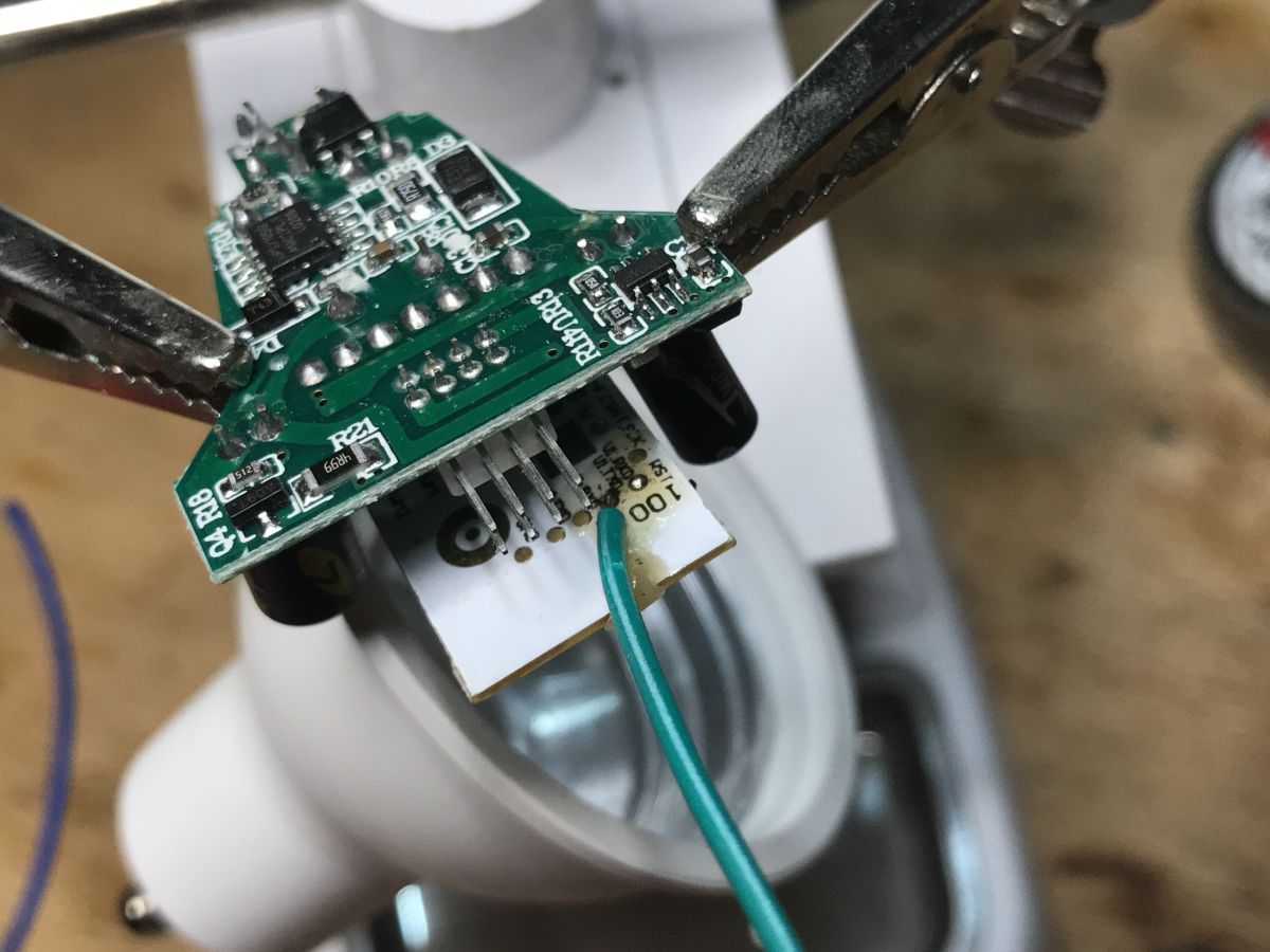

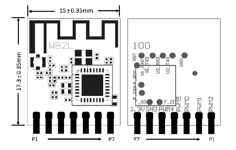

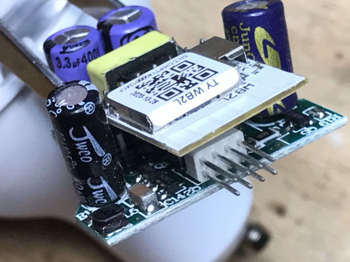

    And of course there is the WiFI module with BK7231T - WB2L:

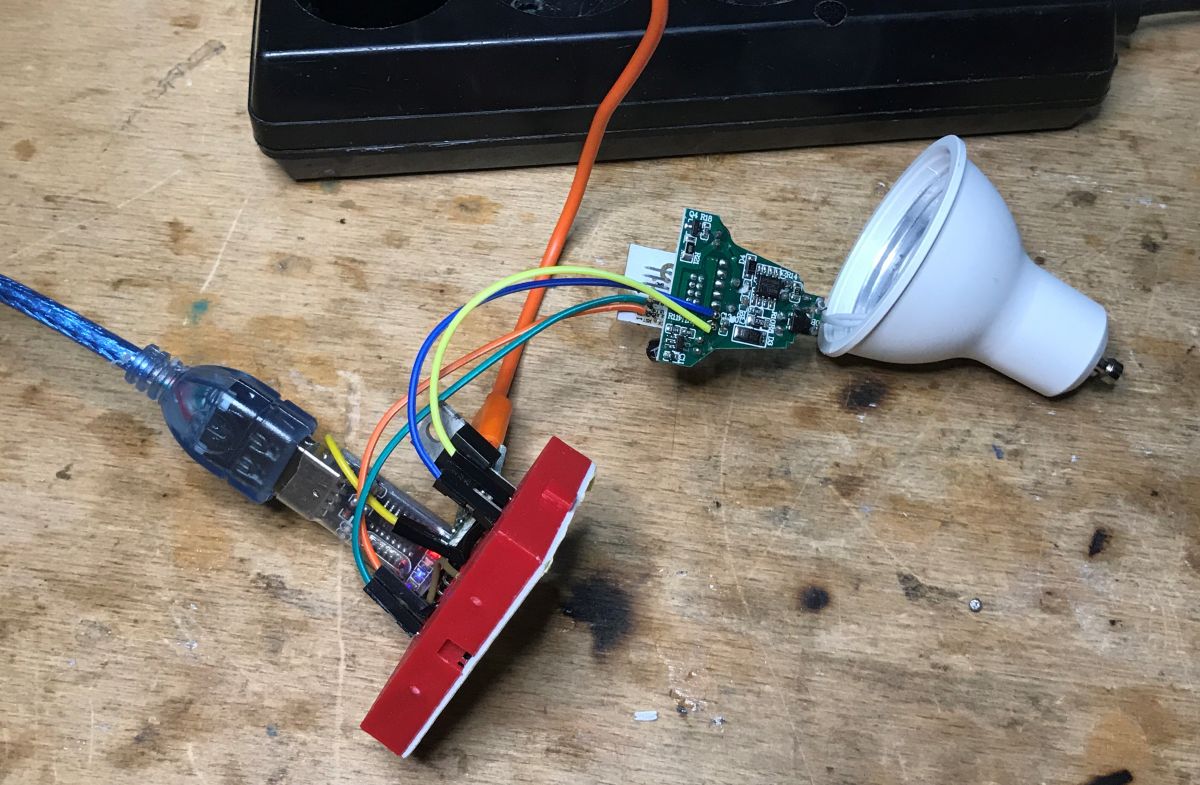

    Uploading the batch - bkWriter 1.60
    As in previous topics in the series, for example here:
    Garden double relay Tuya CCWFIO232PK - BK7231T - programming

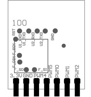

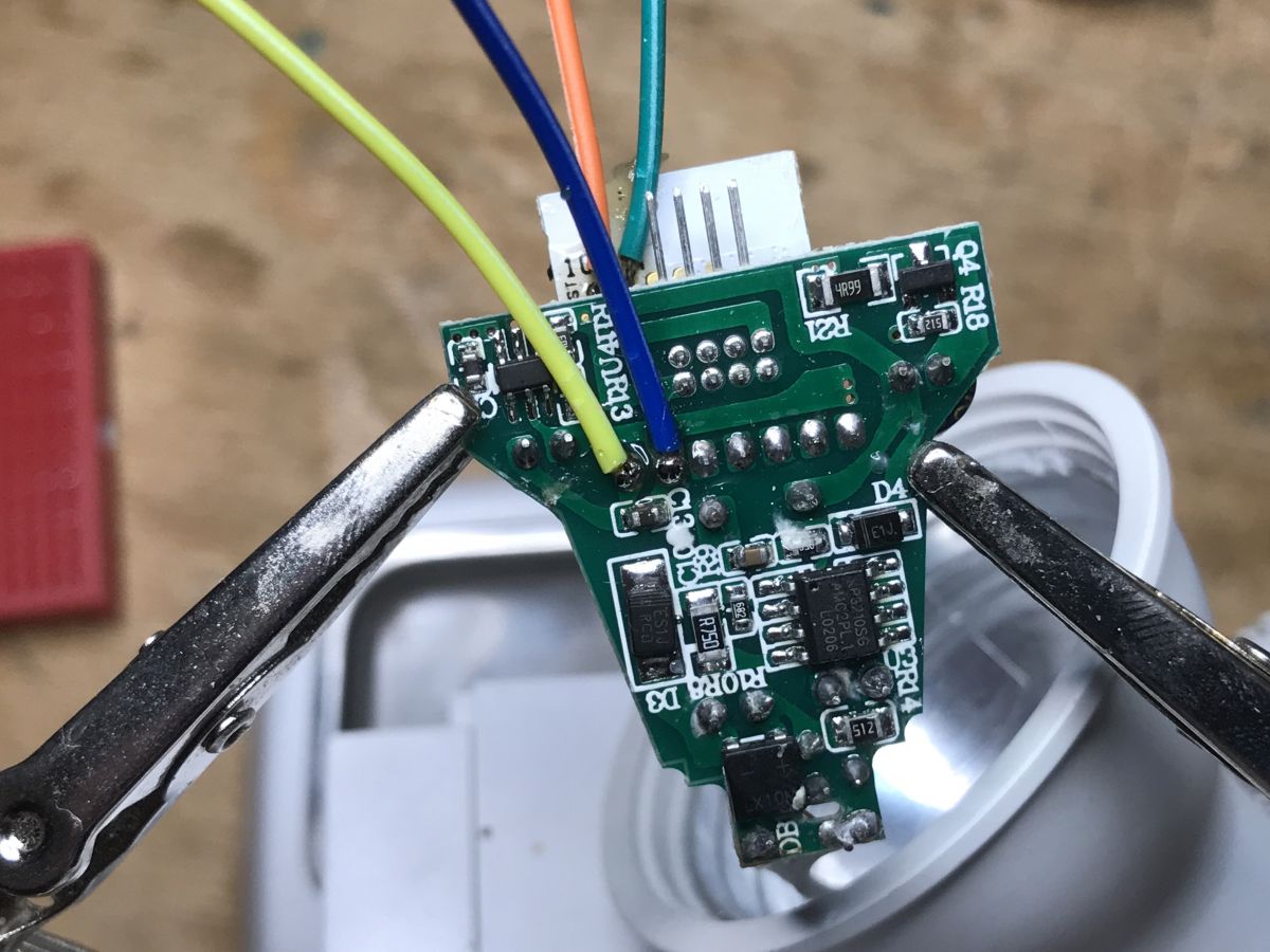

    This time, however, I did not use the method with the CEN/RST pin, I just rebooted the system by cutting off and reconnecting the power supply.

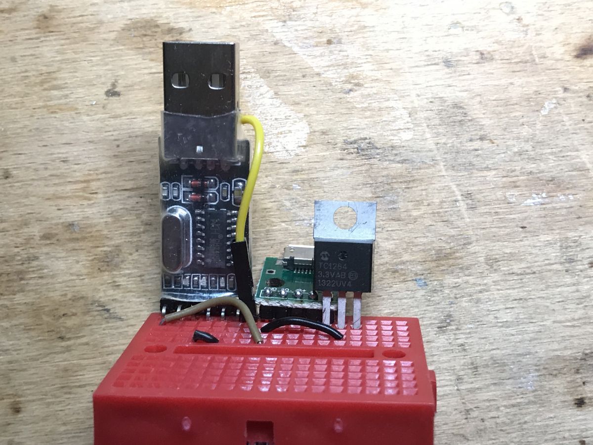

    You need a USB to UART converter in 3.3V mode (the one based on CH340G is reliable) and four wires - 3.3V, ground, RX1 and TX1. Unfortunately, the signals from the UART are on the bottom of the WB2L, as in the pictures:
    In addition - on the breadboard - a 3.3V LDO regulator (to get 3.3V from 5V), a USB to UART converter and a separate 5V connector for powering the LDO (disconnecting the power supply will be needed to reboot the system while the programmer is working, we cannot power LDO regulator from the same USB port in which the USB to UART converter is located, because too high starting current would reset the USB and stop programming at the very start):

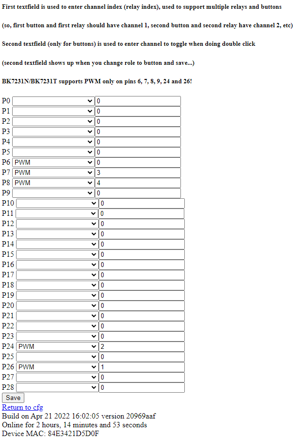

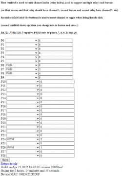

    Pin configuration:

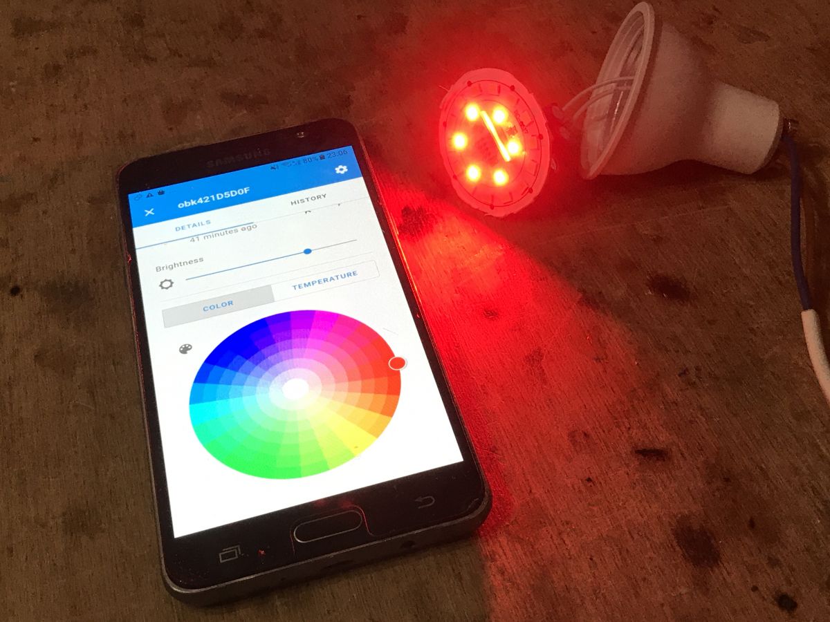

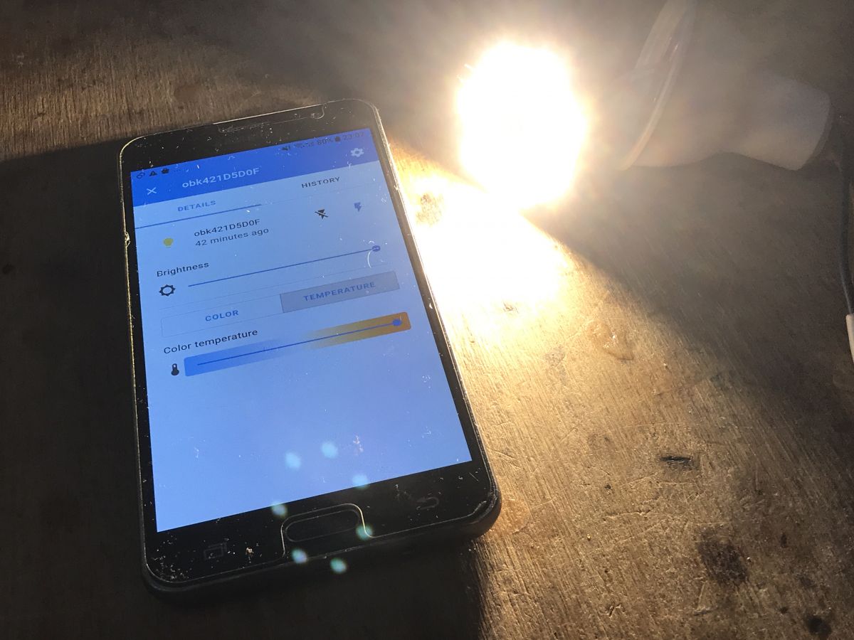

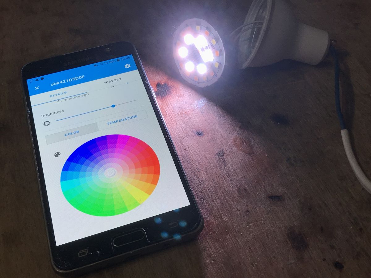

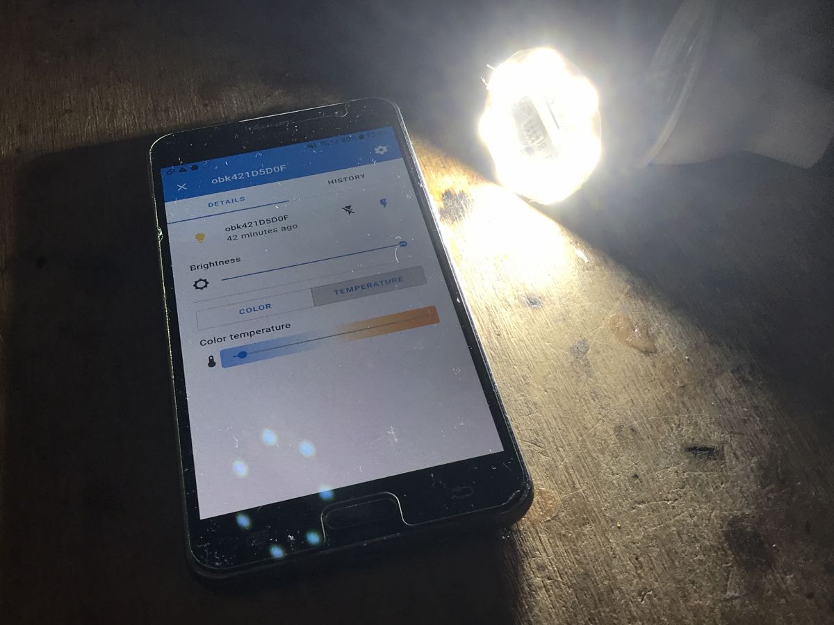

    But now we have Home Assistant Discovery support in OpenBeken:
    Effects:
    [WB2L/BK7231T] LED lamp Fcmila smart spotlight GU10 RGBCW [WB2L/BK7231T] LED lamp Fcmila smart spotlight GU10 RGBCW [WB2L/BK7231T] LED lamp Fcmila smart spotlight GU10 RGBCW [WB2L/BK7231T] LED lamp Fcmila smart spotlight GU10 RGBCW [WB2L/BK7231T] LED lamp Fcmila smart spotlight GU10 RGBCW [WB2L/BK7231T] LED lamp Fcmila smart spotlight GU10 RGBCW [WB2L/BK7231T] LED lamp Fcmila smart spotlight GU10 RGBCW

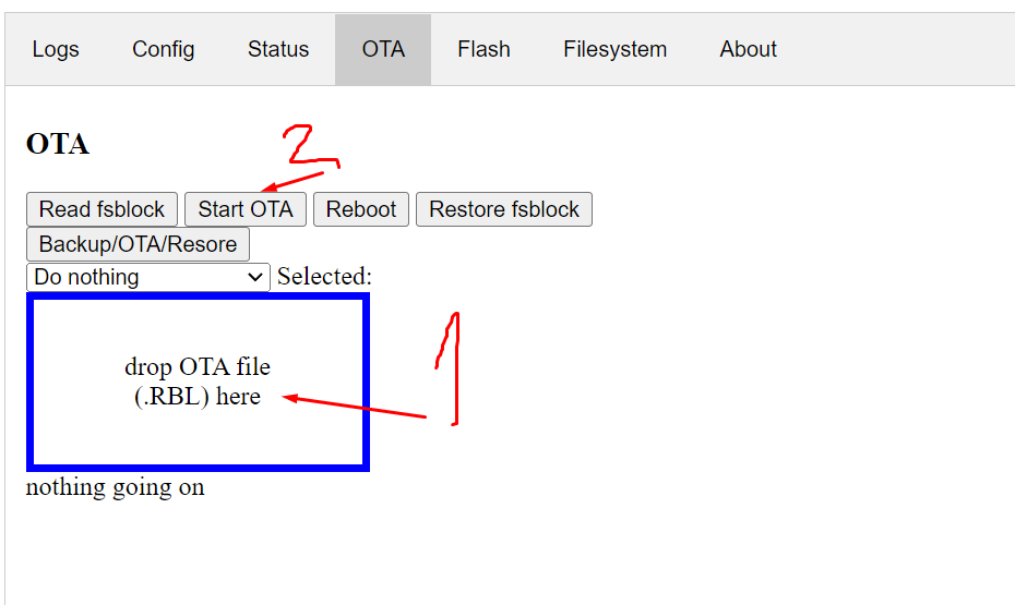

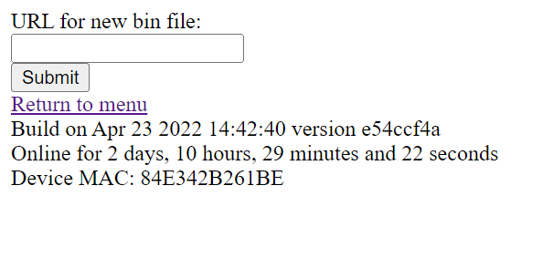

    Add-on - OTA in OpenBeken
    OpenBeken supports OTA, i.e. batch update via WiFi. We must have OpenBeken already uploaded to our device beforehand. There are two OTA modes.
    - mode via a link to the RBL file (for example from Github), i.e. in Config->OTA:
    - mode by "drag and drop" the file (drag) to the field in the browser, it is in the Web App panel in the OTA tab:
