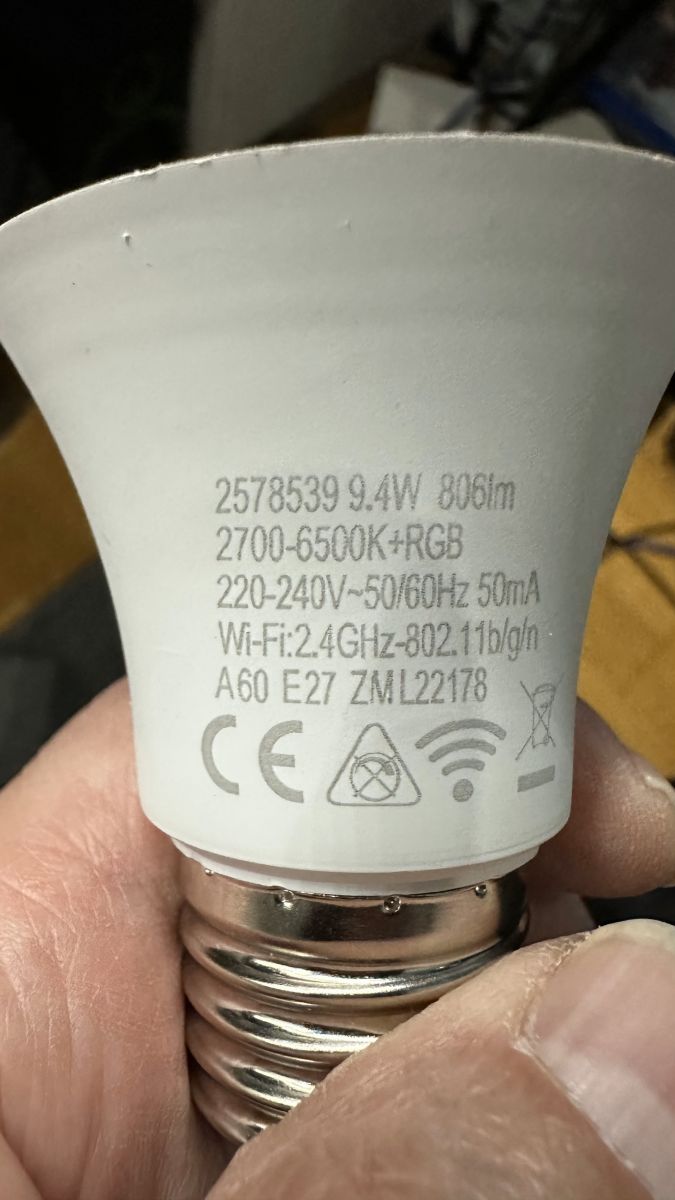

  • The LSC/Action 2578539 A60 E27 RGBCW 806-lumen bulb now uses a BK7231N instead of the earlier BK7231T.
  • Its BP5758D and color-remap pin assignments changed, so it needs a new OpenBeken template and updated teardown photos.
  • The bulb runs Tuya firmware 1.3.21 and can be flashed by TCC or by wires.
  • After flashing, it works with Tasmota Devices Groups and pairs with Home Assistant for local control without the Tuya cloud.
  • Newer revisions may be patched against Wi‑Fi flashing, but wired flashing should still remain possible.
  • Empty packaging of LSC Smart Connect E27 bulb, displaying product specifications.
    This is a new version of LSC/Action 2578539 bulb, previously described in this topic.
    The new version is based on BK7231N instead of BK7231T, features Tuya firmware 1.3.21 FW and is flashable by TCC or by wires.
    The pins used for BP5758D and colors remap were changed, so here I am attaching new template and photos provided by our reader.

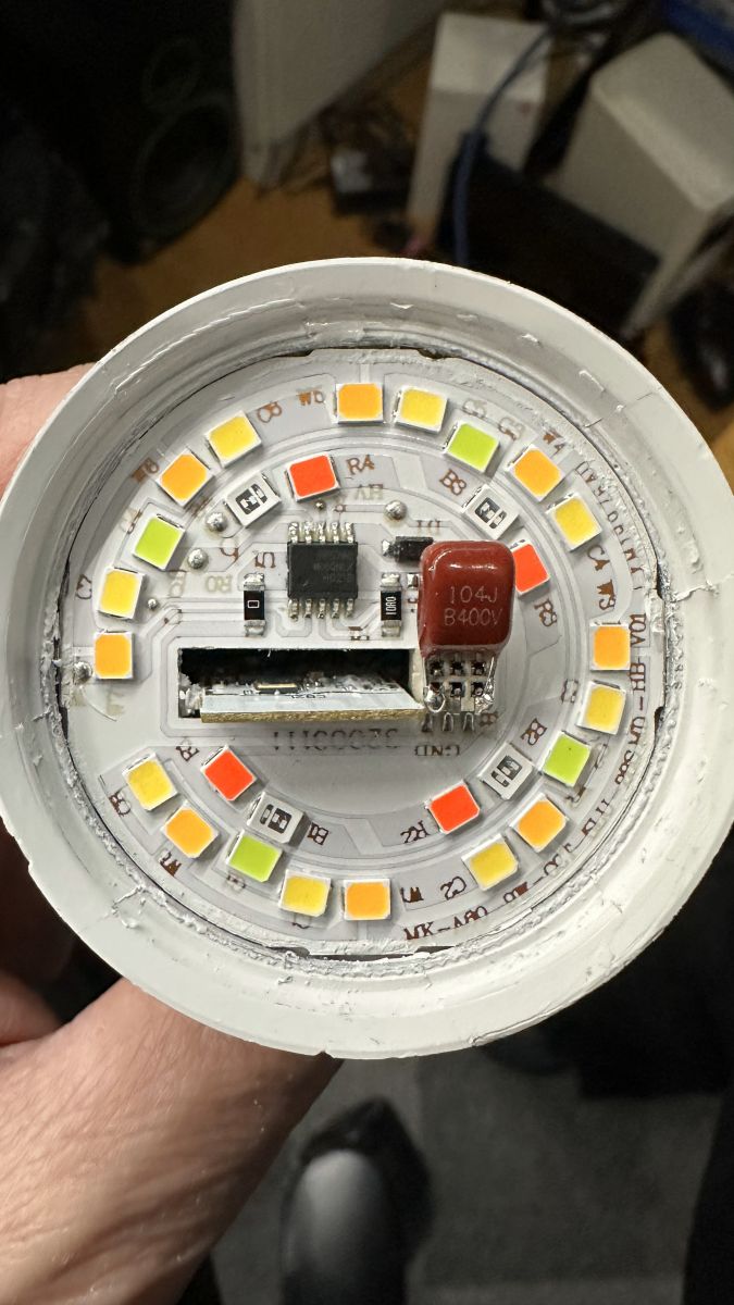

    First, device teardown:
    Interior of LSC/Action 2578539 LED bulb showing electronic components. Close-up of the new LSC bulb, model number 2578539. Back of packaging with barcode and product information for LSC/Action 2578539 bulb.

BP5758D pins Older template GPIO 7 = CLK, GPIO 8 = DAT
Color remap Older remap BP5758D_Map 4 3 1 0 2
Key insight: Treat this bulb as a new board revision, not a minor firmware update. The correct BK7231N template and the new BP5758D mapping are the difference between a clean OpenBeken setup and broken RGB/CW behavior.
  • The posted template identifies the bulb as LSC Smart Connect E27 RGBCW 9.4 W, 806 lumen, A60, using a BK7231N chip on the PCB. [#20860723]
  • The new revision uses Tuya firmware 1.3.21 and is reported as flashable either by TCC or by wired flashing. [#20860723]
  • For the BP5758D LED driver, the template assigns pin 7 = BP5758D_CLK;1 and pin 8 = BP5758D_DAT;0. [#20860723]
  • The required color-channel remap is BP5758D_Map 4 3 1 0 2, because the new revision changed both driver pins and color mapping. [#20860723]
