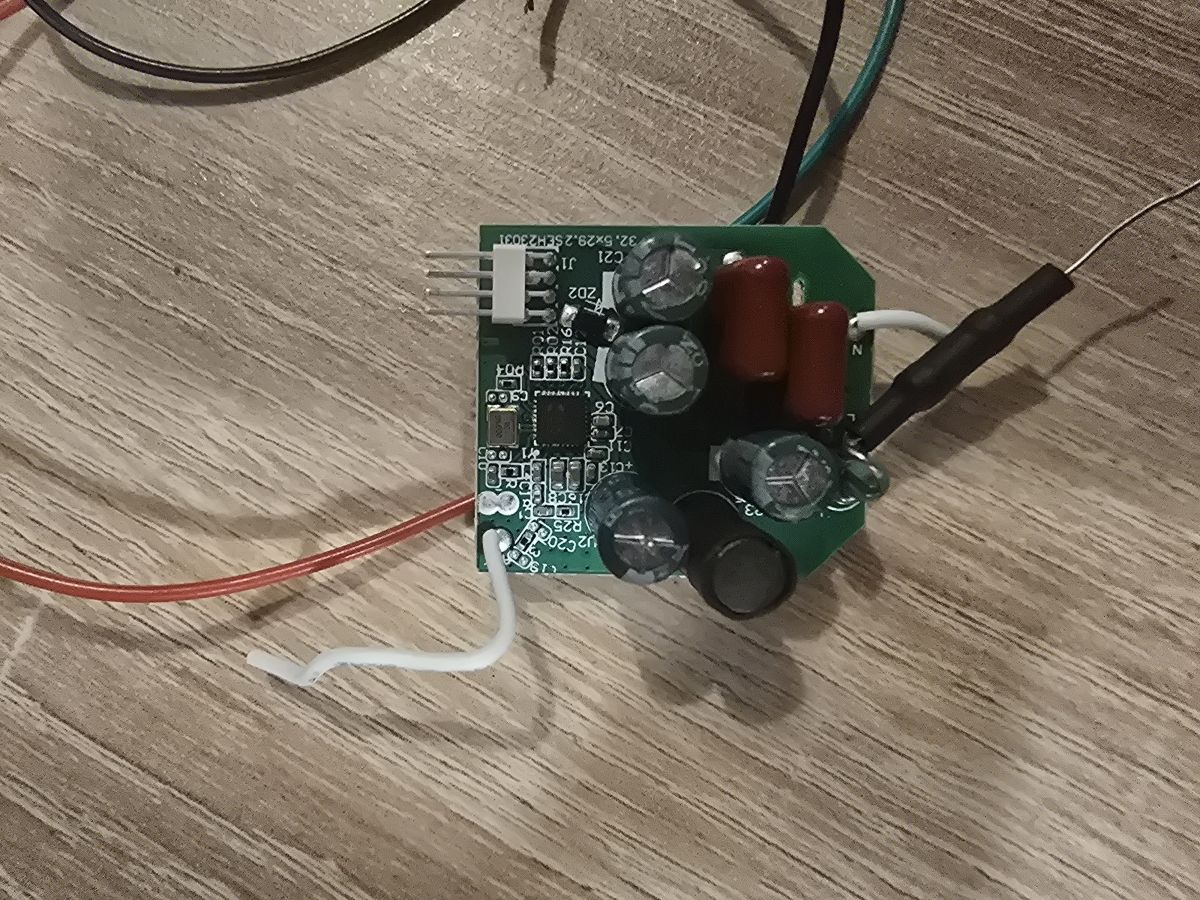

    Hey guys, I just bought 3 LSC light bulbs and honestly, I didn't check the reference.
    So that's the 2578539.2 model, firmware 1.5.32
    For some reason I can't flash it with bk7231 easy uart flasher. (Getting bus failed) Close-up of LSC lamp circuit board with connected wires.
    Anyone have encountered this problem?
    My uart converter is working properly with some other device but not this model.
    Seems like there is no power going to the chip?

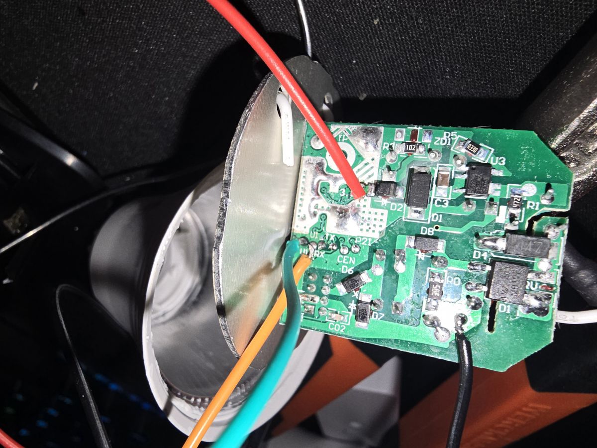

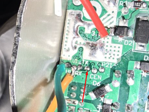

  • #2 21244226
    Posts: 14754
    Rate: 12875
    Maybe wrong pins? Isn't U1_TX where I pointed the arrow?
    Close-up of a PCB with connected wires and pin labels, including U1_TX indicated by an arrow.
  • #3 21244231
    mattistiret1
    Posts: 6
    I'll try that soon and let you know :)
  • #4 21244235
    Posts: 14754
    Rate: 12875

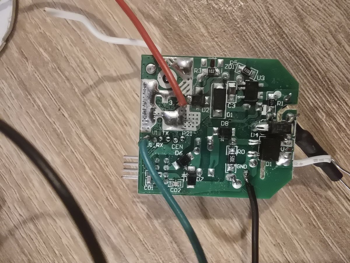

    How it looks from the other side? Maybe we can look at the traces to double check which are UART1.

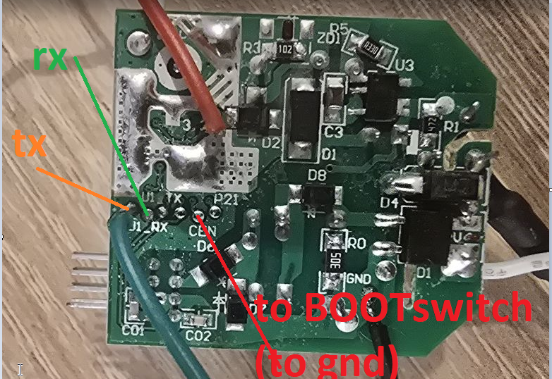

  • #5 21244245
    mattistiret1
    Posts: 6
    Circuit board with capacitors and wires on a wooden table Close-up image of a circuit board with various electronic components and connected wires.
    There you go :)
    Added after 47 [minutes]:
    That doesn't work either
    BK7231N QFN32 header and BP5758D driver used

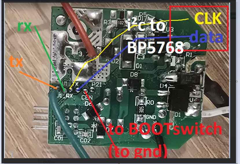

    #6 21287571
    plekke
    Level 4  
    Posts: 7
    >>21244245
    check my schematic, what worked very good
    https://i.imgur.co Close-up of a circuit board with labeled wires: RX, TX, and BOOTswitch to GND. m/999GUqv.png
    Added after 19 [minutes]:
    esphome: name: lscrgbcct friendly_name: LscRGBCCT
    bk72xx: board: generic-bk7231n-qfn32-tuyathis is my header

    Hi! This wiring is working but, I had to unplug the 3.3V cable.
    I'm not powering it to flash them and it works like a charm
    The pinout you gave me isn't working by the way here is what I got from reading the config from tuya firmware (also not working) :
  • #8 21298130
    plekke
    Level 4  
    Posts: 7
    Image of a circuit board with labeled RX, TX pins and i²c connection to the BP5768 chip.
    indeed, the chip is BP5768, and the esphome library is written for BP5758
    i also did not find the difference in i²c protocols....
    on the bk-chip, i²c clk is pin 24, and i²c data is pin 26
    i added the pinout in the image

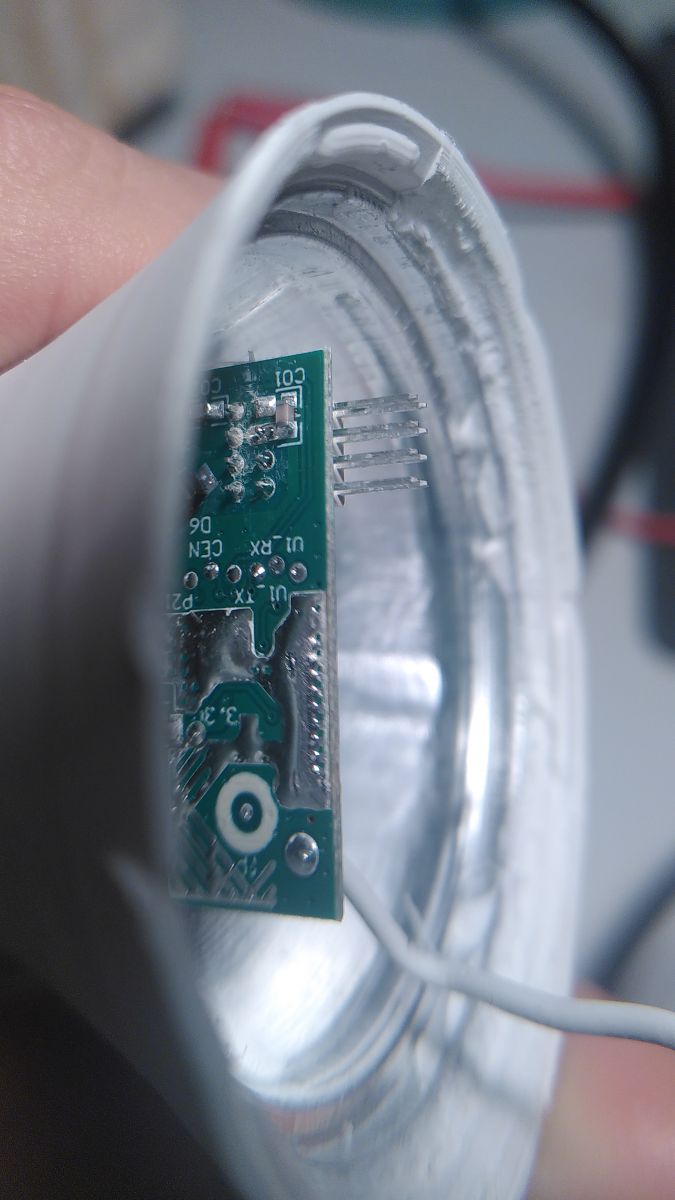

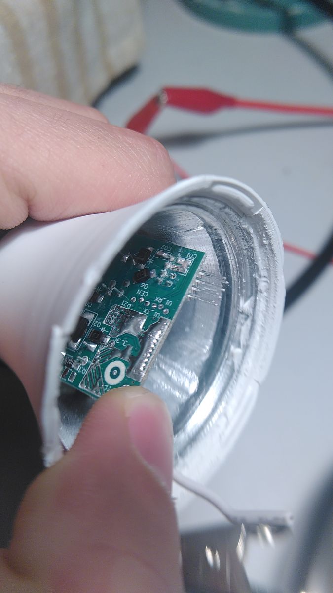

    gehaxelt
    Posts: 14
    Yes, I issued a "reboot" through the Web UI button. I have just retested using physical power on/off reboots, but no change.
    EDIT: Yes, the driver(s) are running according to the main page. My assumption was that maybe the wrong pins/channels are set?

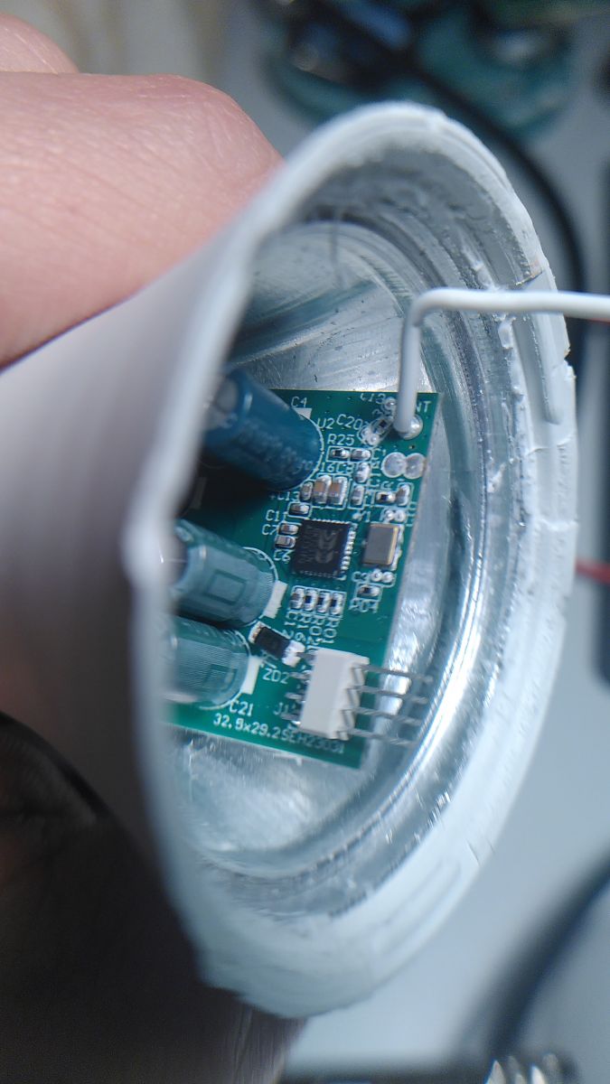

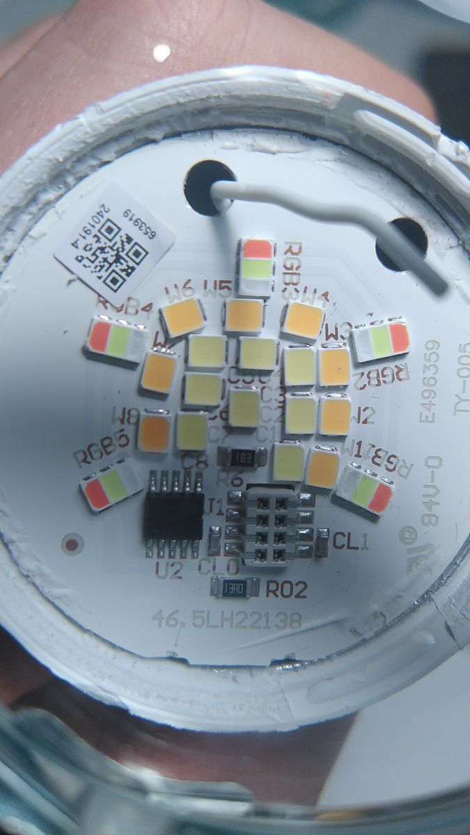

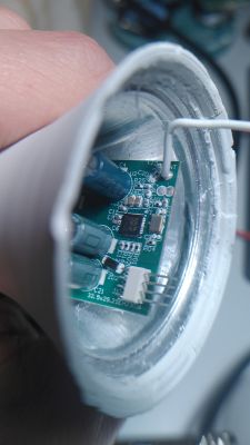

    Here are the images of the PCB:
    Close-up of a circuit board with multicolored LEDs and two wires connected at the top.
    Person holding a circuit board inside a white cylindrical casing.
    Close-up of a circuit board inside a casing with visible capacitors and a connector.
    Close-up of a circuit board with visible electronic components and pins.

    OK. I see where 9, 24 comes from
    so re-reading past experiences above it seems @Matistreet got their 2578539.2 with BP5768D working fully? in OBK?
    Yours is a 2576539.2 with BP5768D so the expectation is that the OBK BP5758D driver is OK on BP5768D.

    You were right and I have some good news! Using my little DSO138 oscilloscope, I managed to identify the PINs used in the original firmware. These correspond to Pin 7 + 8 in OBK, so with a bit of trial and error I identified the right configuration to make this light bulb work:

    The LED map had also to be changed. Can we somehow fix the bktools extractor to find the correct driver and pins?
