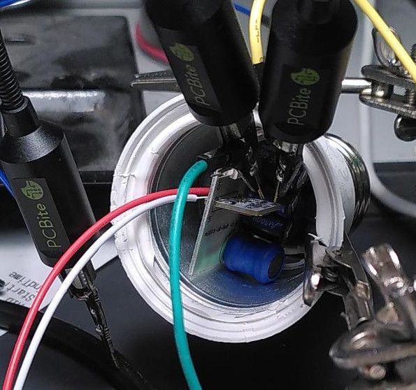

    Teardown of LSC Smart Connect bulb with connected wires and PCBite probes
    After opening the bulb, I learned the following:
    - It comes with a CBLC5 module from Tuya which contains a BK7231N.
    - The LED driver appears to be KP18058 (?)
    - Since I didn't want to remove the PCB from the socket for easier reassembly, I soldered VCC and GND and used PCBites for TX1 and RX1. There's not much space, but flashing worked out without problems with BKN Flasher GUI and the power on/off method.

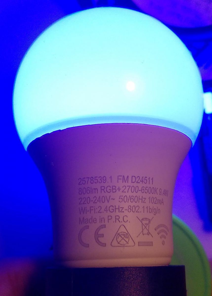

    LSC Smart Connect A60 E27 RGB bulb glowing brightly.

    1) The bulb got really hot (OpenBeken reported 100*C after 5mins). I don't think this is normal - do I need to limit the LED's current using KP18058_Cur? What are sensible values?
    Might be an idea to mirror those values in OBK
    Have you also set powersave 1 in startup command or autoexec?
  • #3 21422346
    gehaxelt
    Posts: 14
    Hi,
    thanks! I have played around with the values a bit and setting the current to 4 4 keeps the bulb below 80° C at 100% brightness.
