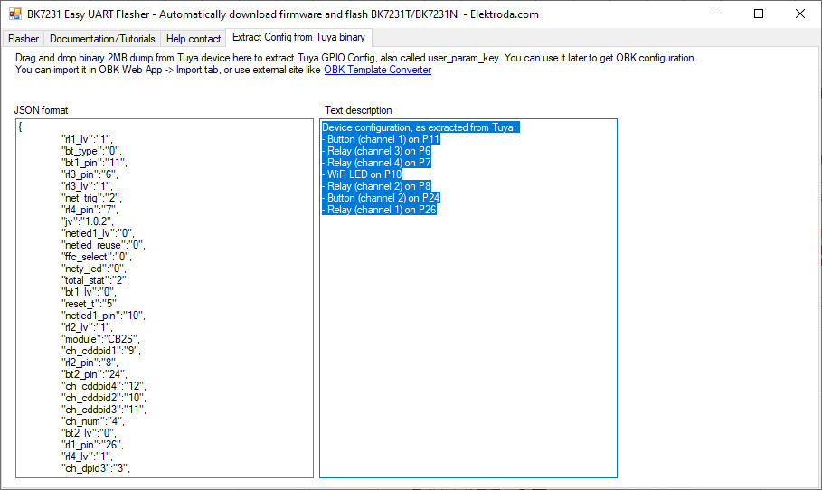

    WK-US2-TC is a dual MOES smart socket that features also an USB output (5V/2.1A) with both Type-C and Type-A socket. Product ASIN is B0BV9HRPMN, manufacturer is WENZHOU NOVA NEW ENERGY CO.,LTD. This MOES smart socket can easily run OpenBeken, and can be also flashed both via UART and by Tuya-cloudcutter (via WiFi).

    Here's OpenBeken template, as exported by BK7231 Easy Flasher (our tool can detect Tuya config and automatically configure OBK):
    [BK7231N/CB2S] MOES Smart USB Wall Outlet with USBC charger WK-US2-TC (5V/2.1A)
    Here's OBK json:
    And here's pin description:
    - Relay (channel 1) on P26
    - Relay (channel 2) on P8
    - Relay (channel 3) on P6
    - Relay (channel 4) on P7
    - WiFi LED on P10
    - Button (channel 1) on P11
    - Button (channel 2) on P24
    Sadly enough it doesn't look like this device supports fast charging, but I would be happy to be proven wrong.
