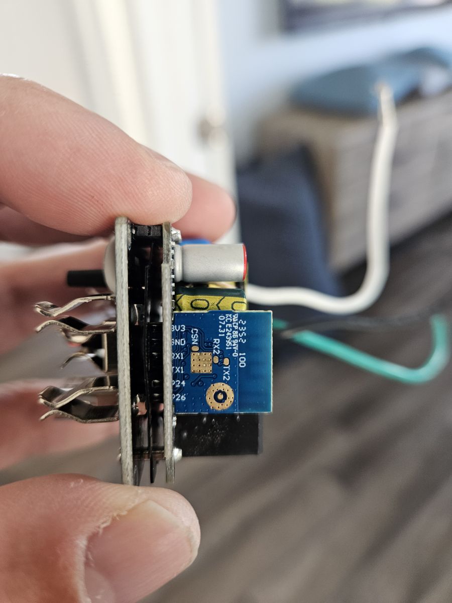

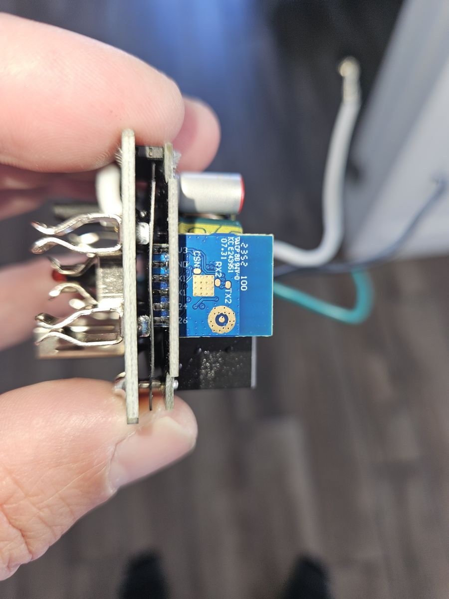

    #3 21105746
    123qweasd1
    Posts: 17
    It is my next option, however at first glance I guess I'll have to order the 2x104 capacitors and voltage regulator as per proposed connector (is there any flexibility on parts ratings and/or can I use the same USB to TTL Serial Adapter (CH340) as for Tasmota flashing?
    Also the chip can't be extracted and contacts are not easy to reach.
    But I'm willing to give it a try if chances of success are good.
    Let me know what you think.
    Thx
    Close-up of an electronic chip held between fingers, showing components and connections. Close-up of a circuit board held in hands with visible components and wires.
  • #4 21105782
    Posts: 14770
    Rate: 12913

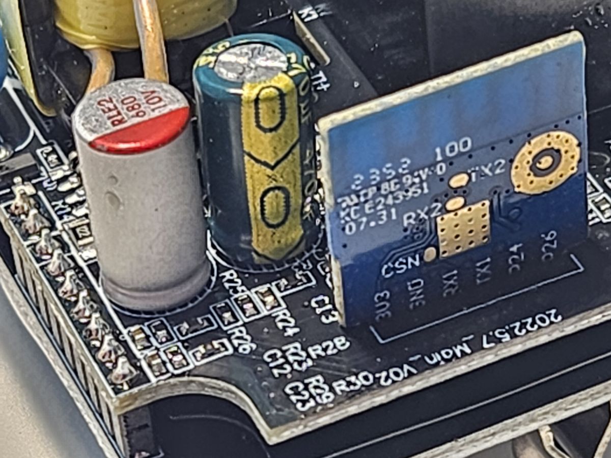

    Those 104 capacitors are not necessary, and if your device has LDO on the board (please provide more photos), you can just use it.
  • Confirming AMS1117 LDO and in-circuit flashing wiring

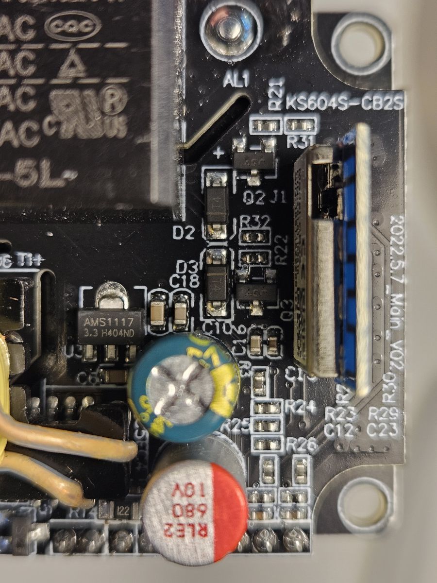

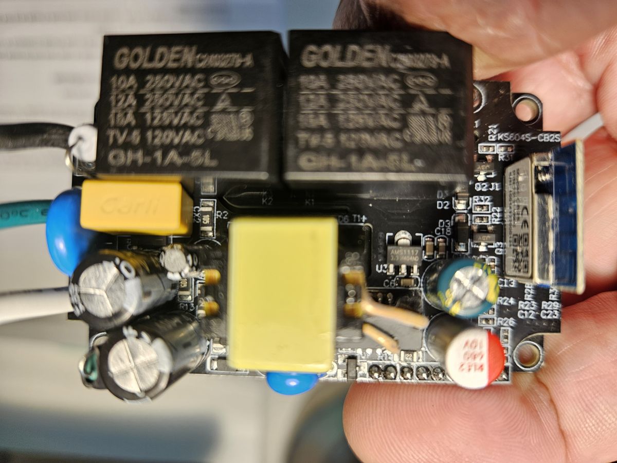

    #5 21105795
    123qweasd1
    Posts: 17
    Below.
    I guess the AMS1117 is the onboard LDO? Can you confirm revised connector wiring if I am to try it?
    Also do you think it can be done "in-circuit" as removing the top board would be beyond my tools & efforts I am willing to deploy.
    Close-up of a circuit board with electronic components and an AMS1117 module. Close-up of a circuit board with a CB2S module and electronic components. Close-up of a circuit board with visible components, including an AMS1117 regulator. Electronic circuit board with components such as connectors, LEDs, and wires. Close-up of a circuit board with connectors and electronic components, including AMS1117.
    PS: pictures are from the KS-604S; I ordered both models for testing. They are very similar in design and neither can be flashed with Cloudcutter.
  • #6 21105876
    Posts: 14770
    Rate: 12913
    If RX/TX is not used for anything, then you can try flashing in circuit.
    Connect 5V to the input of AMS1117-3.3V (check datasheet! Triple check it!) and GND to GND, then connect RX to TX and TX to RX (as usual).
    Start flashing in flasher (first read 2MB backup),, then disconnect and reconnect 5V power to do a power cycle.
    It should start flashing.

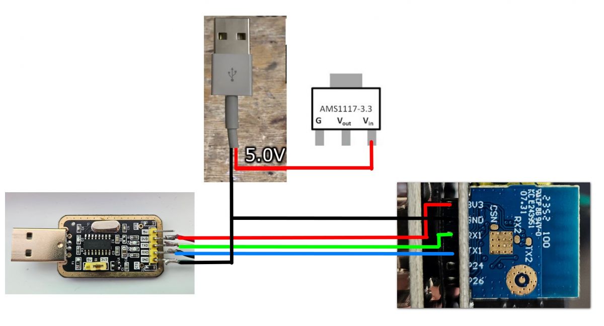

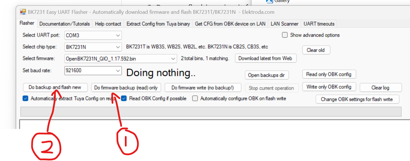

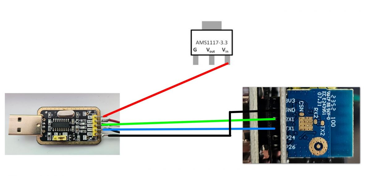

    Thanks for the feedback, does this look right?
    Troubleshooting WK-US2-TC Flashing OpenBeken: Firmware 1.1.17 vs. 1.1.8 Issues
    Will be using BK7231GUIFlashTool, step 1 read to test, then step 2 (with power cycle once ready to write)
    Let me know if this makes sense; will report back once tested.
  • USB-to-UART wiring for AMS1117-3.3V input
    #8 21106090
    Posts: 14770
    Rate: 12913
    If your 5V pin on the USB to UART converter is connected directly to USB, then you don't need second USB cable.
    Futhermore, don't connect 3.3V from USB to UART to anything.
    You need to do:
    USB TO UART GND ---> to GND
    USB TO UART RX --> to TX
    USB TO UART TX ----> to RX
    USB TO UART 5V ---> To the input of LDO on your board (AMS1117-3.3V IN), so at the output of AMS1117-3.3 you get... 3.3V.
  • #9 21106124
    123qweasd1
    Posts: 17
    So like this (changing that jumper from 3.3v to 5v prior) right ?
    Wiring diagram connecting a USB converter with an electronic module via an AMS1117-3.3 voltage regulator.
  • #10 21106137
    Posts: 14770
    Rate: 12913
    This should work, but jumper for logic levels should be in 3.3V mode. UART levels are in 3.3V. And Beken is powered by 3.3V via AMS1117-3.3. You are connecting correctly 5V to the input of AMS1117-3.3V, but still, at the output of AMS1117-3.3, you get 3.3V.

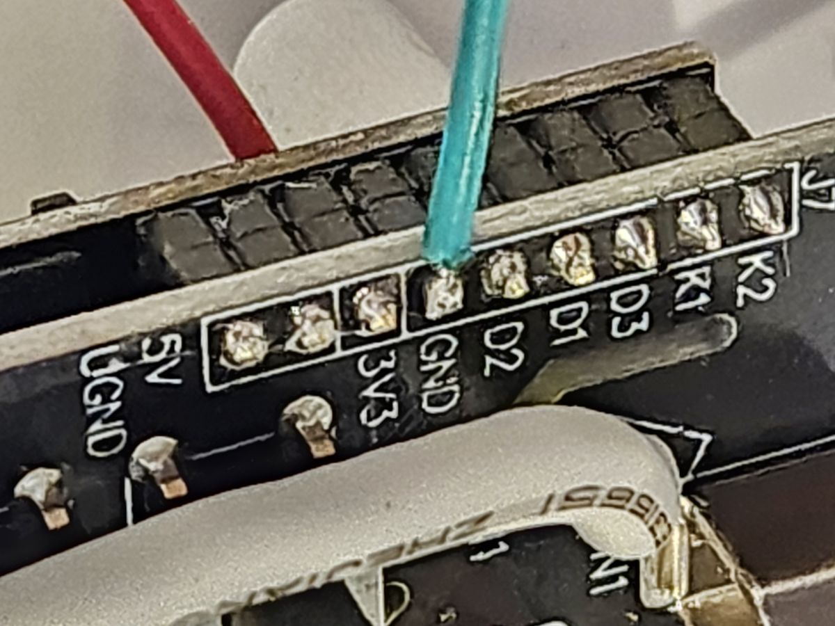

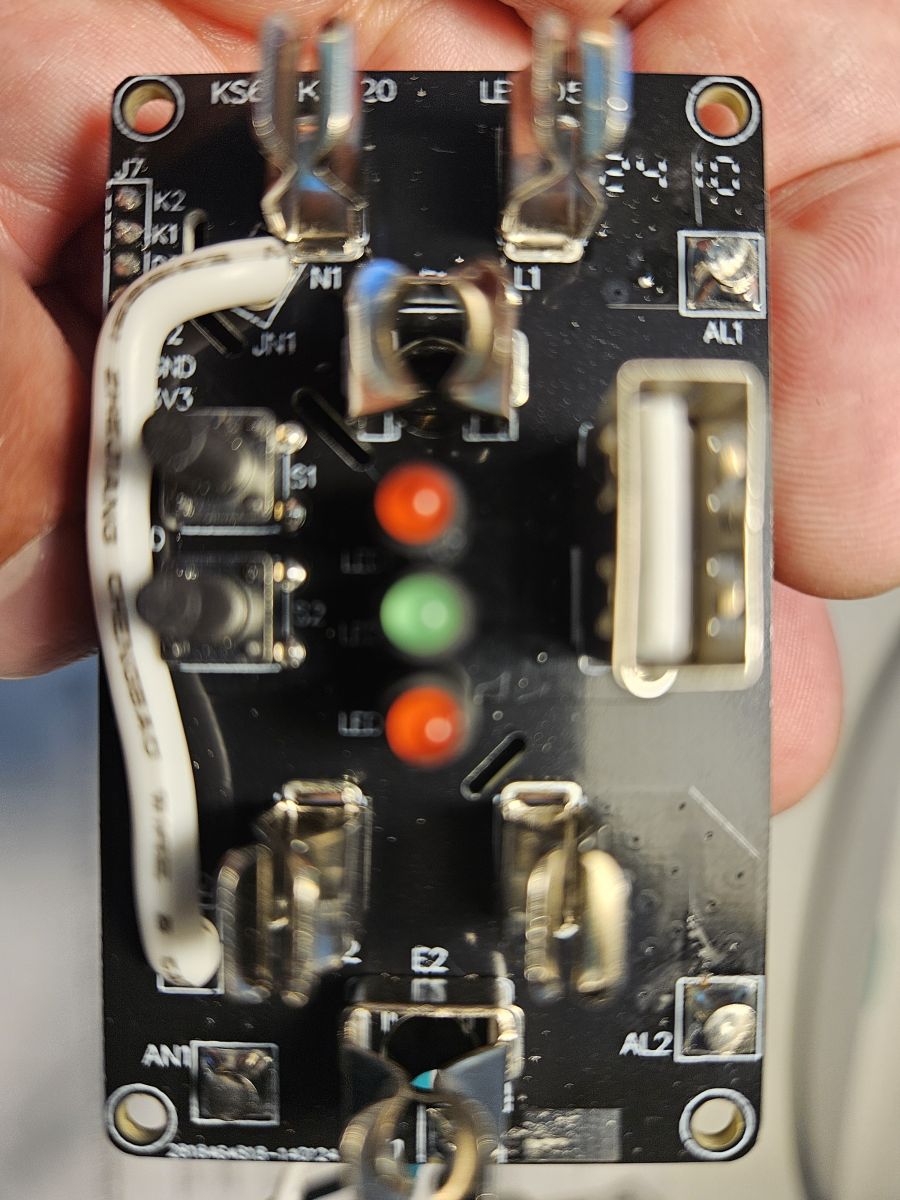

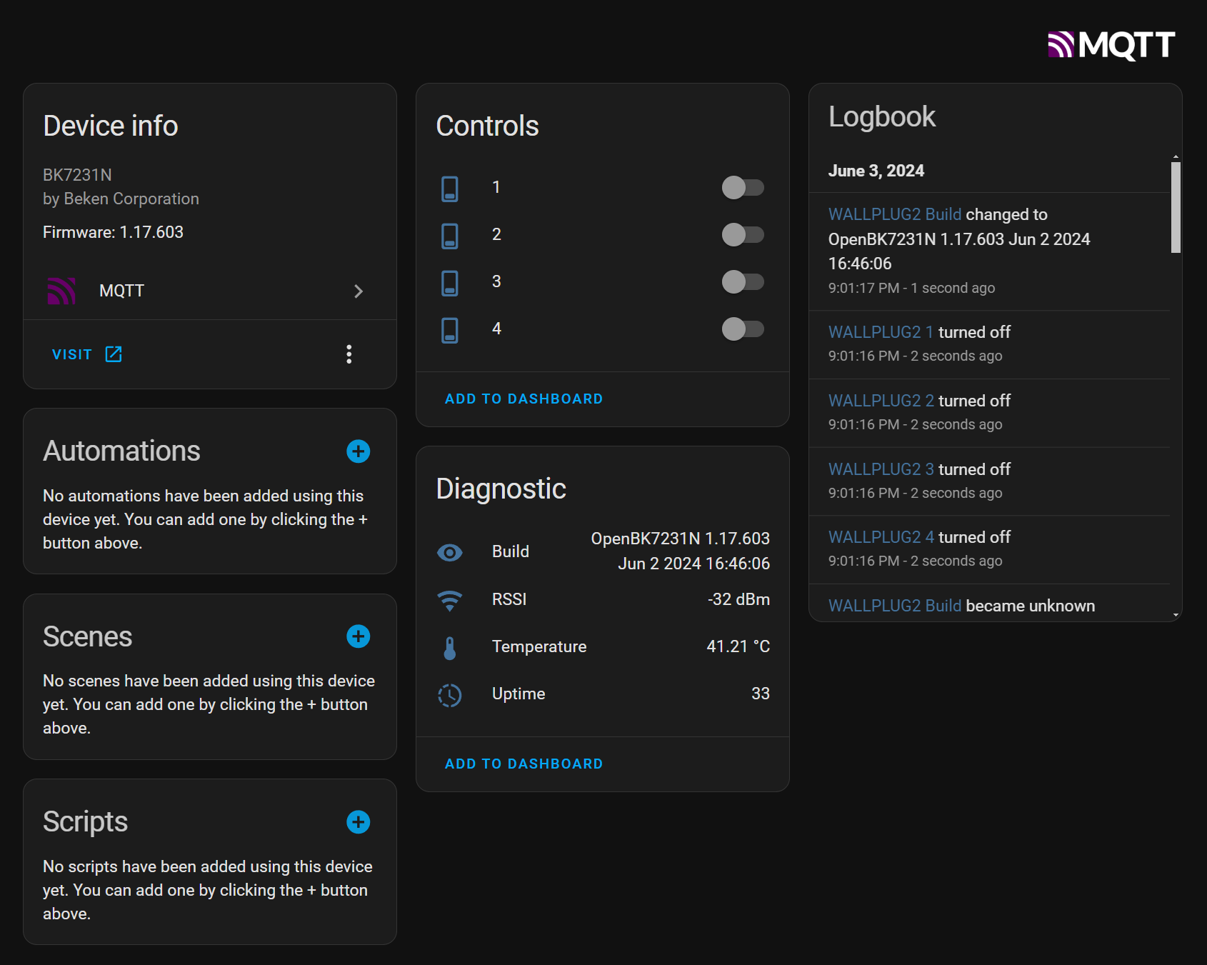

    Added after 4 [hours] 40 [minutes]:
    Success for KS-604S ! =)
    Control panel of the BK7231N device with diagnostic information and logbook.
    I have used ground from block J7 for easier access and a small inline switch on 5V to manage the restart required while flashing.
    Electronic module with visible markings and connections. Close-up of a prototype board with visible electronic components and connected wires. Close-up of an electronic connector with wires attached to the pins, with labels including 5V, GND, 3V3.
    - Button (channel 1) on P11
    - Relay (channel 3) on P6
    - Pair/Toggle All Button on P23
    - WiFi LED on P10
    - Relay (channel 2) on P8
    - Button (channel 2) on P24
    - Relay (channel 1) on P26
    Device seems to be using CB2S module, which is using BK7231N.
    What a great project. Congrats.
    Let me know if you need more feedback/data on this one.
    Thx

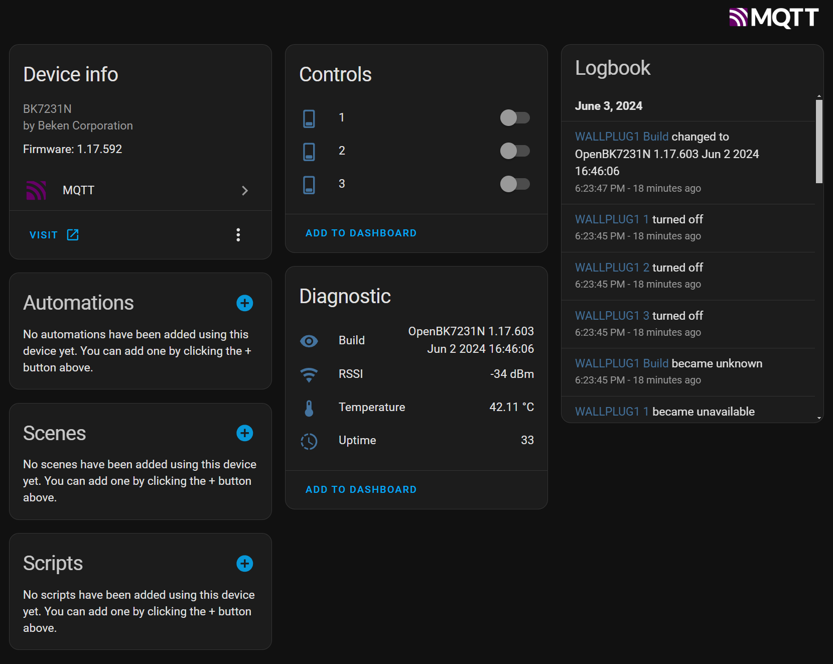

    Added after 2 [hours] 24 [minutes]:
    Success for WK-US2-TC ! =)
    MQTT software interface displaying device information and logs.
    I have used ground from the CB2S board as block J7 has no ID's on this model.
    - Relay (channel 4) on P7
    - WiFi LED on P10
    Original firmware backups attached as well.
    Hope this helps, cheers.

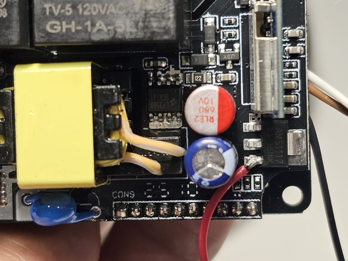

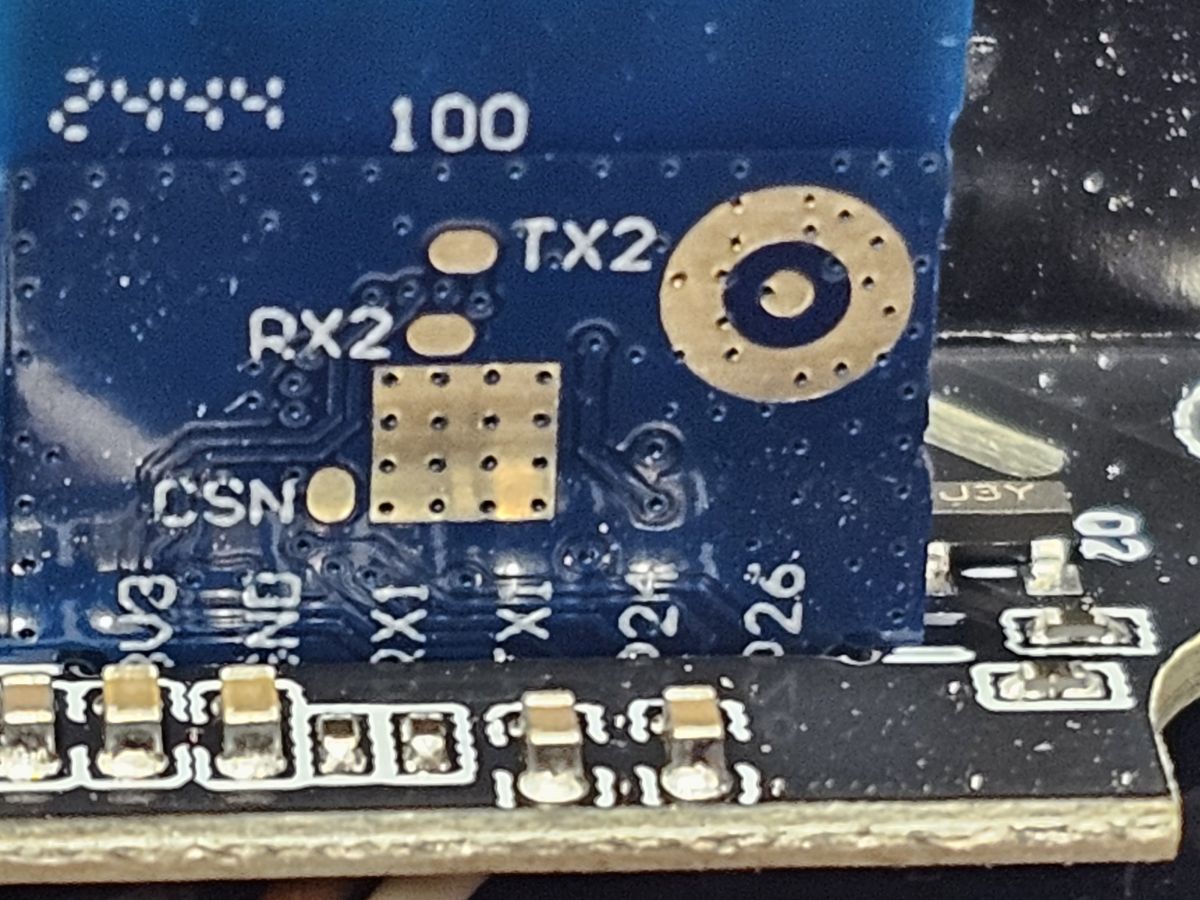

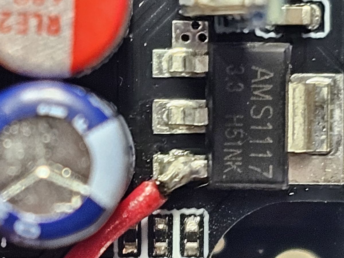

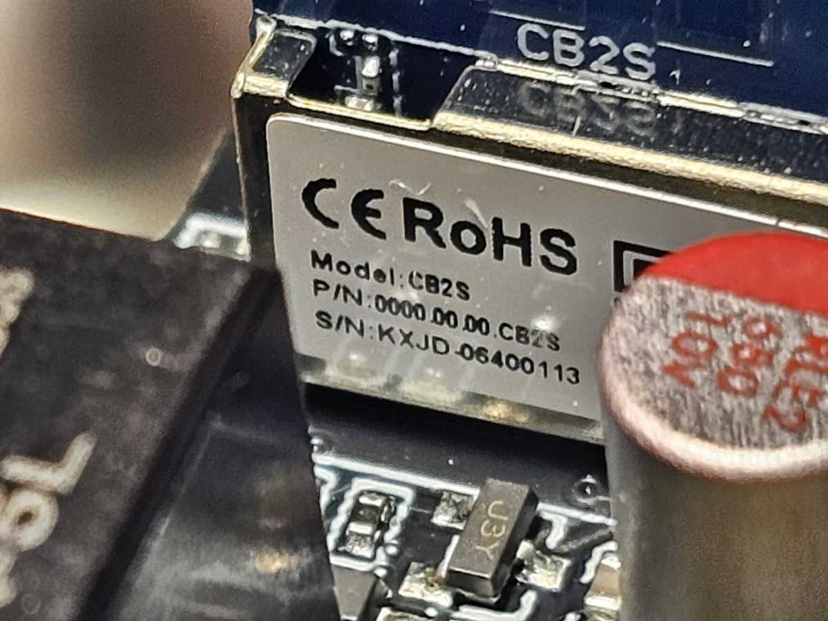

    #12 21707320
    123qweasd1
    Posts: 17

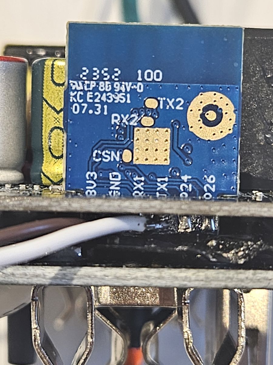

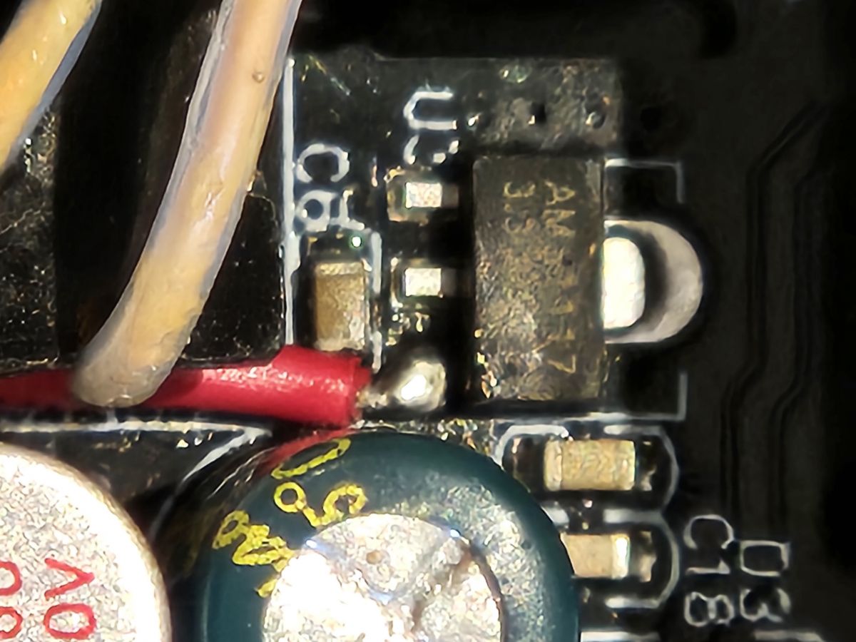

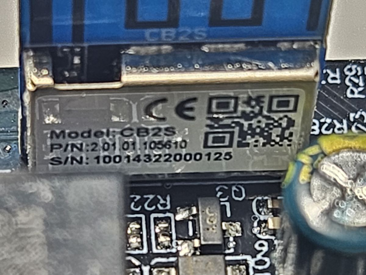

    Hi @p.kaczmarek2 ,
    The manufacturer (Moes) slightly changed the board design and I can't flash it anymore.
    CB2S is still there / identical.
    The only significant change is the AMS1117 location so I just connected 5V to the same 5V input pin on the AMS1117
    The device behaves as usual (lights on when connected to USB so I assume power is right)
    But when I try the 5V power off/on to start sync, it just never starts or fails.
    I've tried 2 units unsuccessfully and my soldering has been triple checked.
    Any clue what could be wrong or suggestions for troubleshooting? See pictures below:
    Close-up of AMS1117 voltage regulator and electrolytic capacitors on PCB
    Close-up of a PCB with electronic components, including capacitors and a relay
    Close-up of a blue PCB with labels TX2, RX2, GND and gold solder pads visible.
    Close-up of CB2S electronic module with CE and RoHS labels on a metal surface
  • #13 21709985
    123qweasd1
    Posts: 17
    >>21707320 And unfortunately the CEN pin doesn't seem to be exposed so I can't try the alternative method. Let me know what would be the best course of action or troubleshooting ideas. Thank you!
  • #14 21711057
    123qweasd1
    Posts: 17
    I was able to locate CEN on the CB2S board and tested the CEN to ground method, same result.
    Is it possible that this new model can only be flashed off circuit? (Almost impossible, too complicated to disassemble)
    Also can we use the 3.3v output from the USB-UART instead of feeding 5V to the LDO?
  • #15 21910116
    gomelkiev
    Posts: 15
    >>21711057 Look like yes, I also was not able to flash without de-soldering cb2s off pcb, when I shorted cen to gnd, I heard relay click (dnk). When I got cb2s out, everything worked as usual.
  • #16 21910372
    123qweasd1
    Posts: 17
    How did you get cb2s out? Thx
  • #17 21910451
    gomelkiev
    Posts: 15
    >>21910372
    I am using this:
    Amazon product page screenshot for SRA Fast Chip SMD removal kit, showing package photo and $9.99 price.
  • #18 21910477
    123qweasd1
    Posts: 17
    Did you have to separate the two main PCBs, or did you de-solder/re-solder by working between the PCBs?
  • #19 21910597
    gomelkiev
    Posts: 15
    >>21910477
    I completely separated both PCBs.
