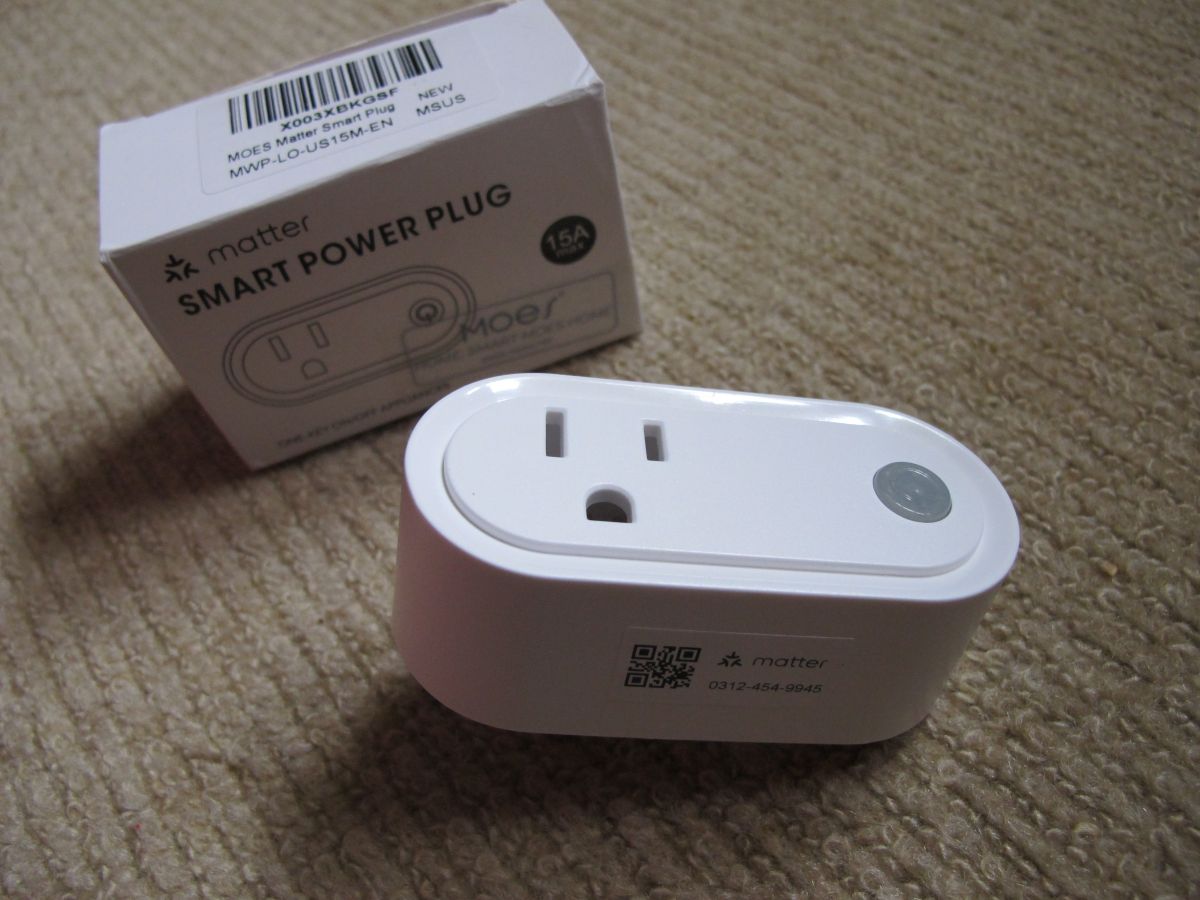

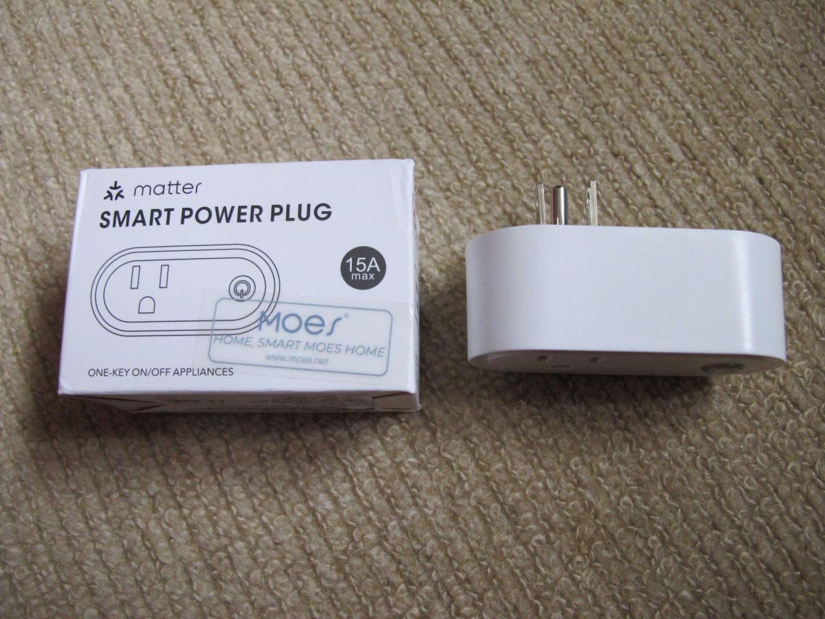

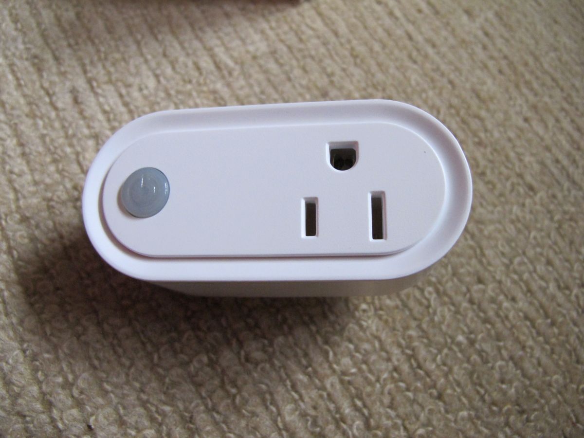

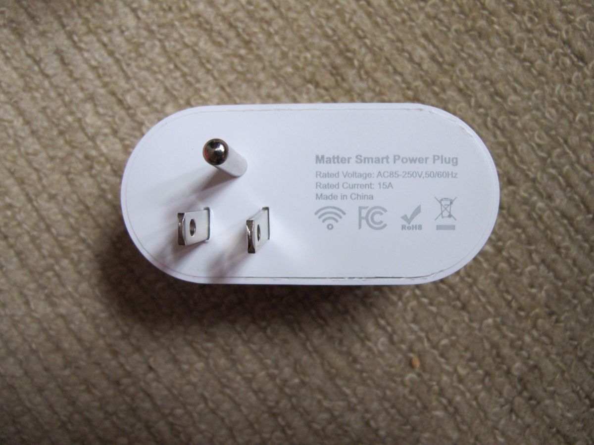

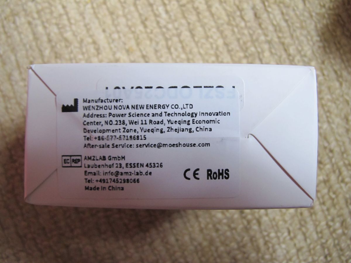

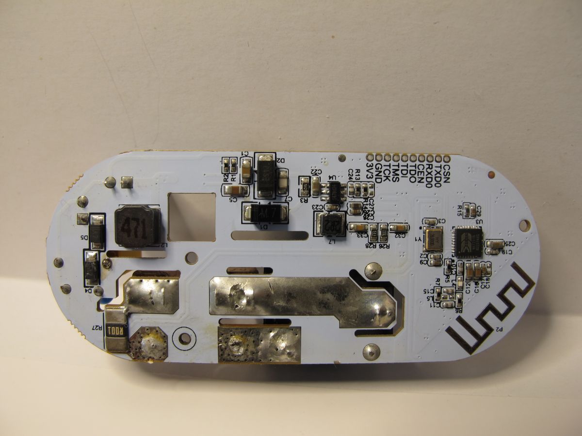

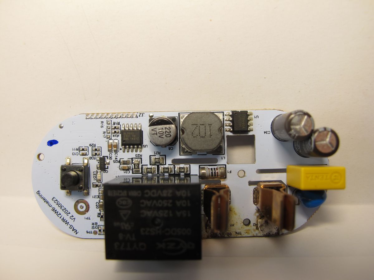

    MOES US Matter Smart Plug with power metering. BL0942/ BK7231N
    FW 1.6.15 boot log
    1.7.16 boot log
    MOES Matter smart plug lying on a carpet next to its box. Cardboard packaging of MOES smart plug. PCB of a MOES smart plug with power measurement on a box. Manufacturer label on the packaging of the MOES smart plug. MOES smart power plug with power measurement next to the box. MOES smart plug on a light carpet with a button on the left side. MOES US Matter smart plug on a light background with printed specifications. MOES US Matter smart plug with electronic components on a circuit board. Electronic components of MOES US Matter smart plug on a white PCB. Internal circuit board of the MOES smart plug. Circuit board with electronic components, including ZK QYT73 relay and capacitors. Circuit board of MOES smart plug with electronic components.

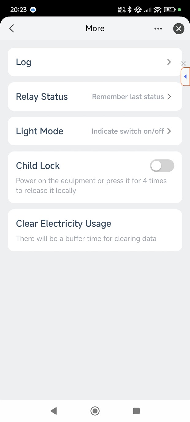

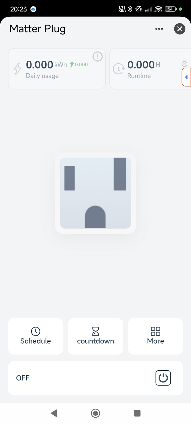

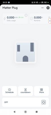

    Smart plug app screen with power measurement Tuya app settings screen with options like Log, Relay Status, Light Mode, Child Lock, and Clear Electricity Usage.

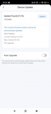

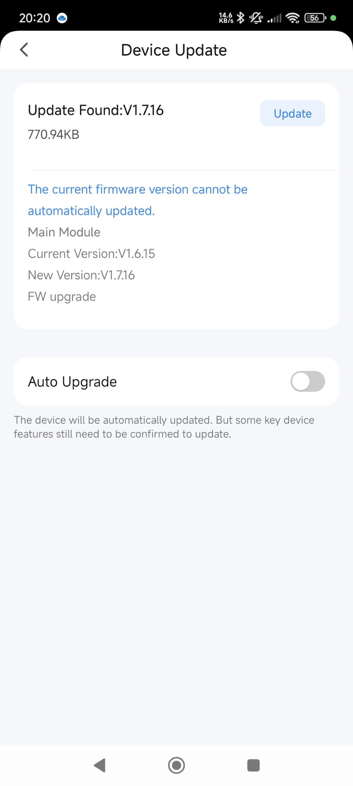

    Tuya app offers update from 1.6.15 to 1.7.16
    Device update screen showing availability of version V1.7.16

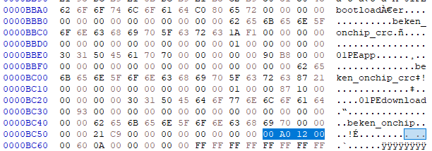

    same partition layout as the MOES Matter bulb https://www.elektroda.com/rtvforum/topic4074263.html
    bootloader has 0 start
    00 00 01 00 -> 0x10000 length
    app partition 00 00 01 00 -> 0x10000 start
    00 87 10 00 -> 0x108700 length
    download partition 00 A0 12 00 -> 0x12A000 start
    00 60 0A 00 -> 0xA6000 length
    Image of a hexadecimal code fragment for an error related to the MOES smart plug.

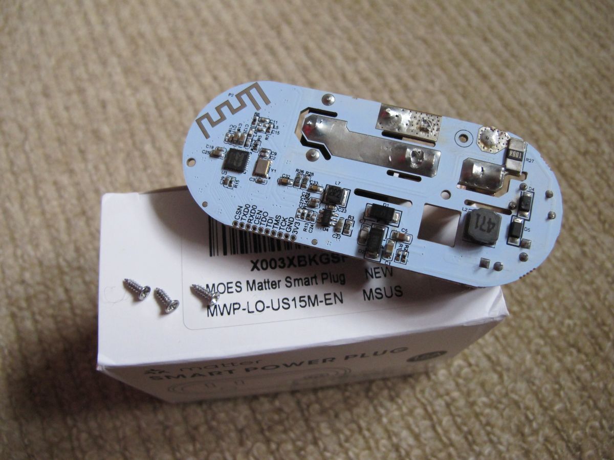

    NAS-WR12W6-metering
    V2 20230523
    MWP-LO-US15M-EN

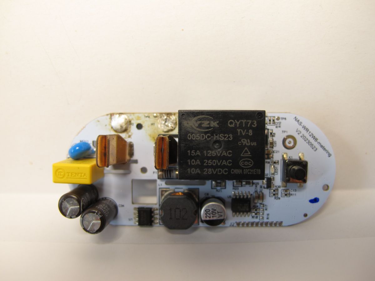

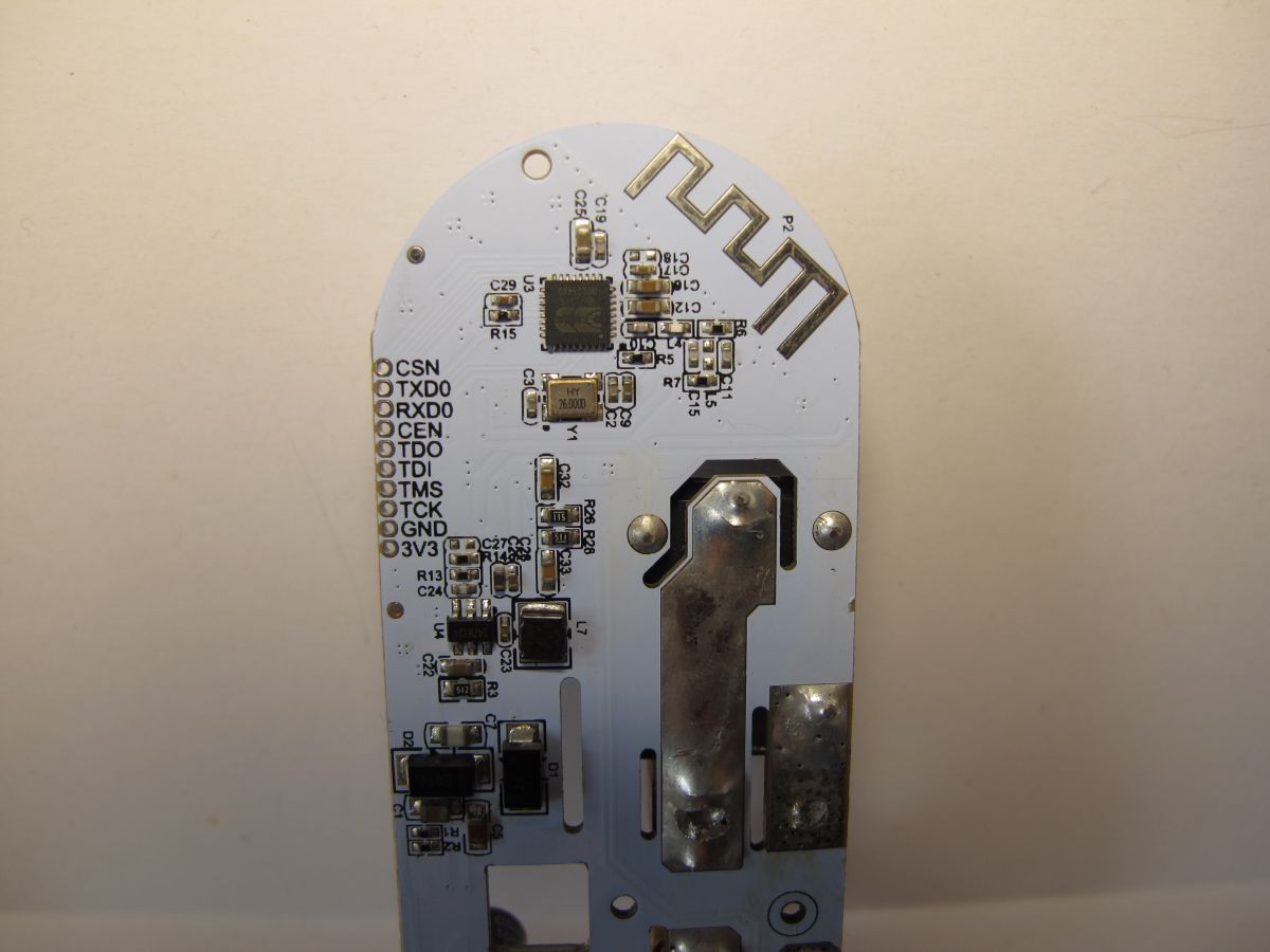

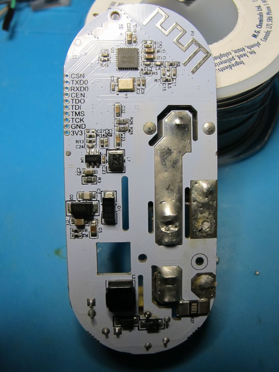

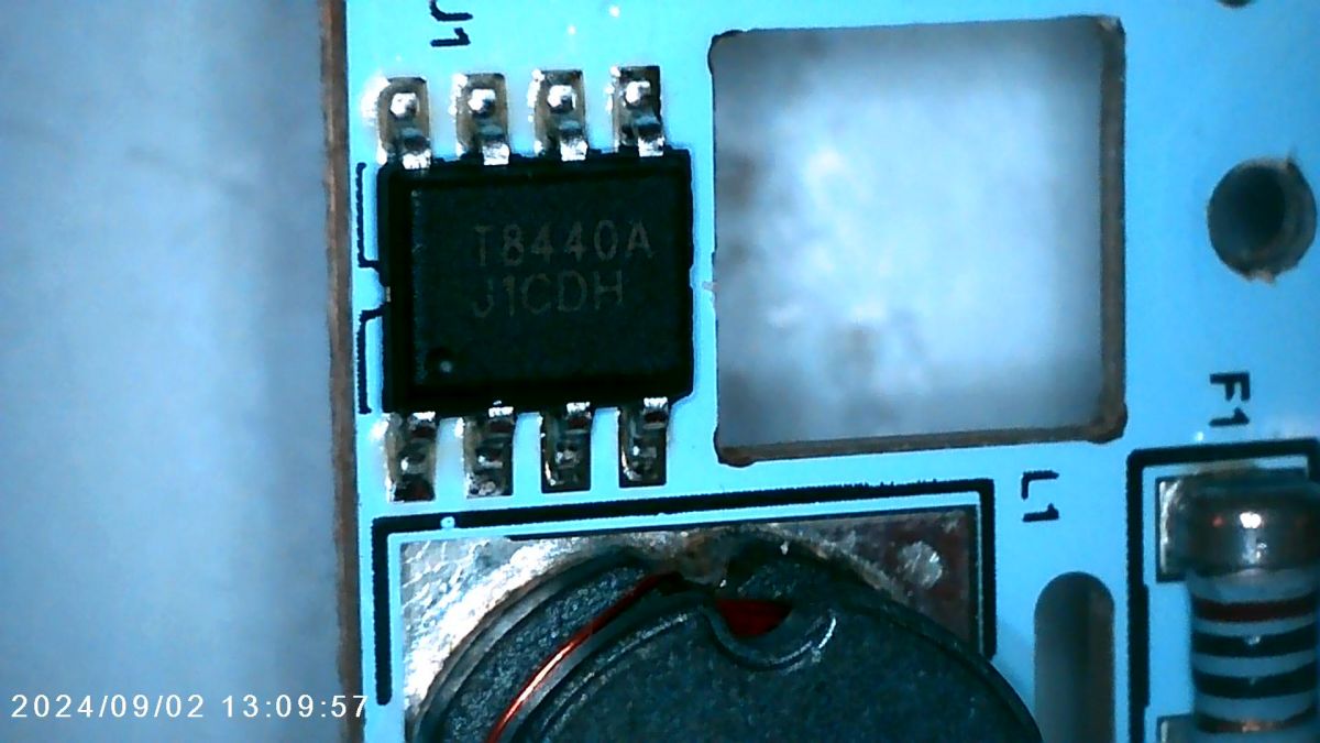

    Not sure what this is yet
    T8440A
    J1CDH
    Close-up of T8440A microprocessor on a circuit board.
    Tuya_MOES_US_Plug_(schemaID-dvs1fo)xxxxx.bin https://github.com/openshwprojects/FlashDumps/tree/main/IoT/BK7231N
  • #2 21442784
    Posts: 14782
    Rate: 12920
    T8440A is most likely the power supply controller. I guess it's a simple non-isolated step down converter as usual. Probably something similiar to BP2525.
    It's nice to see a varistor and big yellow filtering capacitor on the board...

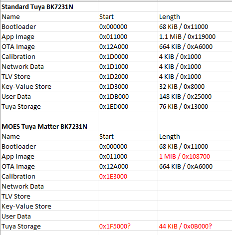

    Can you explain what's going on with these partitions? Why do they have a different layout?
    MOES Matter plug may use standard BK7231N flashing path
    #3 21443823
    Posts: 5222
    Help: 449
    Rate: 918
    I cannot explain it.
    Some comparisons for what I think I know so far.
    Comparison table of memory partitions for Standard Tuya BK7231N and MOES Tuya Matter BK7231N devices.
    Also! I remember now with the MOES Matter bulb that because it uses the standard Tuya keys you can just flash the normal BK7231N bootloader and use standard OBK conversion procedure and general release binary. I'll confirm with this smart plug.
    That would mean losing the RF calib partition though if it contains anything custom. Potentially it'd be possible to save RF partition, flash standard BL, write back RF, flash OBK.
    It could be a single-shot "Convert MOES Matter Device" button in Easy Flasher. maybe

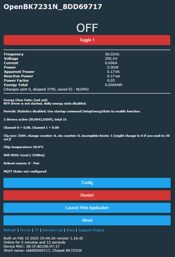

    OpenBeken flashing options and template for MOES plug
    #5 21447549
    Posts: 5222
    Help: 449
    Rate: 918
    it seems there are a couple of options.
    -flash a random BK7231N backup in its entirety to this device then use Easy Flasher to convert to OpenBeken as per normal procedure
    -erase all, flash BK7231N QIO OpenBeken release and overwrite bootloader then write standard non-calibrated RF - all within EF.
    Either way you seem to end up with a standard OBK device. The template:
    OpenBK7231N interface screen showing power parameters and configuration options.
