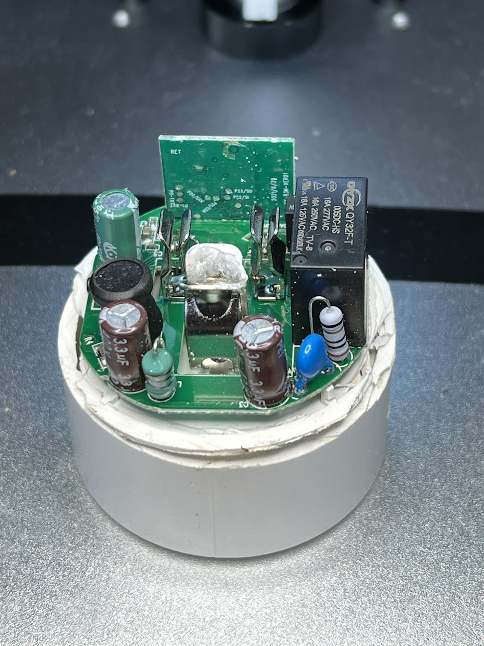

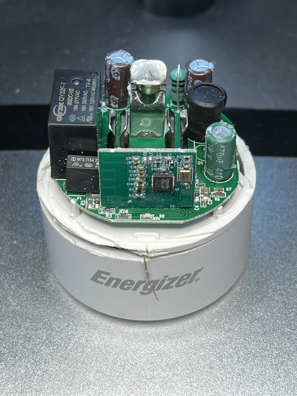

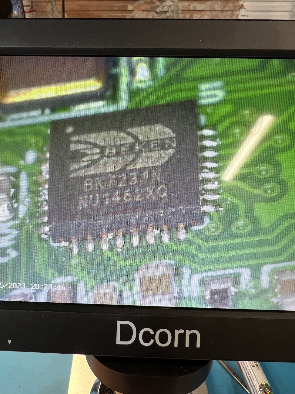

  • Cloudcutter stalls after first exploit on firmware 1.1.8
    #1 20581995
    bleeblak8
    Level 4  
    Posts: 15
    I'm trying to cloudcut this device. I bricked the first one and did cut it open to have a look. I haven't serial flashed that one yet, but am trying to CC the second one. I was able to connect it to Tuya and validate the firmware version was 1.1.8. I'm able to get through the first exploit, but then when it tries to send the update, it just stops. I've included the output of the SSH session. I have CC a few devices and these seem to be giving me the most trouble. Any help would be greatly appreciated.
    Thank you.

    Posts: 5197
    Help: 446
    Rate: 913
    @bleeblak8 what does the text on the back of the module say? I can't quite work it out. XX-B3N-VER01?
