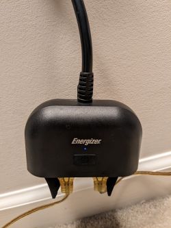

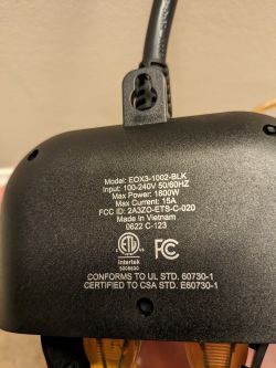

    I bought this initially as an experiment to see if I could flash another ESP device serially -- the device was on clearance for more than 30% off at my local hardware store. I had success pulling down a EOX3-1001-BLK from ebay and flashing it with Tasmota using tuya-convert in early 2022, but I wanted a bit more of a challenge this time.

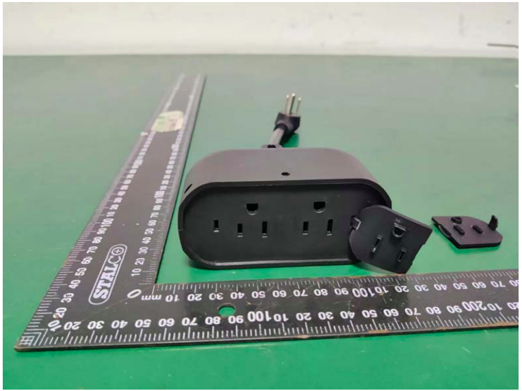

    I figured I would be able to buy the device, look up the FCC ID to look at the teardown pictures (thank you FCC for getting the hard part done for me!), and depending on the chipset flash it to Tasmota (or just return it if it was some arcane hardware).
    Opening up the box, I found the following ID: FCC ID: 2A3ZO-ETS-C-020. (Bizarrely in the photo below, its given a model number of EOX3-1002-BLK? which matches a more widely sold, but very different appearing Energizer product).
    [BK7321N] Teardown/Flash of Energizer Outdoor Smart Plug - EOX3-1002-ME1 (US)

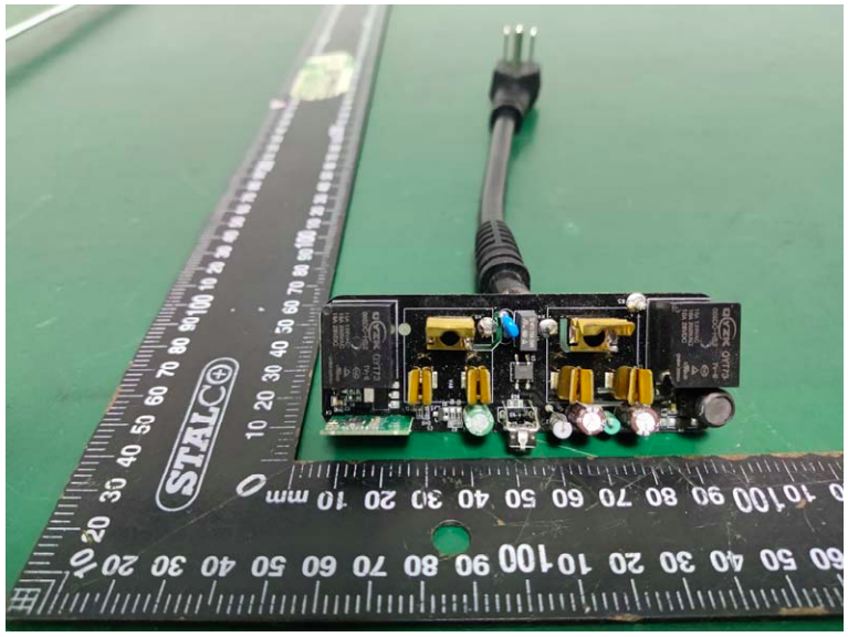

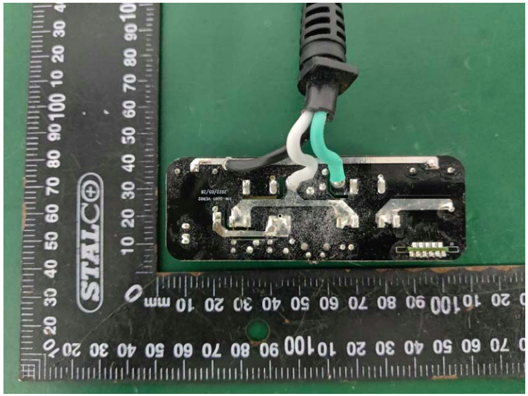

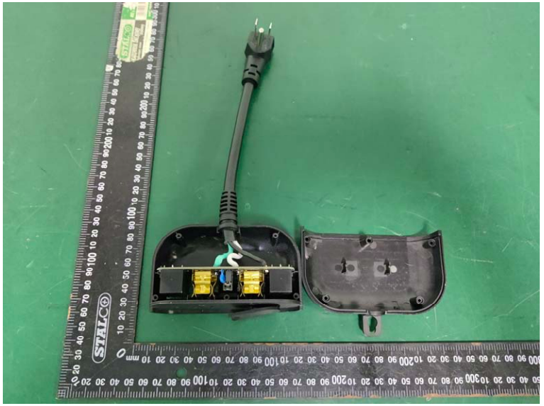

    Running to https://www.fcc.gov/oet/ea/fccid, punched it in and took a look at the disassembly pictures (repeated here for your convience):

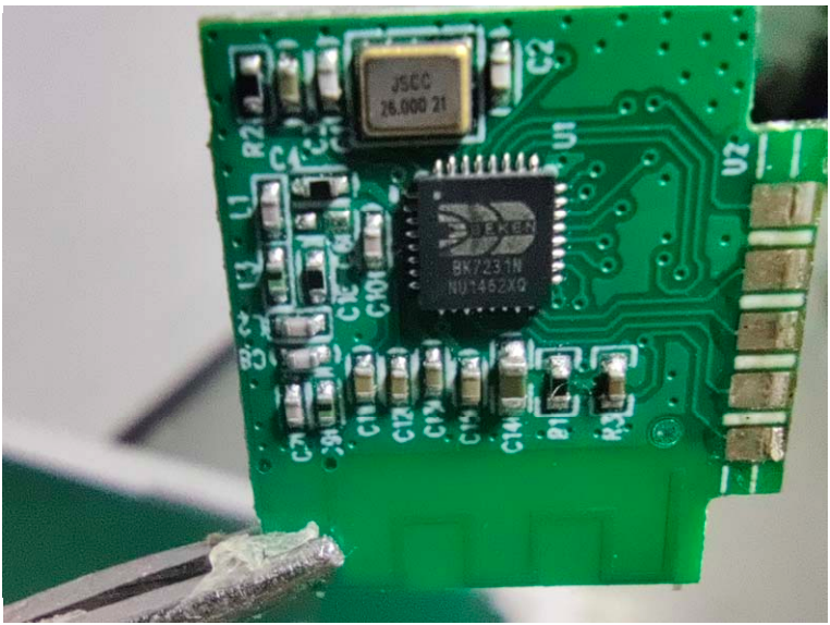

    Most interestingly, the final picture hit me with disappointment -- no ESP. It showed a chipset I was unfamiliar with (I am a Noob in this space): BEKEN BK7231N.
    Before I threw in the towel, a quick google took me to OpenBK7231T_App: https://github.com/openshwprojects/OpenBK7231T_App and subsequently tuya-cloudcutter: https://github.com/tuya-cloudcutter/tuya-cloudcutter. My hopes were up that I could still get complete control of this plug.

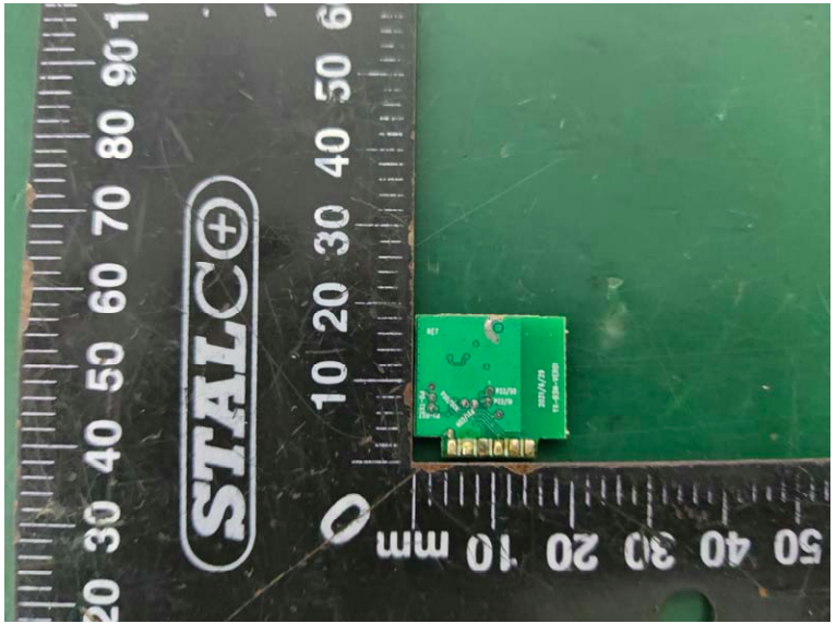

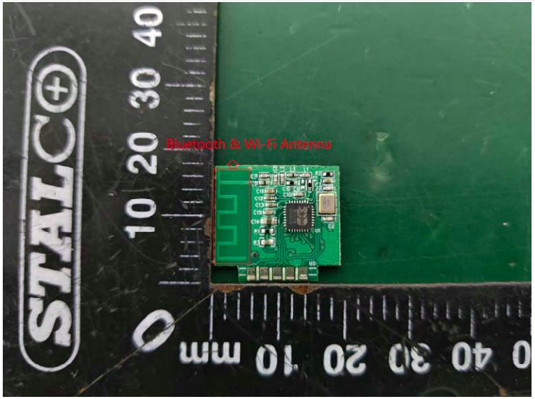

    I forgot to mention that I tried digging around on Tuyas developer pages to find what BK7231N based module this was. I couldn't find one with the wifi antenna next to the pinout. I only found similar configurations with the antenna opposite the pinout.
    Anyone have an idea?
    #2 20427966
    Posts: 14744
    Rate: 12839
    It seems you've found a module I haven't seen yet. The marking on the module on the photo is not clear to me, can you provide a better quality photo or write down the module name?

    It looks like another user has encountered this Tuya module! Please take a look here. It doesn't look like it has obvious markings like the ones on other Tuya models I have seen.
  • #4 20656926
    Posts: 14744
    Rate: 12839
    Does anyone know the ESP equivalent of this module? The one with a matching pinout?
    It looked like LM2 at first, but no, that's not an LM2 clone.

    @jacobefaust just for my own sanity, what is the marking on the module anyway?
