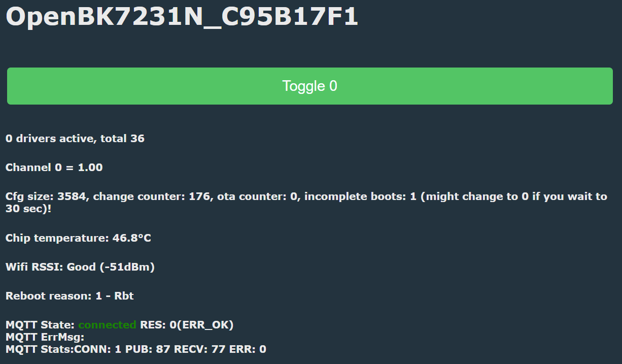

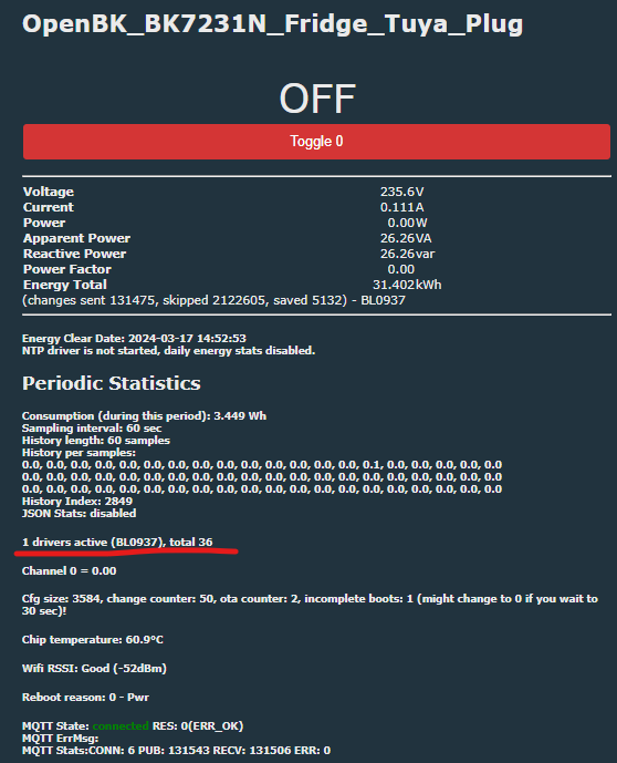

    just checking you've rebooted since config and you have the BL0937 driver running
    Screen showing active drivers with one BL0937 driver.

    vitya123 wrote:
    Hmmmm... what does this mean?
    on the main web gui it should have the drivers running listed
    Dashboard of the OpenBK_BK7231N_Fridge_Tuya_Plug displaying parameter summary.
  • #11 21290282
    vitya123
    Posts: 51
    Rate: 11
    It says:
    0 drivers active, total 36

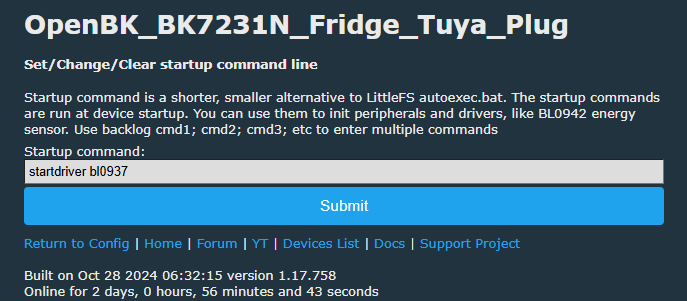

    just to confirm: webapp - import, right?
    yes. the BL0937 driver should start automatically on reboot with configured pins. if not, run "startdriver bl0937" in the startup command text or in an autoexec.bat
    Screenshot of the settings interface for the OpenBK_BK7231N_Fridge_Tuya_Plug device, where a startup command can be entered.

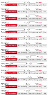

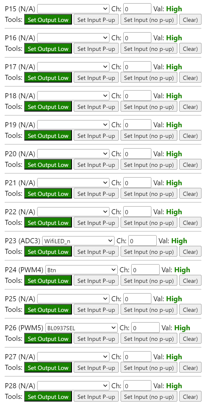

    I also notice a very weird thing now:
    When I press the button, the relay toggles just fine. However, when I'm in the webapp-GPIO finder, the button toggles ALL the GPIOs...
    GPIO Doctor Pins interface with a list of pins and buttons for setting outputs and inputs. Web interface of an application for managing GPIO with active Set Output Low settings and High status. Screenshot of GPIO Doctor Pins interface with buttons to set outputs high. Web app interface for managing GPIO outputs with visible buttons to set outputs to high.
  • Relay and button channels should be set to 1
    #16 21290337
    Posts: 5212
    Help: 446
    Rate: 914
    switch relay and button channels to 1 to change that behaviour
  • #17 21290360
    vitya123
    Posts: 51
    Rate: 11
    Done and dusted - all working as I expect them to. Thank you for your help!!!!
