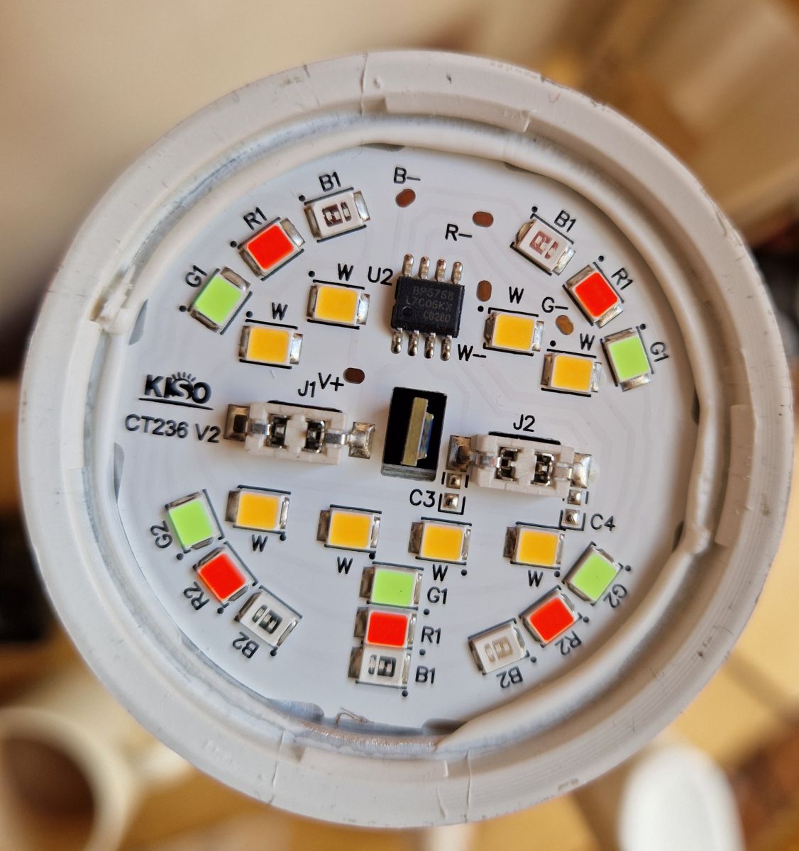

    This is my first time trying anything like this so apologies for any stupidity in advance. I've had a couple of the bulbs pictured for a while using Tuya Local in Home Assistant but got fed up with them disconnecting so decided to have a try using tuya-cloudcutter and flashing with Openbeken.
    I successfully flashed with BK7231N and determined that it is a BP5758 using P6 as DAT and P9 as CLK.
    This work but I didn't really consider the fact this bulb is RGBW rather than RGBCW. I've used the Flag 24 ("Flag 24 - [LED] Emulate Cool White with RGB in device with four PWMS") which works, but the colour temperature is way off, with far too much cold white being used. This is also additionally problematic because when the device appears in Home Assistant the lowest Kelvin that's available in the controls is 2702K, compared with 2000K when using OpenBeken directly.

    That flag doesn't appear to do anything for me - is it possibly because they are using I2C and not PWM?
    I also wondered, how difficult would it be to change how the WW LED's behave when emulated CW mode is being used. I ask because how these bulbs appear to work is to use the WW for a large portion of the Kelvin scale, compensating by only turning on the green and blue LEDs to achieve a cooler light.

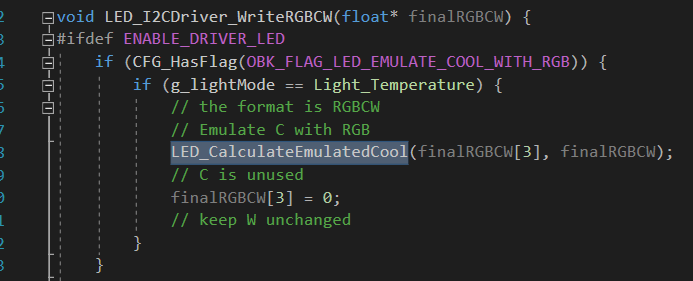

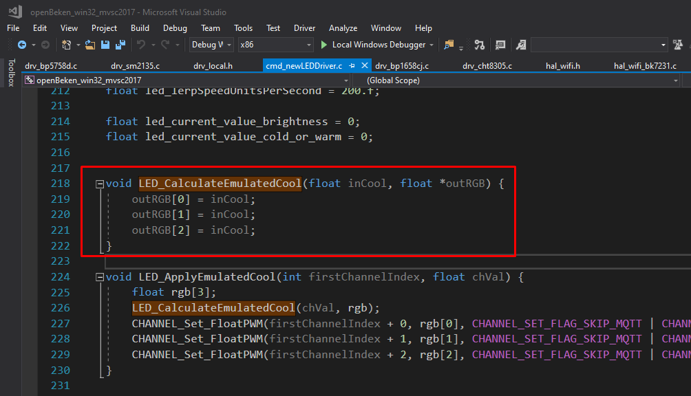

    The interface is currently very crude:
    [BK7231N] TIMEGUARD WLFLB22 - 10W RGB/W/WW - Colour Temperature Issues
    Here is how it is called, we could plug other function here...
    But you could do something like:
    void LED_CalculateEmulatedCool(float inCool, float *outRGB) {
    	outRGB[0] = inCool * FRACTION_FOR_R;
    	outRGB[1] = inCool* FRACTION_FOR_G;
    	outRGB[2] = inCool* FRACTION_FOR_B;
    This would be very simple to do and may be nice, but what kind of fractions would we set? Also maybe we need also to weight somehow more the influence of W channel, and that may require further modifications.
    Regarding your code with Kelvin, we are internally using Mireds, just like HA:
    Code: C / C++
    If you are able to give me for example formula for mireds, that gives results for R, G, B, and W, then I could try to implement it in code for you.
