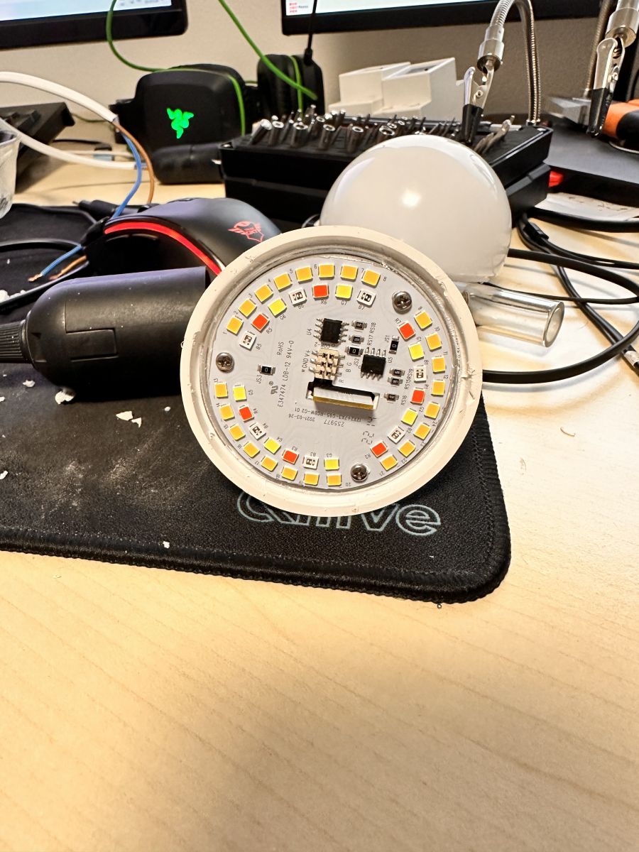

    This is a short teardown of the Ledvance SmartPlus Classic A100 14W Multicolor.
    The bulb uses a BK7231T (WB8P - new for me) Tuya chip.
    Packaging of Ledvance SmartPlus Classic A100 14W Multicolor bulb on a table. A circuit board with electrical components on a desk. A printed circuit board with visible BK7231T chip and various capacitors, lying on a desk. Printed circuit board with electronic components lying on a wooden table. Smart bulb Ledvance SmartPlus Classic A100 with exposed circuitry.

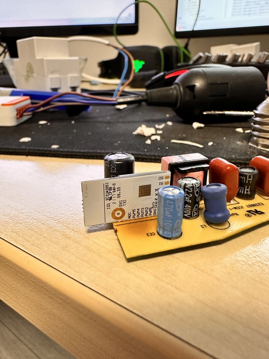

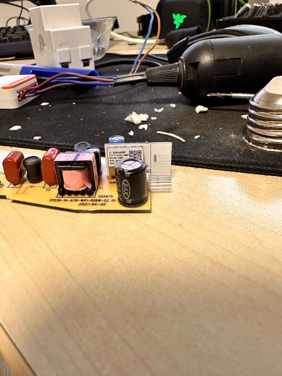

    Installing OpenBK7231T: solder wires onto the 3v3, GND, TX1 and RX1; connect those to a UART and then follow the https://developer.tuya.com/en/docs/iot/wb8p-module-datasheet?id=K9fwx4f89tvzd. You will need to hold a wire connecting CEN to GND to get the chip into flashing mode.

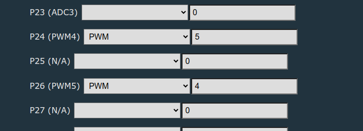

    I am not so much sure with CW:
    color_temp: PWM 26
    white: PWM 24
    Is not working like I want :D
    Attach 2MB flash is version 1.0.3 no profile for this.

    That part:
    color_temp: PWM 26
    white: PWM 24
    indicates that you have device using alternate CW control:
    8	[LED] Alternate CW light mode (first PWM for warm/cold slider, second for brightness)
    See: https://github.com/openshwprojects/OpenBK7231T_App/blob/main/docs/flags.md
    Usually devices are using one PWM for Cool White, and second PWM for Warm White, but in your case, device has one PWM for White Temperature, and second for White Brightness.
    You can see a sample of such device here:
  • #3 20898117
    lionboy
    Posts: 69
    Still not working with this configuration, what I saw from GPIO Finder PWM 24 and PWM 26 have the same color Warm White, I don't find Cool White but on his box show me have this control
    For RGB is ok because PWM1 is Red, PWM2 is Green and PWM3 is Blue, but I don't know from what channel to start I think from 1 is ok and PWM24 and 26 to be on 4 and 5 channel.
    Thanks
  • #4 20898242
    Posts: 14743
    Rate: 12839
    This expects channel 4 to be warm/cold (in your case P26) and channel 5 to be dimmer (in your case P24).
    I(t looks like you're trying the opposite setting. Can you try swapping them?

  • Flag 8 breaks brightness control on RGBWW bulb
    #7 20898284
    lionboy
    Posts: 69
    If i will change like this:
    User interface with PWM settings for different pins.
    Brightness don't work anymore with Flag 8 active

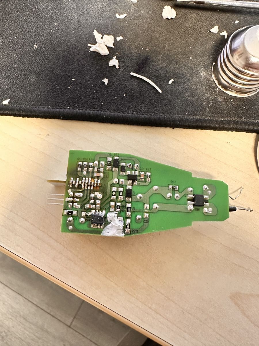

    #8 21051437
    rchristescu
    Posts: 19

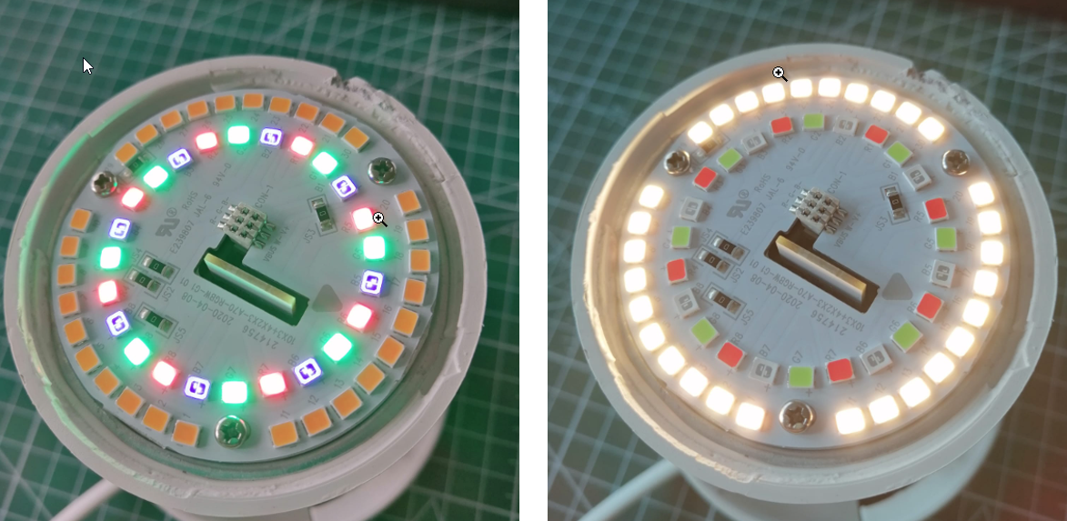

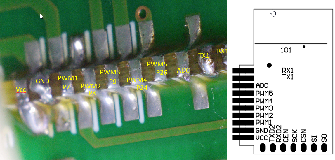

    I also flashed this bulb with OBK and I have the same issue: Cold white is not working.
    Configuration Pin 26 as PWM channel 3 is not OK because:
    First - PWM5 on WB8P (Pin 26 of the IC) is not soldered on the main pcb.
    Close-up of a circuit board with visible pins and a labeled connection diagram.
    Second - there are no cold white leds. Only red, green, blue and warm white.
    Two images of an LED bulb's circuit board without casing, displaying different LED arrangements.
    The configuration should be:
    Pin 7: PWM on channel 0
    Pin 8: PWM on channel 1
    Pin 9: PWM on channel 2
    Pin 24: PWM on channel 4
    But I am absolutely sure that with original firmware it has warm/cold white.
    So, my assumption is that cold white is made by red + green + blue on the same time.
    As I am pretty new to OKB, I don't know how to implement / test this assumption, any help is welcome.

    does indeed look like it's an RGBW bulb with only one shade of white LED. it would have to be making up some white with the RGBs.

    I test the command:
    led_basecolor_rgb #FFFFFF
    and I get the cold white as with original firmware.
    So my assumption is right, cold white is made by mixing red, green and blue altogether.
    What I don't know is how to tell OBK that for channel 3 (cold white) pins 7, 8 and 9 should be used at the same time.
    In other words, how to substitute the missing cold white leds with all RGB leds.
  • #12 21051804
    Posts: 5195
    Help: 446
    Rate: 913
    Ah. Maybe play with:
    Flag 24 - [LED] Emulate Cool White with RGB in device with four PWMS
  • #13 21051909
    rchristescu
    Posts: 19
    Yes, checking Flag 24 solved the issue, thank you so much.
    Now the bulb works perfectly!

    Correct template for Ledvance WB8P bulb
    #15 21051966
    rchristescu
    Posts: 19
    I think the device template should be updated in the Templates list.
    Actual configuration is wrong, pin 26 is not used and Flag 24 shall be checked.
    The right configuration is:
    I don't know how to request this update.

    #20 21236313
    lightmaster001
    I managed to flash the Ledvance A60 9W Lamp via cloudcutter with a generic device profile for the right software-version (in my case (oem-bk7231n-light-ty-1.3.21-sdk-2.3.3-40.00) I used the configuration for the A100 first, but some Pins were different.
    This is the Device configuration I extracted from Tuya:
    - LED Green (Channel 2) on P24
    - LED Cool (Channel 4) on P8
    - LED Blue (Channel 3) on P6
    - LED Warm (Channel 5) on P7
    - PWM Frequency 1000
    - LED Red (Channel 1) on P26
    I converted this to
    "6": "PWM;3",
    "7": "PWM;5",
    "8": "PWM;4",
    "24": "PWM;2",
    "26": "PWM;1"
    and disabled flag 24
    This made the lamp work perfectly fine.
