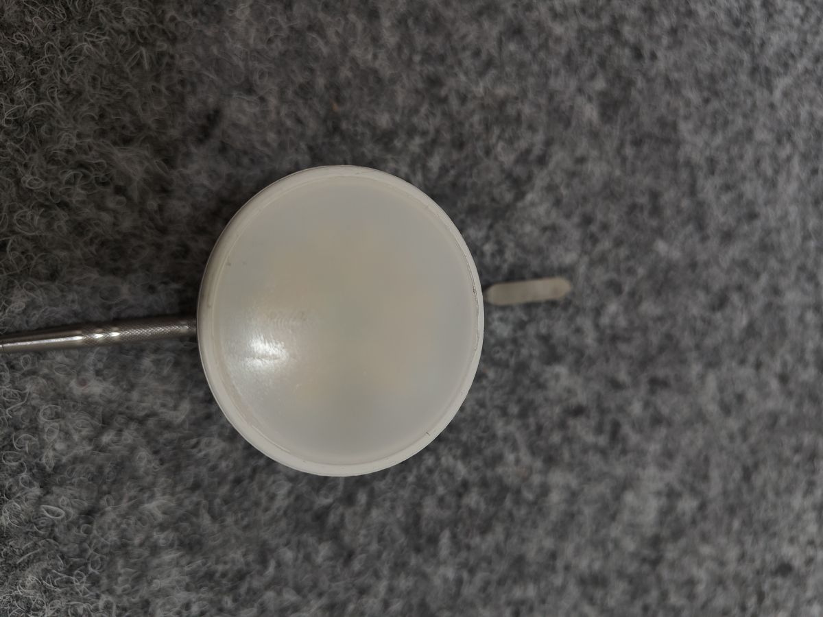

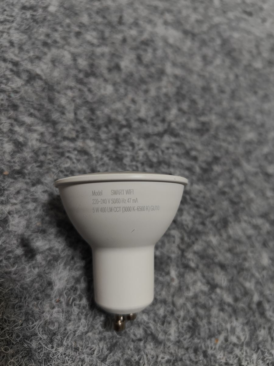

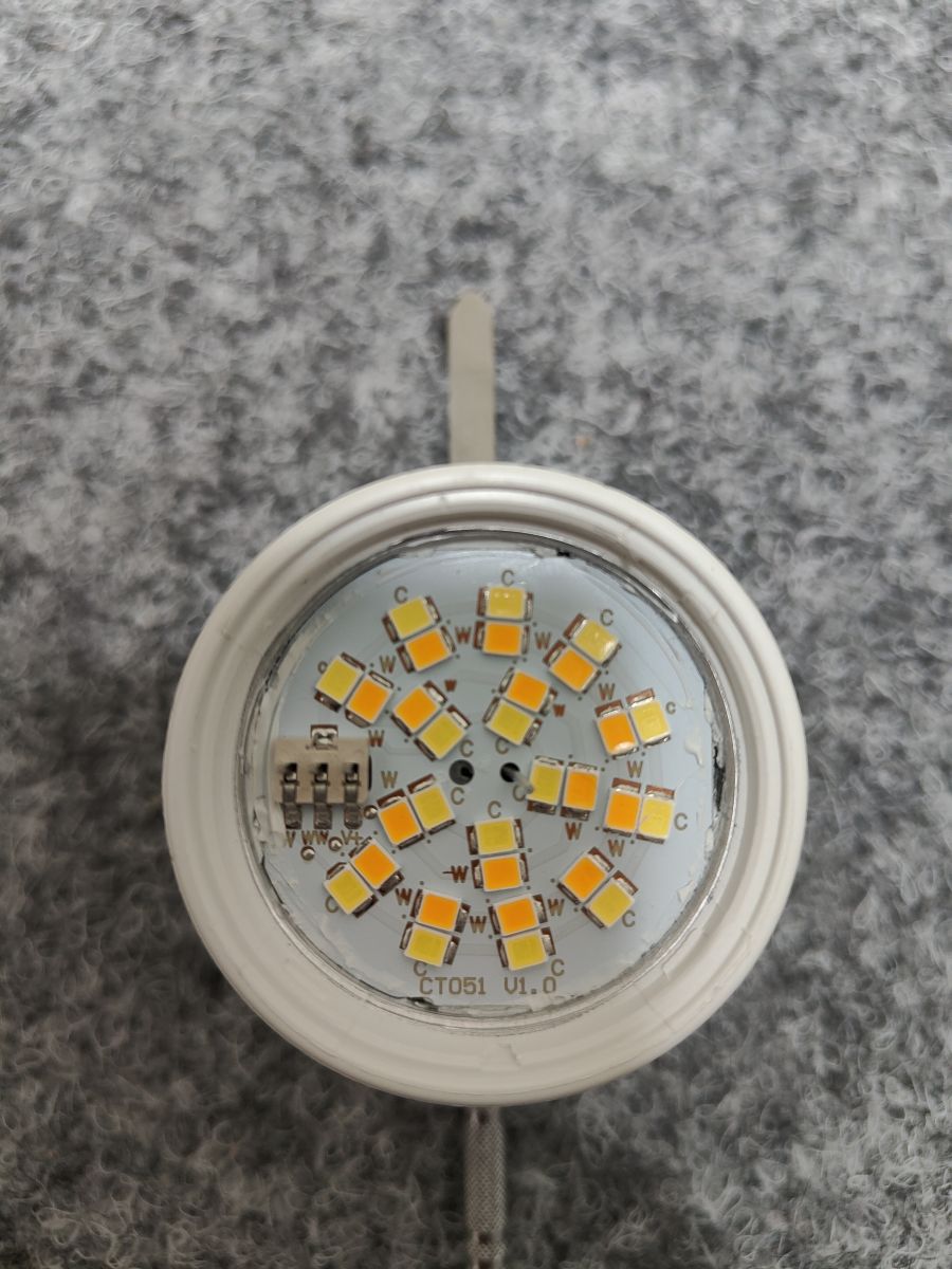

  • Here is short "teardown" of Energy+ (Home Connect) Smart LED CCT GU10 5W. 400 lm, 3000-6500K.
    This brand is exclusively in the Finnish market, so you probably won't ever find it abroad.
    It had V2.9.16 Tuya firmware inside, so you can flash OpenBKT with tuya cloudcutter.

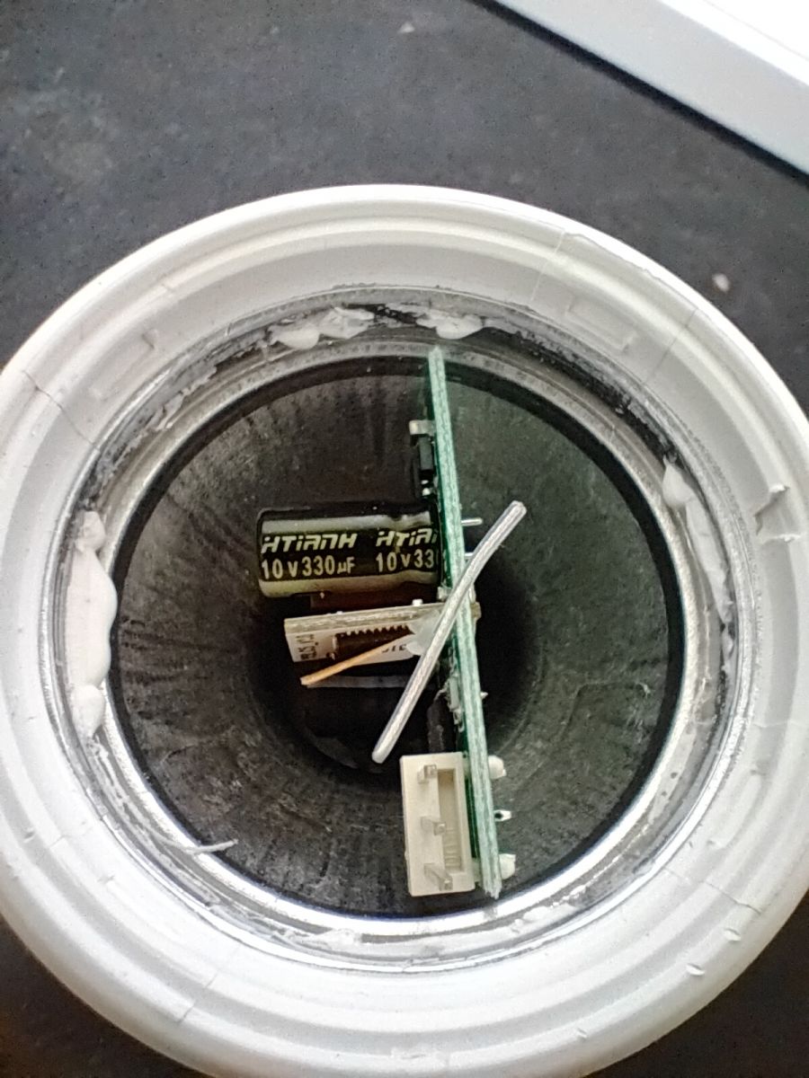

    SMART WIFI GU10 LED bulb lying on a grey surface.
    Interior view of an LED bulb with exposed electronics. Close-up of the interior of an LED bulb showing LED arrays and electronic components. View of a white LED bulb lying on a gray surface with a teardown tool. Box of Energy+ Smart LED GU10 bulb. Back of Energy+ Smart LED CCT GU10 bulb packaging with barcode and CE markings.
    - LED Cool (Channel 4) on P26
    - LED Warm (Channel 5) on P24
    Device seems to be using WBLC5 module, which is using BK7231T.

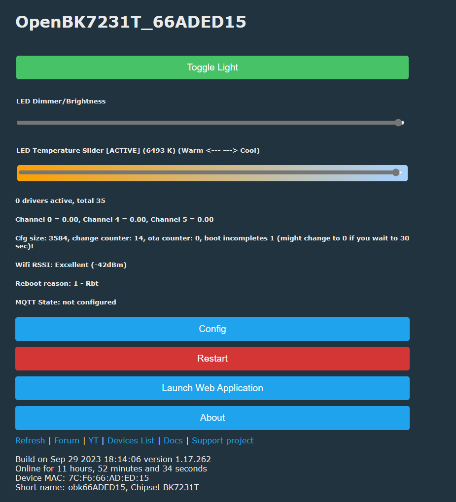

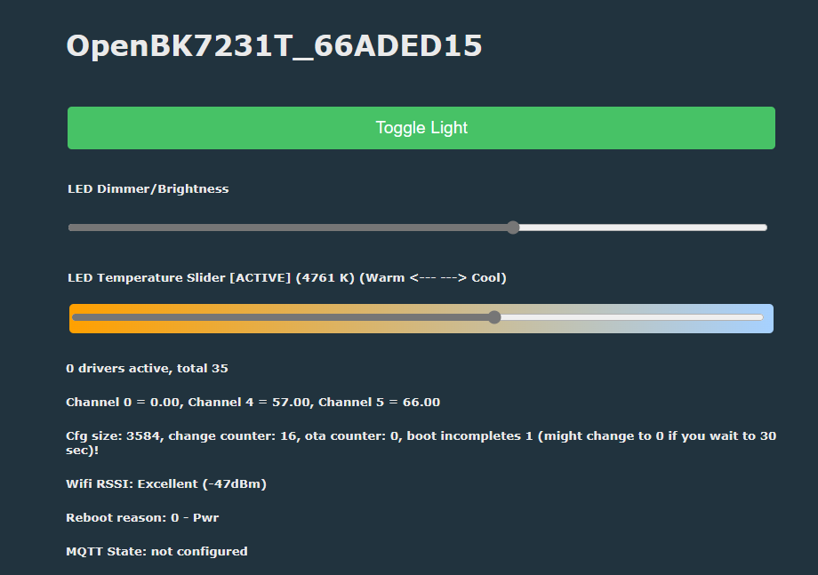

    Help is needed also. I can't turn bulb on or off with toggle button on index page.
    OpenBKT user interface with smart bulb information.
    I can only toggle it on or off with status page buttons.
    User interface showing device status with PWM channels for an LED bulb.
    Any ideas what im missing right now ?

    That's strange.... let's investigate this problem. How do those sliders in the Web App work for you? The ones in the Web App?
    Is one linked to warm white brightness, and second to cool white brightness?
    Or is one responsible for color temperature adjustments, and second for brightness?
    Also, are sliders on native HTML panel not working? What do you mean by saying that toggle is not working? Is bulb always on? Always off?
    Thanks for the fast reply @P.Kaczmarek2.

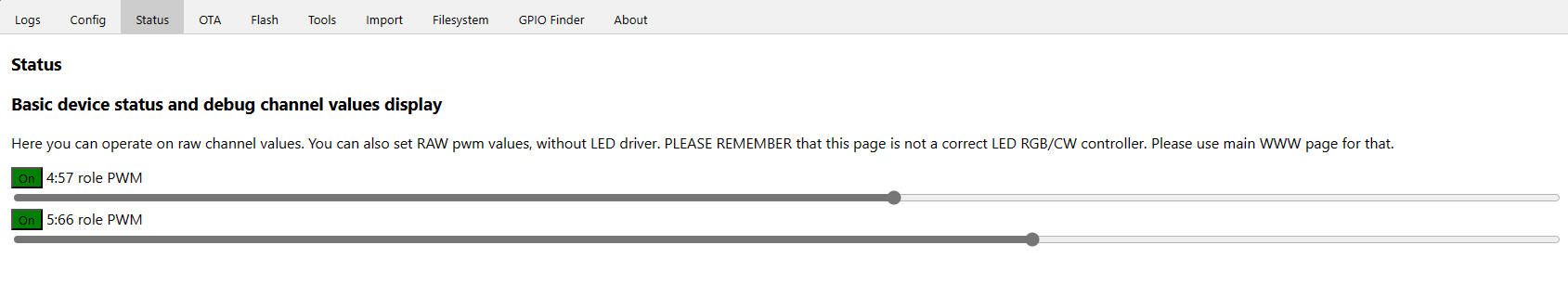

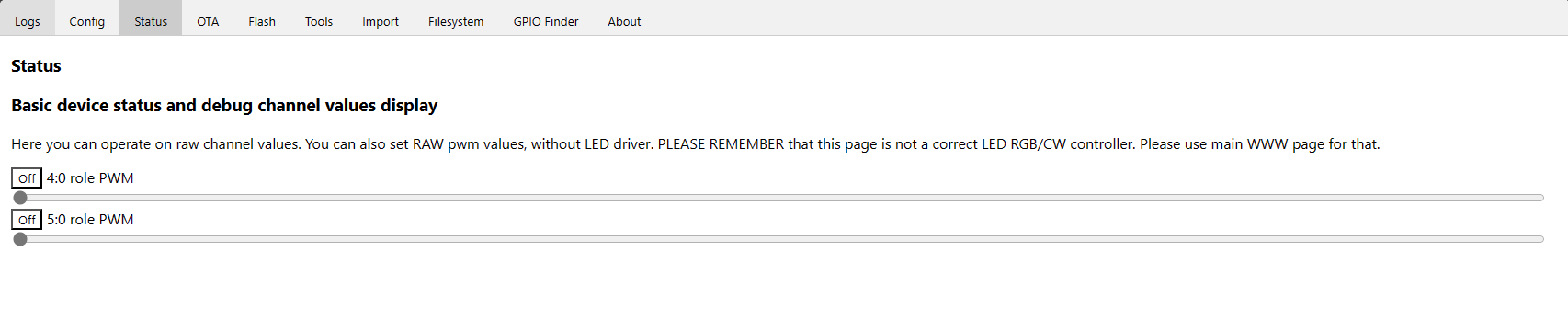

    In Web App "status page", one is for cold white (4:0 role PWM) and second one (5:0 role PWM) is for warm white. I can turn them on/off and adjust them in Web App status page. So this page works as it should
    Spoiler:
    Web application page showing device channel status with PWM sliders.
    This page doesn't do anything:
    Spoiler:
    Screenshot showing the OpenBK7231T application interface with controls for adjusting LED lighting.
    Bulb is always off when trying to control it from the native html panel.
    #4 20854519
    Posts: 14767
    Rate: 12909
    hmm what is the device template in the web app?
    Can you try... changing channel 4 to 0 and channel 5 to 1 in the pins settings?
    There might be a small logical error somewhere that I need to fix
  • #5 20854582
    Nimierkki
    Posts: 10
    Hmm, what is the device template in the web app?
    Can you try changing channel 4 to 0 and channel 5 to 1 in the pins settings?
    Thanks, changing channels was the key, now it's working like a charm :)
    EDIT:
    Channel 4 to 1 and Channel 5 to 0 was right one.

    Posts: 14767
    Rate: 12909
    Still, it's a bug. Let me look into it. It should be fixed by evening.
  • #7 20856249
    Posts: 14767
    Rate: 12909
    @Nimierkki I have submitted a fix for your issue, with future updates, it should always work, even with channels 4 and 5. Thank you for pointing out that issue to me!
