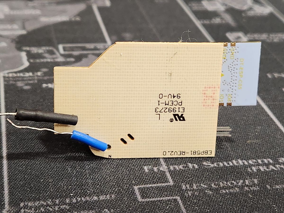

    Daybetter 800 Lumens 120V 9W RGB+2700-6500K bulbs (BK7231N/CB2L/BP5758D)

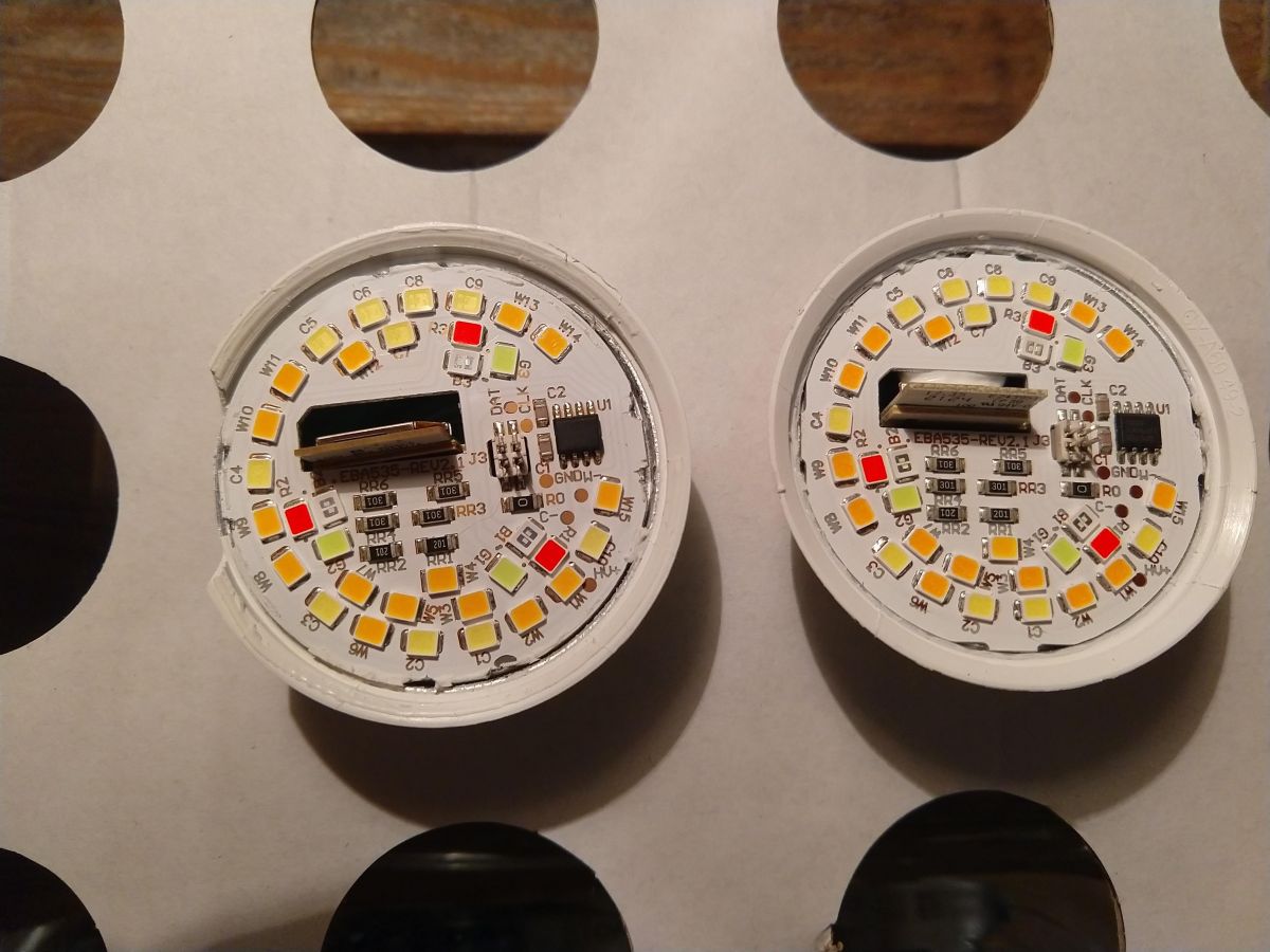

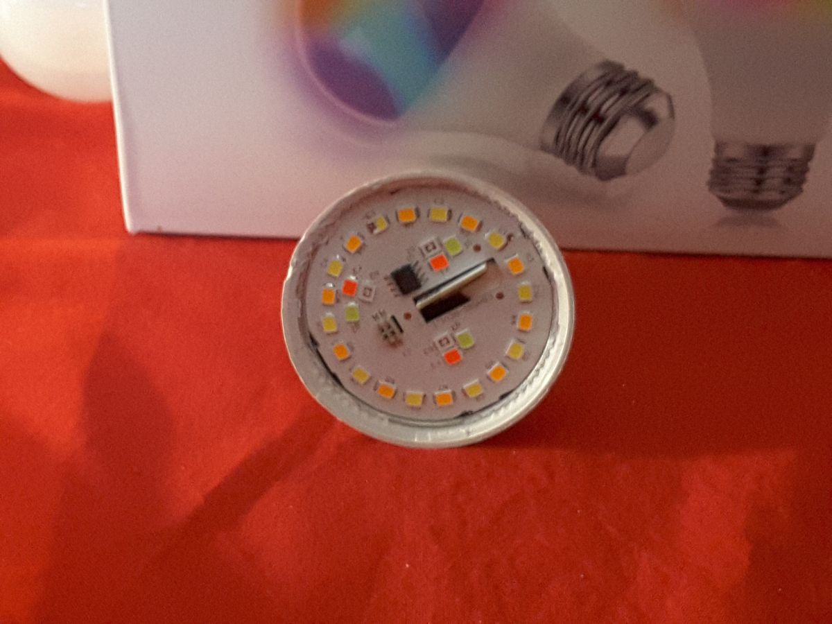

    This board has 15 warm-white LEDs, 10 cool-white LEDs, and 3 LEDs in each of red, blue, and green. The most significant other components are that IC which is identified by the silkscreen as a BP5758, and a four-pin connector which transmits data and power from the MCU PCB (note that this differs from a lot of bulb teardowns --- 6-pin connectors are much more common!). Based on closer inspection later, I believe the pin closest to the BP5758 (the one on the upper left in the picture above) carries the BP5758 clock signal, the one close to both the BP5758 and the surface-mount resistor (upper right) carries 120V DC power, the one closest to the MCU cutout (lower left) is BP5758 data, and the one close to the cluster of resistors (lower right) is ground. At one point I was trying to determine which pins carried voltage and how much and accidentally shorted out the 120V and ground pins. This killed the bulb and the physical damage is visible in a later photo.
    This board's schematic seems to be extremely close to one found in a Chinese-language report from a expo showing off Tuya bulbs which served as Bluetooth beacons.

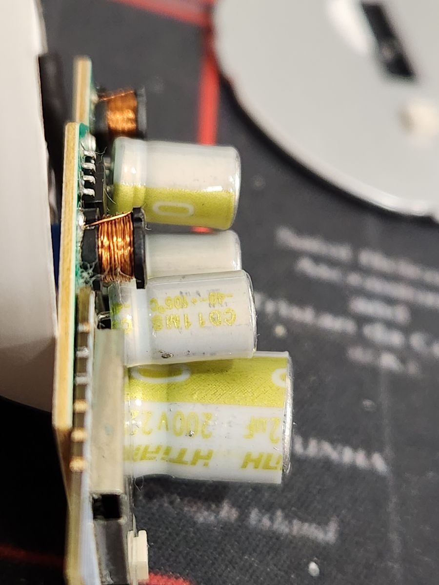

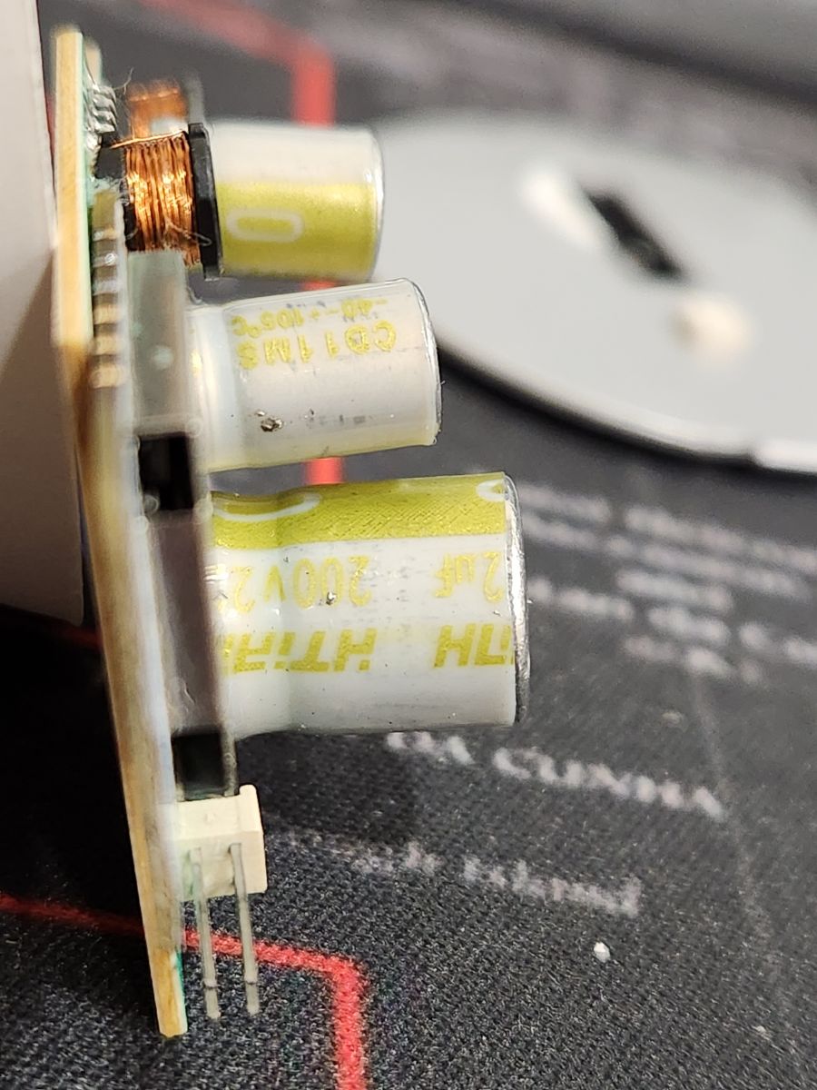

    Disassembling the bulb further required taking off a lot of glue. The light PCB was glued down around the edges, and there was also an enormous glob of glue holding the MCU onto the LED PCB (seen in the photo above. The large glue-glob was easy to cut, and the glue around the edges succumbed to light but consistent upwards prying around the edges of the light board. Removal of this PCB allowed a glimpse of the interior:

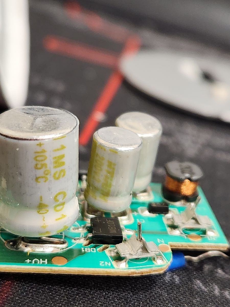

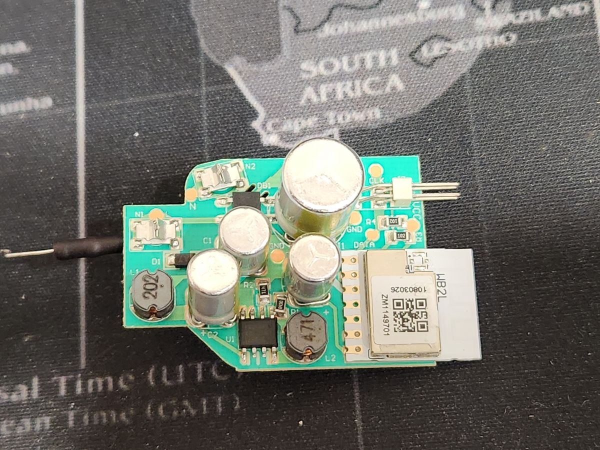

    This board gets a better picture after the physical destruction of the bulb base. It was, as expected, connected to the Edison screw for power by two wires, one of which was an unsoldered contact with the screw wall; the other was soldered onto the button at the bottom. The plastic around the base of the screw was cut until it was possible to take the screw base and the PCB out, whereupon the full PCB, along with its connections to the Edison base, could be photographed.
    Daybetter 800 Lumens 120V 9W RGB+2700-6500K bulbs (BK7231N/CB2L/BP5758D) Daybetter 800 Lumens 120V 9W RGB+2700-6500K bulbs (BK7231N/CB2L/BP5758D)
    Most of what is on here appears to be power-supply stuff. The 4-pin IC on the narrow end is a rectifier with, as far as I can tell, no silkscreen. The 4-pin IC in the wider section is labeled as a KP35026, which seems to be a 3.3V power-supply. The scorch mark directly below the left side of the ICU shows where my careless short seems to have caused a SMD resistor to explode.
    The MCU itself is labeled as a CB2L, which is a pretty standard Tuya Wifi unit built around a BK7231N chipset. As far as I can tell, pins P6, P26, and P24 are not used at all; P7 and P8 have traces to the LED-board connection.
    AFAICT, this is mostly a pretty ordinary 5-channel bulb using a BP5758 for current control. It has the exact same configuration as a Nous P3, and as far as I can tell most of the same hardware although the physical layout on the PCB is a bit different.

    Thanks for the teardown. I see you also noticed it's similarity to Nous P3. I wonder if that Tuya-cloudcutter profile would work for P3 as well. I didn't test that, as my default routine is always to use wires and provide next flash dump for cloudcutting analysis.
    BP5758 is a nice little chip. Those 4 gold pins routed out of the main board to LEDs board looks strange, without BP5758 (or similar driver) it would not be possible to control 5 sets of simple LEDs with 4 pins.
    I've attached BP5758 datasheet.

    Big update: a few (4 out of 24!) of my Daybetter bulbs turn out to have significantly different hardware. Below is a picture of two different bulbs from my stash; they came out of the same box of 12, and look the same externally.
    They look the same internally too, and as far as I can tell use the exact same two underlying PCBs, but they differ in two significant ways: the one on the right is just like the bulbs I described before, with a BP5758D driver on the LED board, and a CB2L Tuya module with a BK7231N MCU. The one on the left has those two components swapped out for two different ones that are pin-equivalent: an SM2135 on the LED board, and a WB2L Tuya module with a BK7231T MCU. These are not interchangeable for flashing purposes; they use different firmwares, and the driver chips require different configurations, so it's actually pretty important to know which you have.
    If you want to check undestructively which you have, it looks like a near-certainty that the CB2Ls are stuck on 1.2.16 firmware while the WB2Ls are on 2.9.6. This might not be the case for fresh bulbs that have never been on Wifi and haven't automatically updated.
    If you're content with a mildly invasive procedure to check, popping off the dome and checking which driver chip is on the LED board and what text is on the MCU will do. Some of the CB2Ls aren't labeled as such in a visible place, but most are. Also, I haven't seen any bulbs with the CM2L/SM2135 or WB2L/BP5758D combination, but there might be, especially as the interface between the LED boards and the power supply/MCU board is unchanged between the models and would be interoperable on the hardware level.
    Anyways, the significant differences for flashing purposes are: first, match firmware to the BK7231 variant present (and guessing wrong will brick your bulb, so best not to guess), and second, any new firmware probably needs a configuration for the light drivers (guessing this wrong will simply make your bulb not work until reconfigured and restarted). The pins are still P7 for the clock and P8 for data, but the right driver needs to be selected, either BP5758D or SM2135.
    [/i]

    Took a look under the top and verified its a WB2L (the flash probably would not have worked otherwise).
    I was barely able to make out BP5758 on the chip by the LEDs.
    I've set the pins to below and cycled power.
    24 BP5758D_DAT
    26 BP5758D_CLK
    The web gui does not show led bars even after setting Flag 4.
    Still no light.

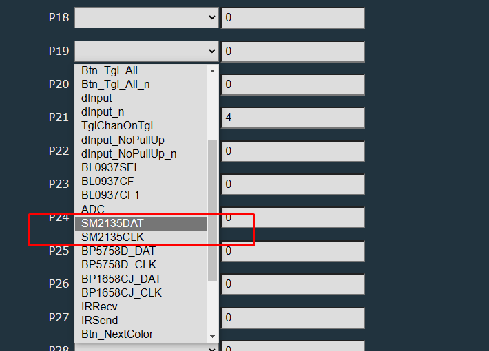

    It looks like you've confused SM2235 (10 bit version) with SM2135 (8 bit version).
    Please select proper pins for SM2135:

    @wascott I can add a template to the database, but can you post here at least a photo of the bulb or of the packaging?
  • Updated BP5758D white/cool white channel map
    #19 20396754
    wascott
    Updated map for white/cool white
    BP5758D_Map 2 1 0 3 4
    Here are the pictures, don't know what you wanted.
    Also, maybe a note about at least 2 different models, one with the BK7231T and one with the N.
    Mine was the T version. Daybetter 800 Lumens 120V 9W RGB+2700-6500K bulbs (BK7231N/CB2L/BP5758D) Daybetter 800 Lumens 120V 9W RGB+2700-6500K bulbs (BK7231N/CB2L/BP5758D) Daybetter 800 Lumens 120V 9W RGB+2700-6500K bulbs (BK7231N/CB2L/BP5758D) Daybetter 800 Lumens 120V 9W RGB+2700-6500K bulbs (BK7231N/CB2L/BP5758D) Daybetter 800 Lumens 120V 9W RGB+2700-6500K bulbs (BK7231N/CB2L/BP5758D)

    #20 20465764
    Zain00
    Posts: 61
    Rate: 20
    I received a pack of Daybetter bulbs. they use WB2L & firmware V2.9.25 that can be flashed with cloudcutter.
    P7 (PWM1) - BP5758D_DAT
    P8 (PWM2) - BP5758D_CLK
    WARNING: When I first try these bulbs, they gave me a mild electric shock! I haven’t even start to disassemble them. It seems there's something faulty with the circuit they use (I experienced electric shock from 2 different bulbs after unscrewing them from the lamp).
  • Electrolytic capacitors may retain charge after unplugging
    #21 20465778
    Posts: 14755
    Rate: 12880
    Please be careful. Electrolytic capacitors can keep they charge long after the circuit is disconnected from mains. Especially if there is no bleeder resistor.
    Regarding the photo, the capacitors are looking strange - do they have any marking?
    I also see that WB2L might have covered programming pads. That's good that we have OTA hack. Otherwise you'd have to use this method:
    I'm usually careful not to touch the capacitors when I open any device, but this time I was shocked by just touching the E27 base.
    Here are some pictures of the board. In this bulb I put ESP32 to try Tasmota. I have to say Openbeken handles LED drivers far better than Tasmota.
  • #23 20466258
    Posts: 14755
    Rate: 12880
    Those capacitors are indeed strangely soldered. They used THT components as SMD ones.
