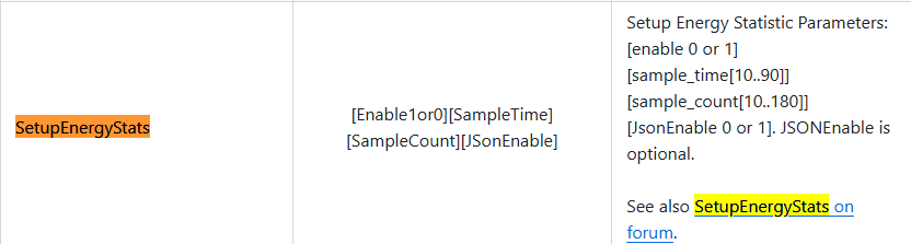

    Good morning.
    I have a PZIOT-E01 DIN rail pass-through energy meter [231N/CBU] [BK7231N/CBU] Driver BL0942SPI.
    When I use the startDriver NTP command, SetupEnergyStats 1 60 5, the bk7231n freezes, takes a long time to unlock, and when it unlocks, it resets and doesn't save the changes.
    What am I doing wrong? Or does it not support these commands?
    Thank you.
    AI: Could you please provide the firmware version of your bk7231n? Different versions might have varying support for these commands.
    OpenBK7231N_1.18.75
    #2 21519898
    Posts: 5209
    Help: 446
    Rate: 914
    is that samplecount too low? could 10 be the minimum?
