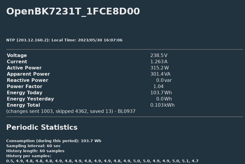

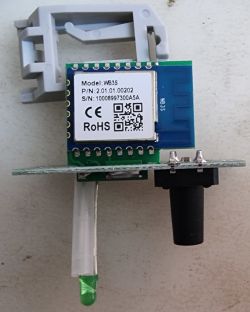

    Automatic decoding didn't work.
    These values seem OK?
    P6 is the Wifi LED
    P7 is the Button
    P8 is the BL0937CF1 pin
    P9 is the BL0937CF pin
    P24 is the BL0939SEL pin

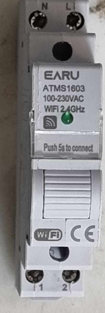

    Should've mentioned or pictured this is the CT clamp style device from Aliexpress

    I know, I noticed that there is no relay role in your pinout.
    I can also see the current transformer on the Aliexpress listing:
    Decoding EARU ATMS1603 Energy Meter (BK7231T / WB3S) with BL0937CF1/CF/SEL Pins
    Added after 50 [seconds]:
    It seems there are various models:
    ATMS1611,ATMS1612, ATMS1601, ATMS1602, ATMS1603...
