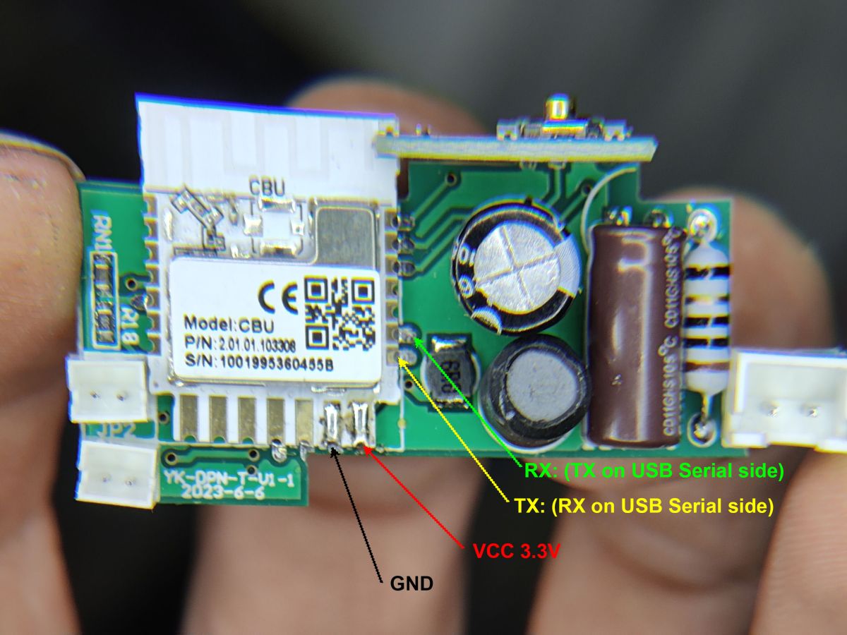

    Flashing device

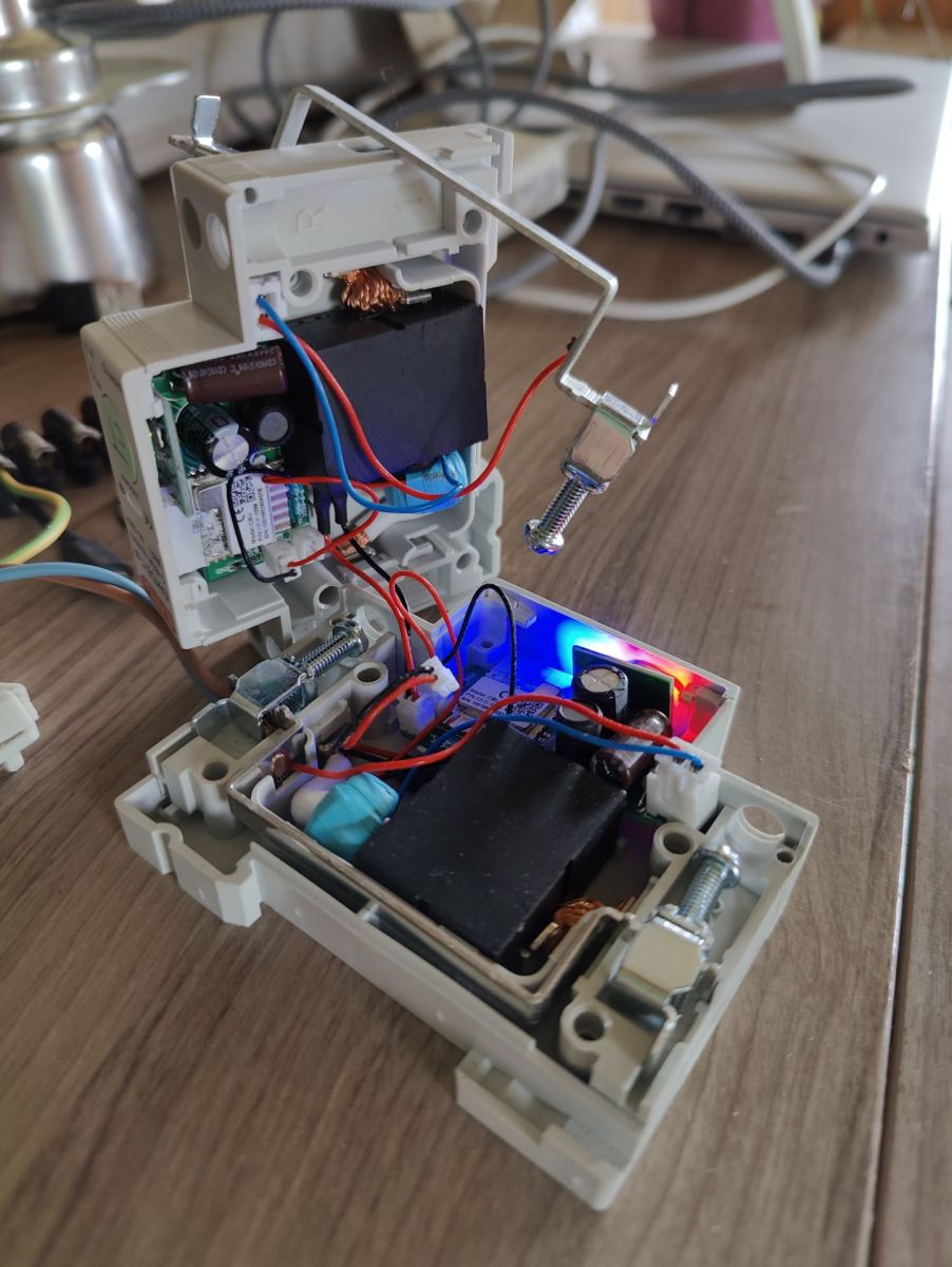

    Flashing is straight forward.
    You need to open the device (6 small rivets to drill), then it opens.
    Earu EAKCB-T-M (BK7231N) Flashing Guide, Firmware Dump, and Config File Details
    CBU doesn't need to be de-soldered from PCB.
    You need a 3.3V power supply, to power cycle device when asked for by BK7231 GUI Flash Tool.
    Connect TX/RX and GND to your USB/Serial adapter, launch BK7231 GUI FlashTool, and start writing firmware.
    When BK7231 GUI FlashTool ask to power cycle power, just supply 3.3V to VCC pin and it should work.

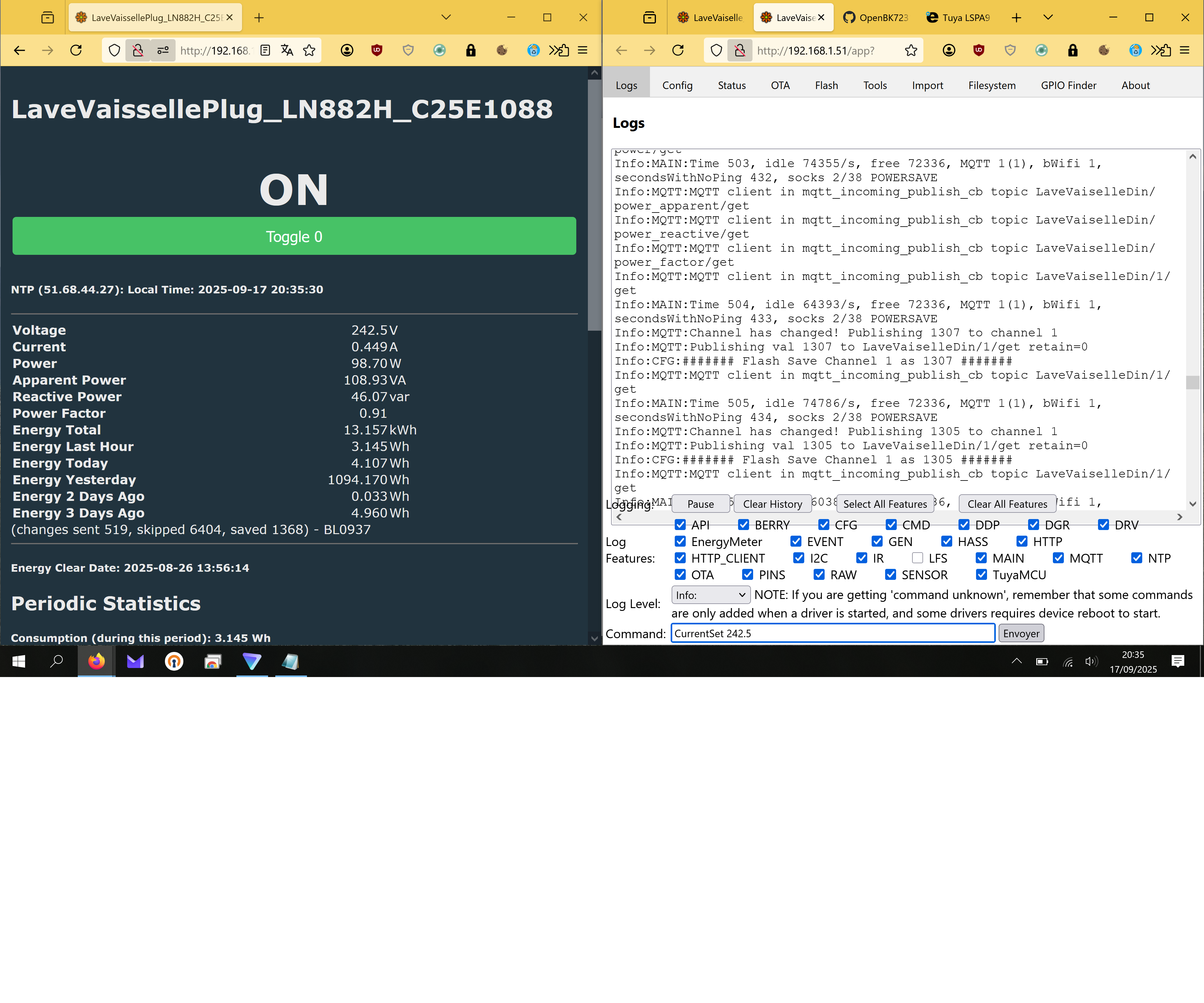

    Meter calibration
    Meter needs to be calibrated. I use another OpenBK device Tuya EU20A to read meter data and use it as a reference. I know i have Tuya device consumption added, but I don't care.

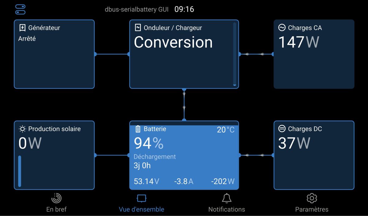

    My goal is to have an overview for dynamic load cut off/on.
    Our home is 100% solar, not connected to grid, using a home made 15KW battery with a 5KW inverter. I must no exceed it!
    In case of over power, I switch off load by priority.

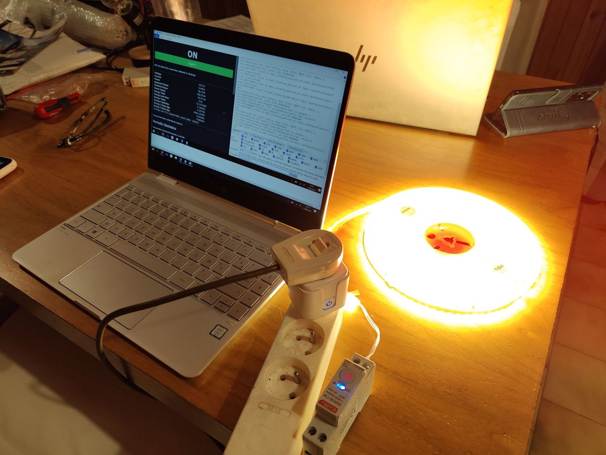

    CALIBRATION PROCEDURE
    I used first a 230V 10meters LED strips (reactive power).
    Then, I read values from Tuya EU20A and set Volt/Current/Power values on Earu device.
    On left Tuya reading, on right Earu writing.
    On device, I launch 'Launch Web Application', goes to 'Logs' tab (on the left) and type following commands:
    Where 242.5 is actual voltage mesurement in Tuya, could be also from a multimeter.
    0.449 is actual current in Tuya, could also be from an amp clamp or meter.
    108.93 is actual Power Factor in Tuya.
    Settings are saved permanently.

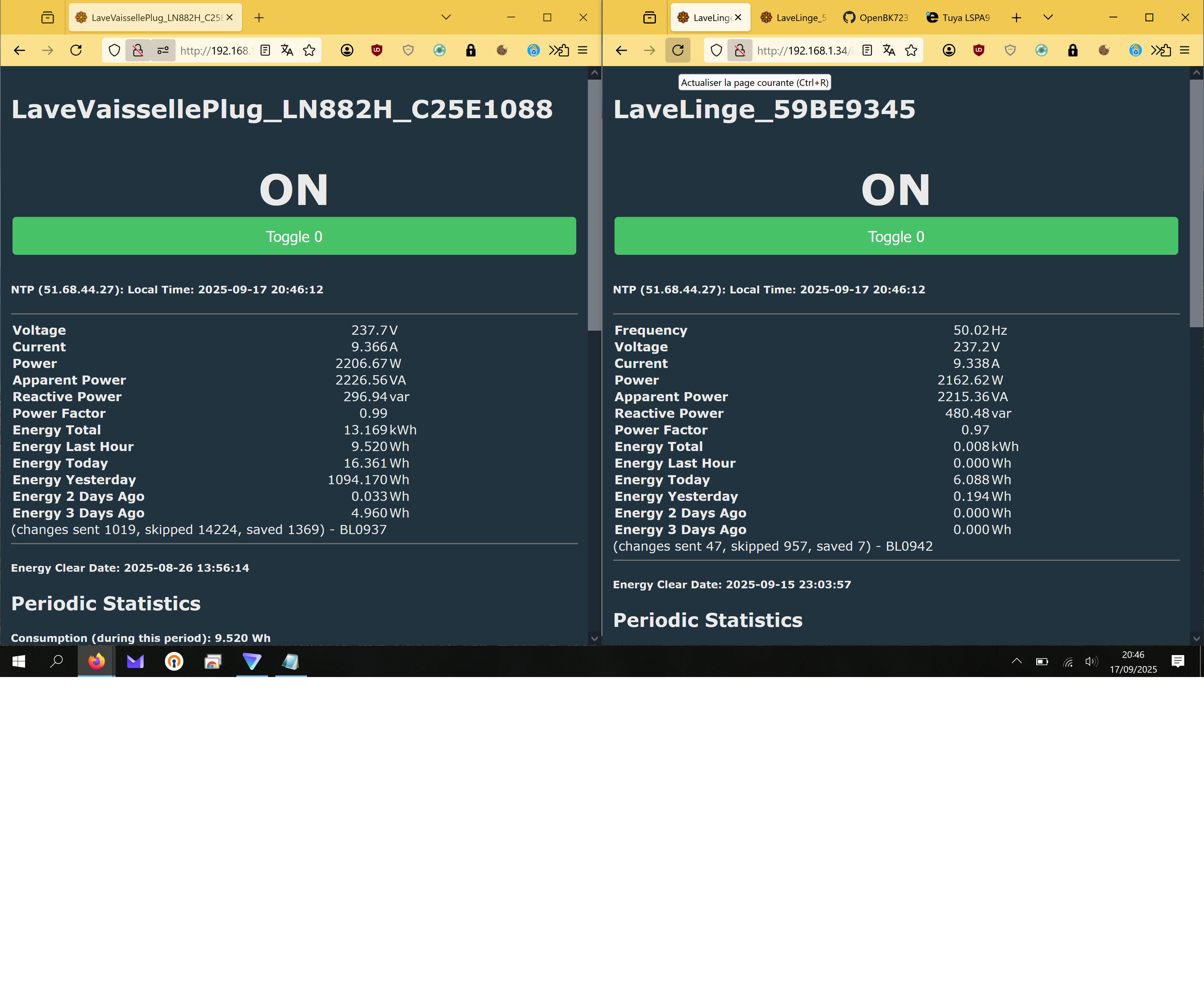

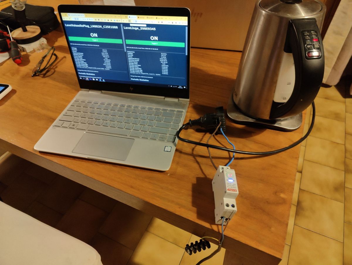

    Then I verify my calibration using a 2000W boiler.
    Readings are OK :

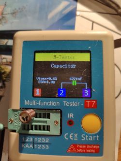

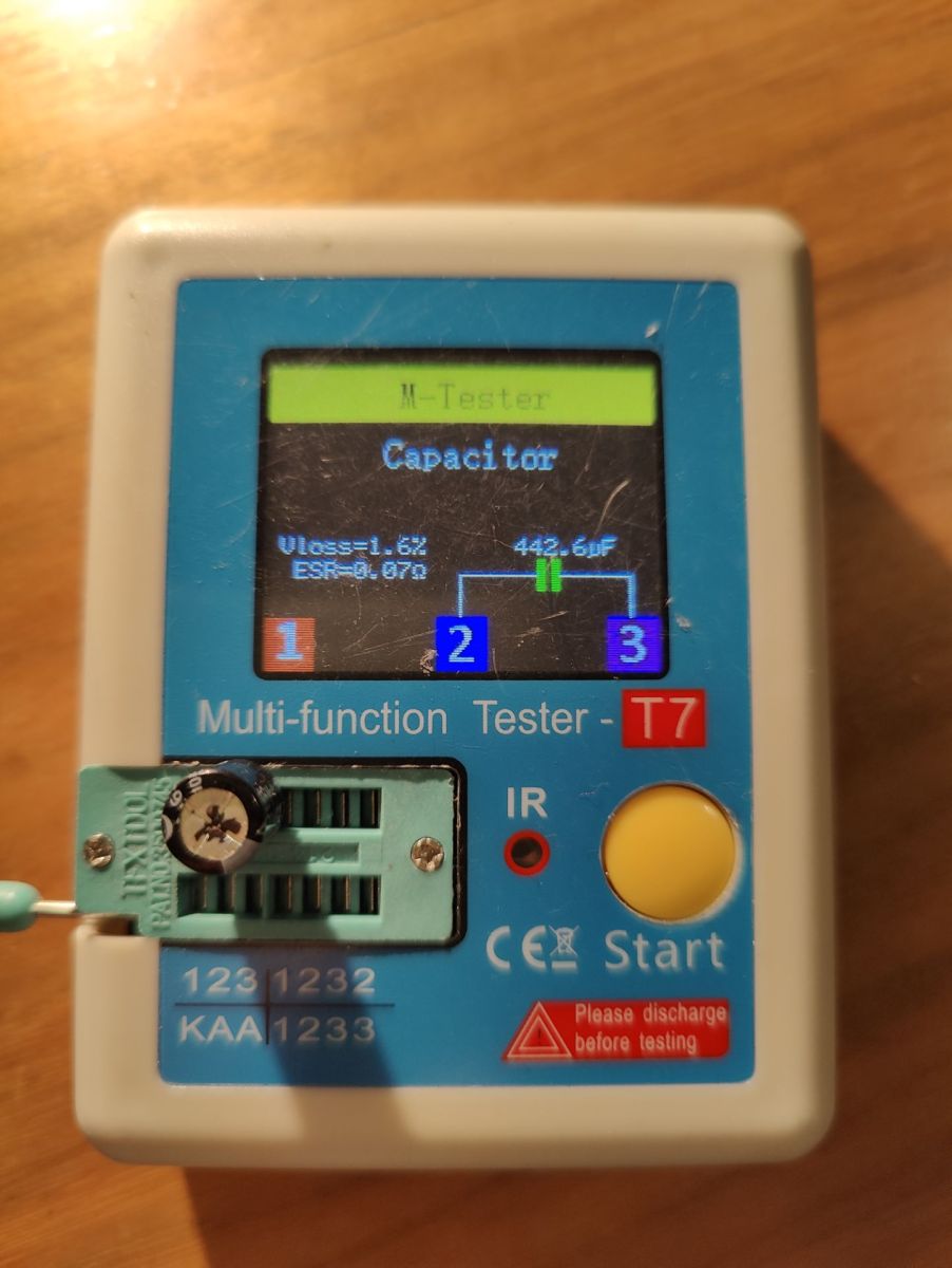

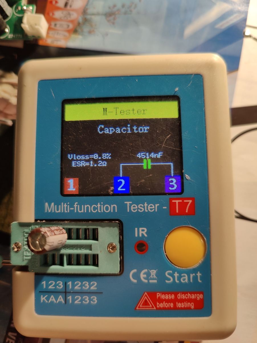

    Then, I checked capacitors, hoping that they were faulty.
    Bad earu relay capacitor (marked with a X) : 4.3uF instead of 4.7uF (400V).
    Good earu relay capacitor: 4.3uF instead of 4.5uF (400V).
    Bad earu relay capacitor (marked with a X) : 442uF instead of 470uF (16V).

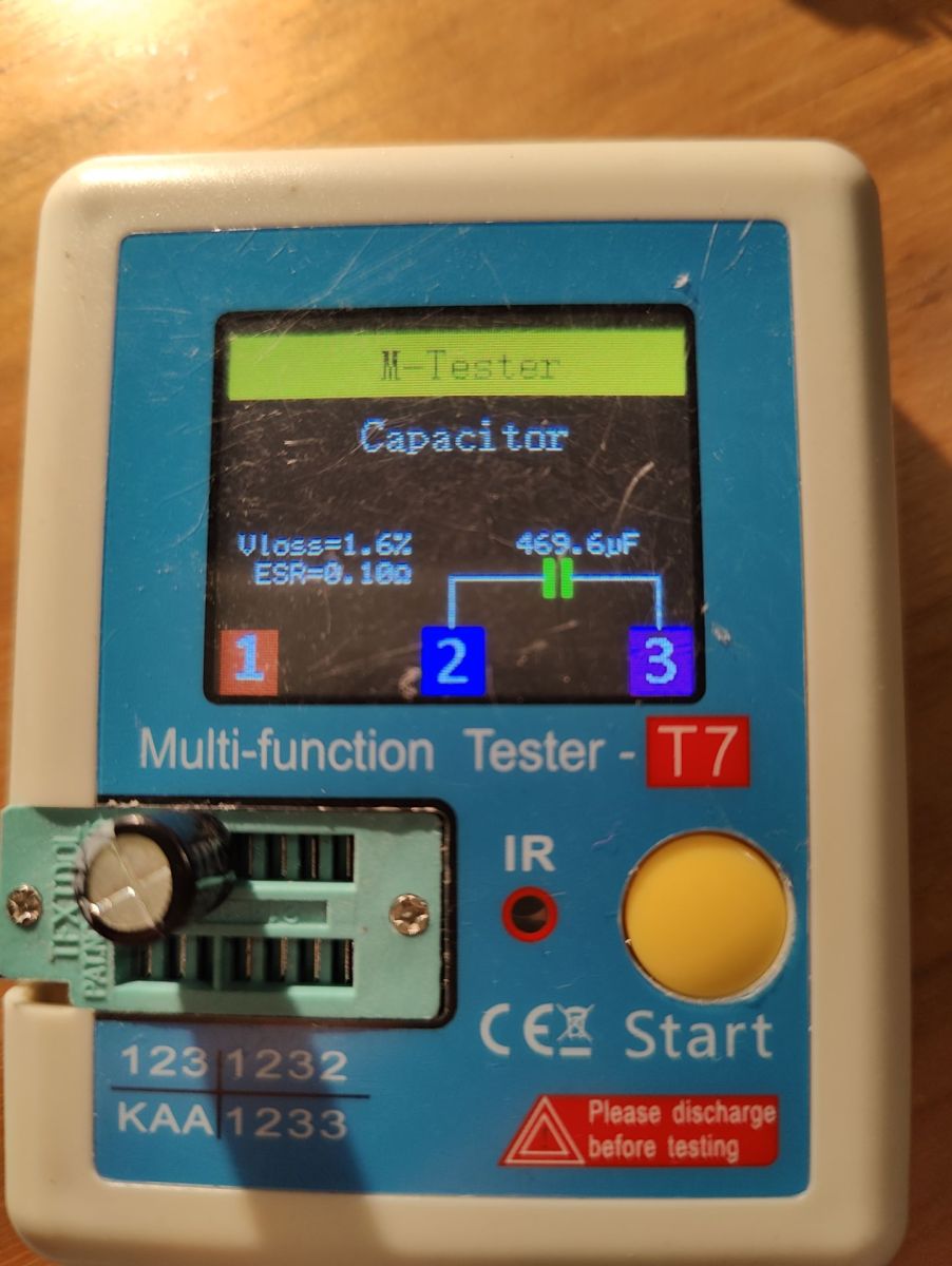

    Good earu relay capacitor: 469uF instead of 470uF (16V).

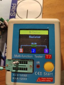

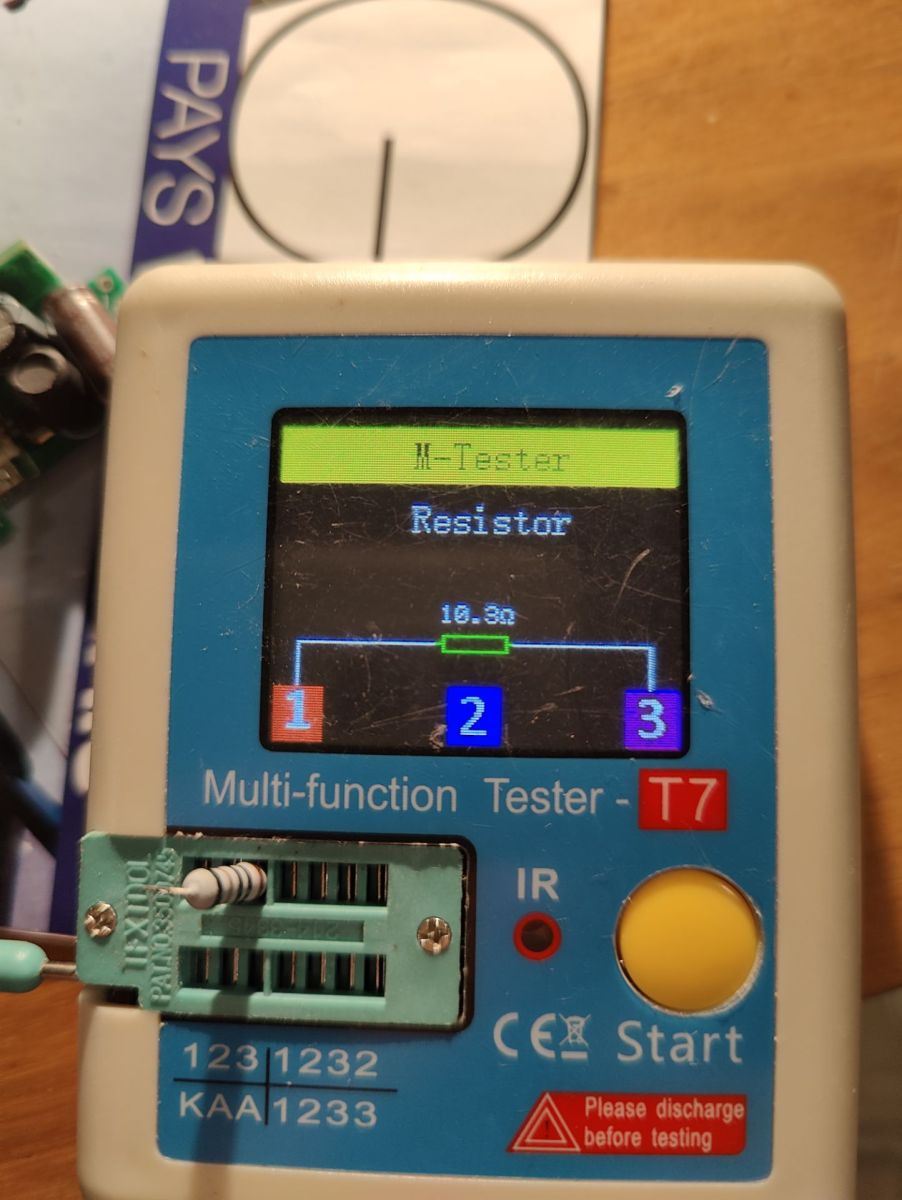

    I even checked both primary resistor. Same 10.3 ohms for each (10 ohm from color code).
    T7 tester displaying a resistor value of 10.3 ohms
    Even by swapping all this components, behavior is the same.
    The good one is still working, even with 'bad' capacitor.
    And the bad one doesn't work, even with 'good' capacitor.
    I noticed that CBU board is not well aligned with main PCB on the 'bad' one. I will try ti reflow and align it.
    EDIT: I did it, nothing change. I think voltage regulator IC is weak.

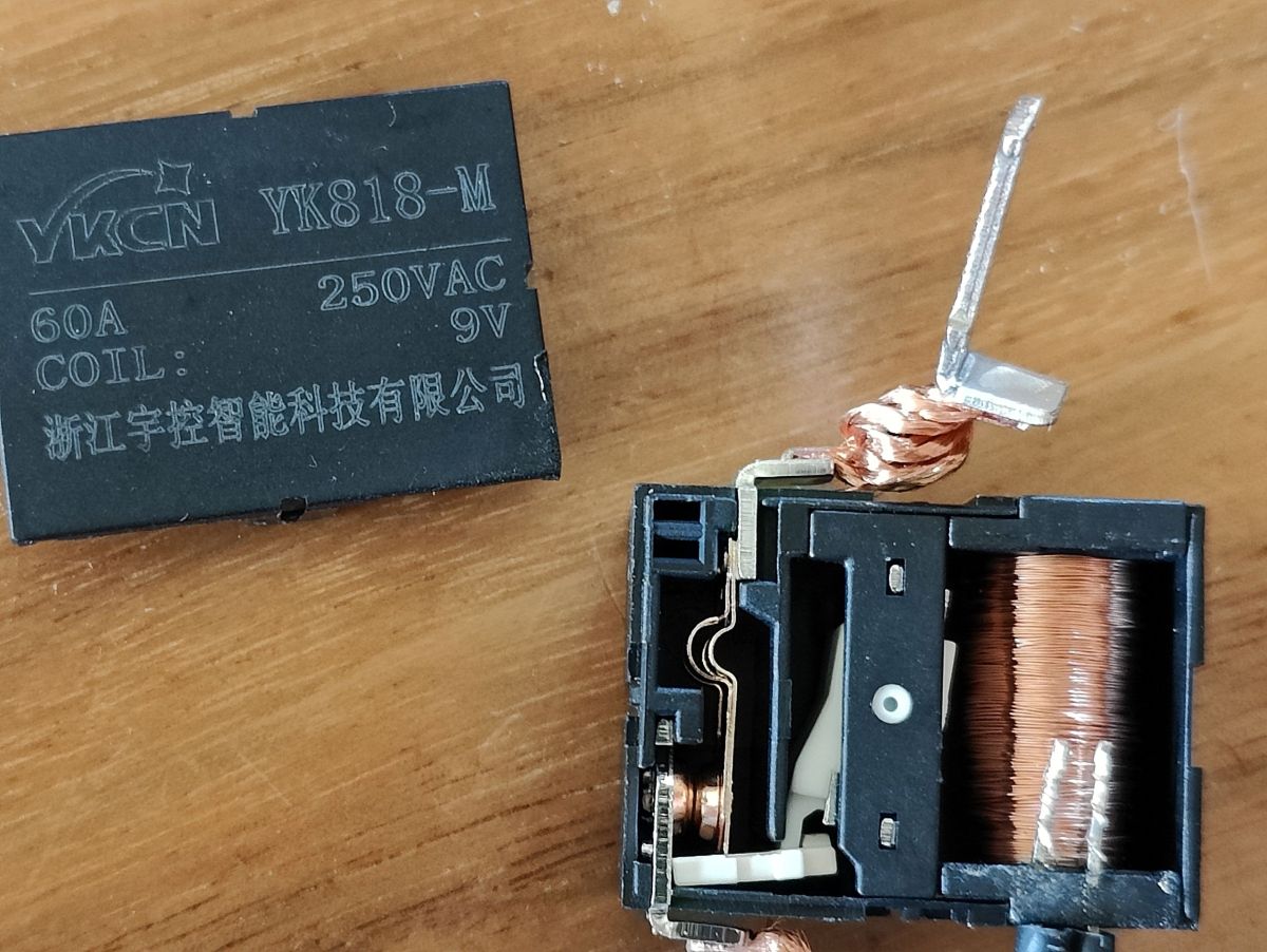

    Magnetic polarized relaye
    This one is a 9V version. Some device use 12V. Device is using a 12V supply.
    Disassembled YK818-M relay showing coil winding and internal contacts

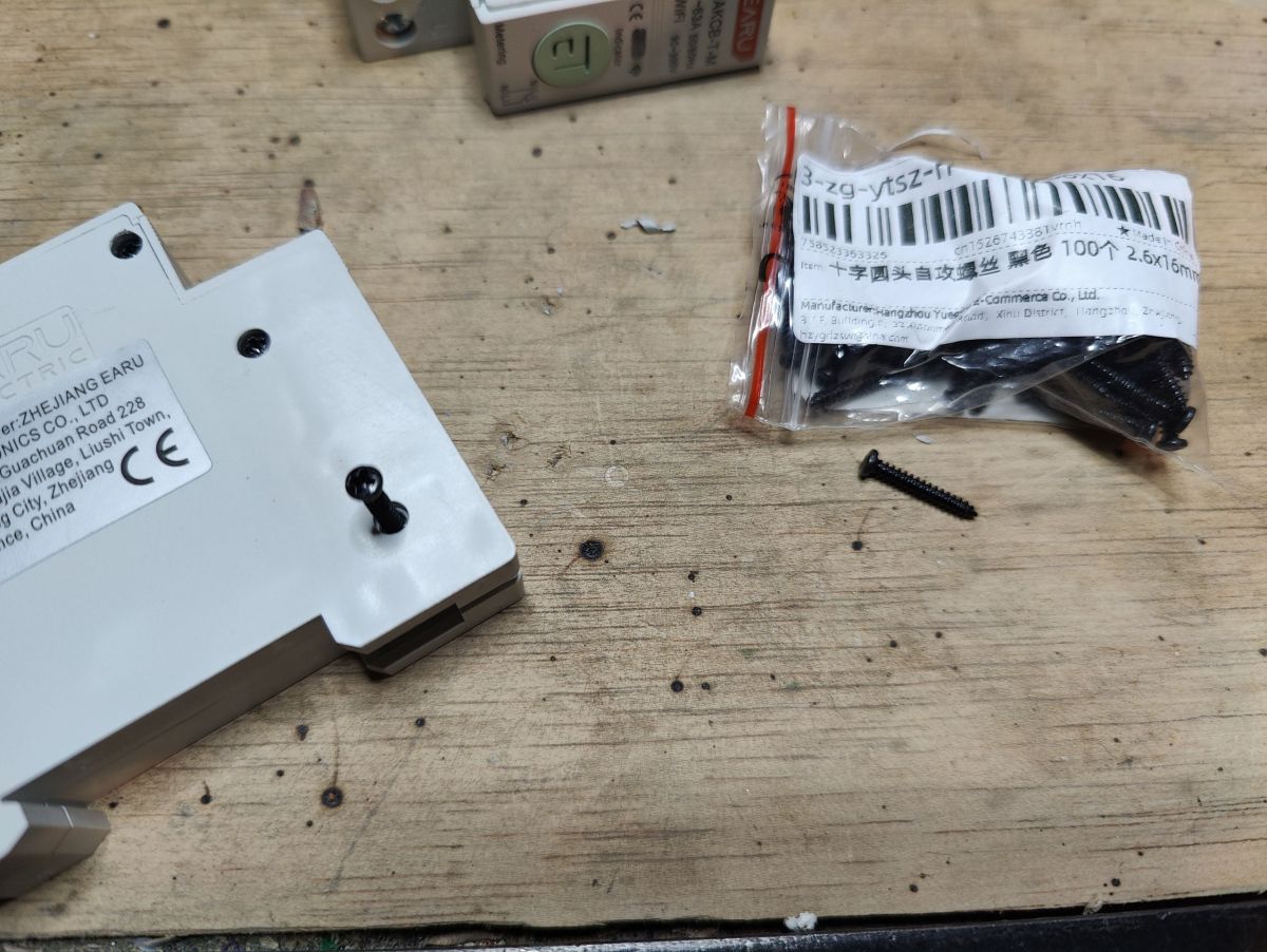

    earurelay
    Posts: 11
    >>21712027
    Hi Kaczakat.
    Well, I just screwed some M2.5 screws inside rivet hole. This fit perfectly, and keep it tight.
    Youare right, you can use tubular rivets, but I never tried.
  • #6 21720512
    earurelay
    Posts: 11
    >>21712027
    Hi again Kaczakat,
    Here is what I do at home.
    2,6x16mm screws.
    Close-up of electrical component with screws and screw pack on wooden surface

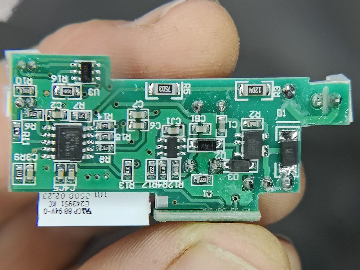

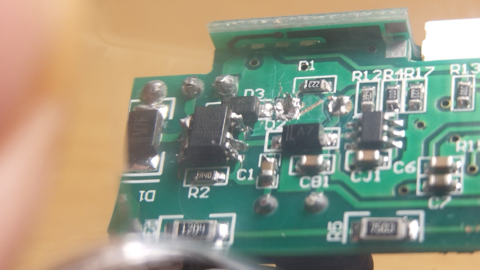

  • #7 21865955
    savalex1977
    I fixed the reboot by increasing the power supply. I soldered two BP2522F chips in parallel.
    Close-up of a green PCB with SMD components and visible solder joints
  • #8 21866638
    earurelay
    Posts: 11
    Brilliant idea!
    I'll do the same to quickly fix my bad devices.
    Thanks !
