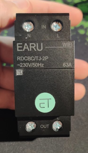

  • Teardown of the EARU RDCBC/TJ-2P DIN-rail relay/energy meter from AliExpress, cosmetically identical to the earlier VKSELE VKS-2P but with different mainboard and Wi‑Fi module.

    It is branded EARU RDCBC/TJ-2P. It looks cosmetically identical to one I bought previously branded VKSELE VKS-2P, but the mainboard and wifi module are completely different. This one has a CBU module, which appears to be an BK7231N, where the VKS-2P was a WB3S (BK7231T).
    It's very easy to access; only 2 screws in the back and it just opens right up.

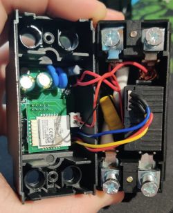

    Inside, the mainboard is secured in place with with 2 more small screws, one of them is hidden behind a capacitor which is folded down.
    There's a big relay, and a CT for energy measurements. There are no Tuya chips.

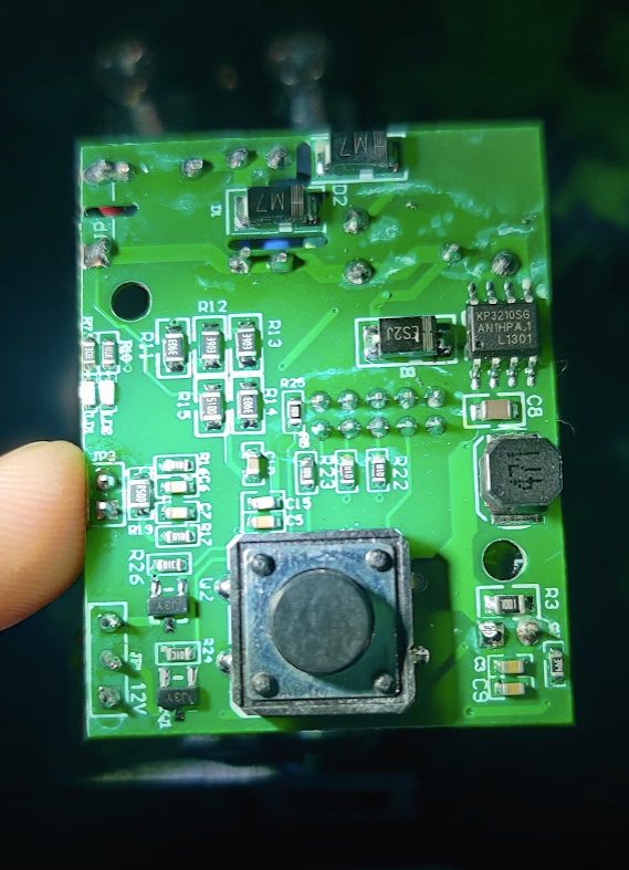

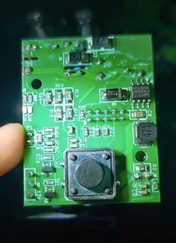

    Other side of the board with the button:

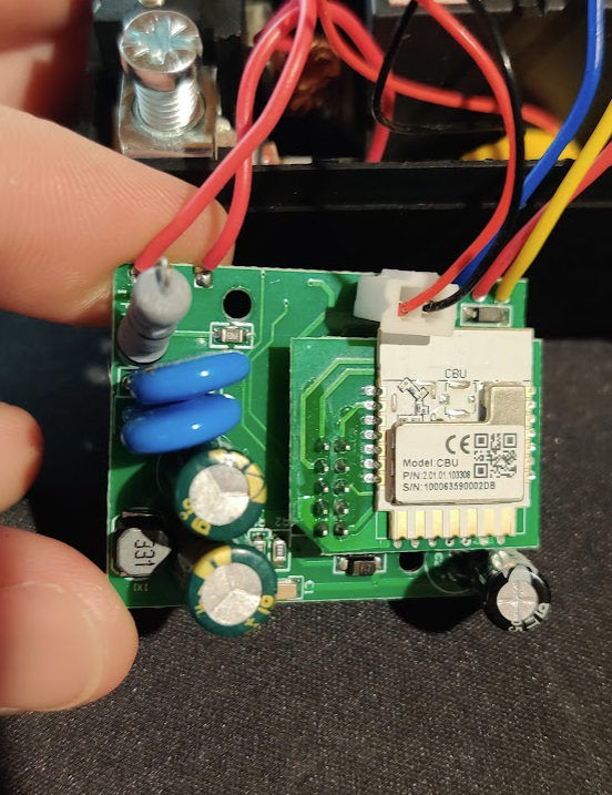

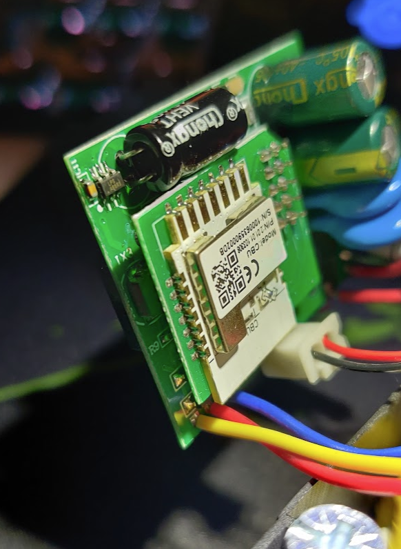

    Just like the older device, the CPU board is positioned on a soldered-down riser from the main board, and there is a small 8-pin chip deep under there which I can't see, with pins leading directly to the CPU. My guess is still that it's probably BL0937.
    [BK7231N - CBU] EARU RDCBC/TJ-2P DIN-rail relay/energy meter
    I haven't attempted flashing yet, I haven't seen mention of this CBU in other places, maybe it's fairly new?
    I'm assuming it's a BK7231N, and I'll try to follow the procedure for that chip.
    I tested the pins connecting the riser to the main board with the continuity meter, and it seems roughly the same pin layout as the VKS-2P I dismantled earlier.

    It seemed the VKS-2P had BL0937 hidden under the wifi board, but I can see on this new model that there is also a chip hidden under the wifi board, but it has 10 pins rather than the 8 on the previous version (BL0937 has 8 pins). So this is something else.
    Using a meter I could trace that these pins breakout to the mainboard: P9, P16, P24, P26, P28, TX1, RX1
    I found the LED seems to be connected to P28, and button is connected to P26, red led is P9 (it could be power led or wifi led). P24 and P16 toggle the relay; to change state, when one is high, the other must be low, and vice versa.
    That leaves no GPIO for the meter, so that must be what TX/RX are for, and it does seems to be a BL0942 chip.

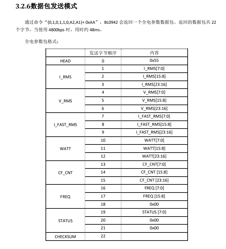

    Here is a documentation of what BL0942 sends to us by UART:

    That's great, there's a heap of extra information there.
    It looks like it doesn't report power factor, but does the chip provide accurate values to calculate power factor correctly?
    Can you please read all the values and display them in a future update?

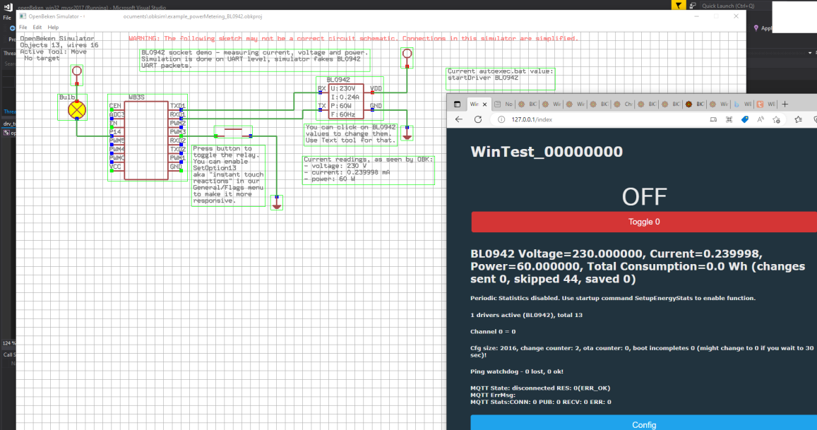

    PS: Do you know that OpenBeken will soon get a Windows Simulator, able to simulate RGB strips, CW strips, relays controllers and power metering sockets? See below for a little sneak-peak:
