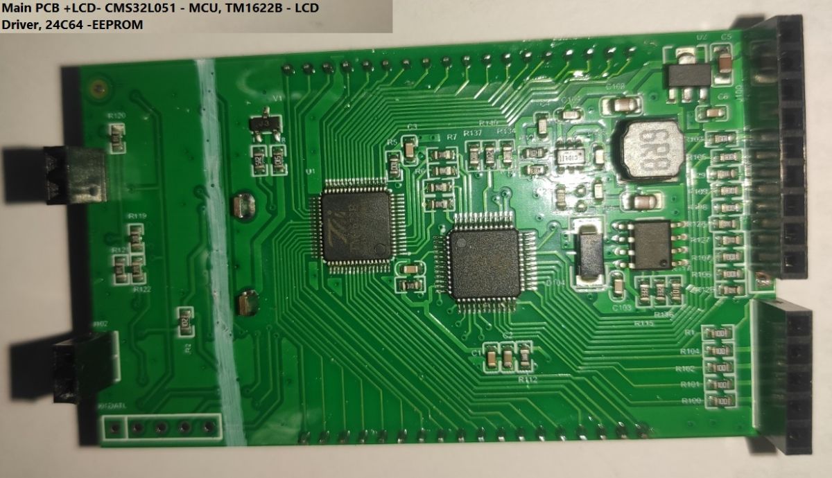

  • Inside, the modules sit on gold pins, the RN8302B handles measurement, CMS32L051 controls the logic, and the display uses an LCD with color backlighting.

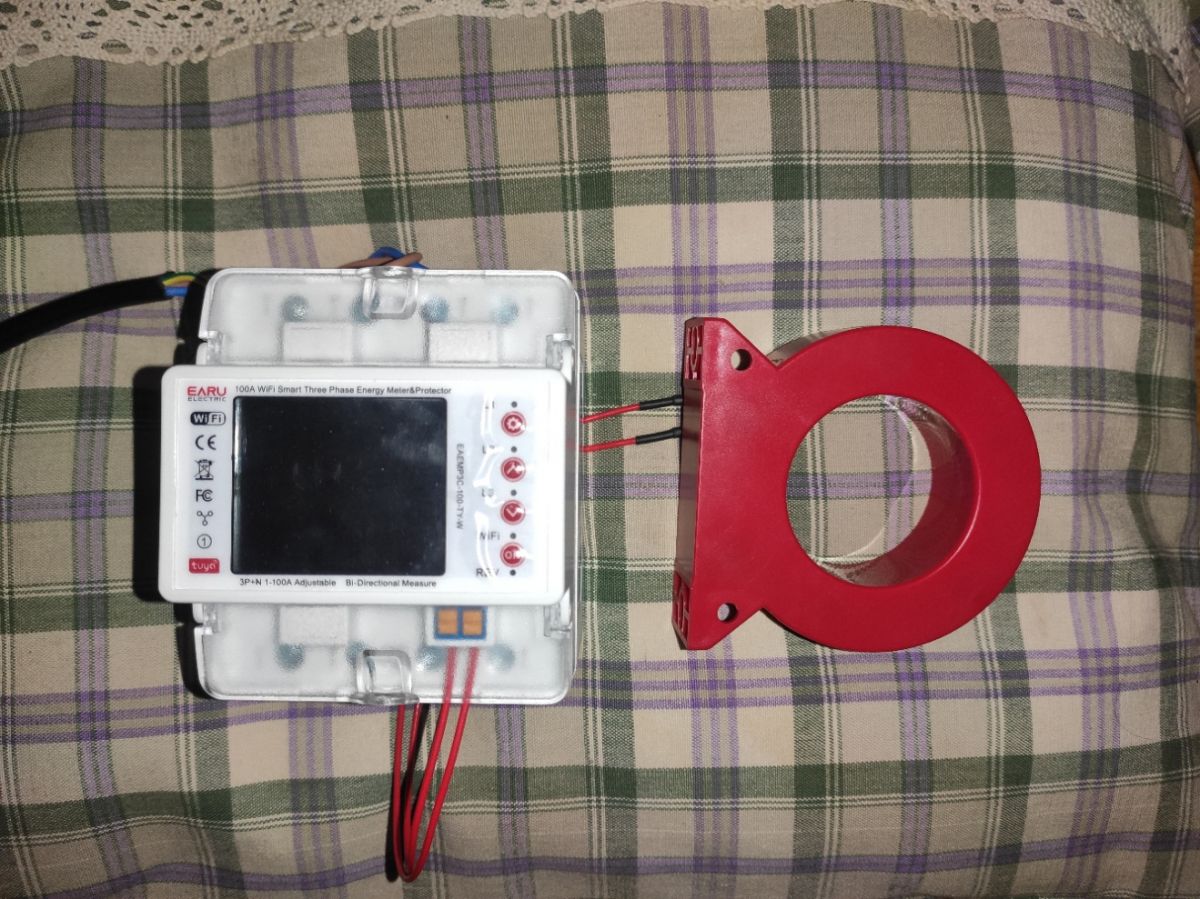

  • Hello

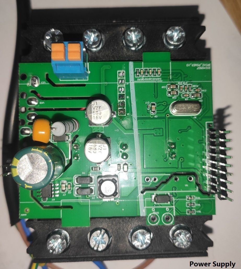

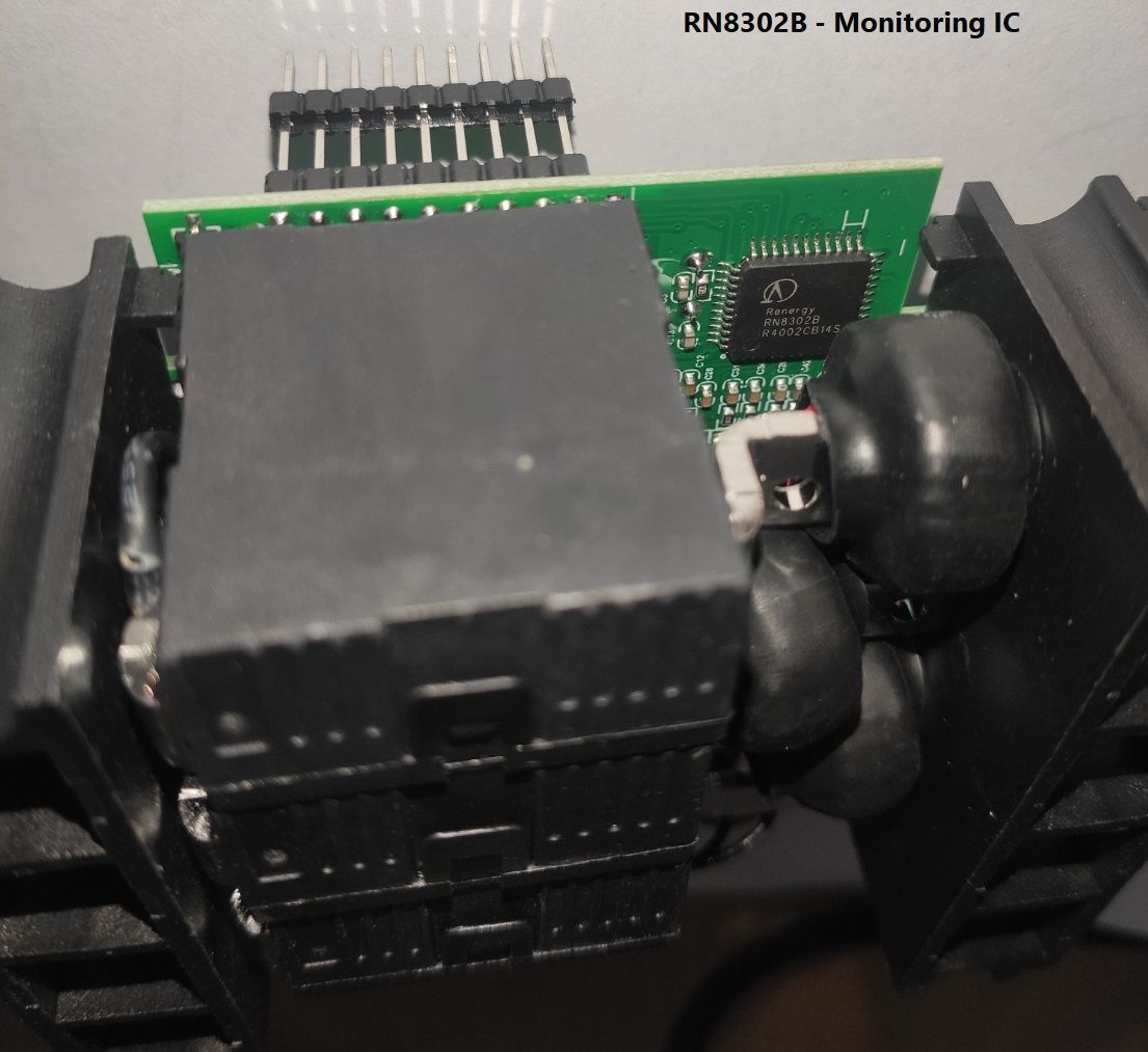

    A short report on the disassembly of the EARU EAEMP3C-100-TY-W.

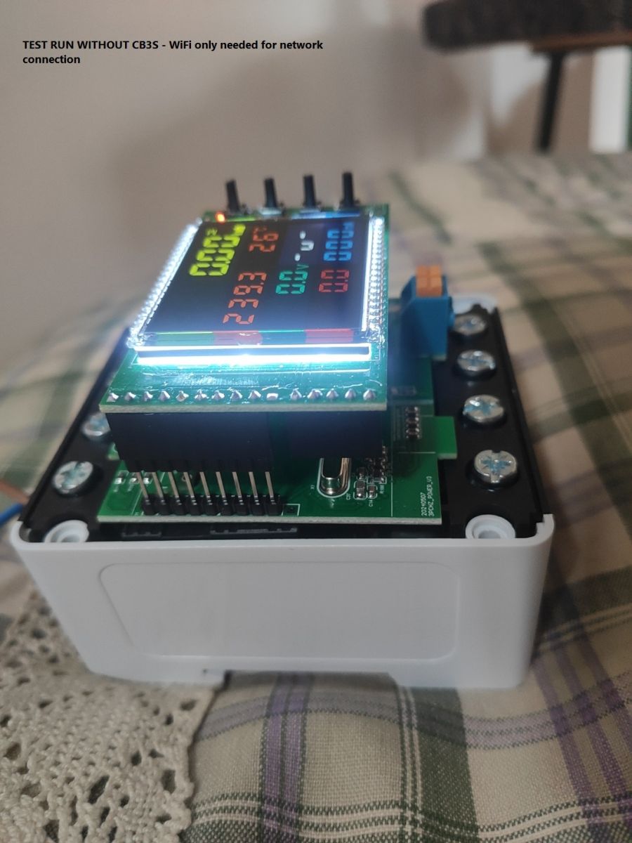

    View of an electronic device without the front casing, with an LCD display featuring colorful backlighting. .
    Fig. 1. Device without front casing commissioned without CB3S module

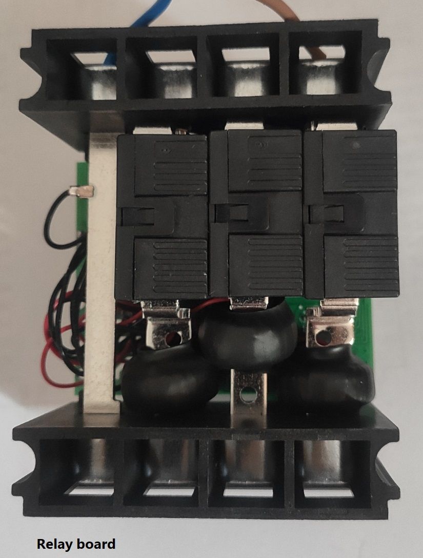

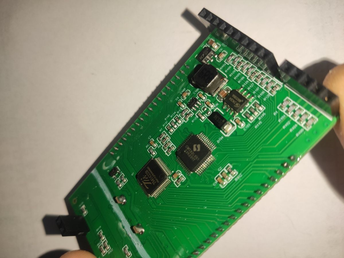

    The individual modules of the device can be separated without the use of a soldering iron, they are seated on golpins.
    The measuring system of the device is the RENERGY RN8302B, to which the measuring coils are connected, the whole is managed by the CMS32L051 chip, which contains an ARM® Cortex®-M0+ 32bit core, and for the display of the parameters there is an LCD display with colour backlighting/film under part of the screen - it looks quite nice.

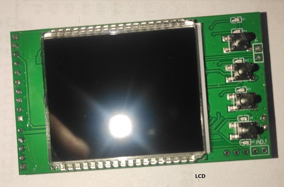

    There are 2 measurement screens to choose from in the device settings. The nominal unit works with TUYA and you configure it through their app. The whole thing is quite easy to configure and works 'out of the box', BUT A LOT OF SETTINGS ARE ONLY AVAILABLE FROM THE APP.
    A measuring coil can be connected to the device to measure leakage. The dimensions of the coil are quite large about 76mm outer diameter, resistance about 90 Ohm, inductance about 76H (measurement of inductance uncertain because with some old meter with a weak battery), described as AC2000:1 on aliex.... .
    The unit, when powered (it is powered ONLY from phase L1 and N), draws 1W, when WiFi is configured approx 1.3-1.5W with relays on.

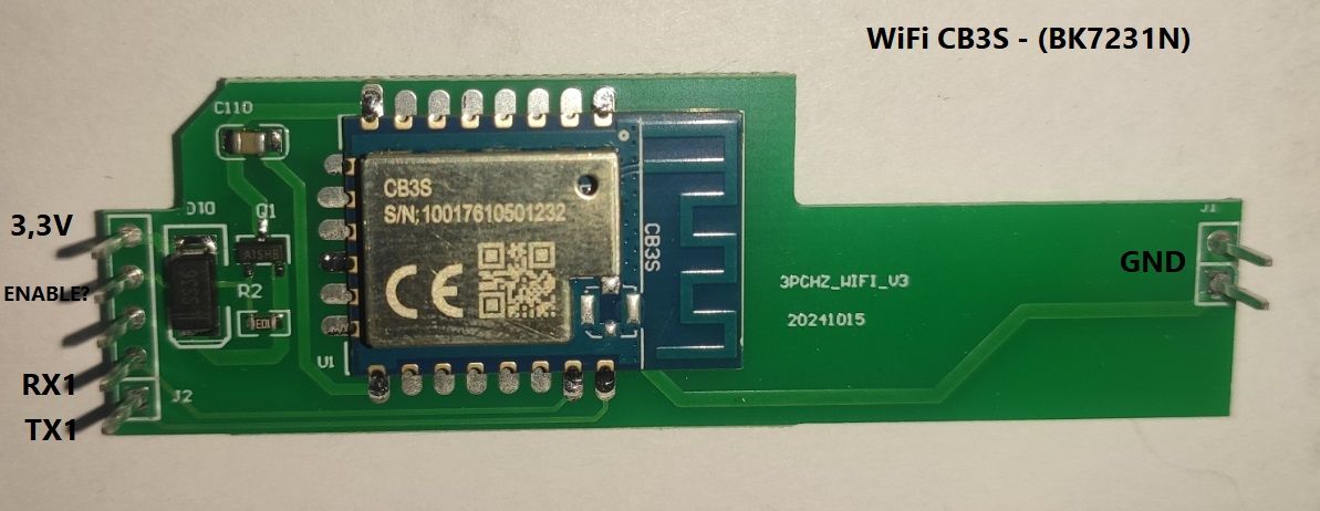

    The CB3S WiFi module is easily removable, the photo shows the pinout, except that if you want to flash the device you need to connect directly to the module with 3.3V power supply - the power supply from the goldpin is controlled by a transistor.

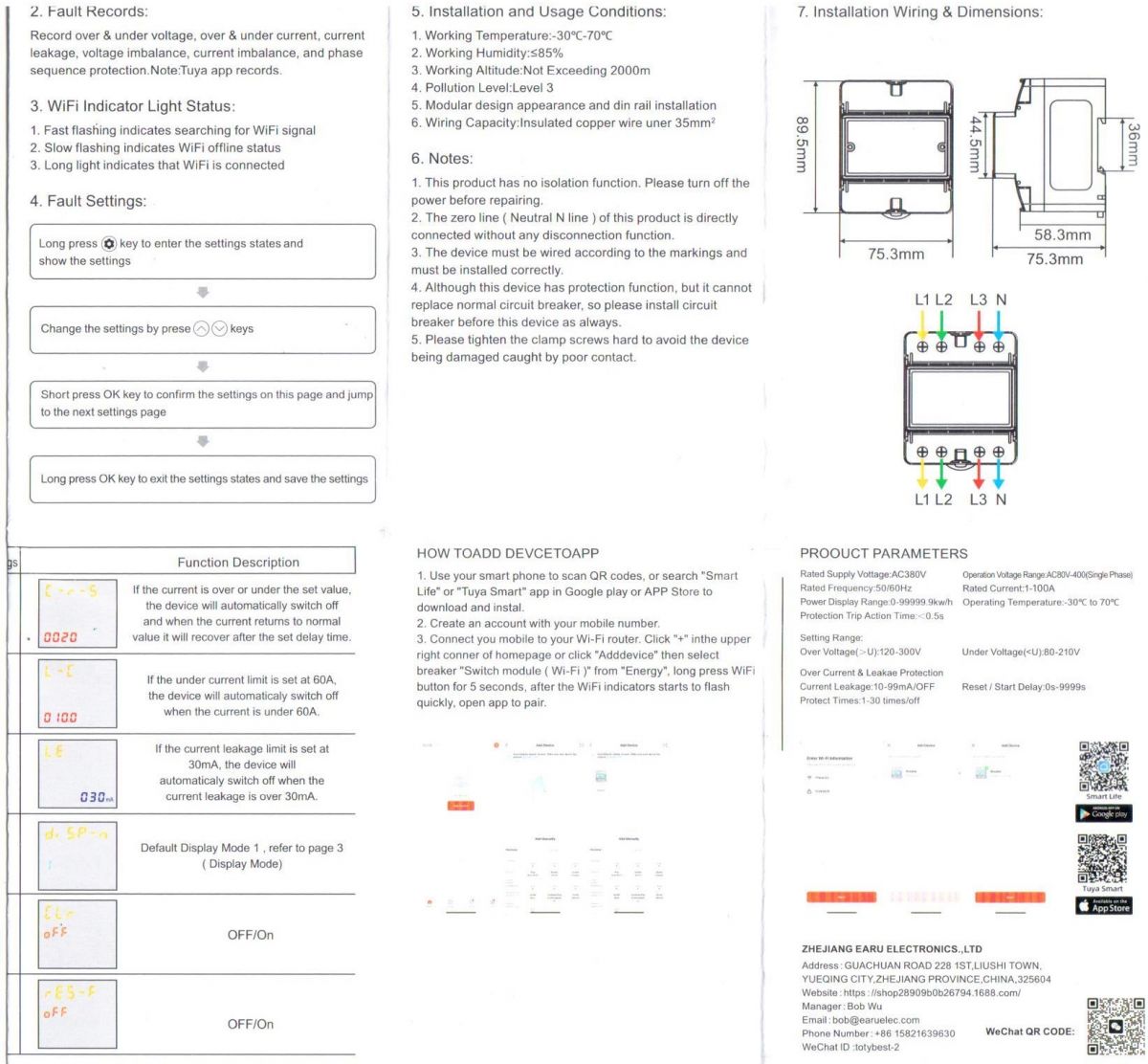

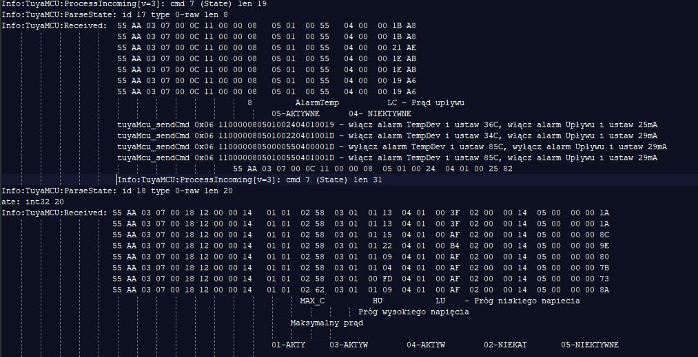

    The device is quite interesting due to the possibility of protection against too high, too low voltage, lack of one of the phases, it also has the possibility of setting the minimum and maximum current and time operation, the time of triggering the protection can be set, also the time of return to work is configurable. The device is described as 3P+N 1-100A - which is probably correct 100/4=25A or 100/3=33A is rather the max what the relays can withstand;) . The unit is capable of bi-directional energy counting, basically it displays the sum of energy consumed and produced, by clicking the arrow buttons we can see the individual components of the sum.

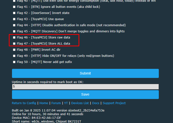

    This much could be ascertained before the device was 'broken', when using the BK7231GUIFlashTool-v5 software there was a problem connecting to rip the software, and during one attempt before the soft landed on the disk I managed to press the Write key instead of Read, and this of course went like this the first time. A strange program by the way, when trying to read it pops up several windows making a simple read difficult. It is not possible to read the memory into the buffer first and then write the file, while write simply fires without any question.
    As the OpenBK7231N_QIO_1.18.23 software has been installed I don't have much left.... By trial and error I managed to find a few dpid, unfortunately only a part. Currently most of the dpID is captured and described. the recommended firmware is at least OpenBK723131N_1.18.30.

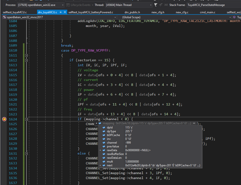

    Below is the autoexec that I managed to put together, however it is definitely up for improvement (it would be nice if someone corrected it), the readout of phase parameters measuring power consumption, power factor, and leakage current, temperatures and a few configuration parameters works.

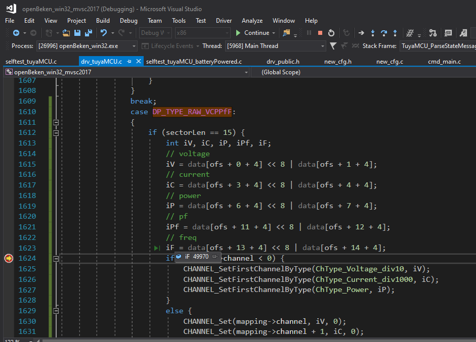

    The code provided, however, manages to crash and not give any other measurement except the last/start measurement. The dpid capture with the "tuyaMcu_sendQueryState" command does not work, at least on this version of OpenBK (or I don't know how to handle it).
    The wifi settings reset key does not work properly - although the logs show it is supported - the WiFi reset command appears, it would be nice if it reset the wifi to factory settings as it did in the original softy.
    After selecting more than 32 dpid the next one can be saved, but to delete it you have to format the whole device.

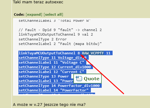

    Currently thanks to the invaluable help of p.kaczmarek2 autoexec is practically finished.

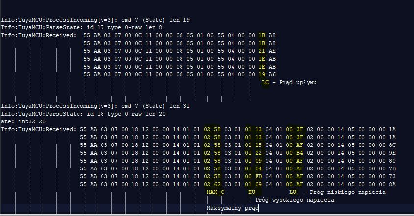

    Some of the settings appear in the debug log only after saving the settings on the meter - I wonder if any command can trigger such a report - TAK write dpID18 ? Below is such a message:

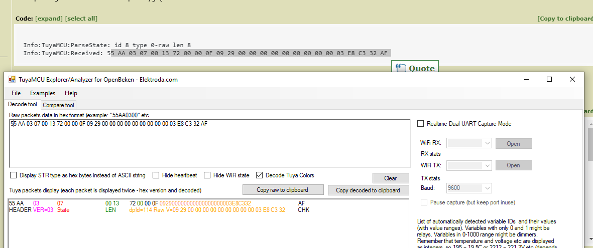

    00 18 12 00 00 14  01 01  *03 2A*  03 01 *01 04*  04 01 *00 B2*  0200 00 14 05 00 00 00 51
    00 18 12 00 00 14  01 01  *03 2A*  03 01 *01 06*  04 01 *00 B3*  0200 00 14 05 00 00 00 54
    			01=ON*MAX_C*	 03=ON*VH VH*	04=ON*VL VL*	02=OFF-3PhaseCurrent inbalance 05=OFF- Lack of 1 Phase disabled

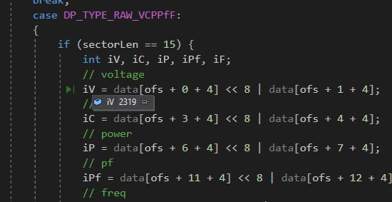

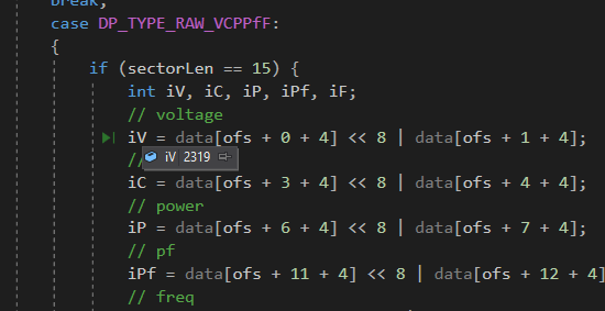

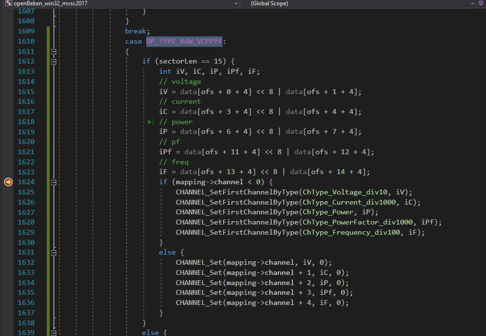

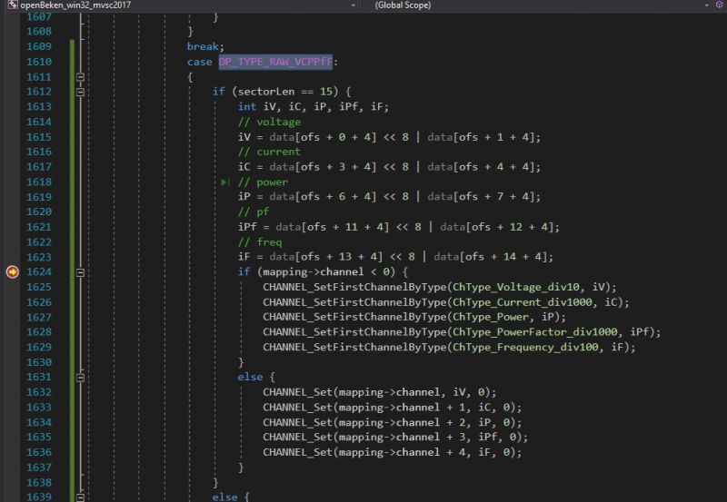

    I can't see the grid frequency anywhere - the meter gives it after the decimal point, e.g. 49.9Hz... dpID113-115 contained this information.

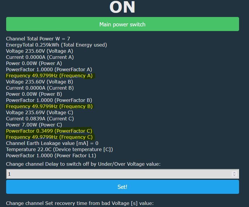

    This works: reading voltage,current,power,powerfactor and frequency for all 3 phases. Here note - the frequency measurement is cheated the frequency of the power phase is copied in the MCU to the other phases.
    Leakage current reading, energy produced and consumed, device temperature reading, WiFi reset are all operational. The dpID of the alarm settings are known, but they are complex and can only be configured on the command line for now - there are examples in autoexec, error codes are known - they are listed in this topic.
    Only the operating schedule is missing - dpID117 is 90% responsible for it.

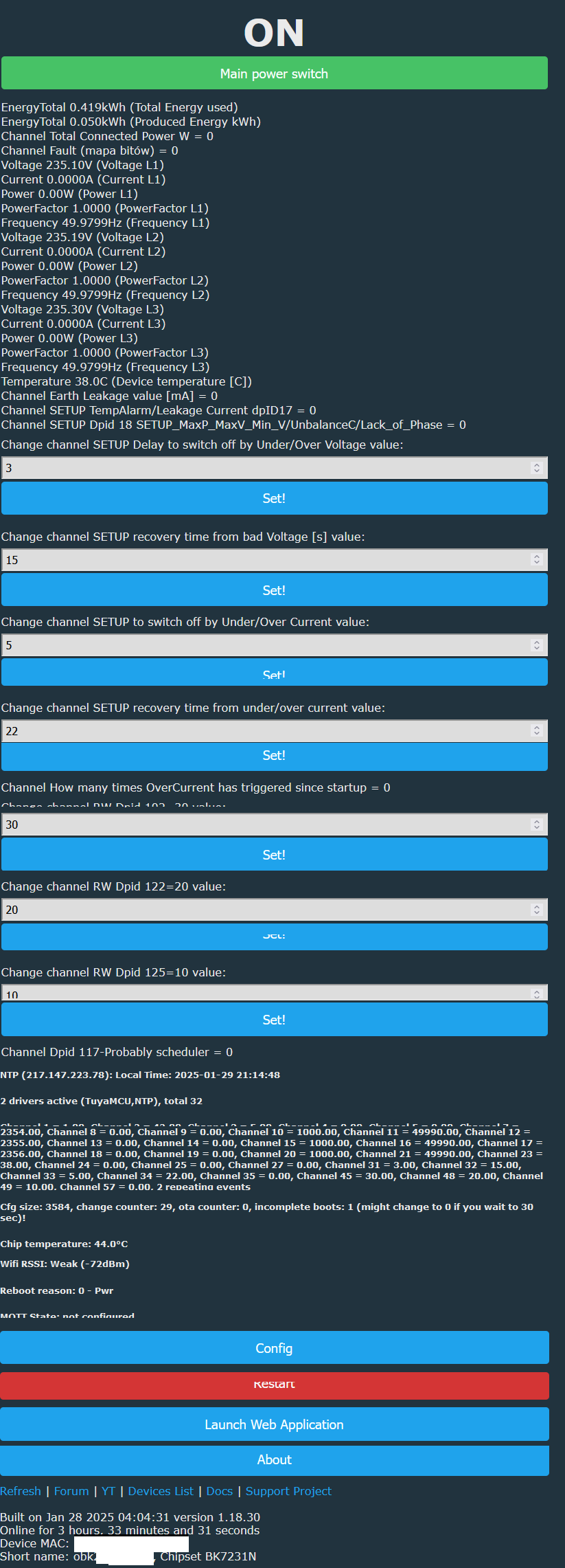

    Below is the view from the interface.
    Screenshot of the EAMP3C-100-TY-W device settings interface. .

    RN8302B chip on a circuit board with visible monitoring components. .
    Fig. 2. Relay board, with measurement circuitry visible ReEnergy RN8302B .
    Relay board with visible measurement coils. .
    Fig. 3. Top view of the relays themselves, measuring coils on individual phases visible, neutral track not interrupted.
    Power supply board with various electronic components. .
    Fig. 4. The other side of the relay board showing the power supply based on the circuit with the description "8231H Q24A1006"
    Main PCB with CMS32L051, TM1622B, and EEPROM 24C64 chips .
    Fig. 5. Board with MCU CMS32L051 , display controller TM1622B , and 24C64 eeprom.
    Close-up of a circuit board with various electronic components, including integrated circuits. .
    Fig 6. The same board from a different angle visible circuit markings.
    LCD display board with control buttons. .
    Fig 7. The board with the display also visible buttons for operation.
    WiFi module CB3S with BK7231N chip showing pin labels. .
    Fig. 8. CB3S WiFi communication module based on BK7231N chip (screen not removed).
    Device EARU EAEMP3C-100-TY-W without front cover and measurement coil. .
    Figure 9: Relay including current leakage measurement coil.
    User manual for the EARU EAEMP3C-100-TY-W device showing the display and setting tables. .
    Scan of the device installation and usage instructions .
    Figure 10-11: Scan of instructions

  • Enable TuyaMCU queue flag for more dpIDs
    #2 21411365
    Posts: 14755
    Rate: 12881
    Thanks for the presentation. As for improving the setup, I would start with whether this meter uses the UART (TuyaMCU) to report the connection to the cloud, or perhaps another pin?
    How do I get the TuyaMCU device to send more data? Why are dpIDs not being sent? .
    I, in the case of this device was not getting full dpIDs for anything until I set the right state on the respective pin....
    halinka1125 wrote:
    However, the given code manages to crash and not give any other measurement except the last/starting one. It doesn't work, at least on this version of OpenBK, to capture the dpid with the "tuyaMcu_sendQueryState" command (or I don't know how to handle it).
    Maybe call it up every so often?
    // every 10 seconds, request update from TuyaMCU
    addRepeatingEvent 10 -1 tuyaMcu_sendQueryState
    halinka1125 wrote:
    The wifi settings reset key doesn't work properly - although in the logs you can see that it is supported - the WiFi reset command appears, it would be nice if it reset the wifi to factory settings as it did in the original firmware.
    What does this look like in the logs? What message was that from TuyaMCU?
    halinka1125 wrote:
    When you select more than 32 dpid the next one can be saved, but to delete it you have to format the whole device.
    At this point I'm not sure I know what this is about, maybe the channel types are remembered? These can be changed in the Web App
    halinka1125 wrote:
    Some of the settings only appear in the debug log when the settings are saved on the meter - I wonder if any command can trigger such a report? Below is such a message:
    And which dpID is this?
    You can also enable the TuyaMCU queue flag in flags.
  • Web app checkbox limit leaves extra dpids undeletable

    I have added a mechanism to force the download as follows
    and the dpID part actually downloads ... I need to test more thoroughly ...
    Only the UART is derived from the CB3S module, an additional connected pin controls the power supply of the chip. The led is controlled from the MCU not from the CB3S.
    Regarding the WiFi reset, it is implemented by the buttons connected to the MCU, when the option is selected from the menu (net-rs) a command is sent to the CB3S module,this appears in the debug log:
    Info:MAIN:Time 1552, idle 195122/s, free 55336, MQTT 0(97), bWifi 1, secondsWithNoPing 1482, socks 2/38
    Info:TuyaMCU:Received: 55 AA 03 04 00 00 06
    Info:TuyaMCU:ProcessIncoming[v=3]: cmd 4 (WiFiReset) len 7
    Info:TuyaMCU:ProcessIncoming: 0x04 replying
    Info:TuyaMCU:Received: 55 AA 03 05 00 01 00 08
    Info:TuyaMCU:ProcessIncoming[v=3]: cmd 5 (WiFiSelect) len 8
    Info:MAIN:Time 1553, idle 187514/s, free 55336, MQTT 0(97), bWifi 1, secondsWithNoPing 1483, socks 2/38
    Info:MAIN:Time 1554, idle 190035/s, free 55336, MQTT 0(97), bWifi 1, secondsWithNoPing 1484, socks 2/38
    Fixed in OpenBK7231N_QIO_1.18.26
    It is the Web App that I am concerned with, there are 32 "checkboxes" available, if we add more than 32 then the next ones cannot be deleted once we use them, they always remain visible on the page with the value 0. (even though we stop using them).
    When more than 32 dpid are selected, the next one can be saved, but to delete it you have to format the whole device.
    Well precisely there is no dpID the device sends the message 00181200.... when saving the settings. - it is only visible in the log. There is for sure current max, voltage min and max, the rest I have not deciphered.
    Info:TuyaMCU:Received: 55 AA 03 00 00 01 01 04
    ... info o wifi
    Info:TuyaMCU:ProcessIncoming[v=3]: cmd 0 (Hearbeat) len 8
    00 18 12 00 00 14 01 01  03 2A  03 01 01 04  04  01 00 B2  02  00 00 14 05 00 00 00 51
    Some of the settings only appear in the debug log when the settings are saved to the meter - I wonder if any command can trigger such a report? Below is such a message:
    And I have another question about WiFi activity is it normal that the module performs so many wifi related operations?
    also a message often appears
    Info:TuyaMCU:ProcessIncoming[v=3]: cmd 43 (NetworkStatus) len 7
    Info:TuyaMCU:ProcessIncoming: (test for S09 calendar/IR device) received TUYA_CMD_NETWORK_STATUS 0x2B
    It seems to be the WiFi status that is called up?
    Updated autoexec below, seems to be more stable.
    Still no reading of PF_L2,PF_L3, individual frequencies, total energy. Updated dpID list with those that appeared after setting the Query flag (3pc in total 105,106,109), Decrypted a few more dpIDs, 14 of unknown significance remain.
    startDriver TuyaMCU
    tuyaMcu_setBaudRate 9600
    startDriver NTP
    ntp_timeZoneOfs 1 //optional
    tuyaMcu_sendCurTime //wysyła czas z TuyaMCU do MCU, bez tego jak zgubił czas to nie uaktualniał
    // This one is better than tuyaMcu_defWiFiState 4;  MQTTState 1 = WiFiState 4
    // issuing of tuyaMcu_defWiFiState 4 continues the script,
    // but doesnt report to MQTT since there is still no connection.
    // if you didn't setup MQTT connection then issue tuyaMcu_defWiFiState 4
    // and comment waitFor MQTTState 1
    // waitFor MQTTState 1

    linkTuyaMCUOutputToChannel 6 RAW_TAC2121C_VCP 5
    setChannelType 5 Voltage_div10
    setChannelLabel 5 "Voltage A"
    setChannelType 6 Current_div1000
    setChannelLabel 6 "Current A"
    setChannelType 7 Power
    setChannelLabel 7 "Power A"
    linkTuyaMCUOutputToChannel 7 RAW_TAC2121C_VCP 8
    //corruption detected
    setChannelType 8 Voltage_div10
    setChannelLabel 8 "Voltage B"
    setChannelType 9 Current_div1000
    setChannelLabel 9 "Current B"
    setChannelType 10 Power
    setChannelLabel 10 "Power B"
    linkTuyaMCUOutputToChannel 8 RAW_TAC2121C_VCP 11
    setChannelType 11 Voltage_div10
    setChannelLabel 11 "Voltage C"
    setChannelType 12 Current_div1000
    setChannelLabel 12 "Current C"
    setChannelType 13 Power
    setChannelLabel 13 "Power C"
    // Leakage tripping - Dpid 15 "leakage_tripping" -> channel 14
    linkTuyaMCUOutputToChannel 15 val 14
    setChannelType 14 ReadOnly
    setChannelLabel 14"Earth Leakage value [mA]"
    // Device temperature - Dpid 15 "Device temperature" -> channel 15
    linkTuyaMCUOutputToChannel 103 val 15
    setChannelType 15 Temperature
    setChannelLabel 15 "Device temperature [C]"
    // Alarm temperature - Dpid 118 "Power Factor L1" -> channel 16
    linkTuyaMCUOutputToChannel 118 val 16
    setChannelType 16 PowerFactor_div1000
    setChannelLabel 16 "Power Factor L1"

  • Power factor and frequency in RAW_TAC2121C_VCP data
    #4 21412434
    halinka1125
    Level 22  
    Posts: 531
    Help: 49
    Rate: 30
    Hello again after some tests
    Is it possible to change the RAW_TAC2121C_VCP parameter so that it shows the power factor and frequency in addition?
    After looking at the topic https://www.elektroda.pl/rtvforum/topic4059060.html
    I see
    Info:TuyaMCU:ParseState: id 8 type 0-raw len 8
    Info:TuyaMCU:Received: 55 AA 03 07 00 13 71 00 00 0F 09 29 00 01 B7 00 03 FC 00 00 00 03 E8 C3 32 65
    that 03E8 - is 99% the Power Factor for that phase
    and C332 - is its frequency
    And I wanted to ask if after backing your configuration and RF config to the BK7231N dump, do you need to count any checksums or should it work?
    Greetings
  • Separate package type needed for corrected parsing

    Hmm parsing does not work on .27 - dpID looks like this:
    Info:TuyaMCU:Received: 55 AA 03 07 00 13 72 00 00 0F 09 29 00 00 00 00 00 00 00 00 00 03 E8 C3 32 AF
    As parsing I have to enter "RAW_VCPPfF" ?
    This is the autoexec I have now
    startDriver TuyaMCU
    startDriver NTP
    // Main Relay - Dpid 16 "switch" -> Channel 1
    linkTuyaMCUOutputToChannel 16 bool 1
    setChannelType 1 toggle
    setChannelLabel 1 "Main power switch"
    // Total energy Used - Dpid 1 "Power Used" -> channel 4
    linkTuyaMCUOutputToChannel 1 val 4
    setChannelType 4 EnergyTotal_kWh_div100
    setChannelLabel 4 "Total Energy used"
    // Total Power Dpid 111 -> channel 3
    linkTuyaMCUOutputToChannel 111 val 3
    setChannelType 3 ReadOnly
    setChannelLabel 3 "Total Power W"
    // Fault - Dpid 9 "fault" -> channel 2
    linkTuyaMCUOutputToChannel 9 val 2
    setChannelType 2 Error
    setChannelLabel 2 "Fault (mapa bitów)"
    linkTuyaMCUOutputToChannel 8 RAW_VCPPfF 11
    setChannelType 14 PowerFactor_div1000
    setChannelLabel 14 "PowerFactor"
    setChannelType 15 Frequency_div100
    setChannelLabel 15 "Freq"
    //tuyaMcu_sendQueryState
    Or is this not yet present in v.27?

    After all, in the log you gave I can see:
    Info:TuyaMCU:Received: 55 AA 03 07 00 13 72 00 00 0F 09 0E 00 00 00 00 00 00 00 00 00 03 E8 C3 32 94
    Info:TuyaMCU:ProcessIncoming[v=3]: cmd 7 (State) len 26
    Info:TuyaMCU:ParseState: id 114 type 0-raw len 15
    Info:TuyaMCU:Received: 55 AA 03 07 00 13 73 00 00 0F 09 0F 00 00 BF 00 00 78 00 00 25 01 10 C3 32 18
    Info:TuyaMCU:ParseState: id 115 type 0-raw len 15
    dpID 114 and 115 are 15 in length, I don't see that they have any other length.
    113 is the same.
    As I paste into myself for automatic testing:
    Code: C / C++
    and I put a breakpoint, I can see that they are parsed:
    Screenshot of source code for TuyaMCU. .
    Screenshot of code analyzing TuyaMCU data, showing how to calculate voltage, current, power, power factor, and frequency. .
    Looks ok to me. You have three dpID of the raw type:
    - 113
    - 114
    - 115
    Each is of type RAW_VCPPfF and contains in turn Voltage, Current, Power, PowerFactor, Frequency.
    And why do you have dpID 8 in your autoexec.bat?
    Screenshot showing code related to TuyaMCU and channel configuration. .
    At this point I think you should be catching dpID 113, 114 and 115, as this is probably the information for each phase.
    Generally they don't have one standard, if RAW_VCPPfF will work with 113, 114 and 115 then ignore 6, 7, 8 and that's it.
    Div1000 I can add, although I admit it came out a bit awkwardly with this, admittedly adding this divider is one place in the board, but still, at the planning stage of this we didn't know TuyaMCU that much.... supposedly there is an alternative way, because you can when mapping a single variable give your own divisor, but still....

    I read the posts again and I know what happened :D .
    Nothing has moved. You accidentally copied incorrectly from the log so that you merged two message fragments from different dpIDs into one and thought it was dpID 8.... Take a look at the screenshot:
    Screenshot of TuyaMCU Explorer with data in hex format. .
    Line one is from the previous package and line two is from the next package.... hence the impression that dpID 8 was longer.

    Well ok I agree that currently dpID 113,114,115 are the sought after values, just why didn't they appear before?
    After substituting as VCPPfF these dpIDs everything starts working as intended.
    The old dpID 6,7,8 as a "shortened" version also works:D .
    I just need to think more about how to extract the energy values because for now it only shows the consumed energy.
    At the moment 90%function and 100% usability works. When I'm inspired I'll try to look for the rest.
    Thank you for the amazing developer support:) .

    These tuyaMcu_sendCurTime you should move to the end of the script and add maybe some delay or waitFor before it, e.g:
    waitFor NTPState 1
    tuyaMcu_sendCurTime
    because otherwise the time will send before it downloads from NTP.

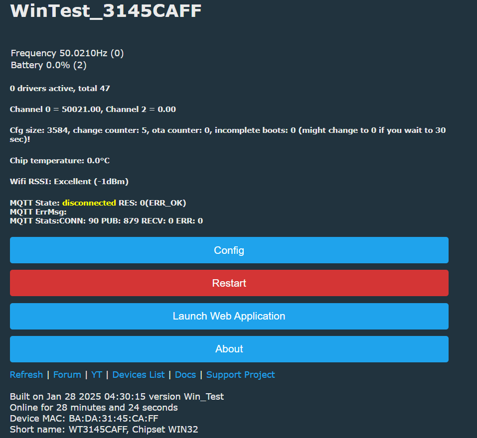

    I added a type for the frequency:
    User interface with diagnostic information for the WinTest_3145CAFF device. .
  • Decoded Tuya dpIDs 17, 18 and 110

    Thank you
    I have changed as advised, there are correct frequency and power factor readings.
    Control panel with the main power switch on, displaying energy consumption and electrical parameters.

    PS. How to correctly declare the error/status dpID shows that the data is normally 5 bytes:
    09 05 00 01 00 - but are read as 0 with me.
    Info:TuyaMCU:Received: 55 AA 03 07 00 05 09 05 00 01 00 1D - normal state
    Info:TuyaMCU:ProcessIncoming[v=3]: cmd 7 (State) len 12
    Info:TuyaMCU:ParseState: id 9 type 5-bitmap len 1
    Info:TuyaMCU:ParseState: byte 0
    Info:GEN:No change in channel 2 (still set to 0) - ignoring
    Info:TuyaMCU:Received: 55 AA 03 07 00 06 09 05 00 02 04 00 23 - overvoltage
    Info:TuyaMCU:ProcessIncoming[v=3]: cmd 7 (State) len 13
    Info:TuyaMCU:ParseState: id 9 type 5-bitmap len 2
    Info:TuyaMCU:Received: 55 AA 03 07 00 06 09 05 00 02 08 00 27 - undervoltage
    Info:TuyaMCU:Received: 55 AA 03 07 00 06 09 05 00 02 01 00 20 - overcurrent
    I have decoded the following dpIDs
    110 - energy produced
    17 - contains set leakage current
    18 - contains set maximum current, maximum voltage, minimum voltage.
    Screenshot showing TuyaMCU process data. .
    id 17 type 0-raw len 8
    Info:TuyaMCU:Received:  55 AA 03 07 00 0C 11 00 00 08 05 01 00 55 04 00 00 1B A8
    id 18 type 0-raw len 20
    Info:TuyaMCU:Received: 55 AA 03 07 00 18 12 00 00 14 01 01 02 58 03 01 01 13 04 01 00 3F 02 00 00 14 05 00 00 00 1A
    Just how to handle it...
    I have a question if it is possible to increase the size of the log buffer, or to set it to write to a file, because with a lot of pids the window is missing and doesn't display most of them....
    Specifically, after defining a dpID in the log, some dpIDs no longer appear even though they are read to html.

  • Flagged data can be viewed via REST API
    #13 21414494
    Posts: 14755
    Rate: 12881
    You don't have to write to a file, you have a flag for that:
    Screenshot showing flag settings in the control interface for TOMPD-63-WIFI. .
    Once you attach it, the data received from now on is remembered and you can view it like this:
    http://192.168.0.170/cm?cmnd=dps
    Flags and raw values can either only be programmed in C at the moment, or via the REST API, as here:
    Alternative HTML control page for TOMPD-63-WIFI .
    but if you want I can think of another solution, and this bitmap faults to be read-only?
  • Decoded Tuya alarm dpid mapping and alarm codes
    #14 21414555
    halinka1125
    Level 22  
    Posts: 531
    Help: 49
    Rate: 30
    Thanks for the information
    I've decoded the alarm control, dpID17 and dpID18 are used for this
    there is one byte of alarm No., one byte of -whether active and a two-byte value of a given variable - you can see what it is about in the picture
    Display of TuyaMCU error codes with information on alarms and states. .
    However, the error values that came to my mind are as follows
    3F imbalance is missing for current and voltage - if I figure out how to do it, I'll add it (the meter somehow checks during startup whether it has 1 phase or 3 on the inputs). As far as I can see there are 2 more inactive alarms (apart from the 3F phase ones) but I have no idea what they do. I've tried with the frequency and the only thing I've detected is that the programmer has excluded frequencies above 65Hz in the Tuya protocol and is counting the Hz from scratch (it's showing fine on the meter LCD).
    Info:TuyaMCU:Received: 55 AA 03 07 00 05 09 05 00 01 08 25 - electrity leak
    Info:TuyaMCU:Received: 55 AA 03 07 00 05 09 05 00 01 10 2D - over heat
    Info:TuyaMCU:Received: 55 AA 03 07 00 05 09 05 00 01 00 1D - Normal state
    As far as I can see I can't write anything else to the map so it's read-only (forcing the state isn't possible either).
    I will have to create alarm settings in html somehow - but I am not a programmer:P .
    Thanks for the tip about saving the data. I will test it.
  • Proposed dpID 17 alarm payload format
    #15 21414678
    Posts: 14755
    Rate: 12881
    While these alarms are fairly standard I can prepare an additional command for this. Are they compatible with this theme?
    https://www.elektroda.pl/rtvforum/topic4101799.html
    Search there for "dpID 17"....
    There it was:
    55 AA	00	06		00 14	120000100101003F03000118040000A00801000A	4F
    HEADER	VER=00	SetDP		LEN	dpId=18 Raw V=01 01 00 3F 03 00 01 18 04 00 00 A0 08 01 00 0A		CHK
    So you are saying that it is:
    - alarm id (byte)
    - alarm status (byte) 1 or 0
    - threshold value (2 bytes)
    and so N times?
    i.e. here:
    01 01 00 3F - id 01, state 01, value 003F
    03 00 01 18 - id 03, status 00, value 0118
    04 00 00 A0 - id 04, status 00, value 00A0
    08 01 00 0A - id 08, status 01, value 000A
    If this format is repeated, I would be able to add some command that automatically creates a gui for these alarms....
  • Tuya MCU alarm and fault bitmap mapping details
    #16 21415062
    halinka1125
    Level 22  
    Posts: 531
    Help: 49
    Rate: 30
    >>21414678 .
    Yes the alarm SETTING format is repeated, except that in it dpID18 is shorter by one alarm and dpID17 is longer by one alarm.
    In its case dpID18 coincides inclusive with the alarm setting ID 01 - maximum current, 02 - maximum voltage,
    04 - minimum voltage, 08 - I don't know what it means.
    In dpID 17 the position is changed but the alarm id's also roughly coincide, 05- temperature alarm, 04- LE alarm,
    Also the alarm setting format is the same, the length is different. Perhaps the difference is because of the prepaid option - which they don't boast about on my device.
    It also looks very similar on the eampdw63
    As for the errors on the other hand, I don't see much of that with him, normal operation as in mine, one additional error caught
    55 AA 03 07 00 06 09 05 00 >02< 80 00 9F- prepaid off balance
    Z tego co widzę dpID9 błąd podaje nr. zestawu ustawień alarmu z którego błąd pochodzi.
    Chociaż trochę ich brakuje->
    fault	Bitmap	{
      "label": [
        "short_circuit_alarm",
        "surge_alarm",
        "overload_alarm",
        "leakagecurr_alarm",
        "temp_dif_fault",
        "fire_alarm",
        "high_power_alarm",
        "self_test_alarm",
        "ov_cr",
        "unbalance_alarm",
        "ov_vol",
        "undervoltage_alarm",
        "miss_phase_alarm",
        "outage_alarm",
        "magnetism_alarm",
        "credit_alarm",
        "no_balance_alarm"
    PS. Although my counter/transmitter does not have an RS485 port out, it has settings in the menu itself for their configuration.
    PS2. there is some error in the tuyaMcu_sendCmd command send (probably CHK):
    tuyaMcu_sendCmd 0x06 140101026203010109040100A00201001405000000 - nie wysyła poprawnie (nie zapisuje) mimo pojawienia się ok. że komenda poszła
    Po przeliczeniu działa i zapisuje ustawienia (jest zwrotka z MCU)														uartSendHex 55AA00060018120000140101026203010109040100A0020100140500000078
    PS3.
    Frequency given on L2 and L3 phases - this is a copy from L1:/.
    Additional 2 alarms.
    Info:TuyaMCU:Received: 55 AA 03 07 00 06 09 05 00 02 02 00 21 - |-UbL - natężenie prądu 3F niezbalansowane
    Info:TuyaMCU:Received: 55 AA 03 07 00 06 09 05 00 02 10 00 2F - brak 1 fazy
    Info:TuyaMCU:Received: 55 AA 03 07 00 06 09 05 00 >02< 80 00 9F- prepaid off balance
    		55 AA 03 07 00 08 09 05 00 04 00 02 00 00 25 - Sequence 3Phase (Rotation)
    		55 AA 03 07 00 08 09 05 00 04 00 08 00 00 2B - UnderCurrent 00080000
    		55 AA 03 07 00 08 09 05 00 04 00 04 00 00 27 - Imblalance 3Phase Voltage
    with dpID18 alarm 02 is responsible for current imbalance ( and the value is in % given by default 20 0-100), alarm 05 - is responsible for phase imbalance it has no value only activity can be set, entered values are ignored).

What UART baud rate fixes the missing TuyaMCU heartbeat on the EAEMP3C-100-TY-W?
Set tuyaMcu_setBaudRate to 115200. At this rate heartbeats (0x55 0xAA…) reappear and dpIDs stream normally [Elektroda, p.kaczmarek2, post #21542027]
Which dpIDs contain phase voltage, current, power, PF and frequency?
Use RAW_VCPPfF on dpID 113 (L1), 114 (L2), 115 (L3). Each returns 5 values: V, I, P/10, PF/1000, F/1000 [Elektroda, p.kaczmarek2, post #21412762]
How do I show leakage current in OpenBeken?
Map dpID 15 to a numeric channel: linkTuyaMCUOutputToChannel 15 val 23; setChannelLabel “Earth Leakage [mA]”. The value updates every tuyaMcu_sendQueryState cycle [Elektroda, halinka1125, post #21413470]
What alarms can the fault bitmap (dpID 9) report?
Bits indicate Over-current 0x01, Over-voltage 0x04, Under-voltage 0x08, Leakage 0x08 in 5-byte frame, Over-heat 0x10, Phase loss 0x10, Current imbalance 0x02, plus a prepaid credit warning 0x80 [Elektroda, halinka1125, post #21415062]

How do I change alarm thresholds without the Tuya app?
Send raw frame via tuyaMcu_sendCmd 0x06 with ID, state, value triples. Example to enable OCP=63 A, OV=265 V, UV=160 V: 55AA00060018120000140101026203010109040100A0020100140500000078 [Elektroda, halinka1125, post #21415062]
