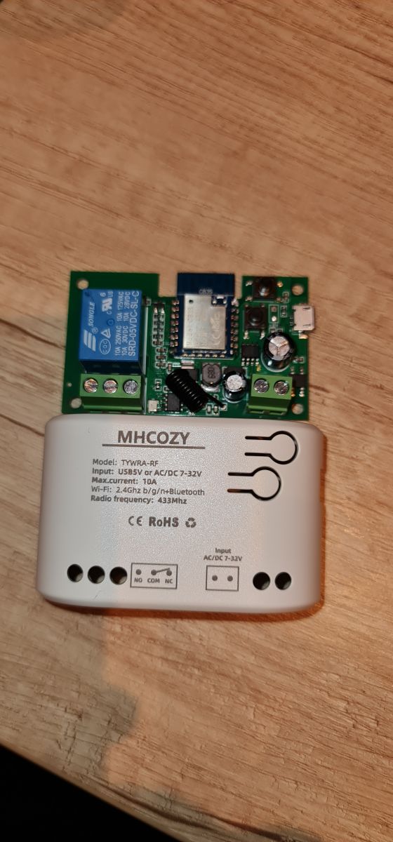

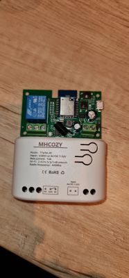

  • Hello everyone,
    First of all thanks to the community.
    I flashed a relay module (dry contact) that uses a CB3S chip
    Brand : Mhcozy
    Model : TYWRA-RF
    I just wanted to share with you the config, in order to save time
    Here is the config:
    [BK7231N/CB3S] Mhcozy TYWRA-RF Relay Module (Dry Contact) Configuration & Setup Guide
    hope this helps someone
    Greeting

    Hi, I have the instructions manual. But xinetic mentioned that the RF transmitter cannot be learned after flash, so far I relay not flash because I want to keep the RF function. I will try to pick up the Tuya config and will see.
    Hi, i made dump, the result is similar to that from wassimsarghini.
    Identifikation of ICs:
    MB10F rectifier
    XL1509  DC BUCK step-down
    RFE2740  ???
    ?? one without label
    Module: CB3S
    JSON+text:

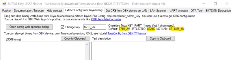

    I have the same smart switch. Can you tell me how you flashed it? Did you connect an uart/usb device, and if so, how did you wire it?
  • CB3S pinout and Tuya config mapping
    #9 21324150
    fitor
    Posts: 11
    Hi, standard conection via UART, module CB3S:
    PIN1 - CEN
    PIN8 - Vcc
    PIN9 - GND
    PIN15 - RX
    PIN16 - TX

  • No AP after flashing CB3S firmware
    #12 21325559
    GastonL
    Level 4  
    Posts: 7
    Your suggestion did help me, but it works differently for me. Steps I did:
    1. wire TX, RX and GND
    2. connect USB/UART to computer
    3. start (windows) BK7231 UART flasher
    4. connect switch to USB for power
    5. shortly wire GND to pin 1 (RST)
    6. disconnect GND
    The results are as below
    note to me: don't swap TX and RX, because that leads to frying a SMD
    Unfortunately, I don't see it come up as an AP neither can I find it on my network when I add wifi credentials. Any flag box I should tick?

    After flash, choose Read only OBK config, then Change OBK settings and here put wifi SSID and password, then Write only OBK config. For wifi is not necesary to tick any flags.
  • #14 21325907
    GastonL
    Level 4  
    Posts: 7
    That was easy, but I think I fried the AMS 1117 voltage regulator, because the led is on with a fast flicker, there is no WIFI and there is no response from buttons or relay (the AMS started smoking when I had TX-TX and RX-RX connected).
    So that was it I guess, unless I have a AMS somewhere and that's the only defect component.
