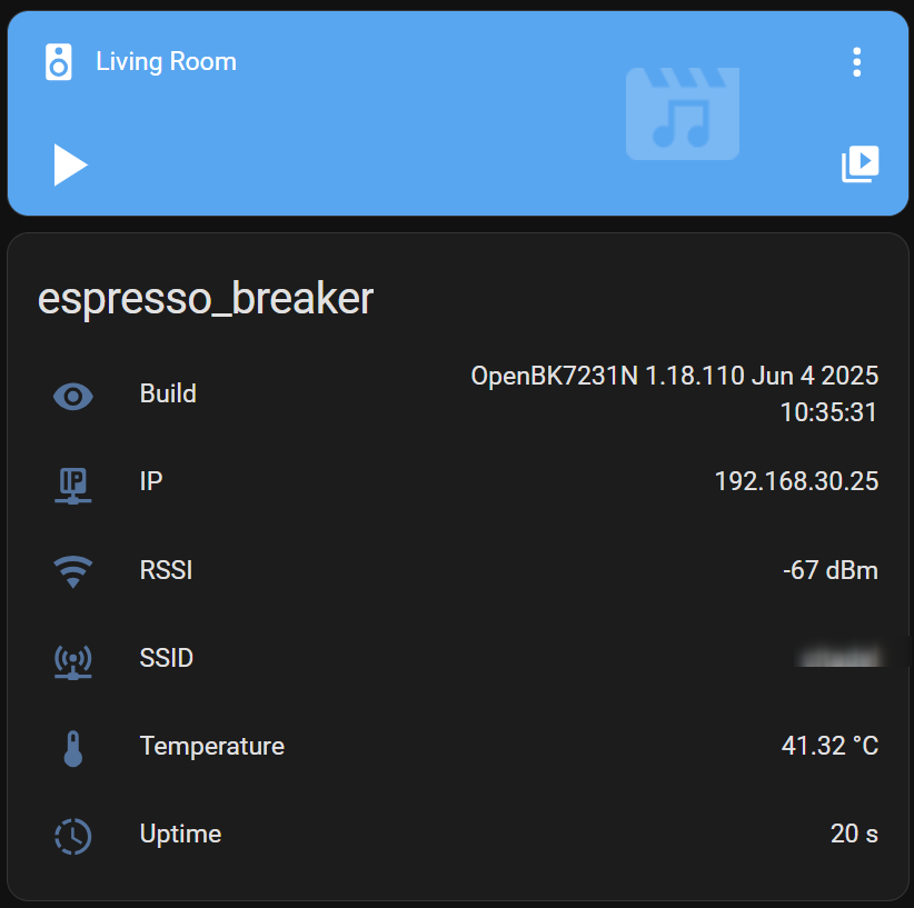

    I need help with Tuya smart circuit breaker flashed with OpenBK. How to MQTT to HomeAssistant consuption,voltage,power and control Toggle function?

    I already have MQTT set. The problem is that it is showing some data, but not the one I'm interested in. I need power consumption, voltage and power, but instead I see this.

    OpenBeken supports automatic Home Assistant Discovery. It should work well once you have already set the channel types.
    Home Assistant Discovery configures Home Assistant to show channel types you have set when you do Discovery. If you add some new channels or remove them, you need to do Home Assistant Discovery again. You may also need to manually remove first device from HA.

    Thank you. It worked.

    I removed and re-added the device. Now it appears in my HomeAssistant under MQTT devices

    Btw, Some people just use:
    scheduleHADiscovery 10
    in the startup command to automatically do HA discovery with 10 seconds when MQTT connects.
