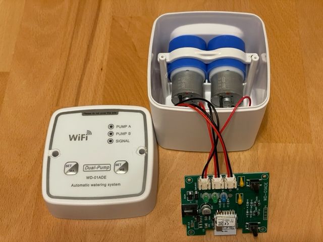

    >WIFI Control Plant Drip Irrigation Watering System Kit Garden Automatic Watering Device Pots Double Timed Water Pump

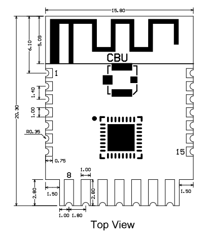

    [BK7231N - CBU] WD-01ADE Tuya water pump with WiFi: Pin Configuration,Btn
    The watering system is controlled by Tuya module CBU (CBU-NL) -> BK7231N
    (Earlier devices are built with ESP8266)

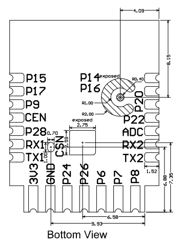

    All needed pin are accessible. You can flash it without dismount the module.
    [BK7231N - CBU] WD-01ADE Tuya water pump with WiFi: Pin Configuration,Btn [BK7231N - CBU] WD-01ADE Tuya water pump with WiFi: Pin Configuration,Btn
    Pin definition for the module as cbu.txt
    The device works with four batteries or with USB-Cable.
    These pins are used:
    P16 - REL1 - pump-A
    P14 - REL2 - pump-B
    P8 - Btn_n 1 - for pump-A
    P7 - Btn_n 2 - for pump-B
    P20 - WifiLED
    I run it with the autoexec.bat attached.

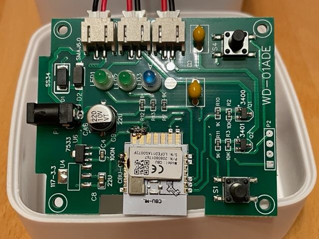

    Some inner pictures:

    The measured power consumption is:
    72mA - quiescent current
    280mA - with one running pump
    490mA - with two running pumps
    It is not a good idea to run it on battery without energy saving rules.
    There is one problem with the configuration: I must press the button twice to start and stop the pumps.
    The device requires a very good power supply.
    To make the function safer, I soldered a backup capacitor between 0 and 3.3V (470uF).

    Hello, are you sure it's Btn_n (button between GPIO and VDD) and not Btn (button between GPIO and GND)?
    You can lower the current usage by using PowerSave 1 command in OpenBeken, put it in short startup command or in autoexec.bat.
    Anyway, thank you for an interesting review. I haven't seen this device yet.

    Yes, I am not absolutely sure about the question Btn / Btn_n.
    For exploration, I set the input to a separate channel.
    Btn_n gave me
    unpressed -> channel=0
    pressed -> channel=1
    That is why I defined Btn_n.
    Andreas
