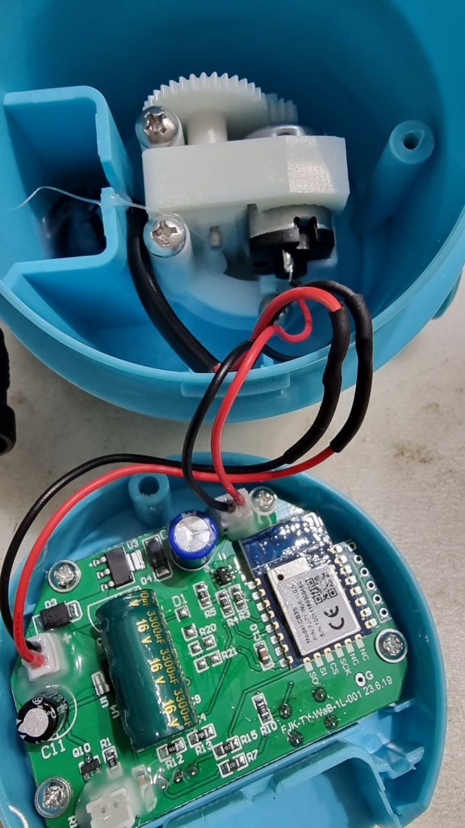

    There is no Tuya JSON data in the attached binary file. It seems that you need to investigate the PCB to find out the GPIO roles. Have you tried using GPIO doctor?
  • #3 20892295
    andrewmarkcongdon
    Posts: 22
    Yes, I need to investigate further, thanks.
    Unlike a couple of other outdoor things I was looking at today, this one wasn't potted, so I can make some progress later.
  • #4 20892300
    Posts: 14781
    Rate: 12920
    This may require some script to turn off relay after 2 or 3 seconds but it's easily doable with OBK
  • #5 20987824
    andrewmarkcongdon
    Posts: 22
    P9 Button
    P14 Motor Open Valve
    P24 LED
    P26 Motor Close Valve
    Yes 2 - 3 seconds for the motor to complete its cycle sounds about right.

    #11 21000601
    andrewmarkcongdon
    Posts: 22
    I changed the pin definitions slightly:
      "pins": {
        "9": "Btn;3",
        "14": "Rel;0",
        "24": "LED;2",
        "26": "Rel;1"
    So I could toggle the LED state to reflect the valve state.
    Similarly the button could be scripted to toggle valve state.
    // Channel 0 - Water Off
    // Channel 1 - Water On
    // Channel 2 - LED
    alias turn_off_led backlog setChannel 2 0
    alias turn_on_led backlog setChannel 2 1
    // This will automatically turn off relays after about 2 seconds
    // NOTE: addRepeatingEvent [RepeatTime] [RepeatCount]
    alias stop_flow backlog turn_off_led; addRepeatingEvent 2 1 setChannel 0 0
    alias start_flow backlog turn_on_led; addRepeatingEvent 2 1 setChannel 1 0
    addChangeHandler Channel0 != 0 stop_flow
    addChangeHandler Channel1 != 0 start_flow
    I can change the state of channel 1 and 0 using mqtt so remote script control works too.
    I also added PowerSave in startup.

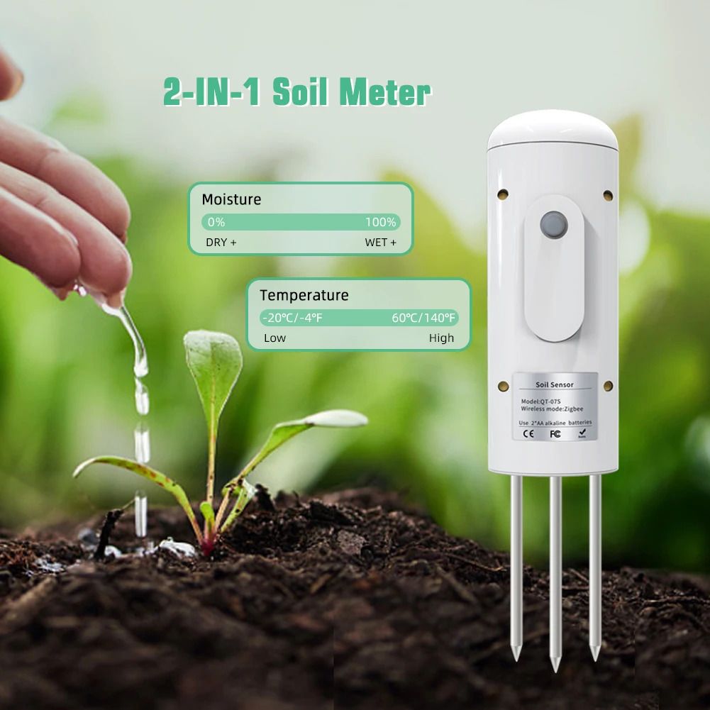

    Couldn't find a suitable OpenBeken compatible moisture sensor so went with this
    2-in-1 soil sensor next to a plant, measuring moisture and temperature.
    and a ZBDongle-E. Works OK, posts results to MQTT allowing simple closed loop scripting, but the battery life looks like only a week.
