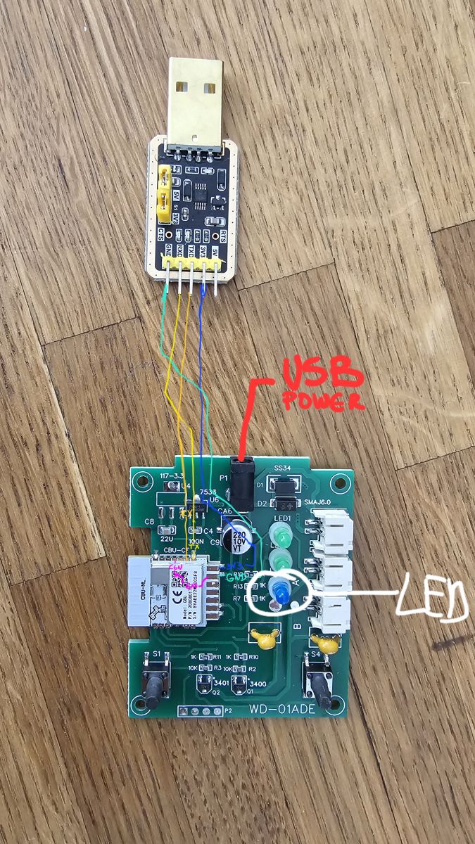

    1. So I am using CH340, connected RX, TX, 3v3, and GND.
    2. That blue diode stays solid for a second then goes blinking.
    3. I start the BK7231 GUI Simple Flasher.
    4. Choose the correct COM port, click on the flash firmware.
    5. I am asked to shorten GND and CEN.
    6. I shorten GND and CEN, and the blue diode goes off, goes solid on for a second, and then starts flashing again.
    7. The flasher still continues with prompting me to shorten CEN and GND.
    What am I doing wrong?
    I guess what happens with the diode means that I am succeeding in reboot?
    I also tried reversing TX and RX but no luck.
    Should I have the 3.3 external power supply also connected?

    Can you post a photo of the setup?
    drkbg wrote:
    5.I am asked to shorten GND and CEN
    It is better to do a power cycle then, disconnect and reconnect power ( reliable 3.3V), I do not even solder CEN

    The image shows a circuit board connected to a USB adapter using colored wires.
    My setup looks like this.

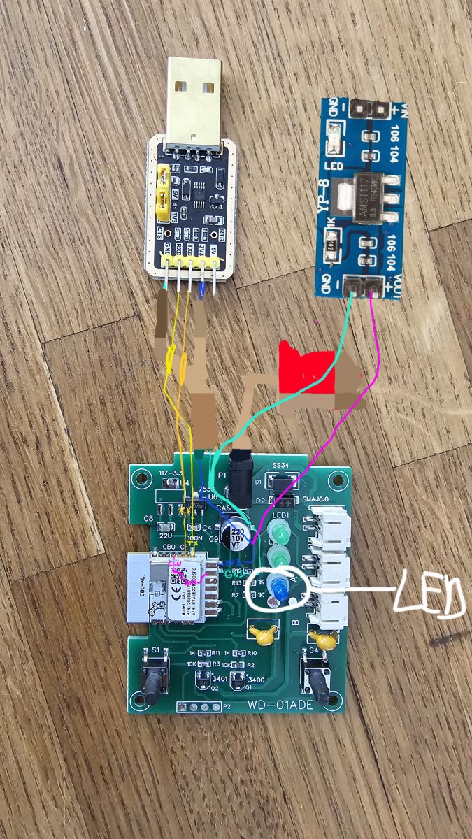

    So if I understand you correctly:
    1. I should not use the USB power connection during flashing.
    2. I should use something like AMS1117-3.3V to connect to the 3v3 and GND.
    At the end, it should look like this:
    Electronic connection setup using USB module, AMS1117, and PCB.
    USB power flashing with 3.3V UART levels

    If this device has USB power, then the simplest way would be to:
    - connect GND, RX and TX from USB to UART converter
    - on USB to UART converter, connect VDD and 3.3V to select voltage levels 3.3V (at least on my USB to UART converter I need to do this, consult your own converter manual for more info)
    - connect power from USB as well
    - then, in flash tool, start flash, it will be doing "{getting bus" and waiting, while it waits, disconnect and connect power to the board, it should proceed with flashing
    The AMS1117-3.3V method is very universal, but if your board already has AMS1117-3.3V on board or any other 3.3V source, then you can just use that. Of course, it assumes that your board is not mains powered, because if it's mains powered and it has non-isolated power supply then you must never use this power supply while flashing, non-isolated power supplies ARE VERY DANGEROUS, you could fry your USB port

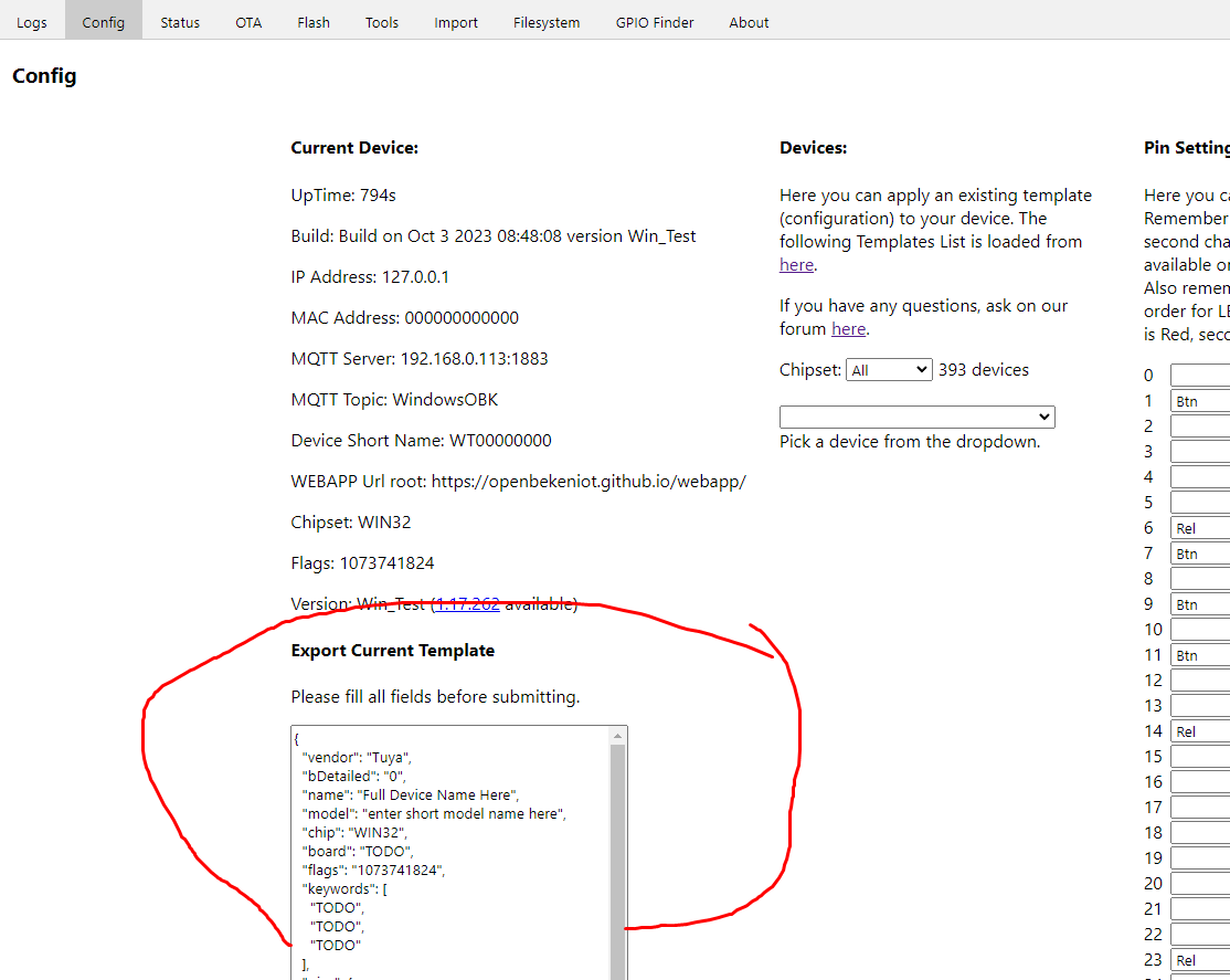

    Hey, can you also post YAML from Web App, so I can add this device to our teardowns list? Thanks!
  • #9 20756133
    drkbg
    Level 4  
    Posts: 9
    Do you mean the template on the Config page of WebApp?
  • #10 20756421
    Posts: 14795
    Rate: 12945
    Yes, that's what we use for devices list:
    Screenshot of a device configuration panel interface with a template export section.

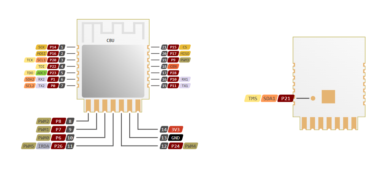

    nifegovi
    Thank you guys!
    It worked for me using
    get flashtool: https://github.com/openshwprojects/BK7231GUIFlashTool
    the trick was to use TX1 and RX1 on the right, not the programming pads on the board :m
    CBU module pinout diagram with TX1 and RX1 pins highlighted
    I have this board. on the back is said : e469716 which was a bit misleading.

  • Start the BK7231 GUI flasher and begin flashing; it will wait for the device.
  • While it waits, disconnect and reconnect power to the board to enter bootloader. This method removes the need to use CEN during flashing. [Elektroda, p.kaczmarek2, post #20752646]
Should I power the board from the CH340’s 3.3V pin?
No. Many CH340 dongles cannot supply enough current for a reliable flash. Use a separate 3.3V LDO regulator. “I never power device directly from 3.3V of CH340.” This improves stability and avoids brownouts during boot. [Elektroda, p.kaczmarek2, post #20752556]
Can I power the pump through its USB port while flashing?
Yes, if it’s a low‑voltage, isolated supply on the board. Connect only RX, TX, and GND from the UART and select 3.3V logic. Do not use a non‑isolated mains supply while flashing; it can damage the USB port. [Elektroda, p.kaczmarek2, post #20752646]
The flasher keeps asking me to short CEN to GND. How do I fix it?
Enter bootloader by power‑cycling instead. Start the flash, then disconnect and reconnect power. Ensure a reliable 3.3V source. You usually don’t need to wire CEN. “It is better to do a power cycle then.” [Elektroda, p.kaczmarek2, post #20751942]
Which UART pads should I use on this WD-01ADE board?
Use the TX1 and RX1 pads on the right side of the board. Some units won’t flash from the labeled programming pads. That pad choice was the key to a successful flash. [Elektroda, nifegovi, post #21625119]

Why does “Extract Config from Tuya Binary” show no meaningful pins?
This device uses a custom, hardcoded behavior. The Tuya JSON lacks pin definitions, so the extractor can’t generate GPIO config. Configure pins manually in the WebApp. [Elektroda, p.kaczmarek2, post #20757008]
Do I need to cross RX and TX when wiring the CH340?
Yes. Connect CH340 TX to module RX, and CH340 RX to module TX. Also wire common GND. This cross‑connection is required for UART communication. [Elektroda, drkbg, post #20755310]
What LED behavior should I expect while resetting into flash mode?
Users report a blue LED that goes off, then solid for a second, then blinks. This indicates resets and boot attempts during the process. Continue until the flasher connects and starts. [Elektroda, drkbg, post #20751807]
Can I flash without soldering the CEN pin?
Yes. Use the power‑cycle method instead of pulling CEN low. “I do not even solder CEN.” Start the flash, then cycle power to enter the bootloader. [Elektroda, p.kaczmarek2, post #20751942]
What logic level should my USB‑to‑UART converter use?
Use 3.3V logic. On some adapters, link VDD to the 3.3V pin to select the correct level. Then connect RX, TX, and GND only. This prevents level‑mismatch issues during flashing. [Elektroda, p.kaczmarek2, post #20752646]
