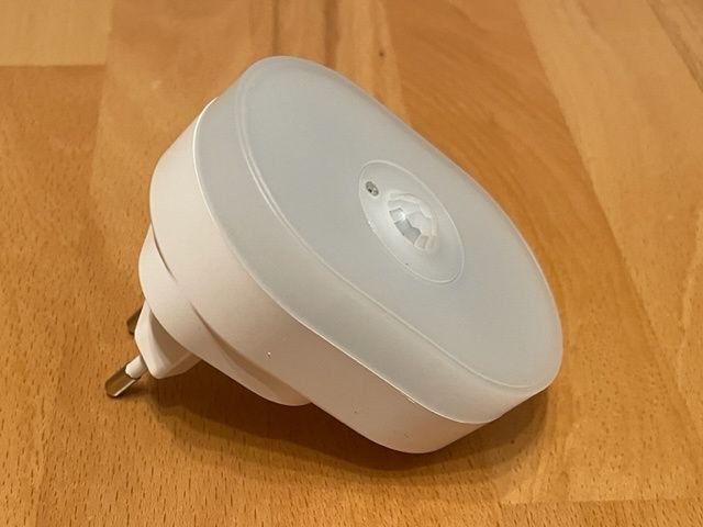

  • Tuya night light with WIFI
    [BK7231N - CBU] Tuya Night Light with WiFi: Pin Configuration, PWM, dInput, ADC, PIR Sensitivity
    Source: https://de.aliexpress.com/item/1005004997029225.html
    The night light is made by Tuya-module CBU.
    All needed pin are accessable. You can flash it without dismount the module

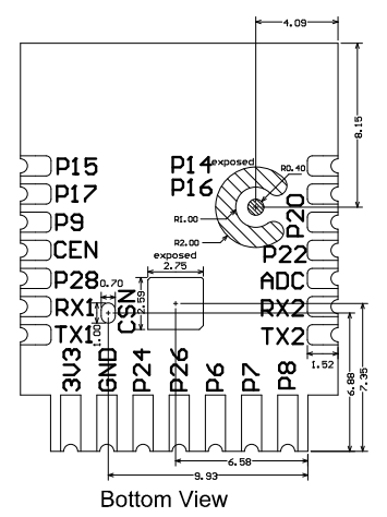

    Pin definition for the module as cbu.txt
    These pins are used:
    P26 - PWM1 - red
    P24 - PWM2 - green
    P6 - PWM3 - blue
    P8 - PWM4 - cool white
    P7 - PWM5 - warmwhite
    P14 - dInput - PIR-signal
    P20 - dInput_n - button
    P23 - ADC - brightness (0 = bright; 4096 = dark)
    P9 - PWM - sensitivity of PIR, 0-max, 255-min

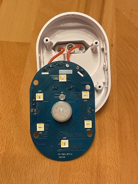

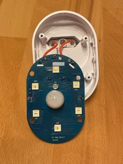

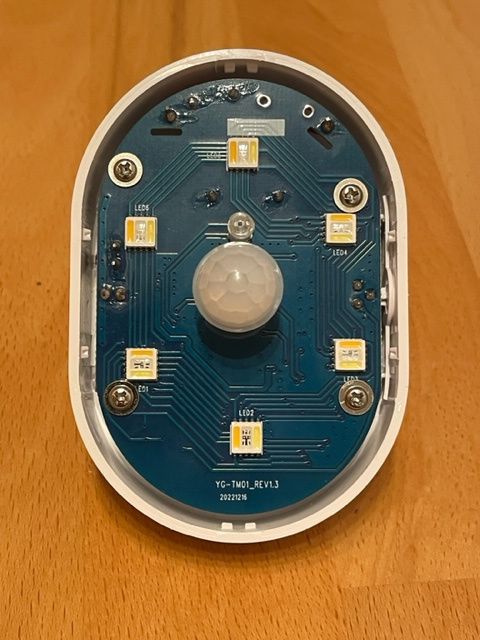

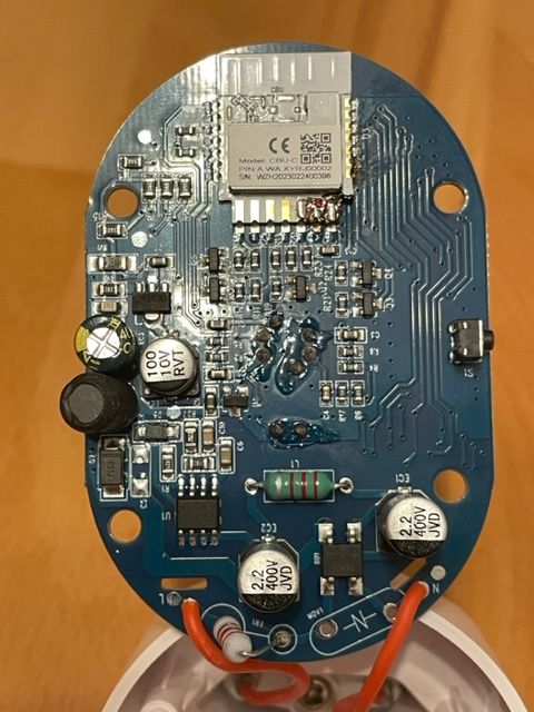

    Some inner pictures:
    [BK7231N - CBU] Tuya Night Light with WiFi: Pin Configuration, PWM, dInput, ADC, PIR Sensitivity [BK7231N - CBU] Tuya Night Light with WiFi: Pin Configuration, PWM, dInput, ADC, PIR Sensitivity [BK7231N - CBU] Tuya Night Light with WiFi: Pin Configuration, PWM, dInput, ADC, PIR Sensitivity
    I use the device as a simple status signal. In my case for the count of open windows in the case of exit the apartment.
    pins explained:
    P26; P24; P6; P8; P7
    standard PWM output for R,G,B,CW,WW
    P20
    buttom at the right side of the device
    negated
    P23
    analog brightness signal
    0 - sun light
    200-400 approx. room light in the evening
    4096 - no lights
    P14
    PIR signal with approx. 5sec switch-off delay
    P9
    output corresponds with pin SENS of the PIR-module BS-612
    there is a small capacitor between signal and ground (no value known).
    0 Volt - highest sensitivity
    3 Volt - low sensitivity
    I do not know if you can output this as PWM or you have to set it as a standard digital output.
    Other signal pin were not found.

    The Pin9 is present in the JSON, it was just not converted to text (not listed on human-readable interpretation)
    	"pirin_pin":"14",
    	"pirsense_pin":"9",
    This is because I haven't seen that kind of JSON before. It's the first time I get TuyaConfig from a such device. This is why your contribution is very helpful and informative. I learned some new things here, thank you!
    You can do some experiments with that PIR PWM control. Set GPIO role to PWM, set some channel for that (one that is not used by other pins) and use SetChannel <index> <value> to set PWM value.
