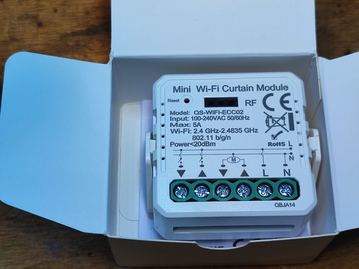

    The whole thing was bought for about PLN60, here's the packaging including the markings - SB527:
    Packaging of QS-WIFI-ECC02 curtain controller module with technical specifications. .
    Marking on the module itself: QS-WIFI-ECC02

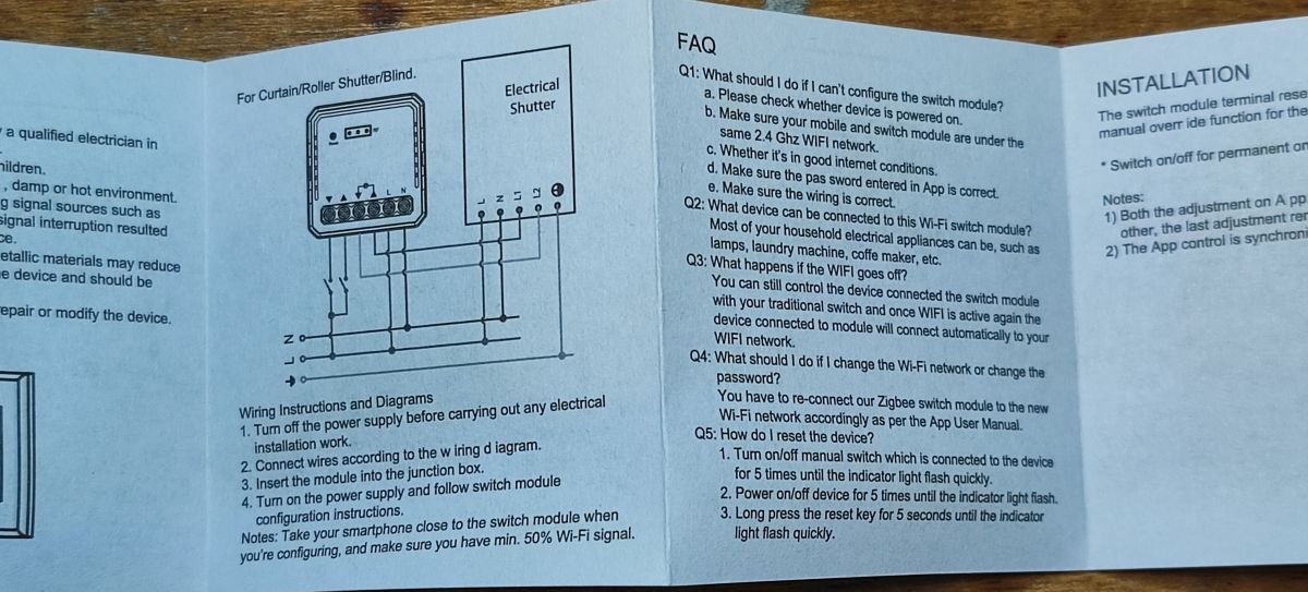

    Instructions:
    User manual for the QS-WIFI-ECC02 Wi-Fi curtain module with technical specifications. Illustration from the installation and user manual for a WiFi module for controlling blinds. .
    QS-WIFI-ECC02 shutter controller installation manual. User manual of the WiFi module with QR code for the Tuya Smart app. .

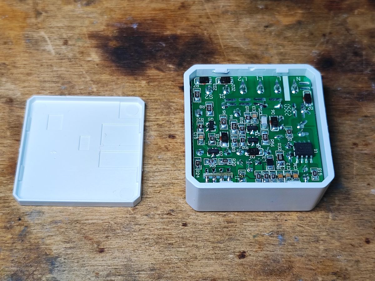

    Tuya tests omitted, let's lift the lid:
    White casing of a shutter controller on a wooden background. .

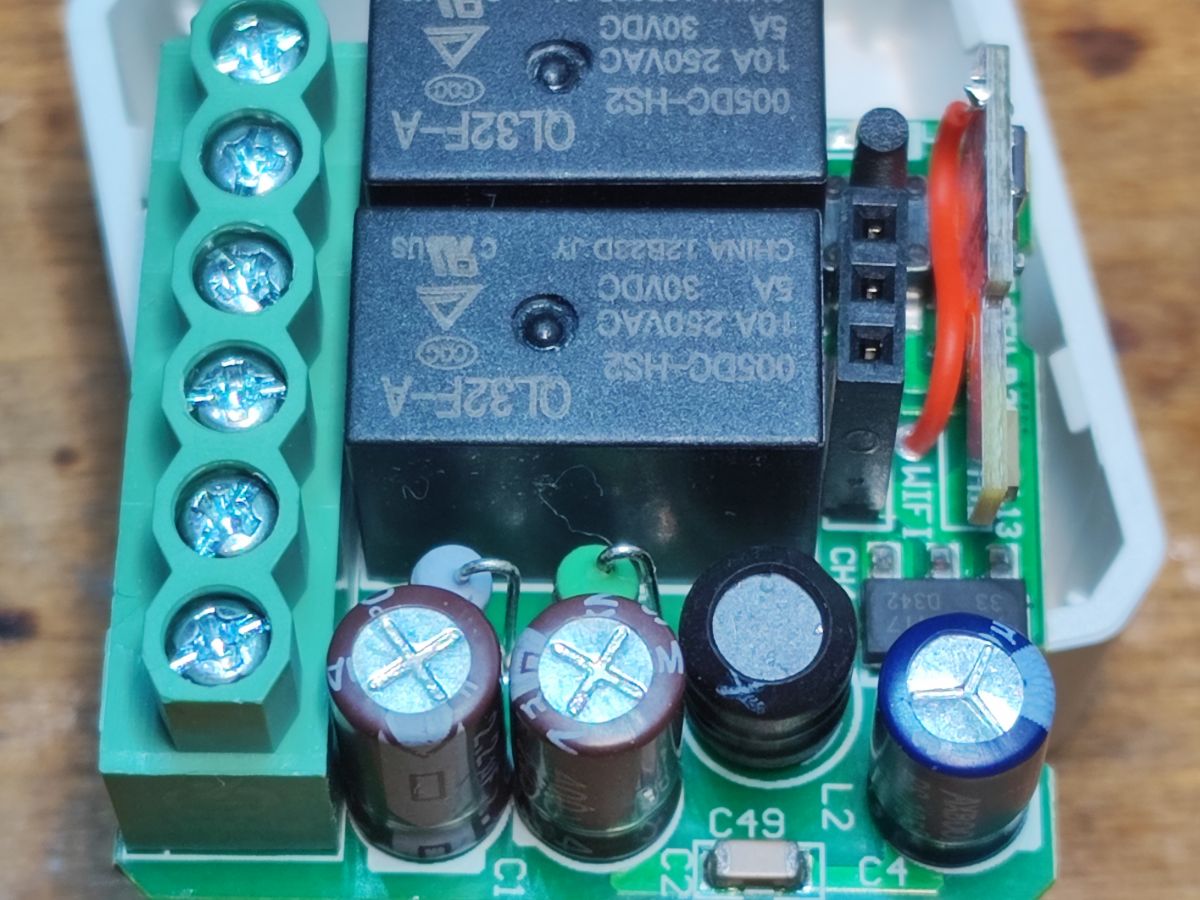

    Interior:
    Interior of a shutter controller with visible PCB. .

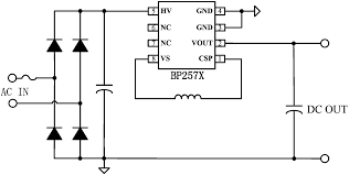

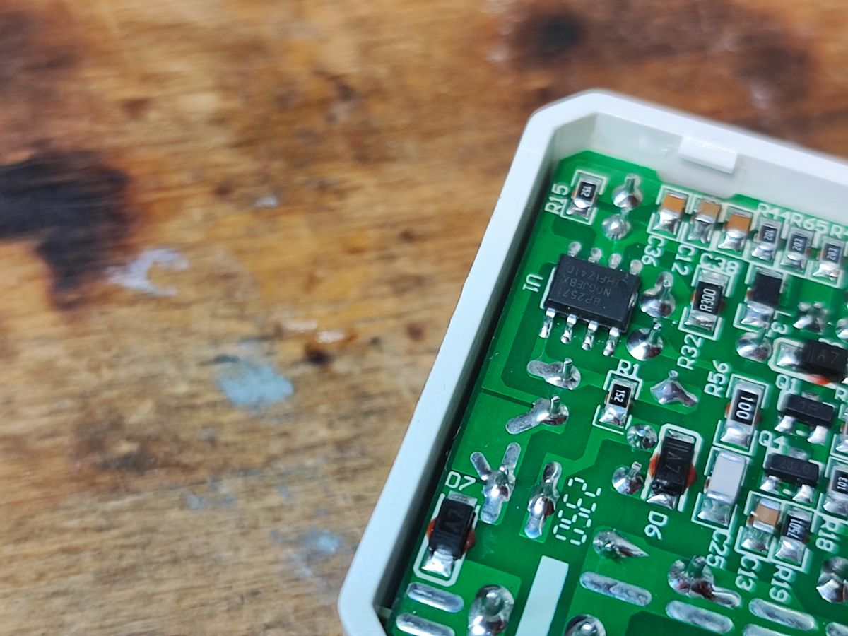

    The power supply is based on the BP2571.
    Close-up of the interior of a shutter controller with visible BP2571 power supply on the PCB. .
    Power supply schematic based on BP257X .

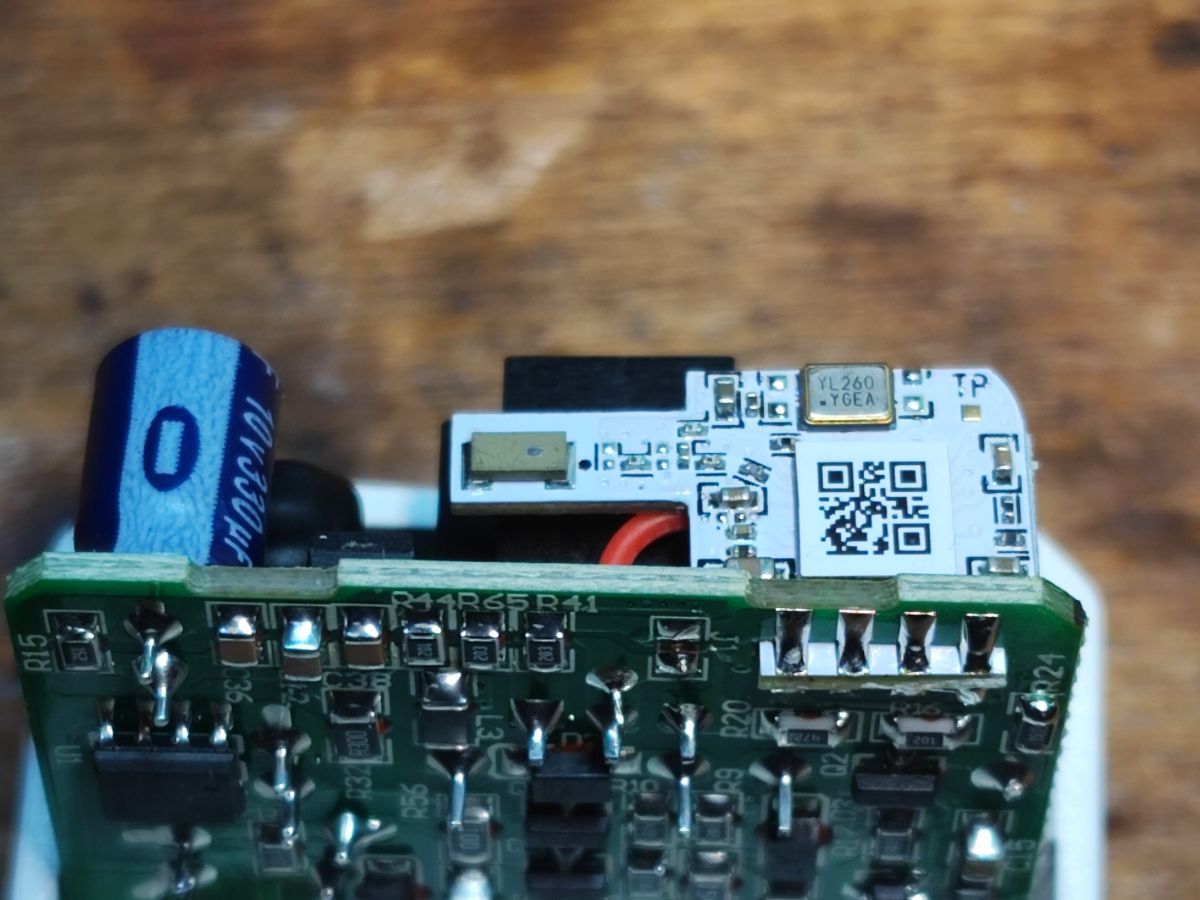

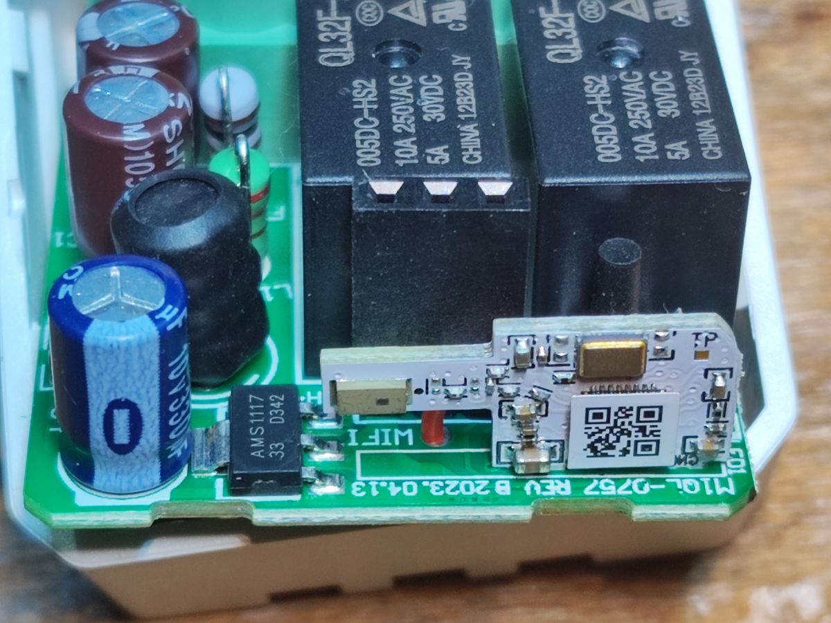

    Here is the WiFi module:
    Interior of QS-WIFI-ECC02 shutter controller with WiFi module and PCB components WiFi module on the PCB inside a shutter controller. .
    For details of this module I refer to RTX WCM1MR .

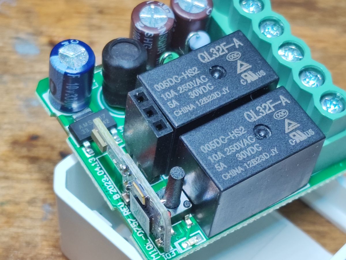

    The rest is also according to the mentioned theme:
    Close-up of CBLC9S WiFi module in a roller shutter controller. Interior of a shutter controller with a WiFi module and electronic components Interior of a roller shade controller with a PCB dated 2023.04.13. .

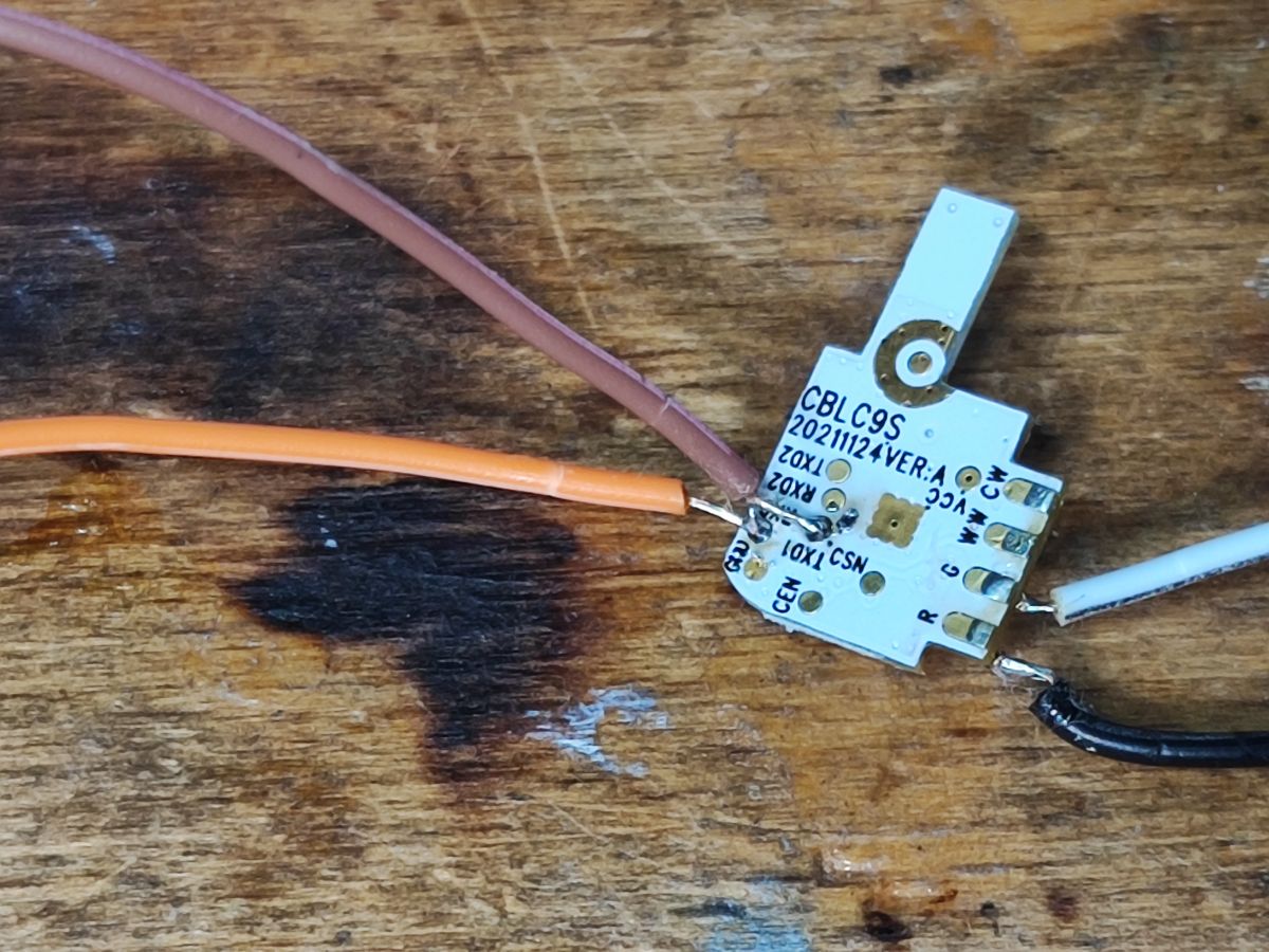

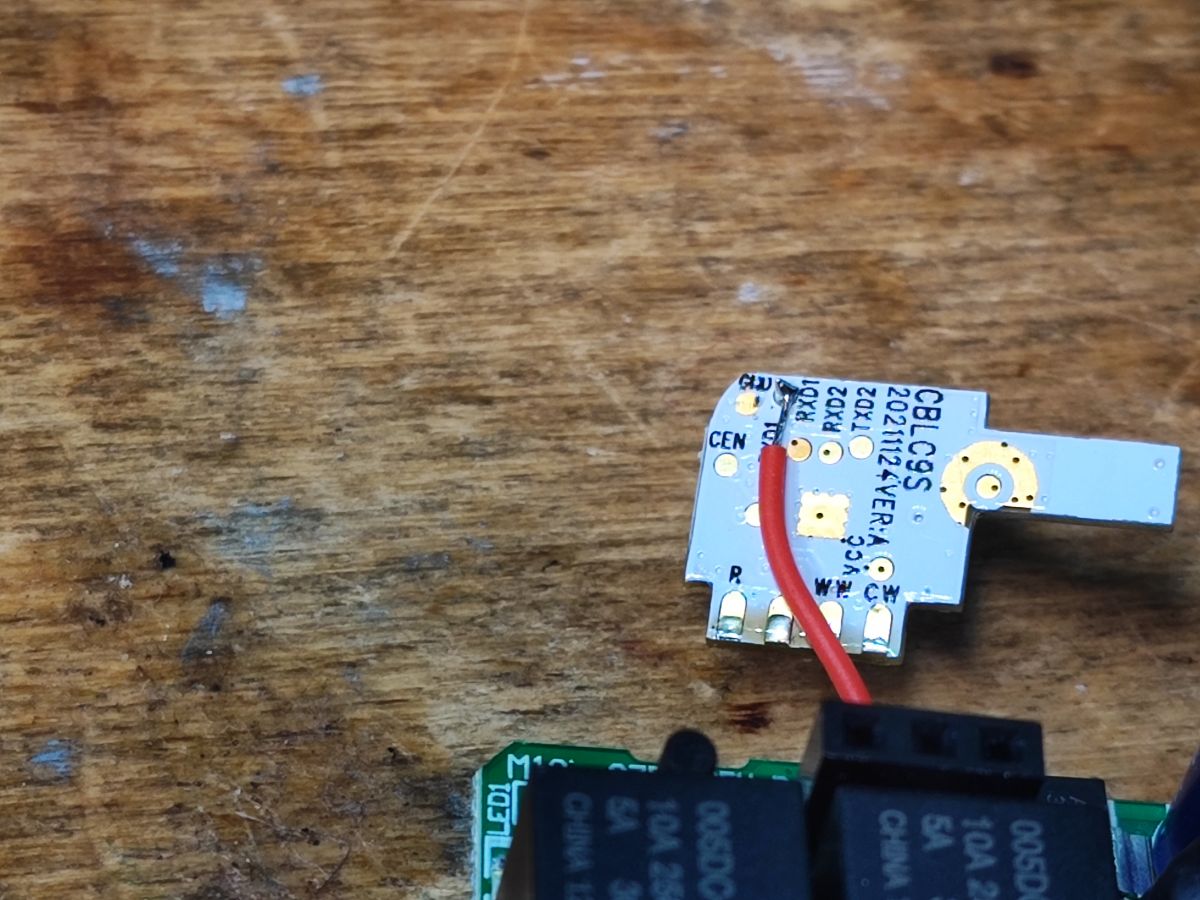

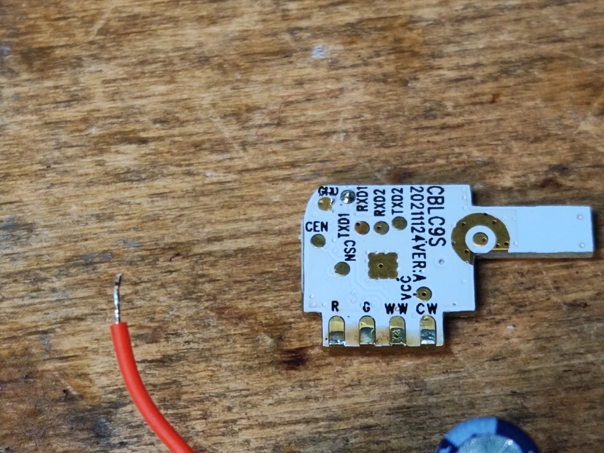

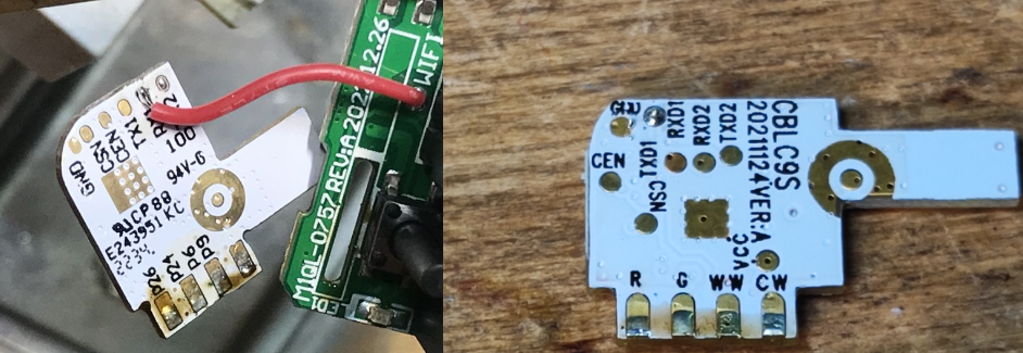

    The only difference I've spotted is a small modification to the WiFi module - there was previously a CBLC9, now there is a CBLC9S:
    CBLC9S WiFi module with roller shutter controller PCB. .

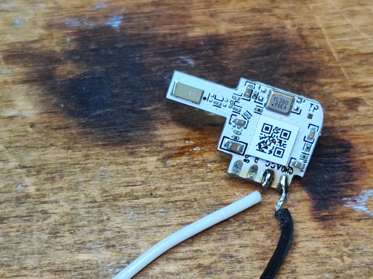

    The WiFI module needs to be soldered, preferably using flux and braid, and then you can use our flasher:
    As with RTX WCM1MR .

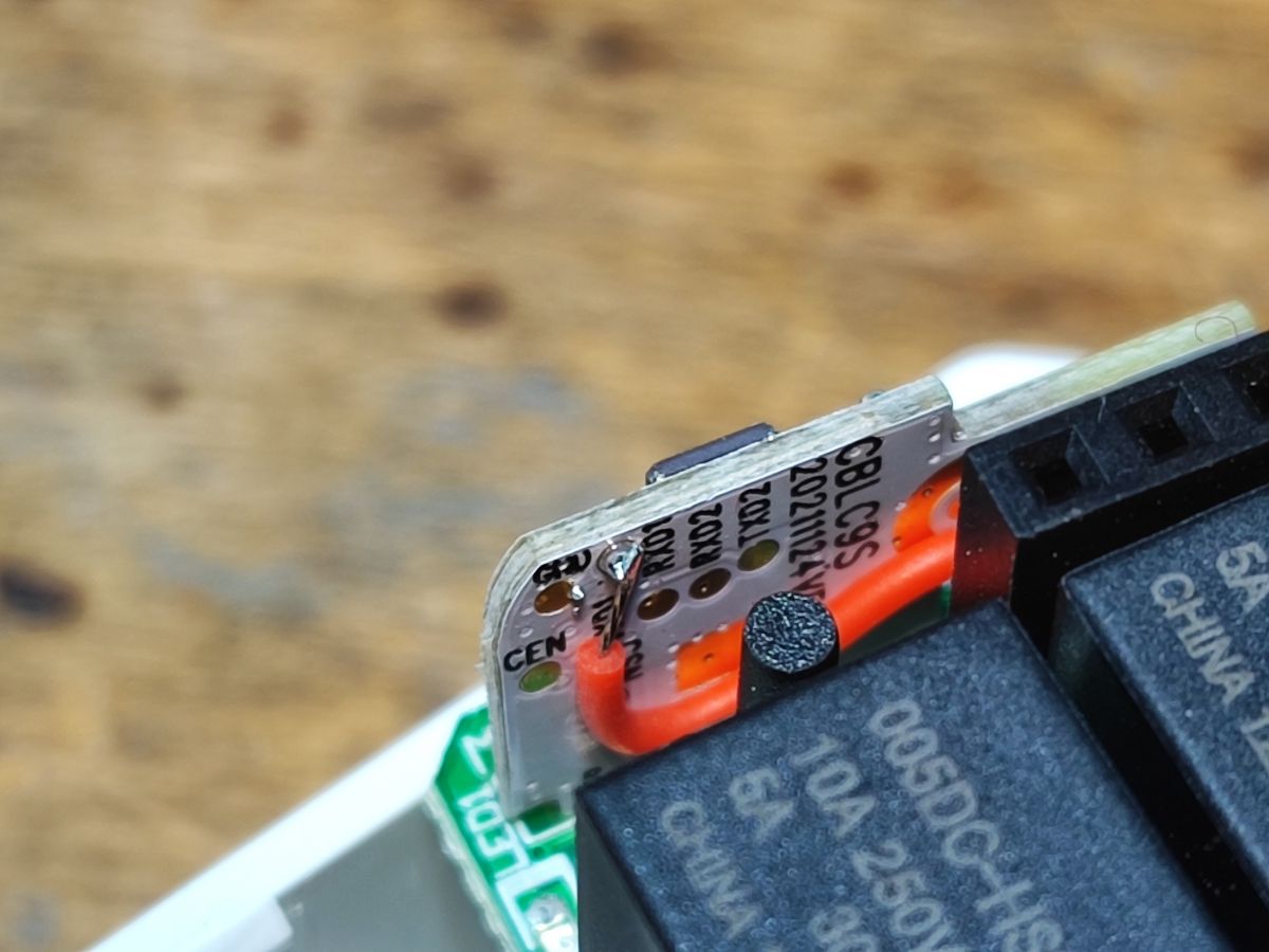

    Photo report:
    bb056a3c9 CBLC9S WiFi module on a wooden surface Close-up of the CBLC9S WiFi module on a wooden surface. The image shows a QS-WIFI-ECC02 electronic module with wires on a wooden background. CBLC9S module on a wooden surface with attached wires. Electronic module on a wooden table next to a prototype board with wires. .

    I also have about 5 of these, fixed price on Ali around 4.5$.
    I have not tested them yet, I understand that the switches should be shorted to the phase as shown in the picture ? this seemed a bit strange to me ....
