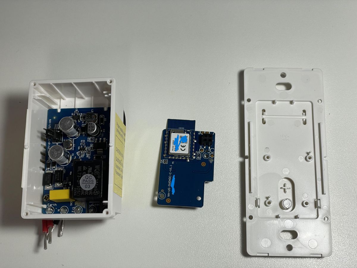

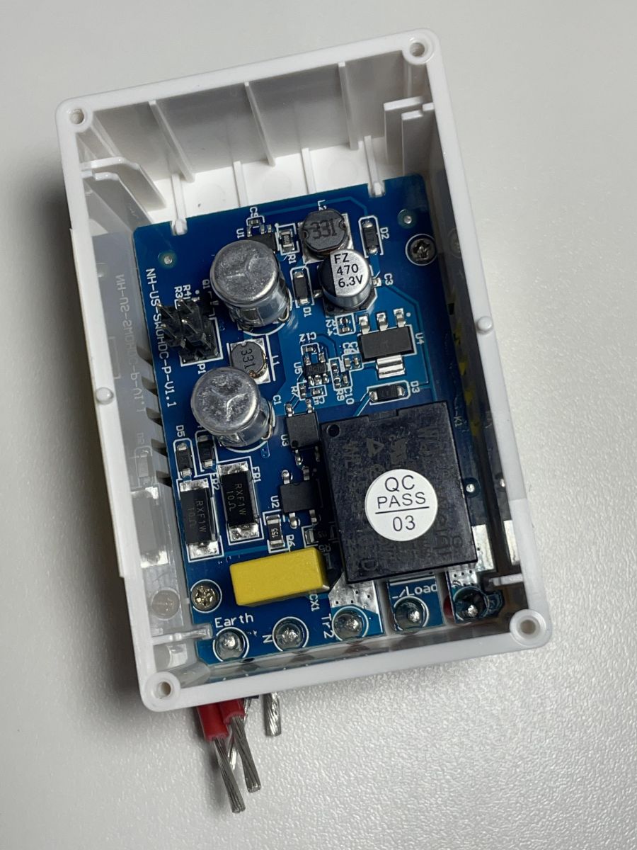

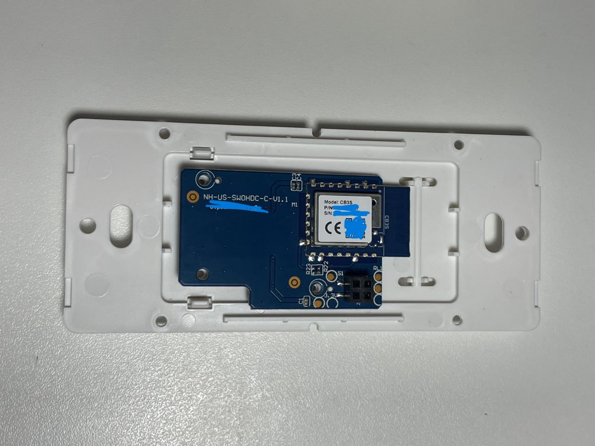

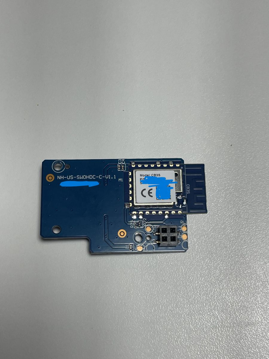

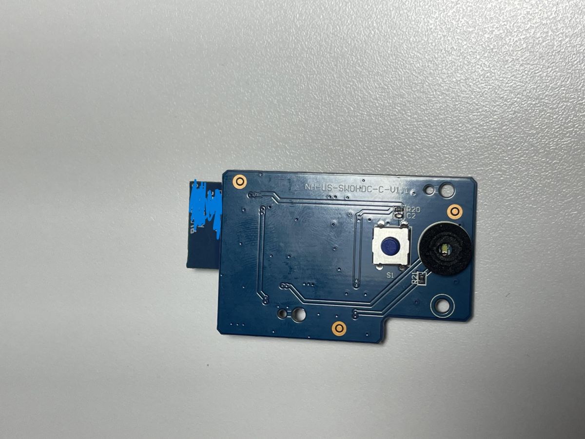

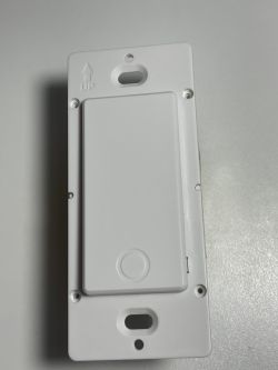

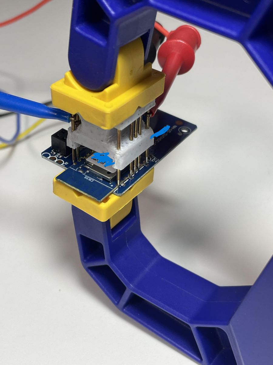

    Teardown and flashing guide for a single-pole / three-way compatible smart switch.
    Moes 3-Way Wifi Light Switch "Star Ring" 2nd Generation
    Amazon Listing: https://www.amazon.com/dp/B0BJ6TZNPG?psc=1&ref=ppx_yo2ov_dt_b_product_details
    Chipset: CB3S (BK7231N)
    [b]Teardown:[/b]
    [BK7231N] Moes 3-Way Wifi Light Switch "Star Ring" 2nd Generation
    [BK7231N] Moes 3-Way Wifi Light Switch "Star Ring" 2nd Generation [BK7231N] Moes 3-Way Wifi Light Switch "Star Ring" 2nd Generation
    [BK7231N] Moes 3-Way Wifi Light Switch "Star Ring" 2nd Generation [BK7231N] Moes 3-Way Wifi Light Switch "Star Ring" 2nd Generation [BK7231N] Moes 3-Way Wifi Light Switch "Star Ring" 2nd Generation

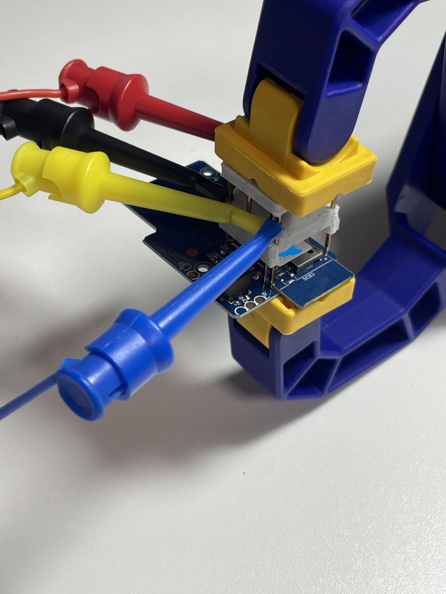

    [b]Flashing:[/b]
    Used a 3d printed pogo pin jig to flash using BK-flasher 1.1.0b

    - Button (channel 1) on P23
    - LED (channel 1) on P7
    - Relay (channel 1) on P9
    Device seems to be using CB3S module, which is using BK7231N.
