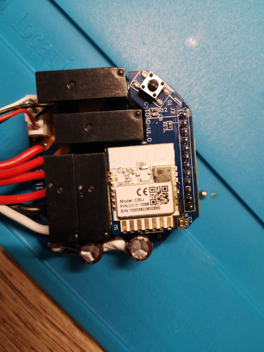

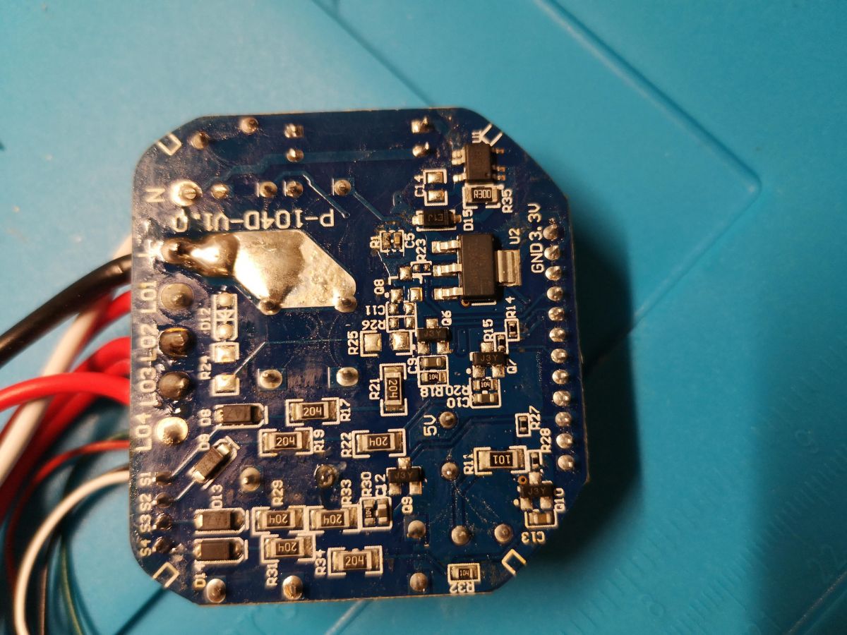

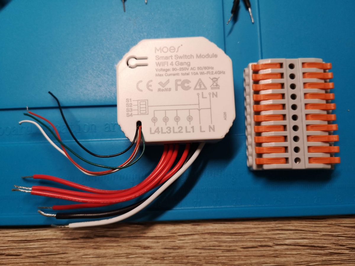

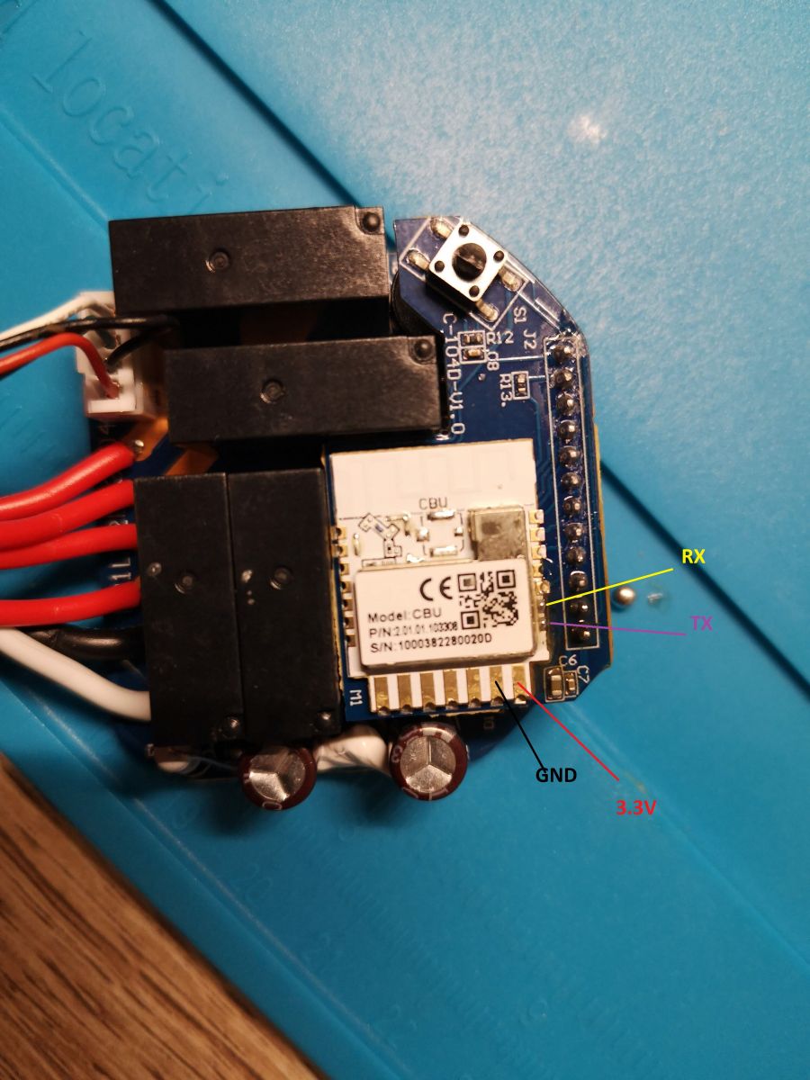

  • MOES WiFi 4 Gang Switch MS-104D uses a Tuya CBU module with a BK7231N chip.
  • It flashes with OpenBK7231T_App through BK7231GUIFlashTool, using the pin layout where S is the input switch and R is the relay output.
  • Flash read always failed, so the "write (no backup)" function was required.
  • The switch works smoothly, but WiFi reception is bad and likely limited by the CBU chip.

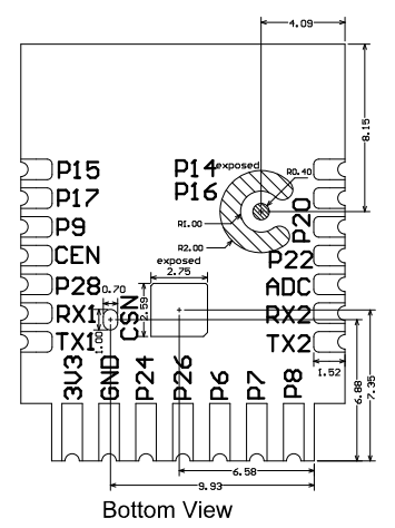

    Chip: Tuya CBU (BK7231N) https://developer.tuya.com/en/docs/iot/cbu-module-datasheet?id=Ka07pykl5dk4u
    Photos:
    [BK7231N / CBU] MOES WiFi 4 Gang Switch MS-104D [BK7231N / CBU] MOES WiFi 4 Gang Switch MS-104D [BK7231N / CBU] MOES WiFi 4 Gang Switch MS-104D [BK7231N / CBU] MOES WiFi 4 Gang Switch MS-104D [BK7231N / CBU] MOES WiFi 4 Gang Switch MS-104D
    Teardown:
    Flash with https://github.com/openshwprojects/OpenBK7231T_App
    [BK7231N / CBU] MOES WiFi 4 Gang Switch MS-104D (WARNING: this view refers to the BOTTOM of the chip!!!)
    I used the new BK7231GUIFlashTool (https://github.com/openshwprojects/BK7231GUIFlashTool) but be aware that I had to use the "write (no backup)" function because flash read always failed (probably because bad connetions with the USB-serial chip or bad USB-serial chip itself). Do that at your own risk.

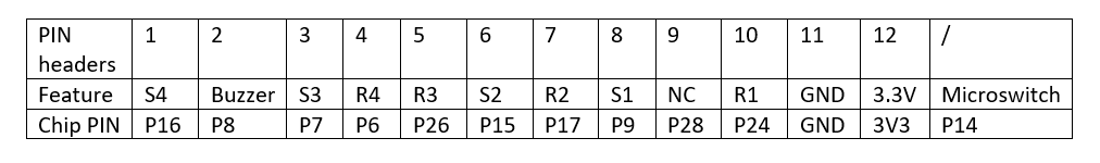

    This is the PIN layout (where S is the input switch and R is the output relay):
    Everything work smoothly except for a bad WIFI reception but I think this is a limitation of the CBU chip itself.
