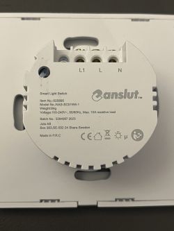

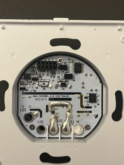

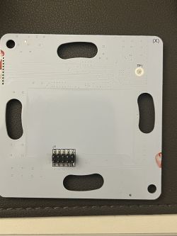

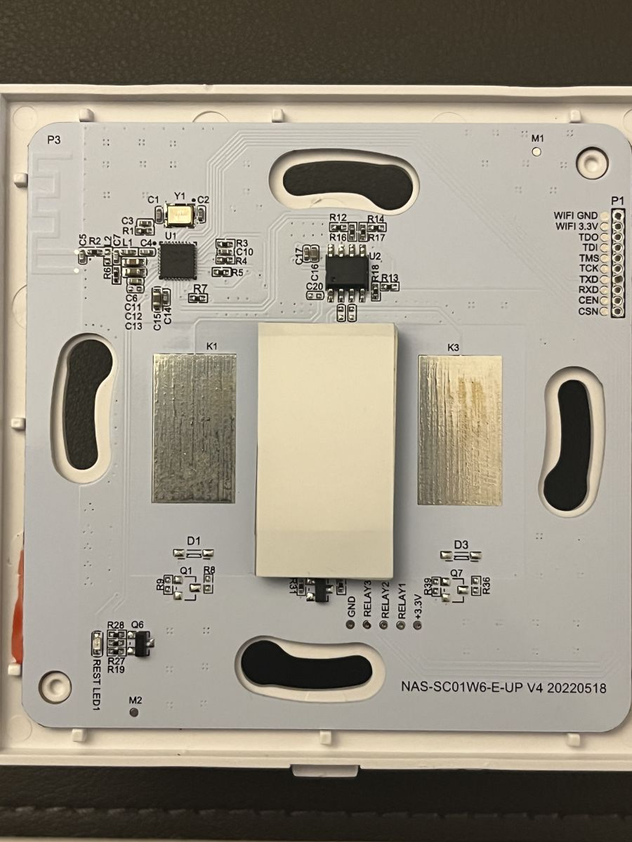

  • BK7231N-based Anslut smart wall switches are covered in 1-, 2-, and 3-button versions from Jula.
  • The teardown highlights neatly labeled pins on the top right, which simplifies identification and flashing.
  • The switches were flashed with openBK version 1.17.398.

  • Confirmed device data: vendor Anslut, model NAS-SC01W6-1, chip BK7231N, and OpenBK version 1.17.398. [#20907115]
  • The posted 2-gang template assigns 7 GPIO roles: relay pins 6 and 8, button pins 14 and 20, LED pins 15 and 22, plus Wi-Fi LED pin 24. [#20907115]
  • The PCB programming pads are described as being on the top right and clearly labeled, which reduces identification errors during flashing. [#20907115]
  • Jula-related identifiers in the template include keyword 025895 and a Jula product link for the wall switch family. [#20907115]

What is the pin mapping for the Anslut NAS-SC01W6-1 smart wall switch 2-gang version?
The posted 2-gang mapping is: GPIO6=Rel;2, GPIO8=Rel;1, GPIO14=Btn;1, GPIO15=LED;2, GPIO20=Btn;2, GPIO22=LED;1, GPIO24=WifiLED_n;0. The model in the JSON is NAS-SC01W6-1, and the chip is BK7231N. [#20907115]
Where are the programming pins located on the Anslut smart wall switch PCB, and how can I identify them?
The programming pins are on the top right of the PCB, and the thread says they are nicely labeled. That means you can identify them visually from the board markings rather than tracing pads manually. [#20907115]

How are the relay, button, LED, and WiFi LED pins assigned on the BK7231N-based Anslut wall switch?
The assignments are explicit in the JSON. Relays use GPIO6 and GPIO8; buttons use GPIO14 and GPIO20; LEDs use GPIO15 and GPIO22; and the Wi-Fi LED uses GPIO24 as WifiLED_n;0. [#20907115]
