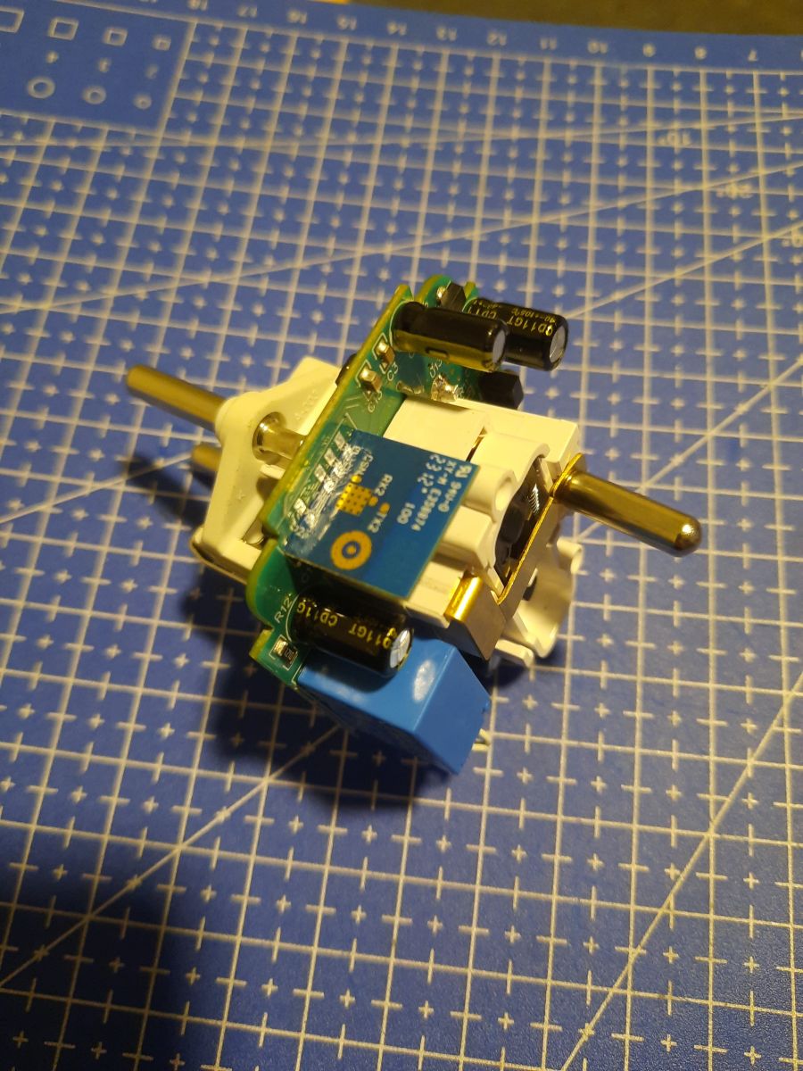

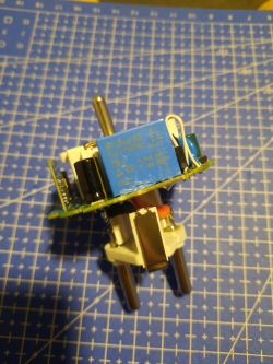

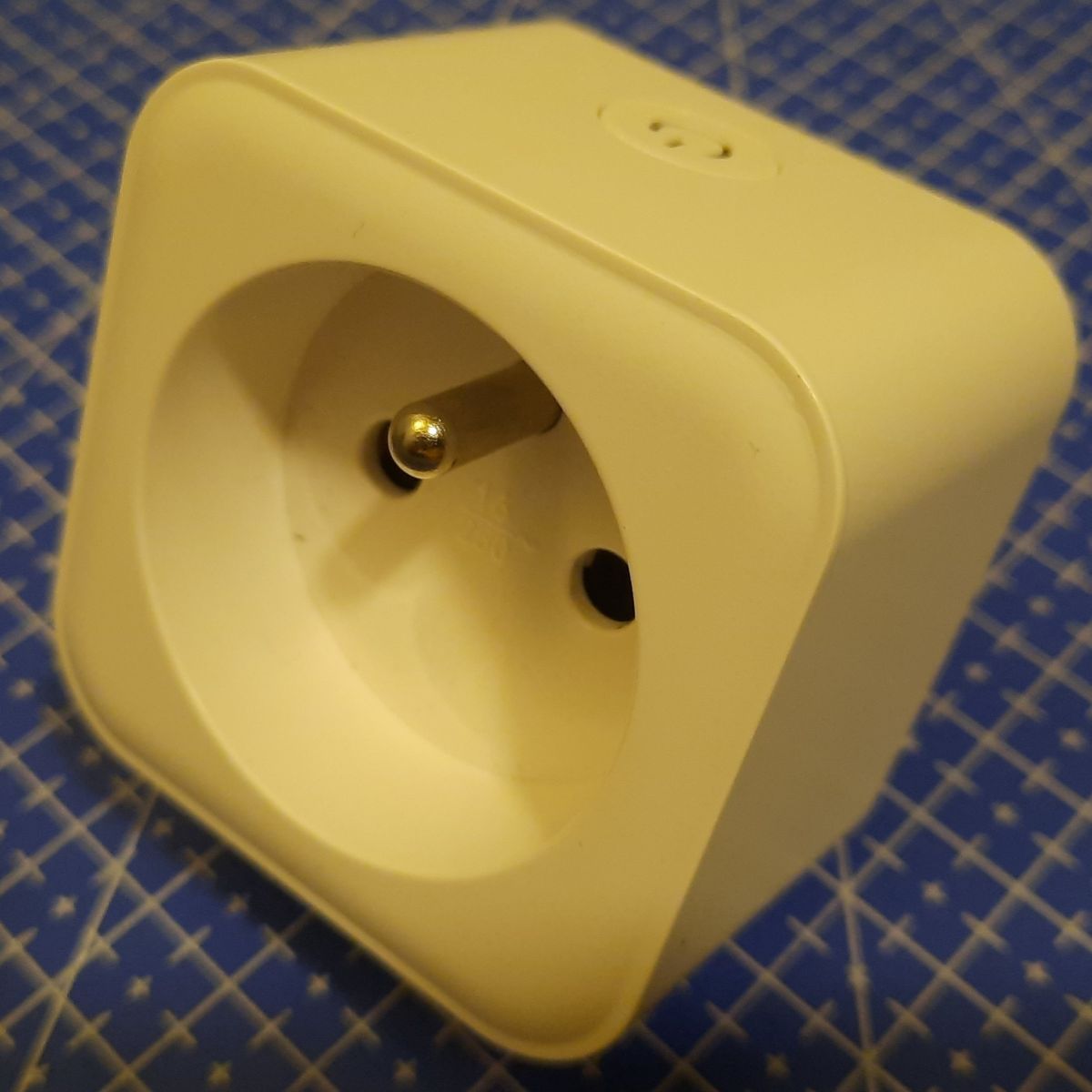

    Recently I bought an inexpensive Tuya-compatible smart plugs: IMMAX NEO LITE 07762L. I got curious about their insides and wanted to get rid of cloud reliance.
    ^^ Teardown of the smart plug with all the tricks I learned while opening three of them ^^
    After opening it as shown in the video, it revealed a BK7231N - CB2S - Bingo

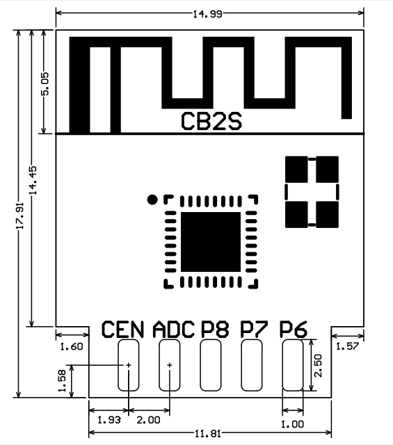

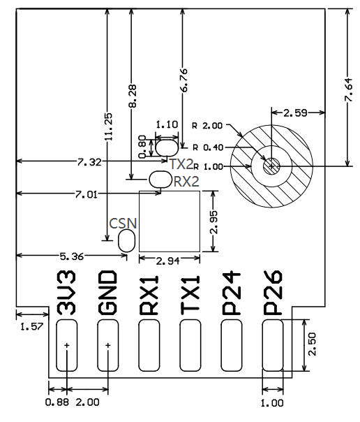

    This variant of the chips has all the pins on one side, and conveniently all the required are in a row next to each other (with the exception of the CEN pin, which is on the other side) Here I borrowed pictures of the chip itself from https://www.elektroda.com/rtvforum/topic3951016.html
    Diagram of BK7231N chip with labeled pins and dimensions. Diagram of the CB2S module with pin labels and dimensions.

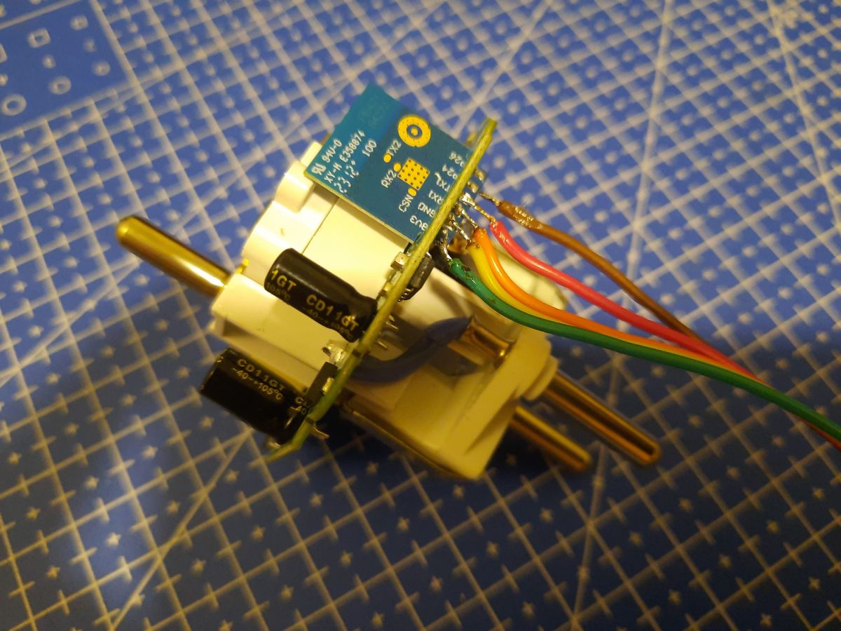

    It was a piece of cake from here. First I soldered some dupont wires on the pins 3,3V; GND; RX1; TX1; CEN, connected it to USB-TTL adapter and was able to flash it like any other BK7231N chip. The only software-related issue I found is that when ltchiptool generated ESPHome YAML from the dumped firmware, the voltage division was 1600 instead of 800. After reflashing it with new firmware, the power measurement was correct.

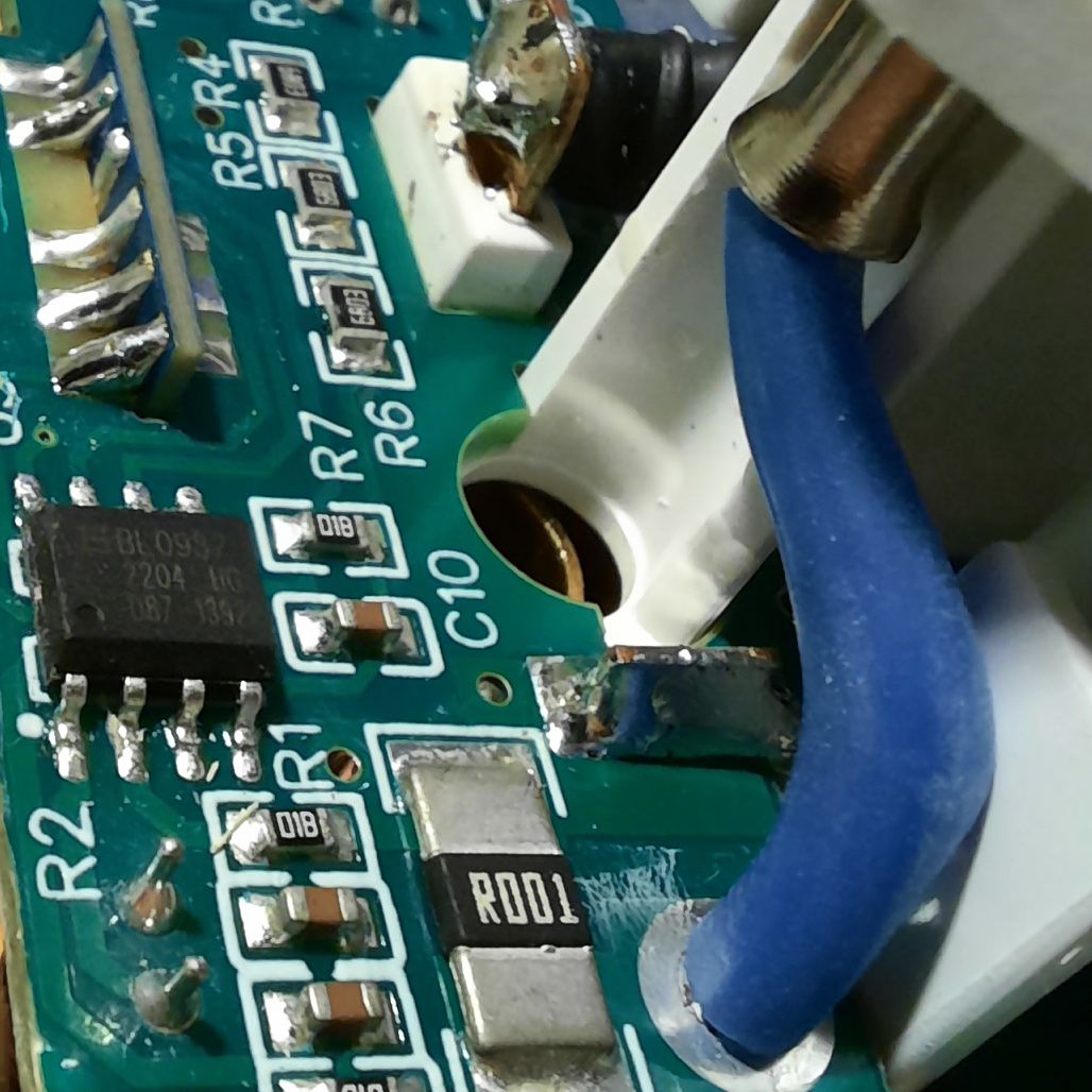

    Other than the Beken, it features a BL0937 IC for energy measurement

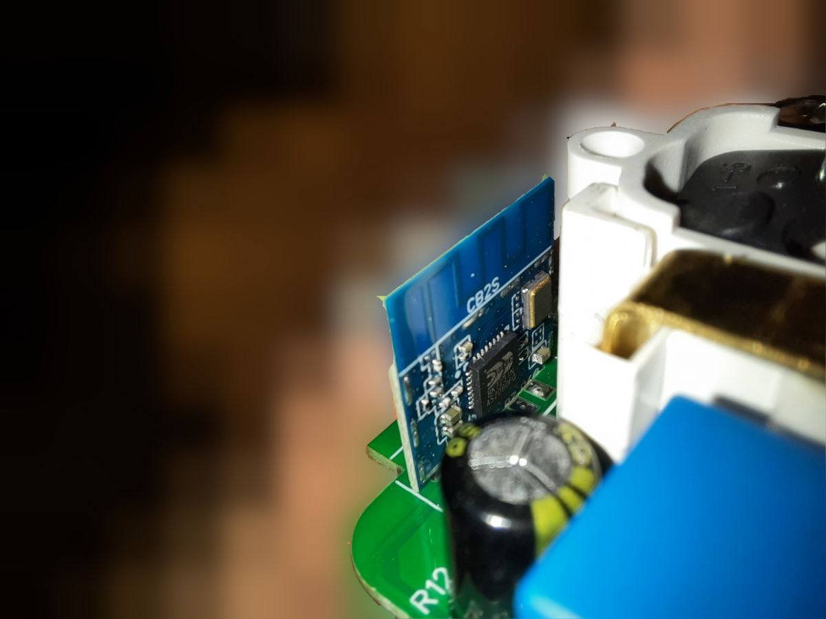

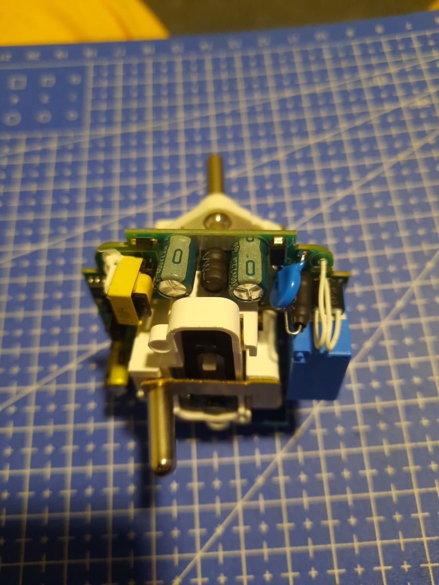

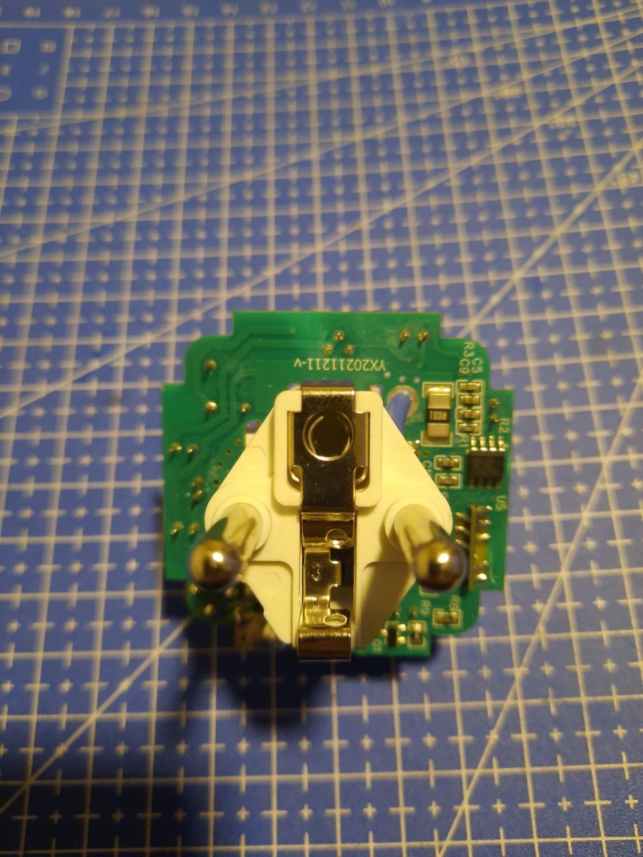

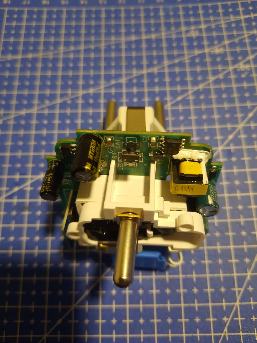

    It seems that there is a new revision of the board. I just wanted to post my experience with it.
    The biggest change we care about is that the module is flipped, so the pins are more difficult to solder now.
    The device also has an unfortunate behaviour that the relay will loose power when you are resetting the module, so a firmware update will cause the power to turn off downstream.
    The module is running Tuya firmware version 1.1.23 - oem_bk7231n_plug, which is not vulnerable to the https://github.com/tuya-cloudcutter/tuya-cloudcutter exploit.
    Teardown and Flashing Guide for IMMAX NEO LITE 07762L with BK7231N ChipPXL_202606...731795.jpg (704.63 kB)You must be logged in to download this attachment.
    Teardown and Flashing Guide for IMMAX NEO LITE 07762L with BK7231N ChipPXL_202606...913999.jpg (596.06 kB)You must be logged in to download this attachment.
    Teardown and Flashing Guide for IMMAX NEO LITE 07762L with BK7231N ChipPXL_202606...251802.jpg (870.87 kB)You must be logged in to download this attachment.
