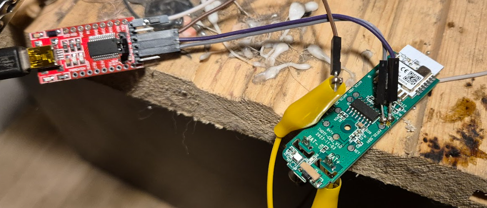

    I am trying to convert this sensor (Green PCB and White CBU module)
    Close-up of two circuit boards connected by wires on a wooden surface.
    I had success doing so with similar sensor that is Blue PCB and White module.
    The same method fails here as I get random errors reading or writing:
    $ ~/.venvs/ltchiptool/bin/python -m ltchiptool flash write -d /dev/ttyUSB0 OpenBK7231N_QIO_1.17.780.bin
    I: Detected file type: Beken QIO Firmware
    I: Connecting to 'Beken 72xx' on /dev/ttyUSB0 @ 115200
    I: |-- Success! Chip info: BK7231N
    I: Writing 'OpenBK7231N_QIO_1.17.780.bin'
    I: |-- Start offset: 0x11000 (auto-detected)
    I: |-- Write length: 1.1 MiB (auto-detected)
    I: |-- Skipped data: 68 KiB (auto-detected)
    [##--------------------------------------------------------------] 3% 00:01:53W: Writing 4k failure @ 0x1c000 (No response received), retrying (attempt 0)
    W: Erasing failure @ 0x1c000 (No response received), retrying (attempt 0)
    W: Erasing failure @ 0x1c000 (No response received), retrying (attempt 1)
    I am quite beginner to this kind of hacking so I am wondering whether there is something else to try out before going ahead desoldering the CBU module which in my case is almost guaranteed kill of the device?
    AI: Could you provide the exact model and version of the TH01 sensor you are trying to flash?
    CBU with AHT20
    AI: What operating system and additional hardware or software are you using in your setup?
    Linux and ltchiptool

    >>21331513 This is a TuyaMCU device, so to flash it you must at first try to connect RX and TX directly to module, and if that didn't work - then you must either remove the module or cut traces.
    I have the same device, and wiring directly to CBU worked for me.

    >>21331600
    I tried to resolder to CBU directly, but no change.
    One note though, I am able to flash the bootloader
    $ ./python -m bk7231tools write_flash -d /dev/ttyUSB0 -s 0 -S 0 -l 0x11000 --bootloader flash/OpenBK7231N_QIO_1.17.780.bin
    <frozen runpy>:128: RuntimeWarning: 'bk7231tools.__main__' found in sys.modules after import of package 'bk7231tools', but prior to execution of 'bk7231tools.__main__'; this may result in unpredictable behaviour
    BK72xx connected - protocol: FULL, chip: BK7231N, bootloader: BK7231N_1_0_1, chip ID: 0x7231c, boot version: None
    Connected! Chip info: BK7231N / Flash ID: eb 60 15 / Flash size: 0x200000 / Protocol: FULL

    $ ./python -m bk7231tools write_flash -d /dev/ttyUSB0 -s 0xF8000 -S 0xF8000 flash/OpenBK7231N_QIO_1.17.780.bin
    Writing 204656 bytes to 0xF8000
    Trying to unprotect flash memory...
    Erasing at 0xF8000 (0.00%)

    Connected RX2/TX2 and watching the boot shows this:
    [23:30:02]SYS:000000df          0040192c	�������j
    [23:30:02][ARM(ANOMALY][2]
    [23:30:02][ARM ANOMALY][2]

    So either I am specifying chunks wrong or this way its not possible to flash.

    Battery-powered devices that have a TuyaMCU chip control the power of the Wi-Fi module (in this case CBU).
    To prolong the activity time of the Wi-Fi module you have to press and hold the pairing button. This will prolong uptime and will probably allow you to flash the wifi module without having to cut tracks or desolder it.

    or solder power directly to CBU too so the TuyaMCU has no control over it?

    #6 21332490
    viktorpot
    Posts: 7
    >>21332041
    Nice one! It helped even though I had to keep pressing the button and letting it go every second in order to see the flash to finish.
    After reboot I can connect to device AP, but it has some problem to keep up, I think it might be in some reboot loop. It stays up for few seconds then disconnects and the pairing button has to be pressed in order to bring it back online. So I have to reconnect every x seconds to configure it.

    >>21332490 That is not a reboot loop, this it the MCU cutting power to wifi module. Connect GND directly to CBU, this should prevent any reboots until you configure the OBK settings.

    Pressing the reset buton helped to flash.
A TH01 sensor with a green PCB and white CBU module could not be flashed with OpenBK7231N firmware using ltchiptool because of random read/write failures and “No response received” errors. The device was identified as a TuyaMCU-based battery-powered unit that controls Wi‑Fi module power, unlike a similar blue PCB version that flashed successfully. Direct RX/TX wiring to the CBU did not solve the issue, but flashing the bootloader separately worked. The successful workaround was to keep pressing the pairing/reset button during flashing to keep the Wi‑Fi module powered long enough to complete the write. After flashing, the device could join the AP, but the module was still being power-cycled by the MCU until GND was connected directly to the CBU to prevent shutdowns during configuration.
