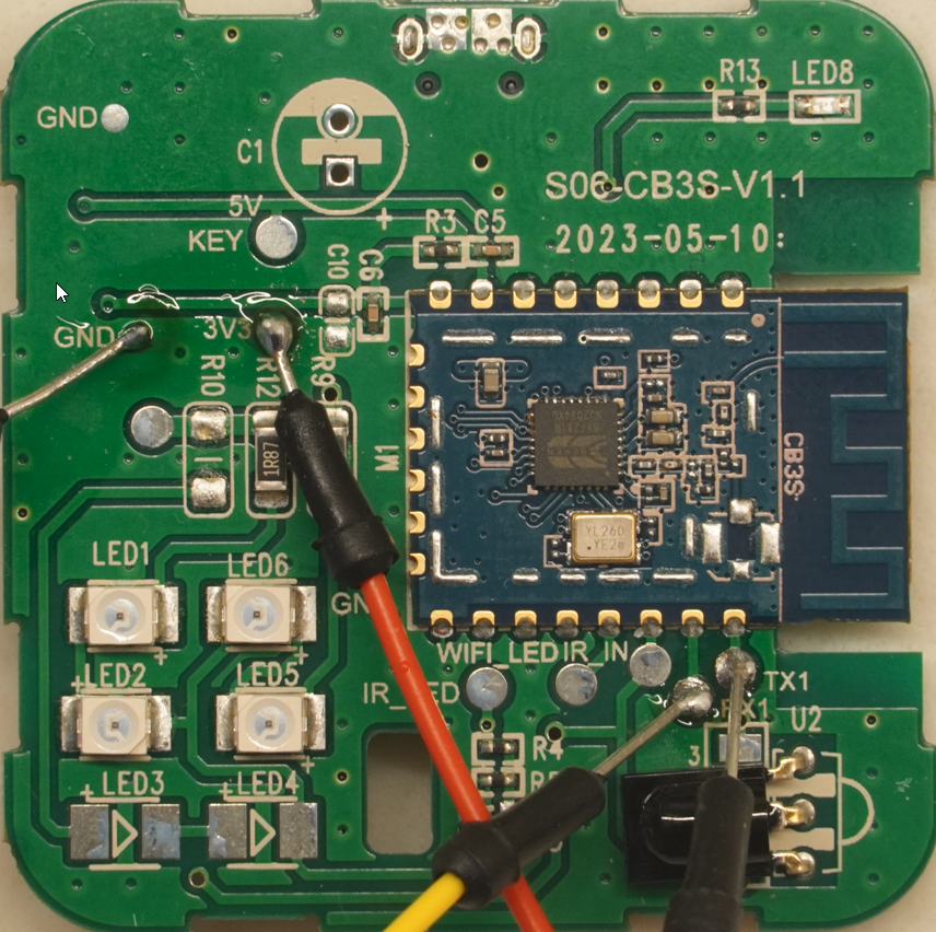

    Hello. I'm new to the scene and trying to flash Beken devices following tutorial videos without success. I tried multiple options with no avail, and would like to get some advice.

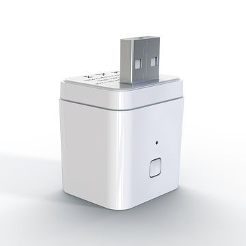

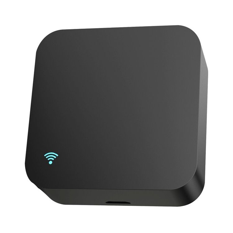

    Chips I'm trying to flash: BK7231N (Tuya USB Smart Adapter) and BK7231T (Tuya S06 IR Remote)
    White Tuya smart USB adapter with a USB plug
    Black smart USB adapter with a WiFi icon in the lower left corner.

    Power supply: Either directly from CH341T UART adapter or independent AMS1117 module set to 3.3v
    I checked all solder joints with multimeter and made sure that the connection is secure and RX/TX of UART adapter is connected to TX/RX of BK7231 chips.
    When GUI Flash Tool asks me to reset the device by either power cycling it or shorting CEN to GND, I do as instructed and I can see that the device is reset by power led turning off and on. However the tool doesn't detect it and keeps displaying 'Getting Bus' indefinitely even though I reset the device multiple times. I tried different baud rates which didn't work. I tried ltchiptool which failed to connect, too. What could be the problem here?

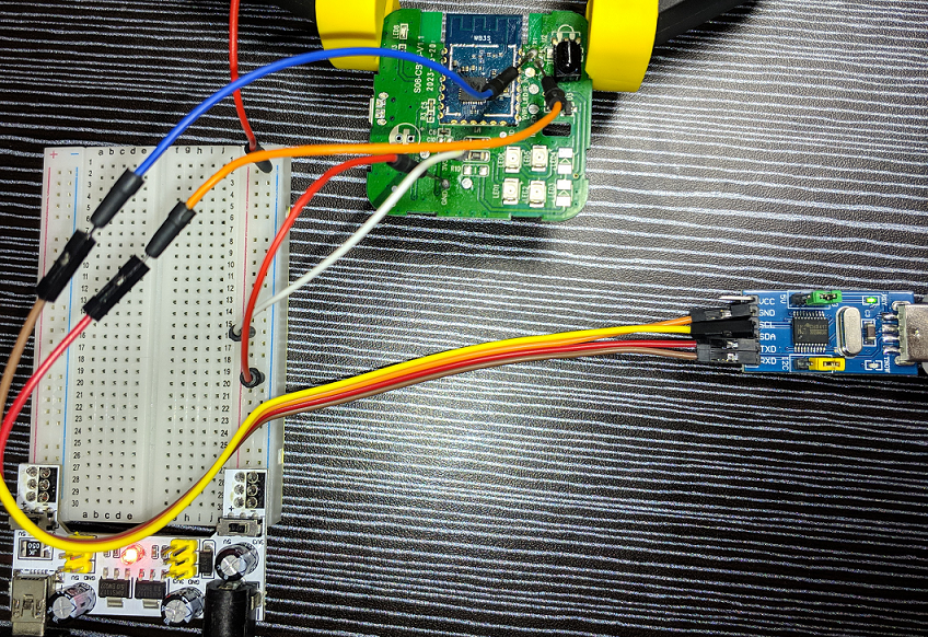

    Yes, I tried bkwriter with BK7231T chip, which just counted up to 15 seconds and then displayed 'Failed'.
    I tried swapping TX and RX which didn't help.
    I think my cables are as short as possible, being less than 20 centimeters from solder pads to UART adapter.
    Programming setup with a breadboard, BK7231T microcontroller, and UART adapter.
    My setup roughly looks like this.

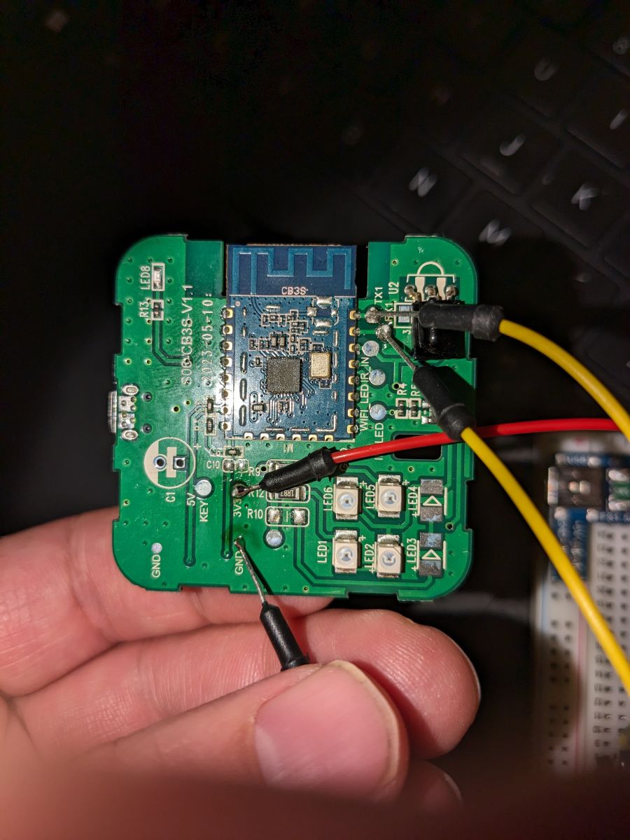

  • #8 21015301
    mrt724

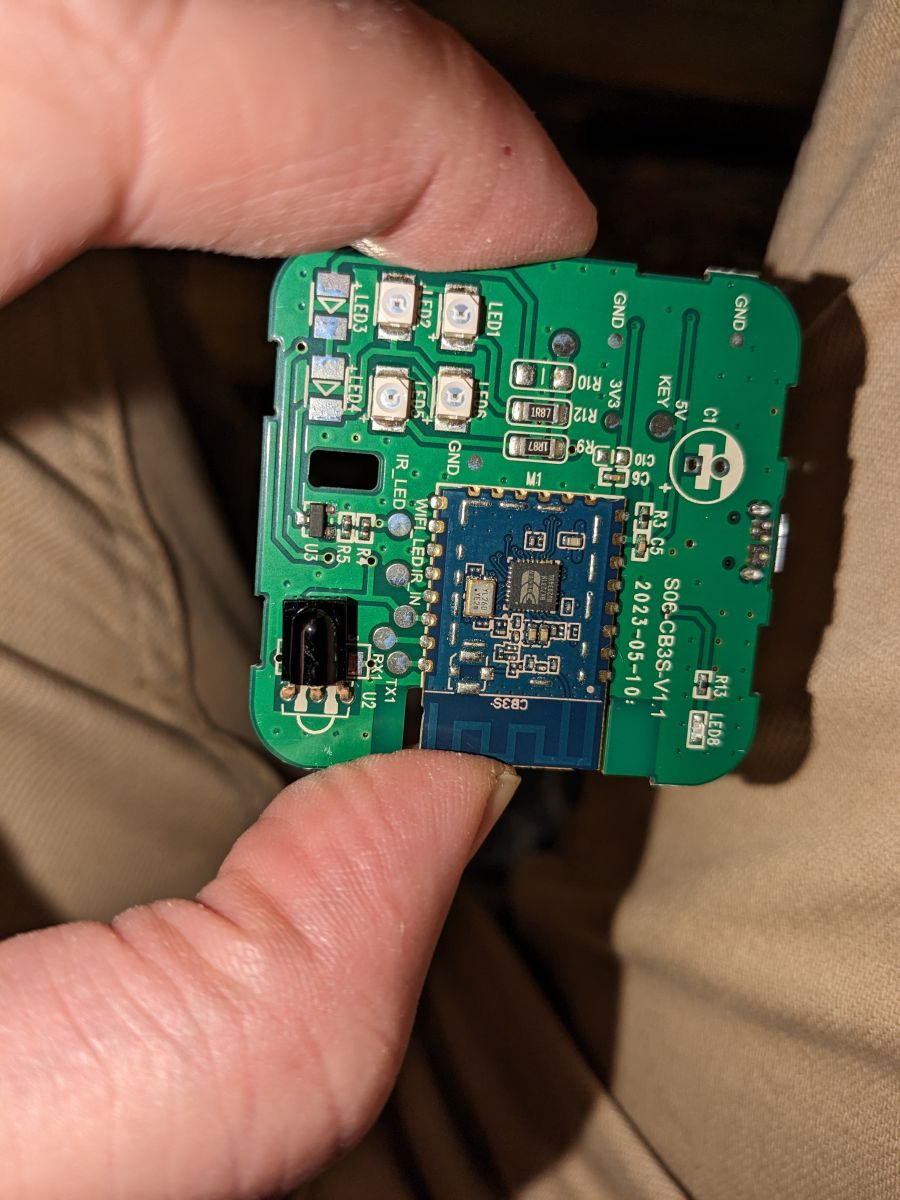

    Thanks for looking into this. Here is my pcb.
    Circuit board held in hand with connected wires. A person holding a printed circuit board with various electronic components. Close-up of a printed circuit board with visible electronic components.
  • Suggests multimeter checks and removing CB3S module
    #9 21015525
    Posts: 14755
    Rate: 12878
    Well, I must admit, I don't see much on this PCB. I am unable to tell at the moment whether RX/TX are connected somewhere futher.
    Do you have a multimeter, can you investigate?
    Or maybe are you able to desolder that CB3S module? I can give you some hints how to do that.
    Or maybe you are indeed making some kind of beginner mistake when it comes to flashing... idk, maybe the capacitor on the board is too large to do power off/on cycle and needs to be removed?

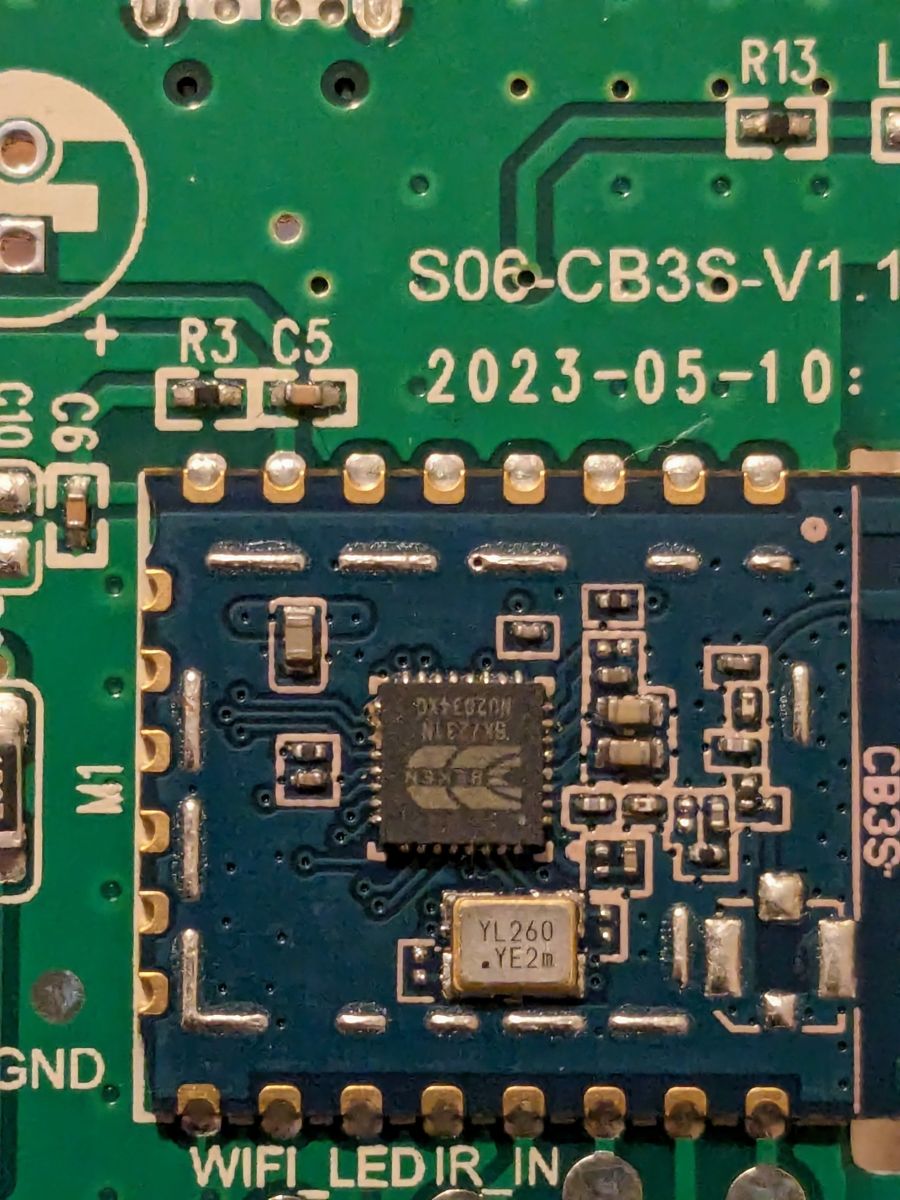

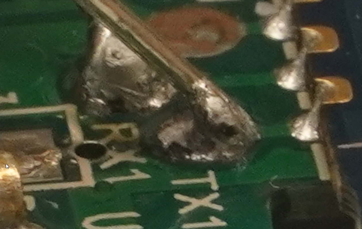

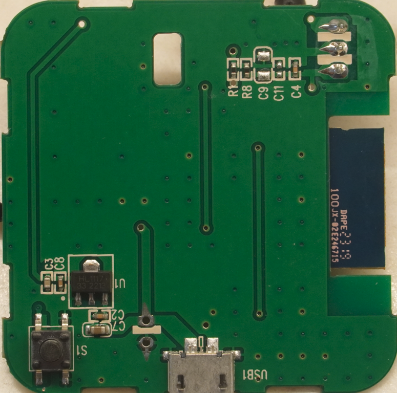

    Thanks @p.kaczmarek2 I appreciate you looking at this. Let me try to answer some of your questions, provide a little more detail and higher resolution images.
    Looking closely at the PCB I don't believe TX/RX go past the solder points and thus not are connected to anything else:
    Close-up of a damaged circuit board with visible solder points labeled RX1 and TX1.
    Close-up of solder points and traces on a circuit board with TX and RX markings visible.
    I do have a multimeter and if I know what I am checking I could probably identify it, but have lack of knowledge to know what I should check myself, other than ... are grounds connected, what's the voltage on 3v3, etc.
    Desoldering a full module, is probably a little above my skill level, although I saw another person replaced the beken with an esp and thought that was interesting.
    I definitely could be making a newbie mistake.
    I'm happy to describe or answer any questions you think would be helpful.
    1. The UART/USB is identified on my pc using device manager, then I use that port in either flashing tool.
    I have tried baud rates of 115200 and 921600.
    2. I am using a ESP8266 as pass through UART, tried doing the same with ESP32 dev board. This appears to be a well documented approach without a separate USB/UART module.
    (wiring up as follows):
    - ESP EN/RST pin set to GND (to keep the on board esp off)
    - ESP TX -> S06 RX (Tried it swapped)
    - ESP RX -> S06 TX (Tried it swapped)
    - ESP 3V3 -> S06 3V3
    - ESP GND -> S06 GND

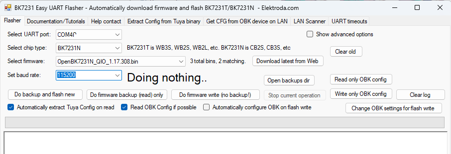

    Easy UART Flasher interface with selected COM port and baud rate settings.

    I managed to get the flashing tool to recognize the device finally and it appears that I'm getting OpenBK to flash. For anyone who is running into this issue I solved it with these three tips,
    1. Try swapping tx/rx
    2. Make sure you have a separate 3.3v power supply.
    3. When doing GND to RST repeat every couple of seconds until one of them triggers at the right time.
    NEW ISSUE: The Access Point isn't appearing after flashing.

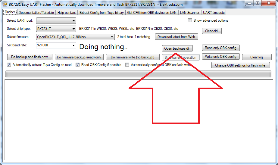

    mrt724 wrote:
    So.... I think my original firmware got overwritten by a second flash in the backups folder. Is that something I can find?
    To the best of my knowledge it is not possible to overwrite the firmware backup file taken by BK7231 easy UART flasher. This is because each created backup file has a current date/time string in the name and backup procedure takes so time so there is no chance that a backup file will be overwritten. Are you really sure that your backup file is not present? Use "open backups dir" button and check the files:
    Screenshot of the BK7231 Easy UART Flasher application with the Open backups dir button highlighted.
